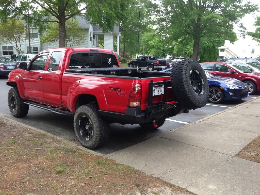

    Cuttin the bedsides. Wasn't me tho. Was el tacorojo

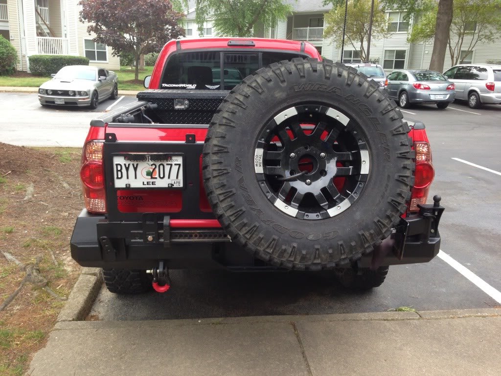

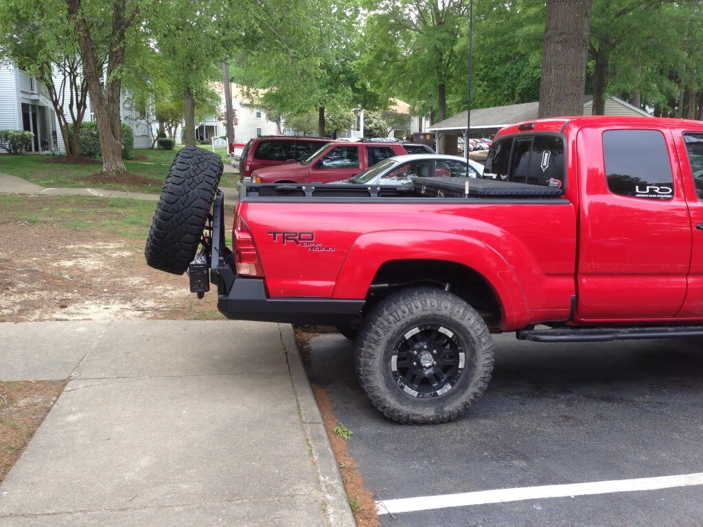

    bumper complete
    the only issues i ran into with the bumper was the latch thing that secures the swing arm to the bumper. the Hole in the swing arm was slightly off to screw the handle into the hole. once we opened it up a little, it worked just fine. also, i think the screw part for the handle could stand to be a little longer to make it easier to secure the swing arm. otherwise it was a pretty simple install other than painting which always sucks.
    for paint i used POR-15 to coat, then rustoleum bedliner to finish it off.

    wrmathis,
    I have a Bushmaster with a swing gate ordered from Nathan. Did you do your own install and are photos/info available? Would appreciate any suggestions/comments. It looks like you cut your fender right up to the minimum between the fender and the bumper. Is their any "give" under this area if you contacted a rock or something that would result in the fender area above it being flexed and bent?

    no extra pics i got other than what i have posted. best tip i have is have someone there to help you out. makes it a lot easier. when i first cut the bedside, part of the bedside was actually inside the bumper. like an over lap. since then, i have gone in and measured 3/4" above the bumper to get a nice gap/clean looking cut. you want some kind of gap here and not because of hitting a rock or anything like that, but from the frame twisting and making contact with the bedside
