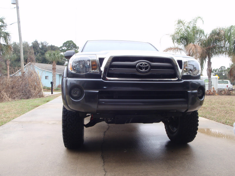

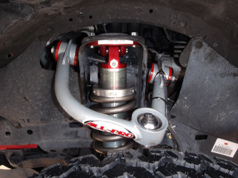

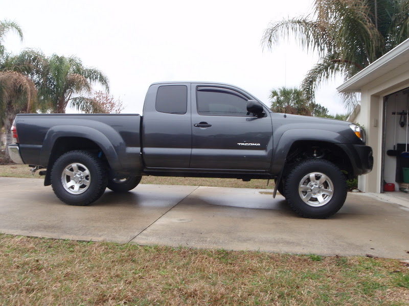

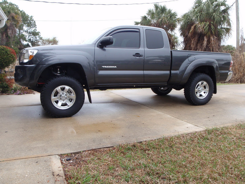

    Just finished my lift and tire install. It looks like I will now need a rear lift. I was hoping to just level the truck since I have the TSB rear. Any suggestions on rear lifts?
    Also the All Pro instructions for the coilovers say to pre-load at 3.2" and 3.5" for 3" of lift. This is NOT correct!!!!! I set mine at 3" and had 4" of lift and NO give whatsoever. I now have it at 2" of pre-load and still needs to come down another 1". Any suggestions on adjusting the pre-load while on the truck is appreciated as I am having a tough time.

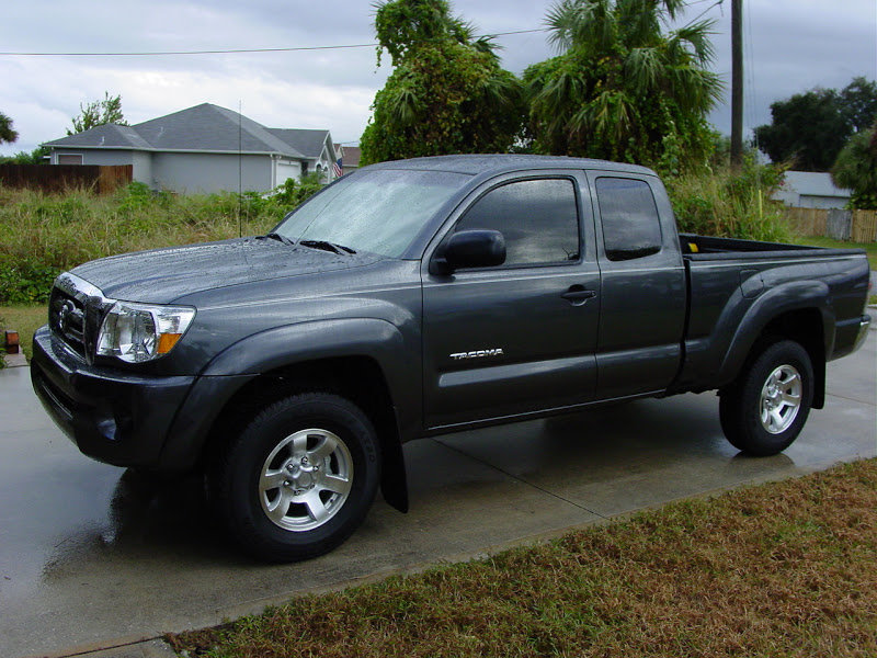

    Before:

    Damn that shits high in the front!! Get Toytec's AAL, costs $92 shipped!

    Lower the front some, and get an Aal for sure

    I am looking at the Toytec or All Pro AAL. Do you know if I need longer U-Bolts from the Toytec AAL? I am also unsure if I will need axle shims and/or a carrier bearing drop.
