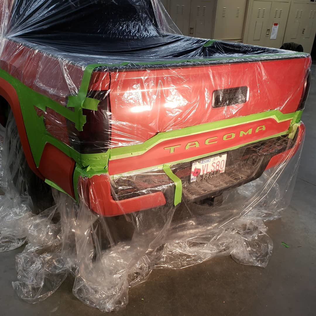

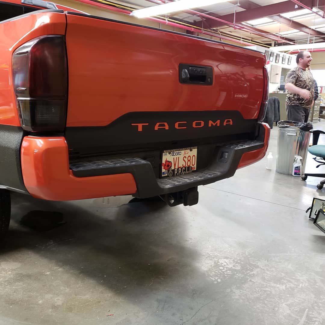

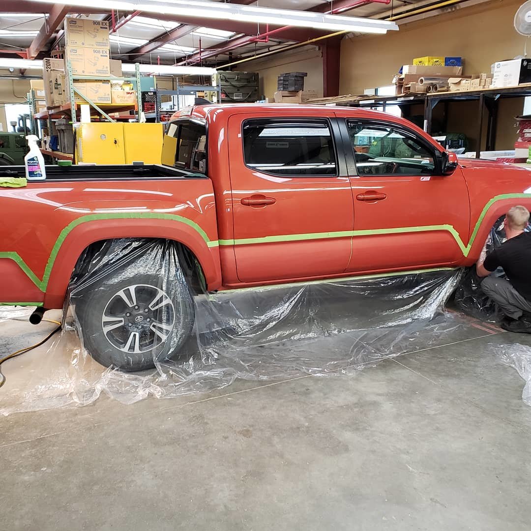

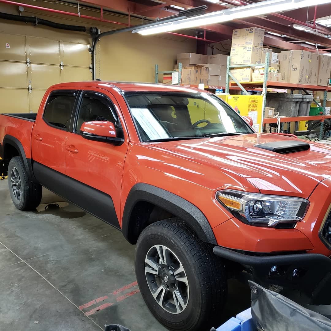

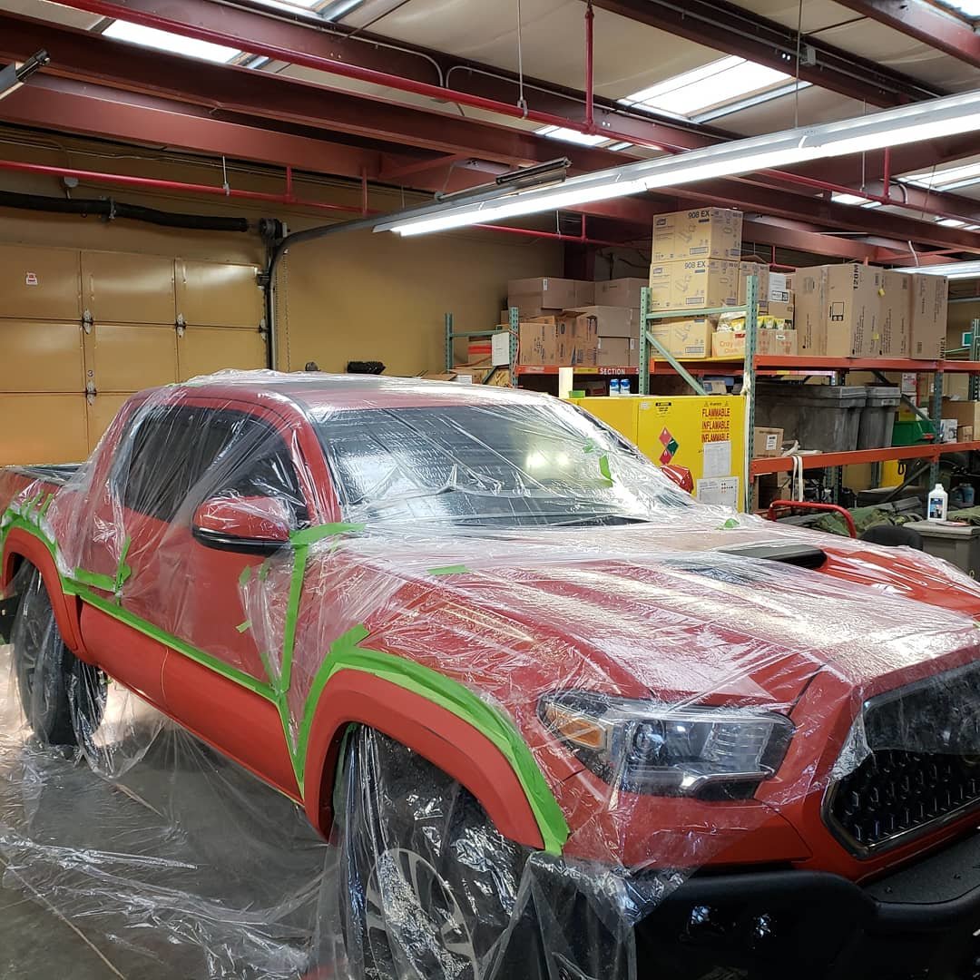

    I was a busy boy this weekend, let me know what you think.
    Started with a long night on Friday taping off all the lines and sanding the clear coat.
    What a feeling it is to take sand paper to your new truck lol
    We then in the morning looked over all our work, did a thorough clean, and polyed off the whole truck.
    I had bought some vinyl letter inserts by BD trims and taped over them so I could get some contrast on the tailgate. This ended up looking very good and was very easy, add long as you have a steady hand and take your time.
    Once everything was set, it was time to posti. I had access to a shop at work with a large compressor to use the posting gun. I recommend buying a regulator for the air pressure. I used 42psi to paint.
    And after a half-hour dry time, I took the tape off before it was too dry and hard.
    I'm very pleased with this project, I'll post more pictures in better light, but right now the truck is going to stay put indoors for the week as to let the paint cure. I'm up in Alberta and winter gets in early
    The raptor liner seems like a fantastic product and I'm very impressed with it. This cost me about $500 all in, I feel like it would cost me a few thousand to get it done professionally.
