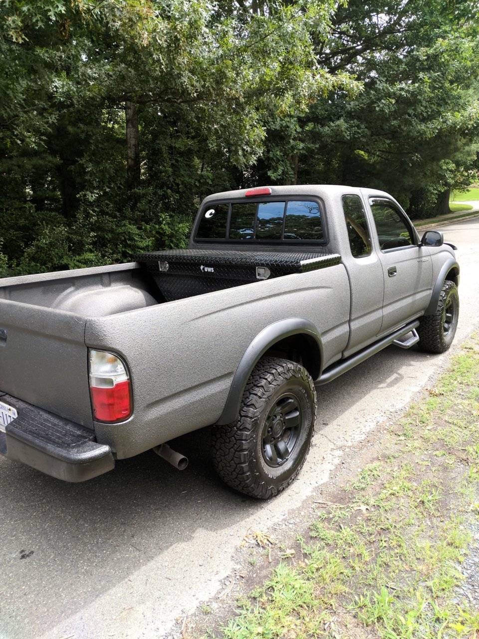

    Raptorliner is fantastic. I went ahead and covered my old '96 from head to toe with it and couldn't be happier. It's held up well...looks the same as the day I applied it a year ago. This stuff can take a missile. Also is great for door ding repellant.

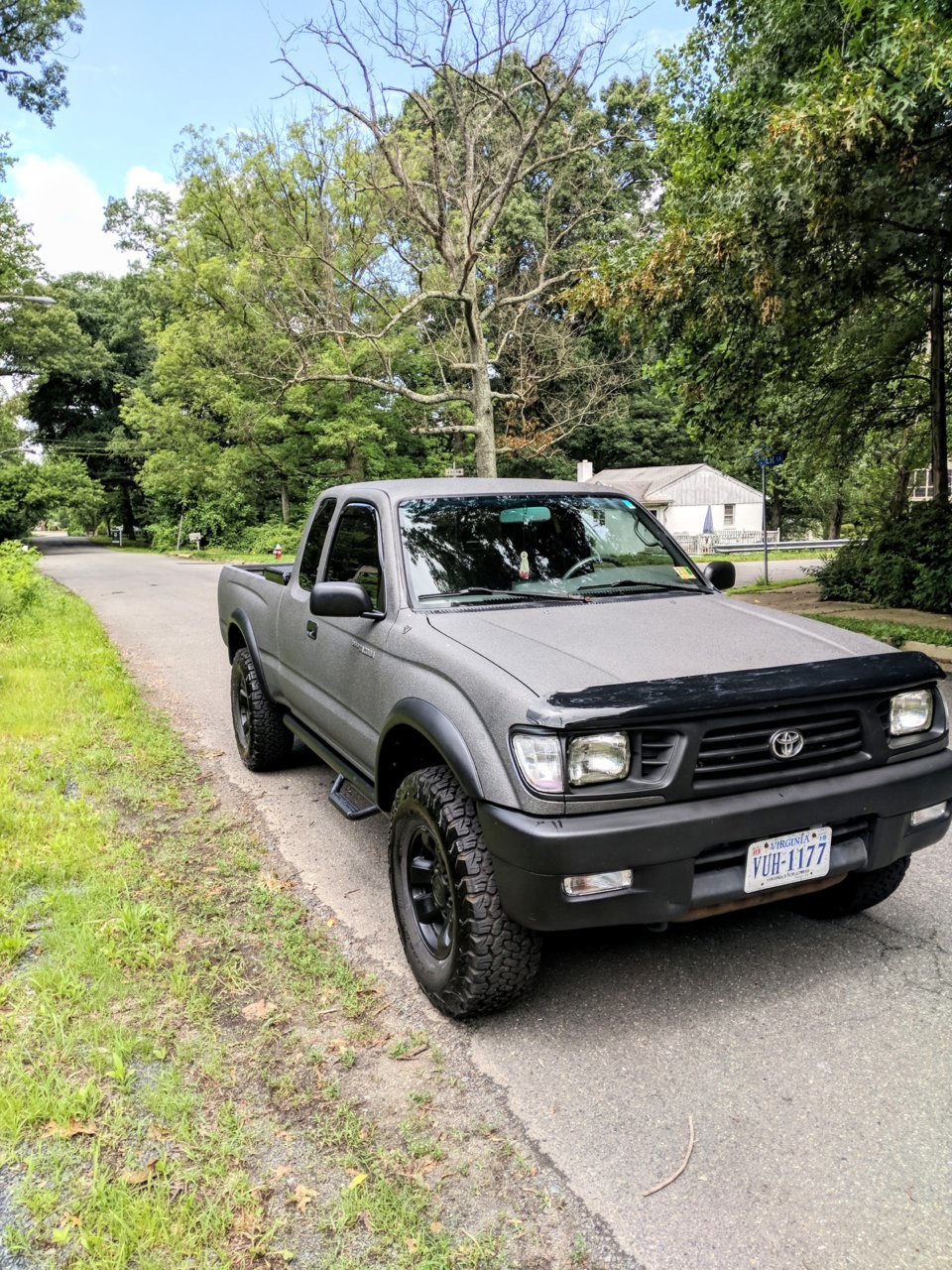

    Its holding up great...no regrets. It's nice just taking a hose and never having to wax again that's for sure. I'd definitely do it again, just make sure to sand and wash properly in the process. Take your time with the taping too...that was the most time consuming part but I'm glad I didn't cut corners. Once you get to the liner spraying stage it's a lot of fun and real rewarding. Here's another picture up close, if you have any other questions feel free to ask!

    Heres a couple more
