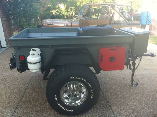

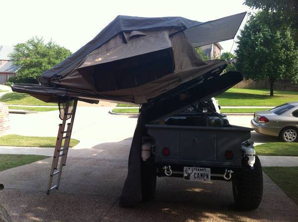

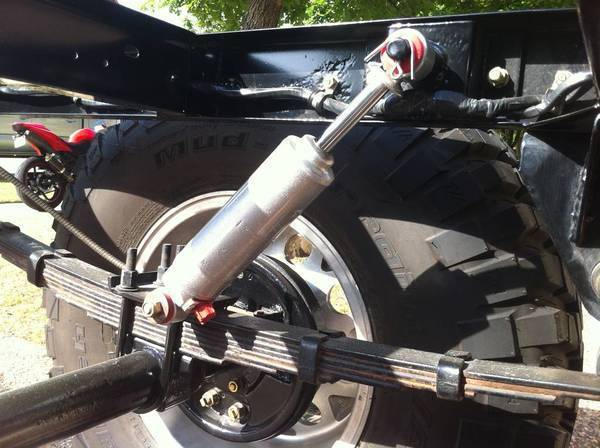

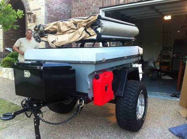

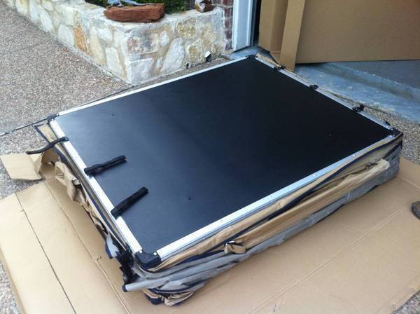

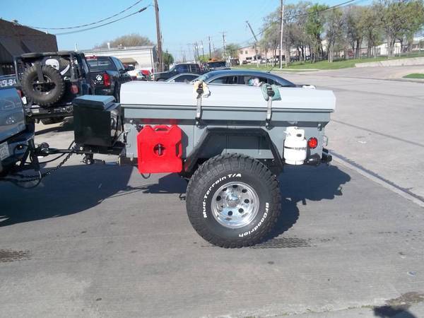

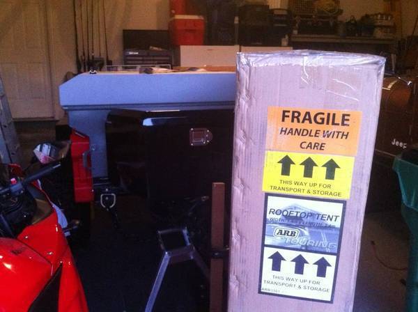

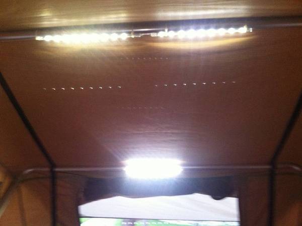

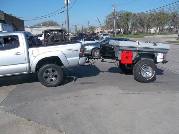

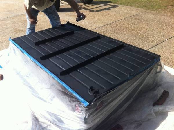

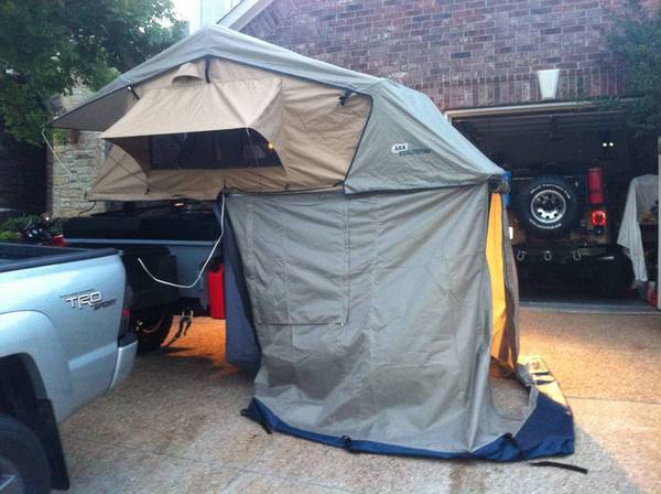

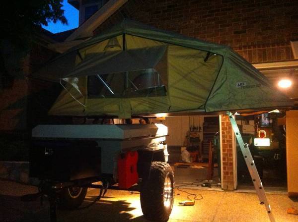

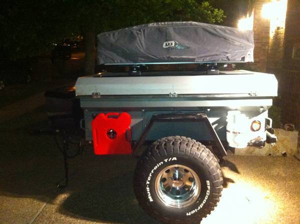

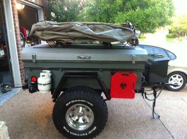

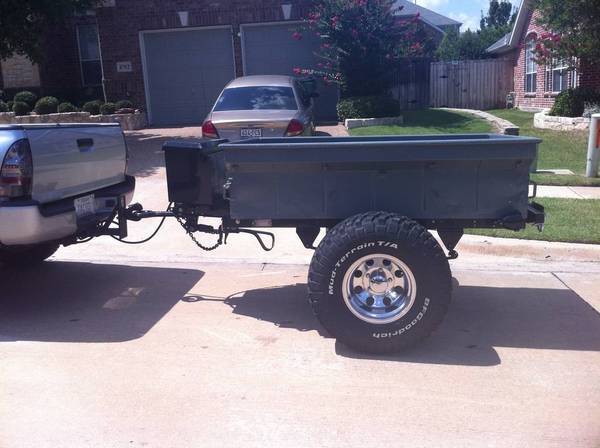

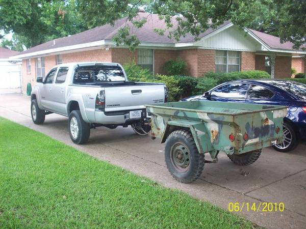

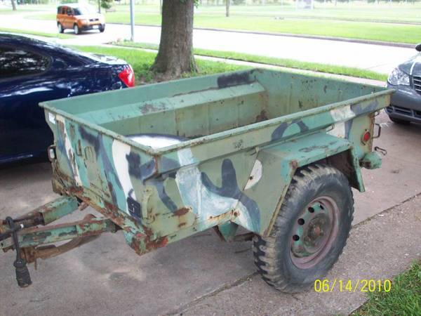

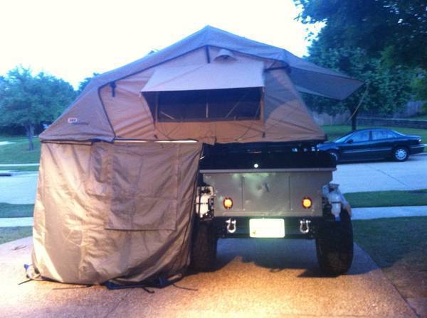

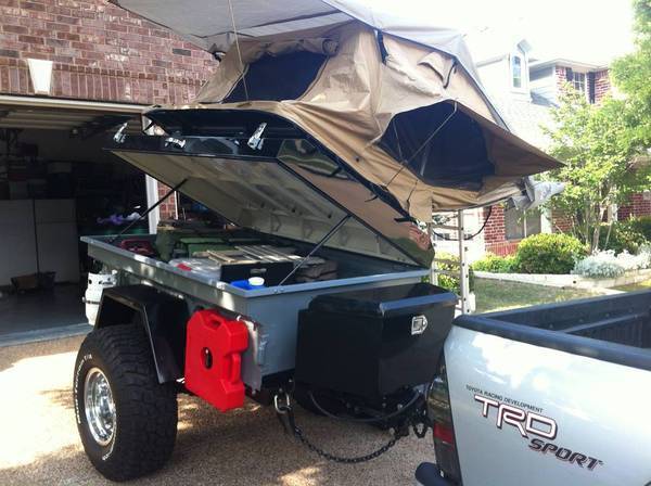

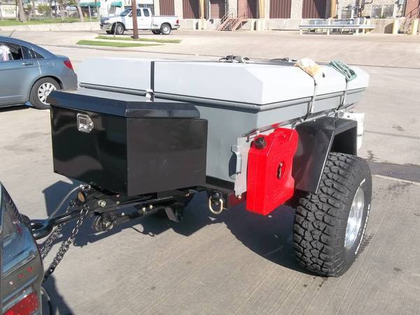

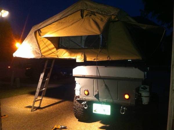

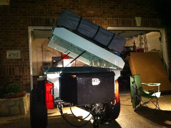

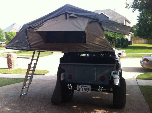

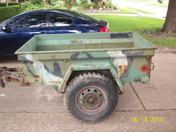

    So my dad and I bought this old 1960's M416 trailer to build for expedition camping. I completely removed the tongue and frame from the tub, had it sand blasted and powdercoated and replaced all the nuts, bolts and washers with new zinc ones and replaced all the rubber gromets (basically all hardware was replaced) and then reassembled. We then did a spring over, and dad put on the same 33's and matching wheels like the ones on his '79 CJ-7 Golden Eagle Jeep. Between those 2 upgrades it raised the trailer like 4", so its easier to see now. We then had the tub sent off to the powdercoaters. Next we added a tool box to the tongue, using some square tubing to raise it up from the tongue some and give good mounting points. We also added one 5 gallon propane tank behind each fender flare and one 3 gallon Rotopax gas can in front of each fender flare on both sides of the trailer. Recently we had a custom lid made by Sierra4x4trailers.com and bought the ARB Sampson III RTT. To mount the RTT to the lid we used Thule tracks, feet and crossbars. In addition, we installed some LED lights in the tent that are wired to a deep cycle gel battery in the tongue-mounted toolbox. We also, just had the lid painted, and while we had the lid off, we removed the tub, flipped it over and sprayed a rubberized coating on the bottom. Now we just need to paint the tub. Dad and I are arguing over the color, I say leave it all flat grey like it is now, but dad wants to paint it to match the Jeep (1979 Alpaca Brown Metallic) for show purposes. My arguement is that we arent building it for car shows, we're building it for camping. Although, I'll admit, it will look sharp match painted and behind his jeep. Oh well, like dad says, when I inherit it...I can paint it whatever damn color I want. Heres the pics. MORE TO COME!!!!!
    How it looked the day we bough and picked it up

    On the Taco

    ARB RTT waiting to be put on

    Rubberized coating applied to bottom of tub

    Tent Open
    Tent & Lid Open
    LED's Installed in Tent
    Annex installed

    That is sick! Where did you pick that up from?

    got it from a guy on CL here in Houston. Paid $700 for what it looks like in the first few pics
