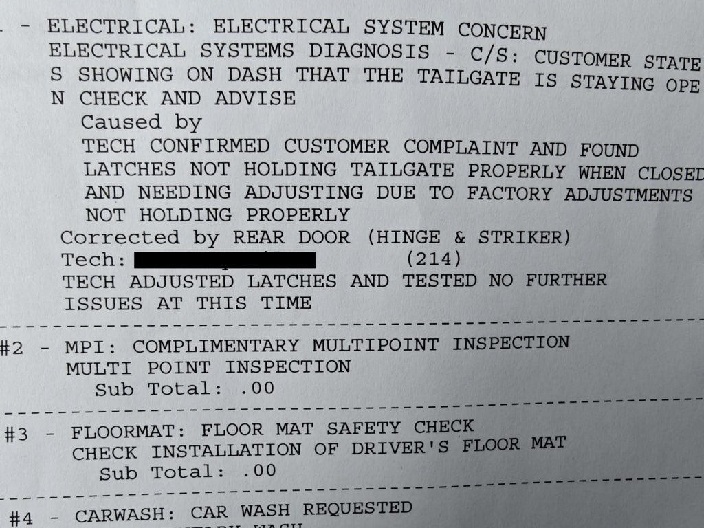

    Went to the dealer to solve the tailgate deciding in the middle of the night it was open thus triggering the truck alarm:
    Service writer says latches on both sides adjusted forward. He indicated a distance of approximately 1/8 ".
    I can confirm that I can't replicate the previous error no matter how much I pull on the tailgate. It does give a more "pop" when opening than before. I should of asked if used Loctite on everything.

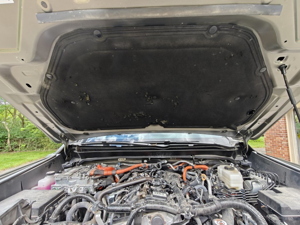

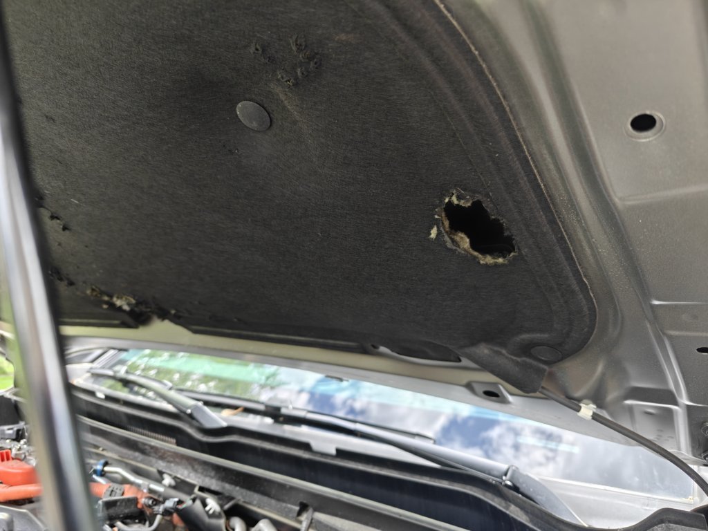

    Rodents like the hood lining material:
    I have been parking in my driveway and opened my hood to see this. Just now soaked the material with peppermint oil. Sprayed all electrical wiring just in case. Additional rodent traps on the way.

    Holy shit man...

    OEM’s really should use ghost peppers in their wiring harness and other engine compartment bits.
