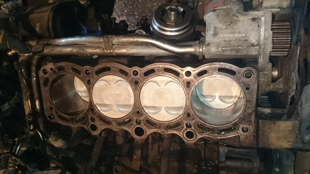

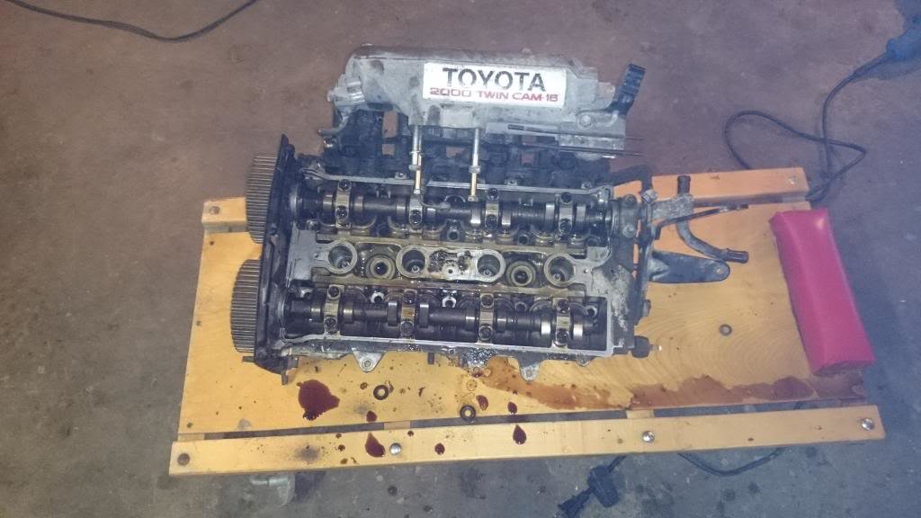

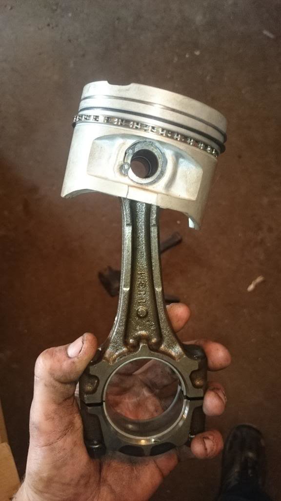

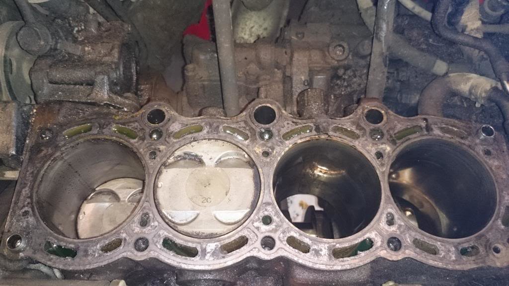

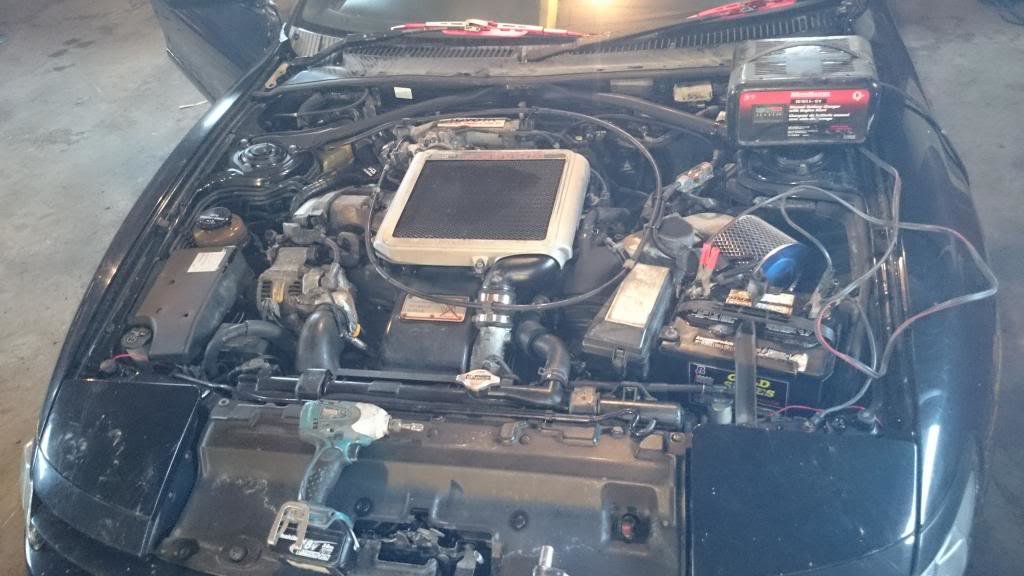

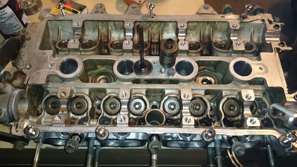

    alright since I sold my mr2 every sports car I see makes me sad!
    So I found this on kijiji for 1000 bux! It's a 92 jdm toyota celica all trac 4 or gt four
    seller claims it won't start and just needs a turbo.
    Compression was 185 across the board.

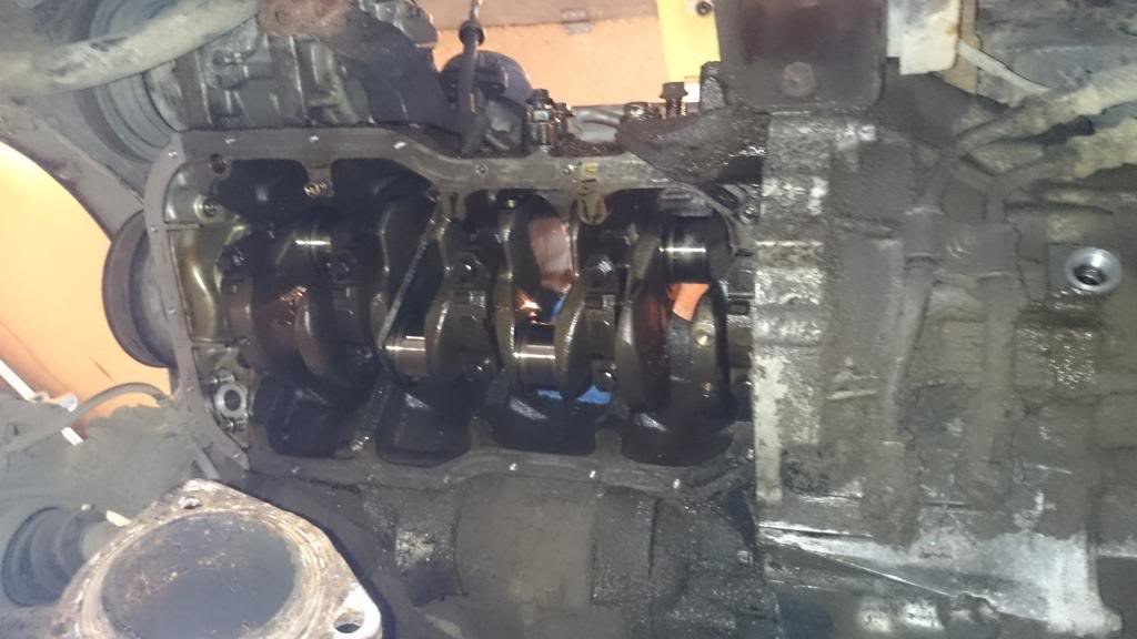

    I have a set of pistons, Rings,all gaskets,Waterpump and oil pump for the 3sgte so I started going to town on it...
    Pistons can be done with bottom end still in the car

    Apr 4, 2012

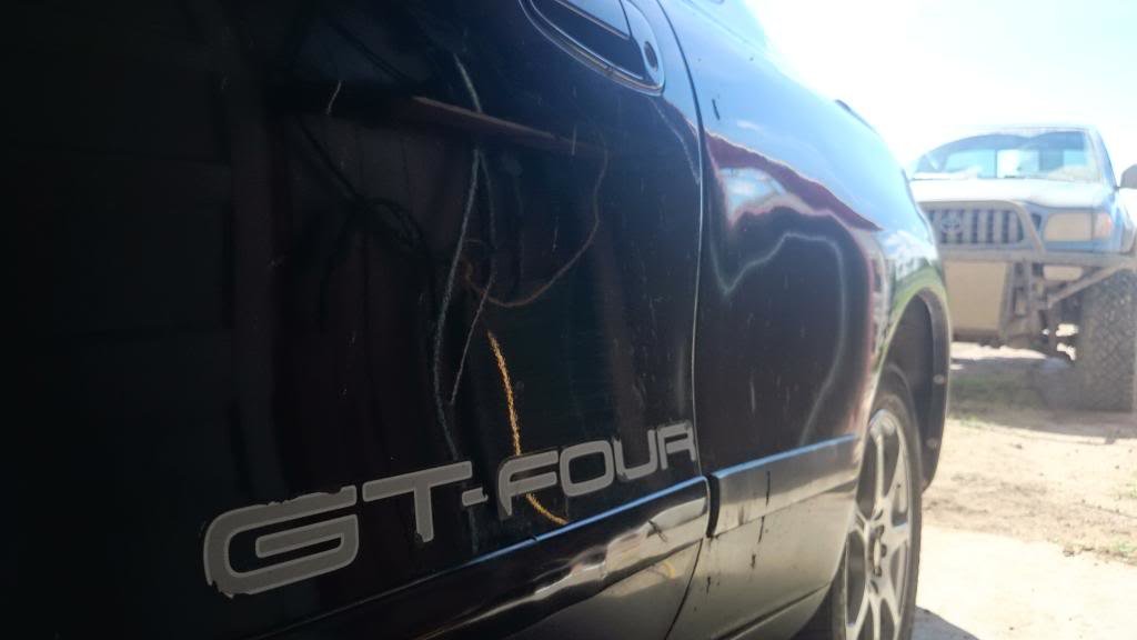

    Cellphone photography hahaha
    Extension cords in the reflection...

    Plans other then the engine rebuild are blow off valve, downpipe, change diff and tranny fluid, powercoat valve cover + other random parts....wheel spacers with wider tires

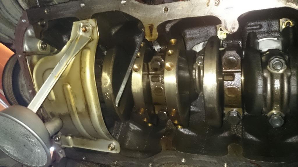

    So honed the cylinders...installed the new pistons/rings!
    Changed all 16 valve stem seals...what a pain
    Cleaned up the bottom end as best I could....retorqed everything and installed new oilpan gasket.
