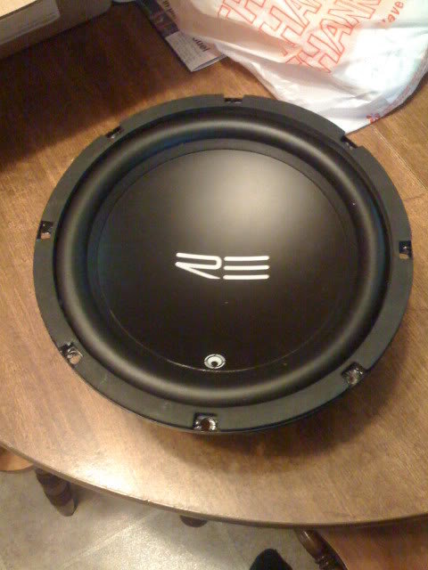

    RE10. I used to run RE HC12's in my Civic back before that line was replaced with the SX line. I've always loved the sound of their speakers.

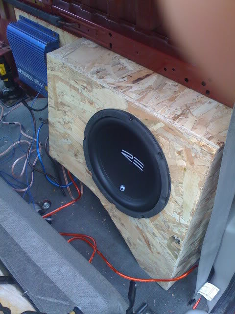

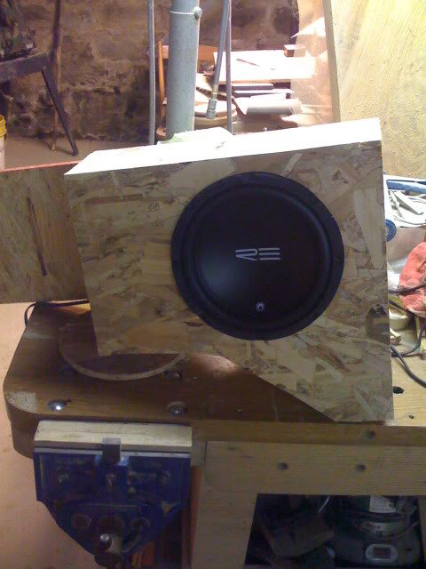

    Well, I had an uneventful weekend...
    Yes, I did use 1/2" thick particle board. I've been into car audio for the past 10 years so I know that the particle board "leaks" air. I put 4 coats of fiberglass inside of the box to seal it up. We're having a garage built so it was free instead of buying a sheet of MDF for 35 bucks.
    The jenson amp is temporary. I scowered ebay for the past week and landed on a Rockford Fosgate 300x to power my components and the sub. The jenson has no LPF so I'm getting a full range of sound instead of 80hz and lower. I also have a thumping sound but I'm 99% sure it's the amp. I'm going to hook my friends HU up to it to make sure that its the amp before I do something drastic.
    Overall, even though it's a full range of sound and in a .7 cube sealed box, it sounds pretty good. I'm thinking of putting in a 2" round port, but I'm waiting for the new amp to come in before I decide on that.
