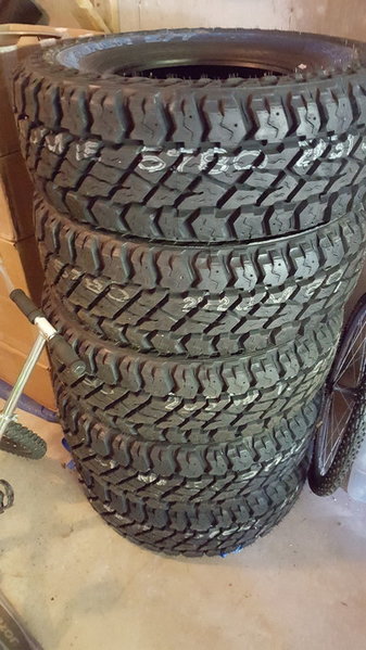

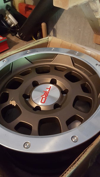

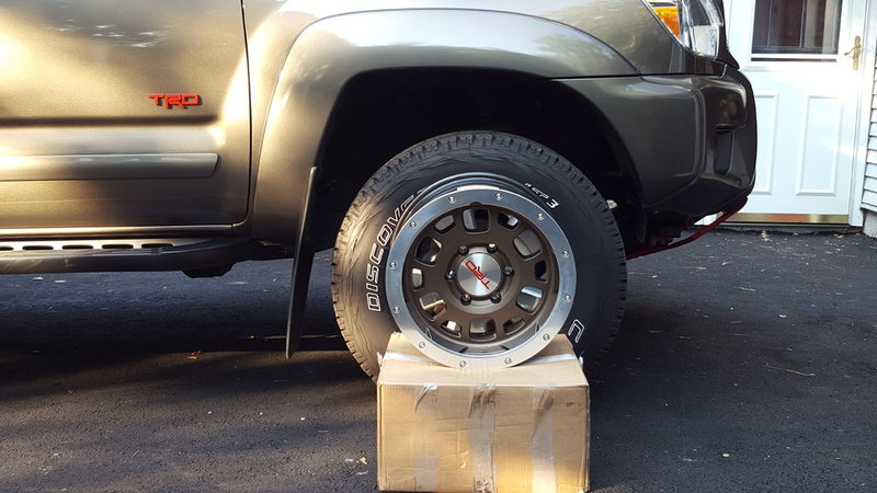

    5 Bronze TRD Beadlock rims with 5 new Cooper ST/MAXX 265/75/16 tires
