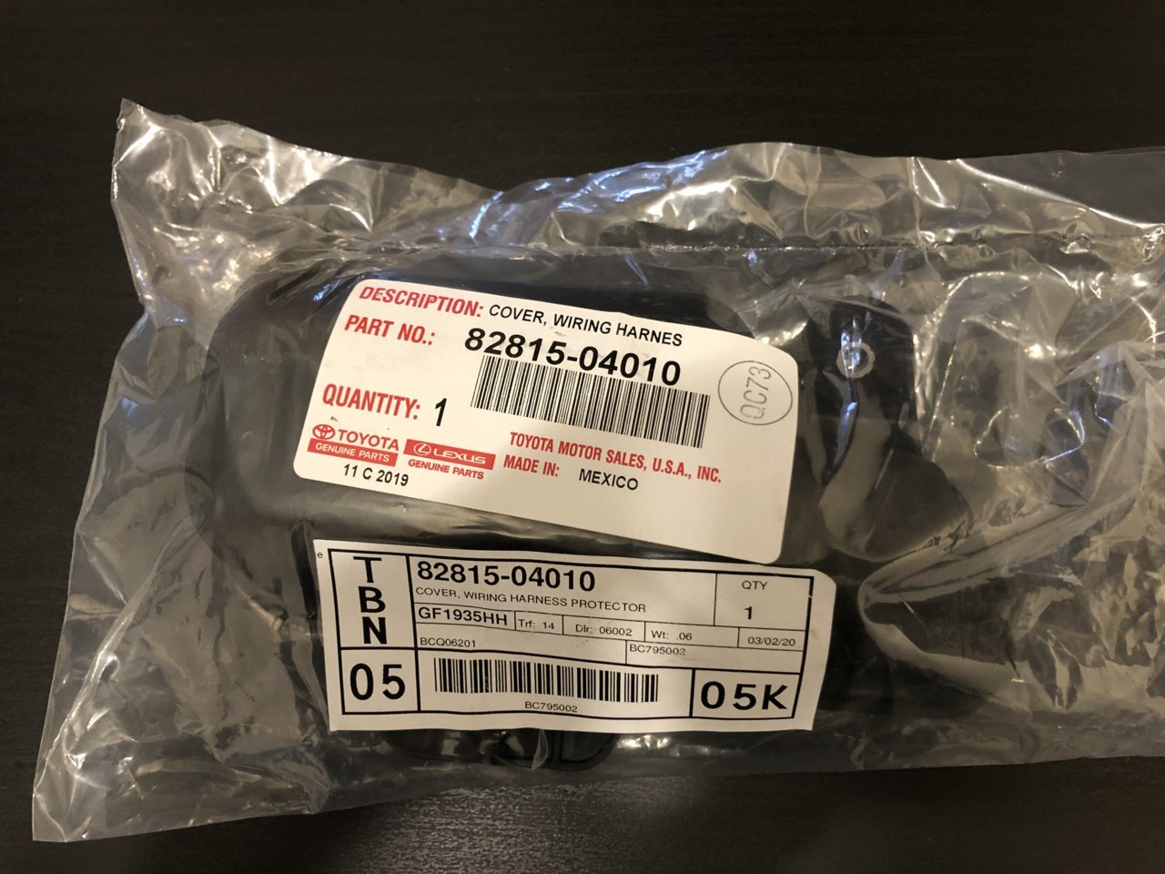

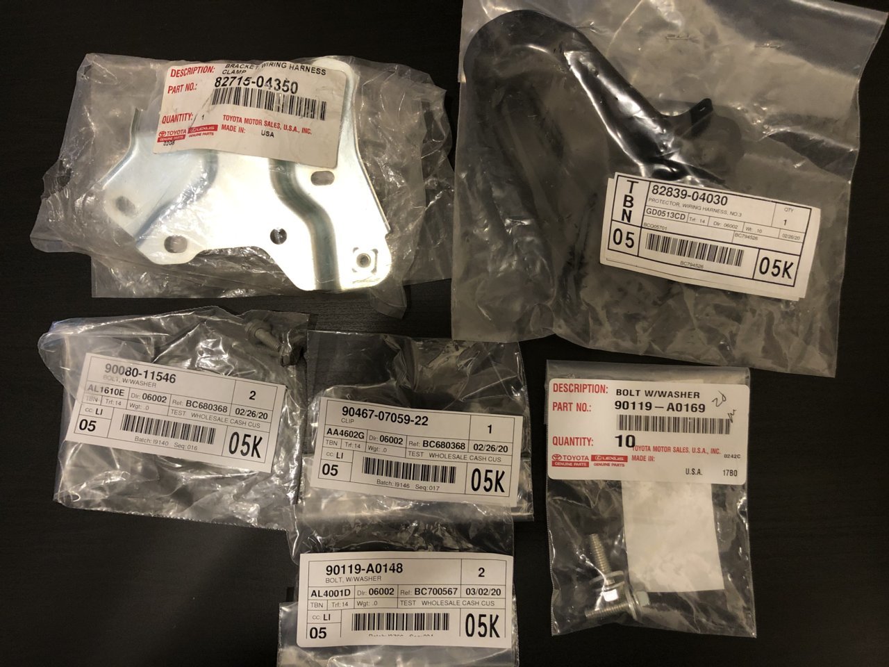

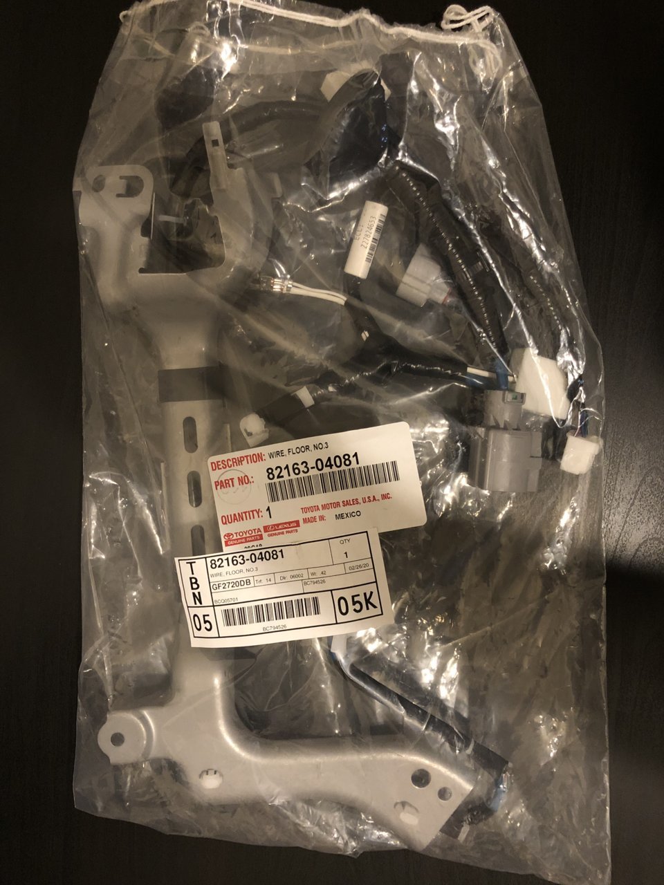

    Here are some part numbers I dug up while searching on the internet. Parts are for a 2015 Tacoma quad cab. I went with the specific harness because the plugs are under the truck (covered by the plastic piece) instead of under the seat.
    The main harness part number is 82165-04071 (no picture).
    There is one cover for the interior that is on back order. It should be here March 12th.
