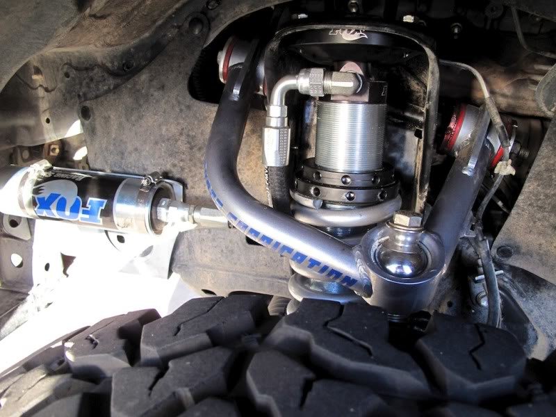

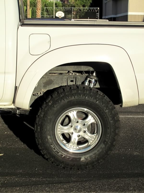

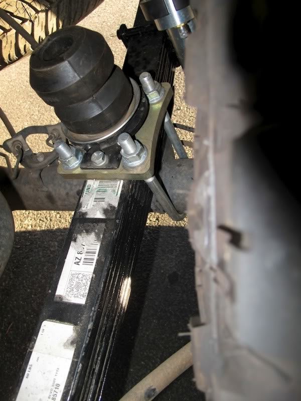

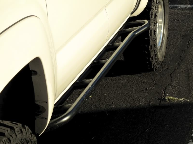

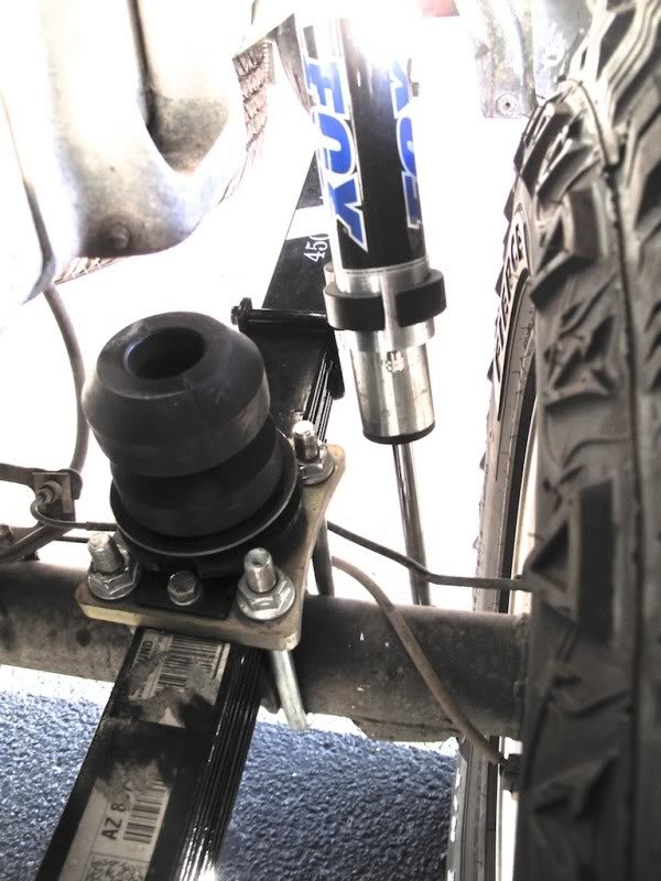

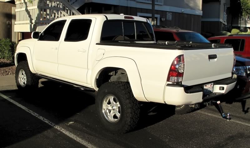

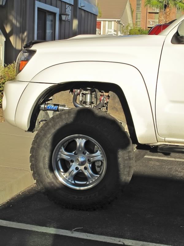

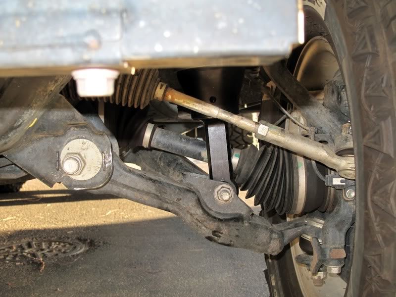

    OK, so today I finally had my coilovers cranked up and an alingment done. I had them set it a bit high so when I put my skids back on it will come down a bit and even more when I get my bumper and winch up front. Also there is a picture of my sliders from Avid Offroad, I never really posted pics of them.
    The truck definatly rides a bit rougher now that they are cranked up but its not any rougher than you would expect a normal truck to ride and it is still better than most trucks straight off the line.

    Very nice man... I need to get off my ass and get mine done
