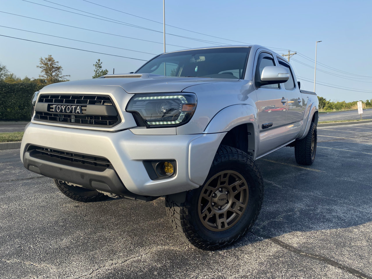

    Thank you! I’m loving the lighting upgrades, just need to work out the kinks with the headlights. They came with no installation instructions and the turn signals are hyper blinking. Can’t figure it out. I ordered some resistors so we’ll see if that fixes it. In all the reviews I read about them nobody ever mentioned needing them, so we’ll see.

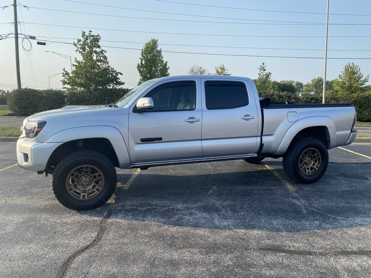

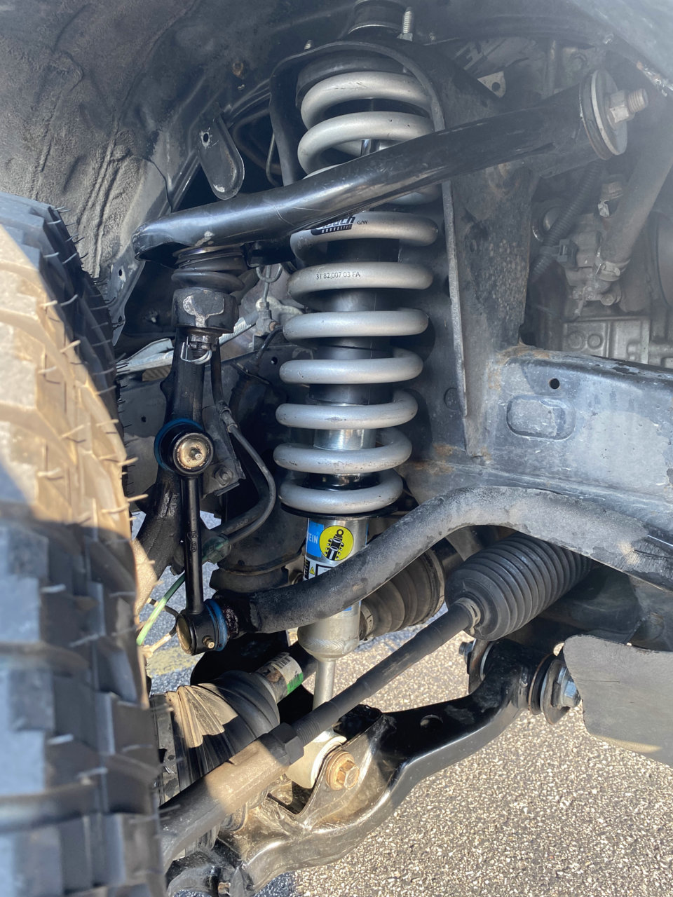

    It took me a few days to get the 5100s+Eibachs installed but I finally finished up today. Compressing those stiffer Eibachs with my janky little spring compressors was super sketchy, so I stopped and dropped the shocks off at a shop to assemble. Loving the new stance; it's sitting pretty dang close to level now. The ride is MUCH better than the 3rd gen OR suspension was. A tad stiffer but still very comfortable, and definitely feels stickier.
    Also fixed the hyperblinking turn signals I was getting after installing the AlphaRex headlights. All it took was adding a pair of resistors to my tail lights and now we're all systems go.
    I noticed that damn near every photo I've posted so far has been in the same spot of my driveway, so this time I ventured out for you guys. :D

    Also had to throw on a diff drop and carrier bearing drop to try to resolve the expected pesky driveline vibes I got after installing the Eibachs. They definitely helped but there’s still a little bit there. I can live with it.
