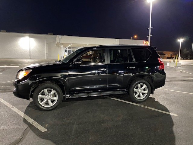

    2010 Lexus GX 460 - Base (essentially a 4runner with some added luxury)
    4.6 L V8 w/ 6 speed trans
    Stock for now, but already spent so much on mods that my card company froze funds for suspicious activity.
    Wheels, tires, lift and sliders all ordered. Crawl control, multi terrain select and a few other OE retrofits planned.
    Overall plan is to build it like the Tacoma as that served my needs well, essentially an “OEM ++” type build, not the ultra rock bouncer or overland focused thing, just nice and capable for a weekend beast.
    I originally sought out a GX 470. I test drove a few that were very affordable, but started focusing on the nicer, low mileage ones. Not only were they few and far between (and out of state), but for a lower mileage one, I was looking at the same kinda price as a newer GX 460...so I searched for a few and found this one in Texas at CarMax. Had it shipped to town (for free, thanks CarMax) and test drove it last week and bought it that day. Now that I see the light, I’m not sure why you’d buy the GX 470 honestly. Unless the higher mileage and thus lower budget ones is a focus. Good 470s and good 460s are about equal cost, yet the 460 has loads more to offer. More modern safety and features, more fuel efficient V8, more modern styling, more upgradable features from modern 4Runners.
    So far very happy, except the wife saying it’s an old mans car lol.

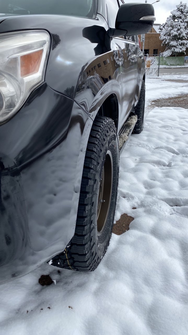

    Wheels and tires mounted. 285/70R17 Falken Wildpeaks on SCS Stealth 6 17x8.5 -10mm offset in dark matte bronze.
    Rubs up front when turning, but the 2.5” lift, JBA UCAs and some trimming will fix that soon.

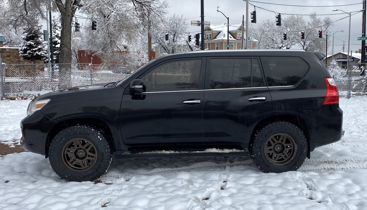

    She needed a lift, so I went for a 3" Dobinsons lift kit with JBA UCAs, came out pretty nice. Little firmer ride, got rid of some of the nose dive while braking but retained most of the ride quality.
    Started by seeing if the camper would fit 33's...it does. The tires on it are starting to dry rot, I bought them dirt cheap second hand, so it's time to replace them and I'm a fan of carrying less spare tires and thus all tires (rig and trailer) matching. I've had to talk myself out of spending $450 just to have wheels that match the rig...that's stupid, right...right? The ProComp black wheels should be just fine, though they do take a different wheel lug key than the rig and I would like to only carry one...no, no that's silly. I'll just match the tire sizes.

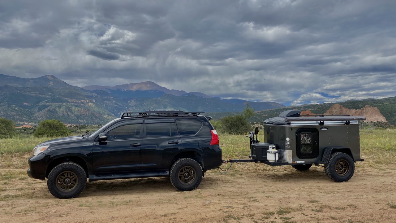

    Well, trailer is all wrapped up, pending some little storage solution tweaks and maintenance. Pulled it out of the garage and cleaned it up and she’s ready for some weekend-overlanding.
    As you can see, I caved and got the matching wheels and tires on the camper, thanks @SCSPerformance for a rad setup. Your “blemished” wheels make perfect trailer wheels.
    In the next month or so when we’re out camping next, I’ll probably record a walk around video of everything to celebrate the end the two year build journey and try to detail anything I’ve missed along the way.

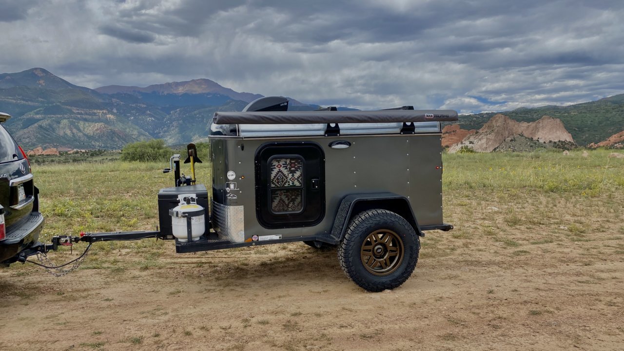

    I only swapped from the stock A-frame standard ball hitch to the extended tongue with the lock and roll hitch.
    The a-frame to receiver tube adapter I ran came from Adventure Trailers and was this piece, which is laying upside down in the pic:
    Here’s the complete combo labeled to help break it down. AT a-frame adapter -to- standard receiver tube extension -to- lock-n-roll hutch:
