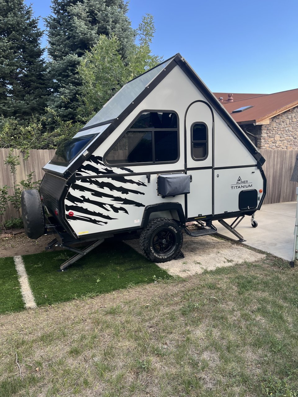

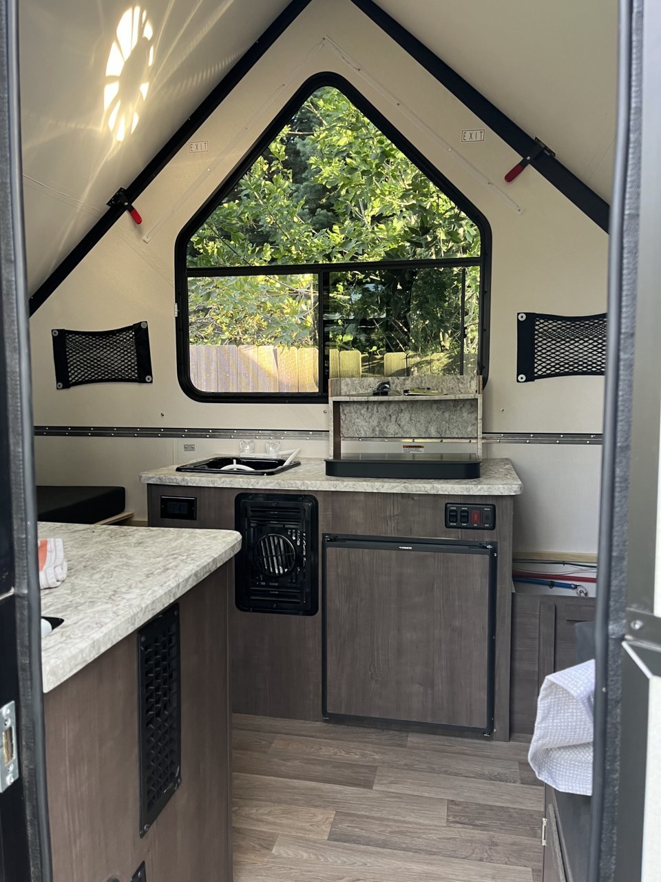

    Finally an update for everyone, here’s our new camper that I surely plan to modify for a better use: 2019 Aliner Titanium 12
    40FB0E98-A300-4108-A0E2-18B561E7B3E1.jpg 19B2BD1D-F2AC-43DC-8DB0-01FF27342108.jpg
    First improvements will be a longer tongue and lock-n-roll hitch and eventually new suspension. While it sits high, I hate the torsion axle setup and much prefer a good leaf spring setup with shocks (or maybe I’ll try a independent A arm style with coils and shocks).

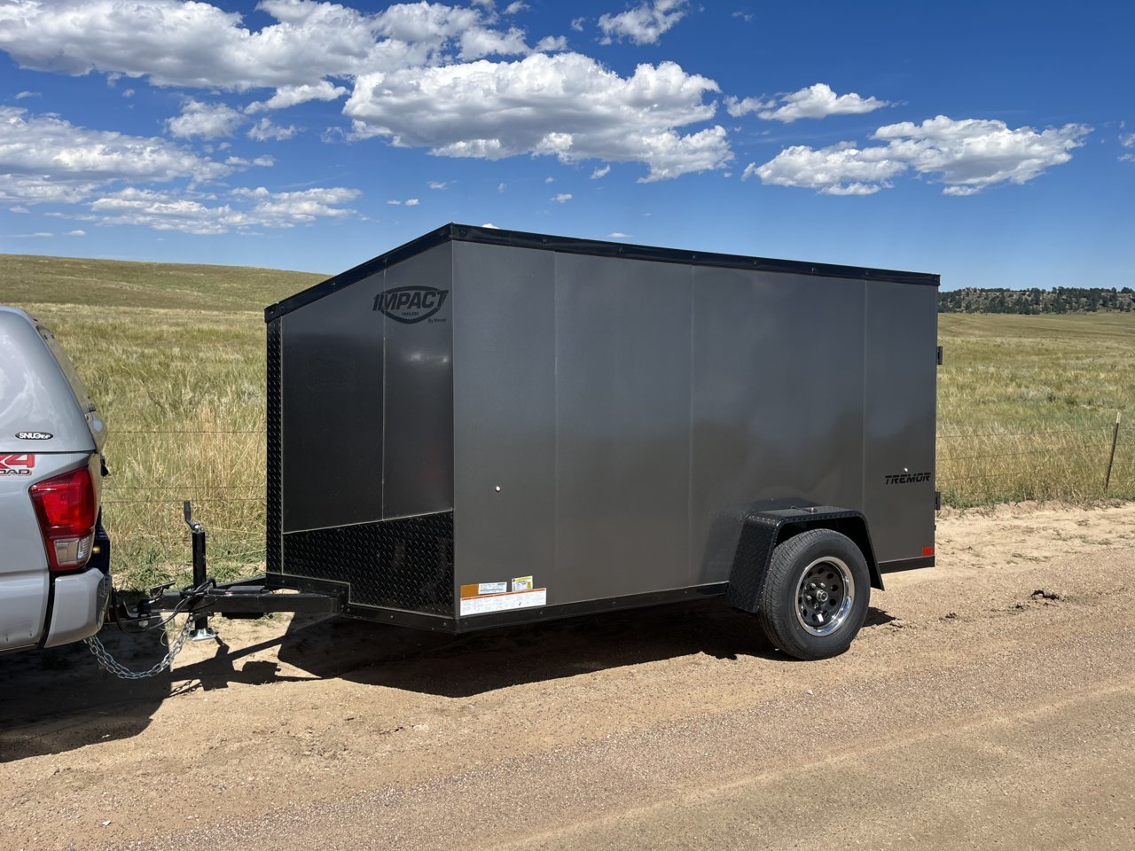

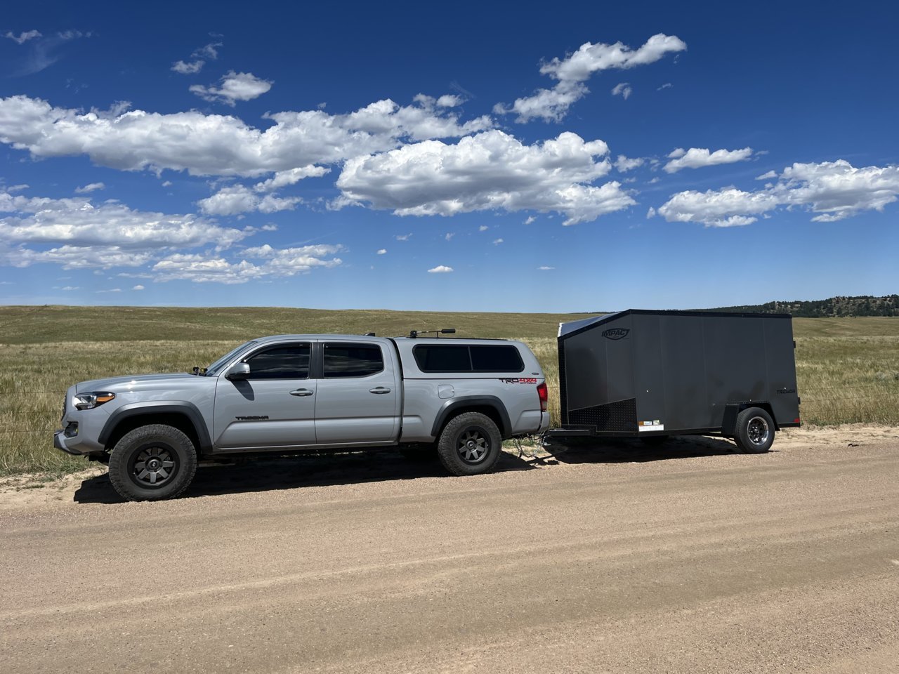

    We’ve got one ordered! We customized it as much as we could from the factory, so they said 6-8 weeks build time and I’m collecting parts in the mean time.
    Boy have trailer prices skyrocketed since the last one we bought new 5 years ago!
    It’s a 6x10 Impact Quake, shortened 8” in height, no side door, no vents, dual rear cargo doors (side opening), blackout trim and we asked for a custom axle, but they weren’t able to provide the one we wanted.

    The axle we’re after is a standard Dexter 3,500 lb, but with electric drum brakes and a 6x5.5 hub. They don’t sell one off the shelf like that (it steps up to a 7,000 lb axle for twice the money) but you can piece one together, so we’re opting to do that.
    Concerning suspension, we’re going with the Jeep CJ-7 leaf springs and shocks again, like the last one.
    I’ve experienced torsion axles/suspension and Timbren and in my experience, neither ride even close to as smooth as a well balanced (read: length and weight rating) leaf spring and shock setup.
    The CJ7 setup has great manners for what we do, is cheap, offers enough articulation for us and the ground clearance isn’t an issue for us either (it’ll still have more ground clearance than my Tacoma).
    I considered independent trailing arms with shocks and springs…but manufactured universal fit ones are expensive, hard to find stateside and required a lot of custom work. Custom ones would take too much time to build and test, so I bailed on that idea quick and defaulted back to what I know worked wonderfully for us last time.
