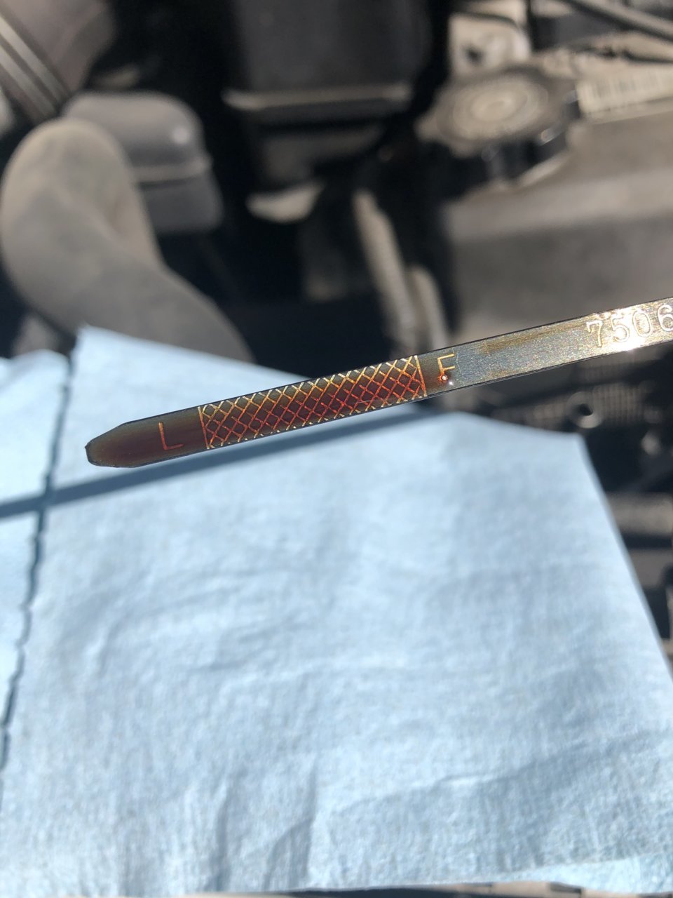

    Yes totally normal! Modern oil and its additives have gotten so good that it keeps the inside of engines incredibly clean. It’s actually good if the oil looks dirty right away, means everything is working. I won’t go into the science of oils but using high quality oil that’s the CORRECT spec and doing oil services between 5-7.5k on most cars is important.

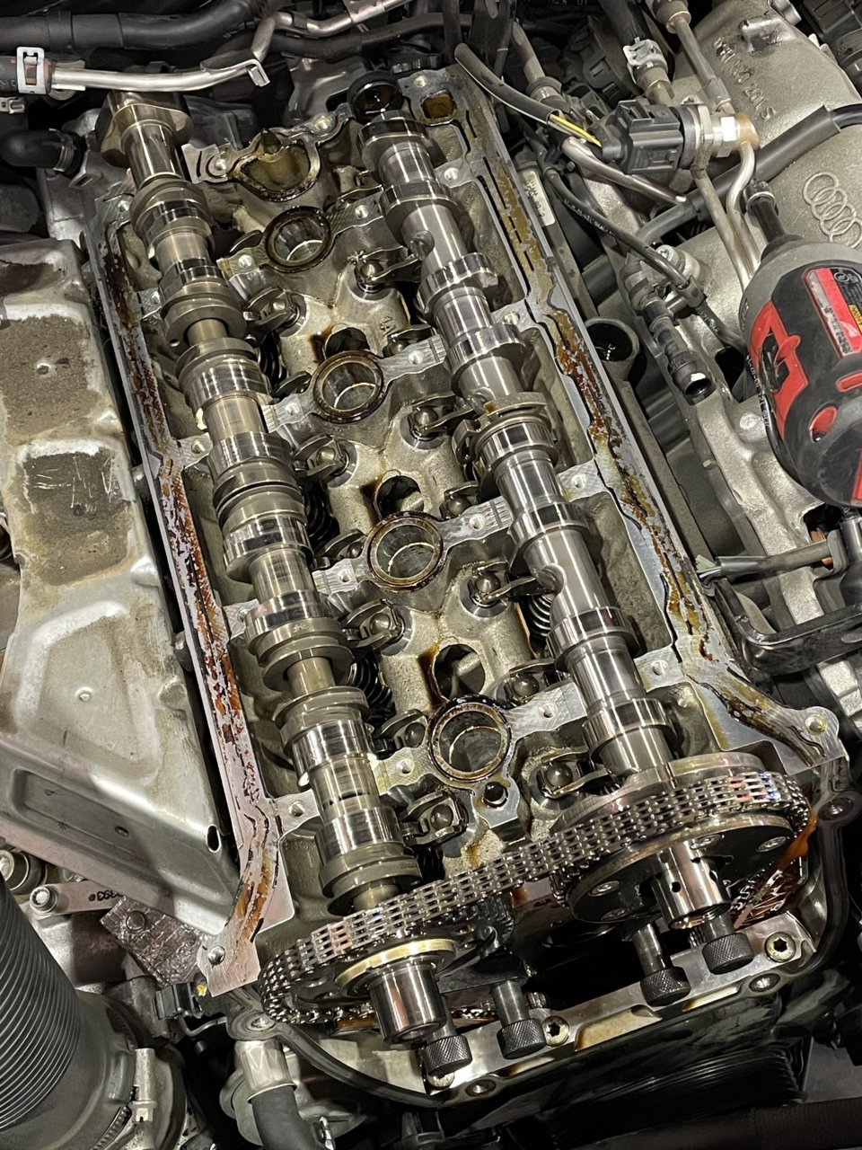

    You can see puddles of “dirty” oil sitting in there and that car had about 60k on it. The inside still looks new! Pretty much every engine I take apart is that clean. Oil is amazing stuff! I will note the reason for frequent oil changes is to help save variable valve timing components, oil seals, maintain PCV systems and prevent excessive carbon build up. I know a lot of people will disagree with me but what do I know, I literally deal with this stuff everyday.

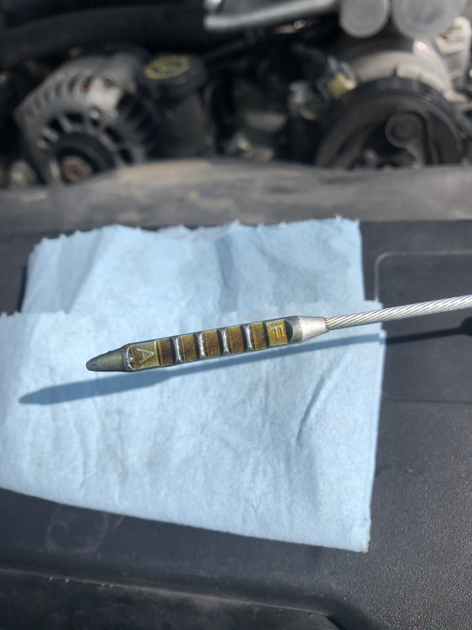

    Biggest difference is probably that your engine has a crankcase breather filter and my year duramax just has open crankcase ventilation. A little bit of blowby is normal which is why all engines require some form of crankcase ventilation. If that blowby is filtered, more of the miniscule particles of sooty oil are separated from the combustion gases and go back into the crankcase. But it's truly nothing to worry about. I am an industrial diesel mechanic and we rely on oil samples, not color, to tell us the true condition of the oil.

    I've never cared about diesel pickups before but this one fell into my lap. I have several coworkers who are really into the 2001-2007 duramaxes. Theirs are the same way, it takes a long time for the oil to get dark. Our running hypothesis is that it's because they are on a short list of diesel engines made with modern common rail fuel injection but very little emissions equipment. 2001-2004 didn't even have EGR.
