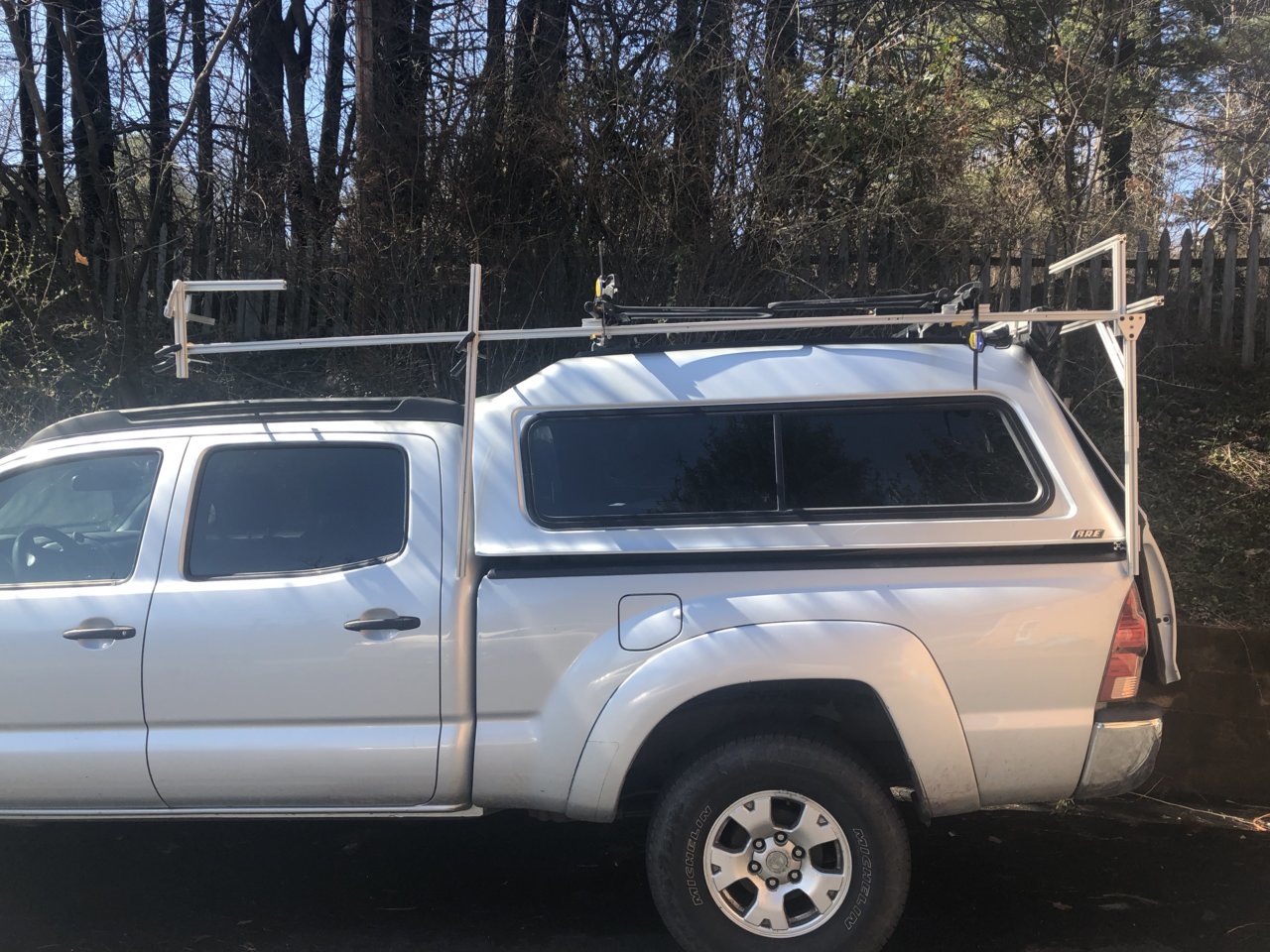

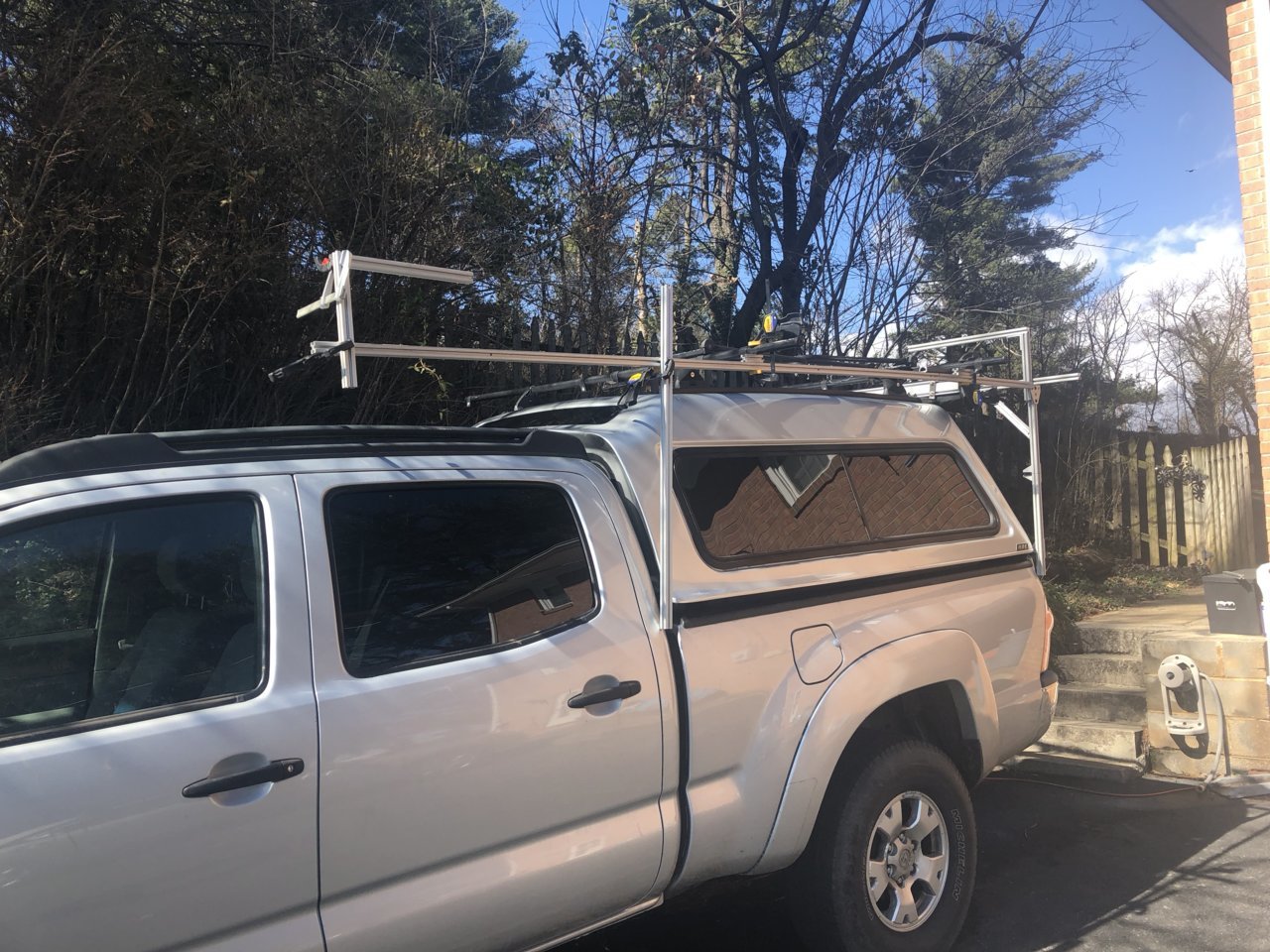

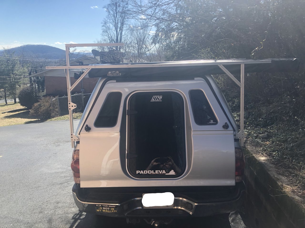

    I found this pics yesterday and sometimes "seeing it" is better. This is a mock up of the exterior of the wedge camper i designed in cad before finding the alucab -obviously i was impressed with alucab since most of the exterior measurments were within an 1" or 2". The 80/20 represents the size of the canopy camper relative to an ARE MX shell. IMG_1431.jpg IMG_1432.jpg IMG_1433_LI.jpg

    I love this idea. I have been trying to figure out an easy way to get my Kayaks up on my canopy camper. My kayaks are a 17 foot and 15 foot sea kayaks so opening the top may still be a problem

    I bet it would still work- the pink/purple boat on m truck is a little over 9 feet but if ou notice the angle - i dont think the tent open has a steep enough angle to let you boat hit.

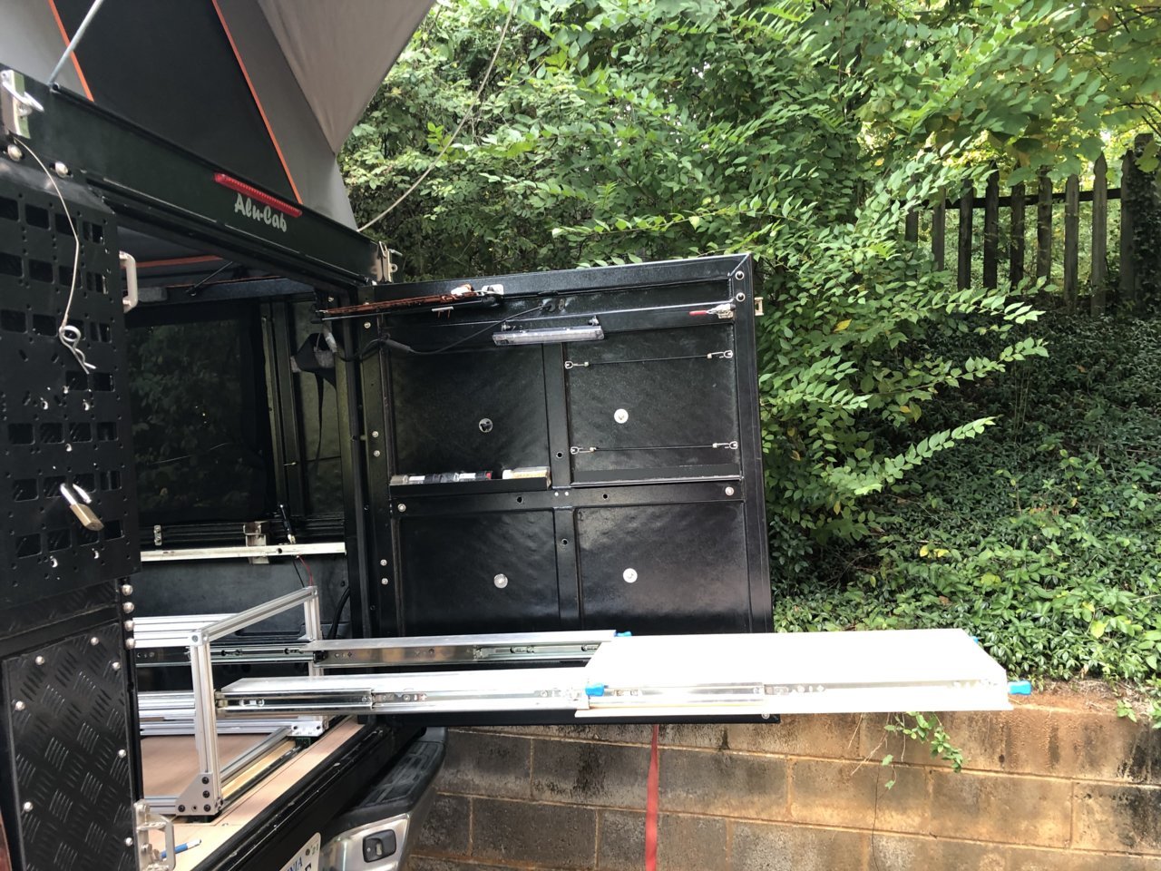

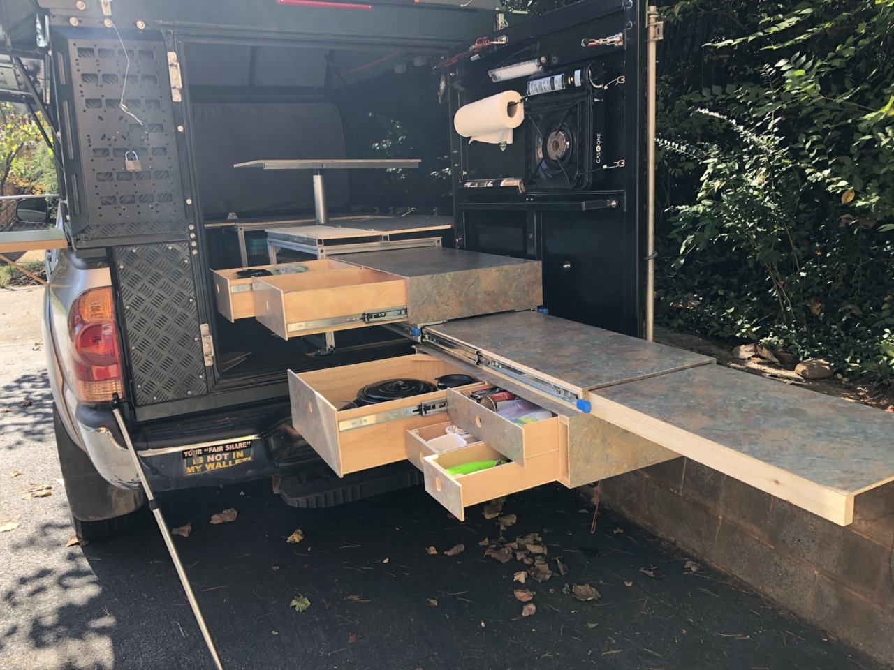

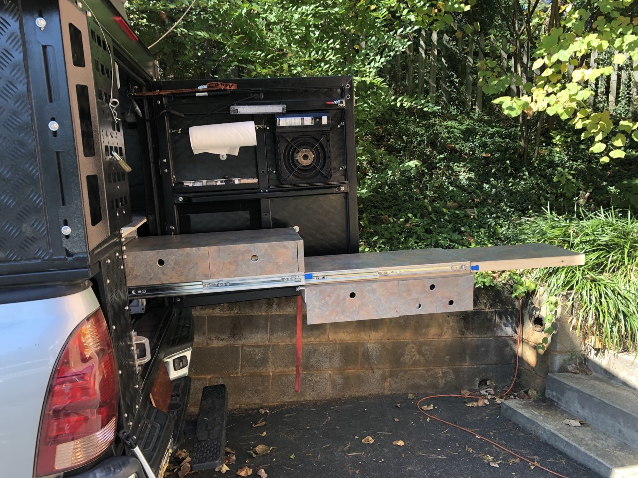

    A little sneak peek of my soon to be completed pull out kitchenIMG_1962.jpg IMG_1959.jpg IMG_1961.jpg IMG_1962.jpg IMG_1959.jpg IMG_1961.jpg

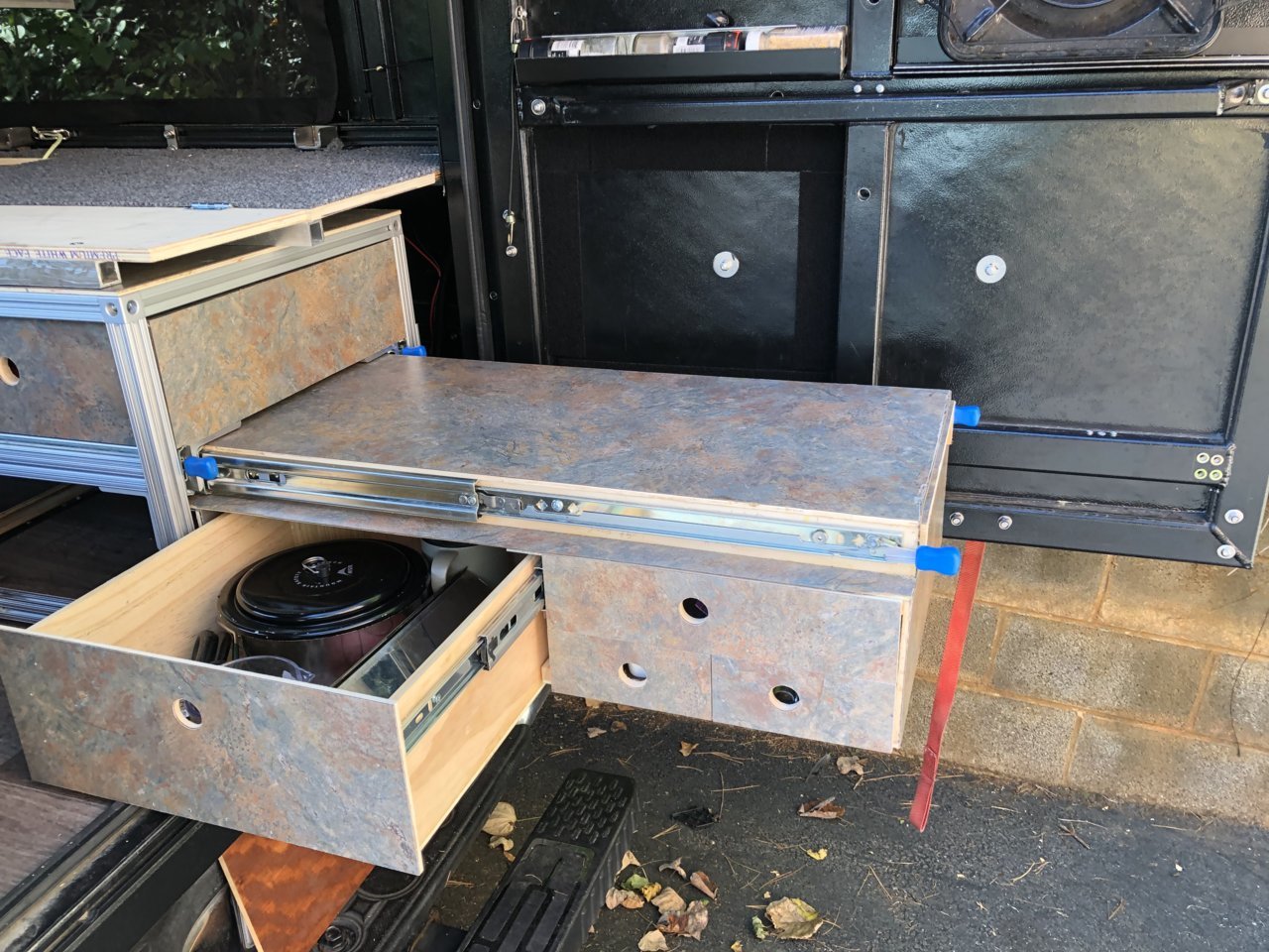

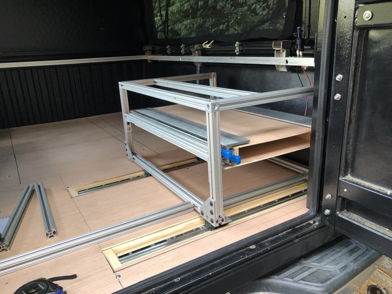

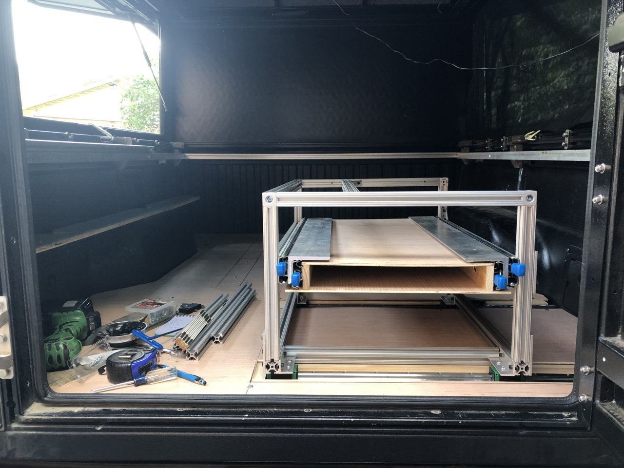

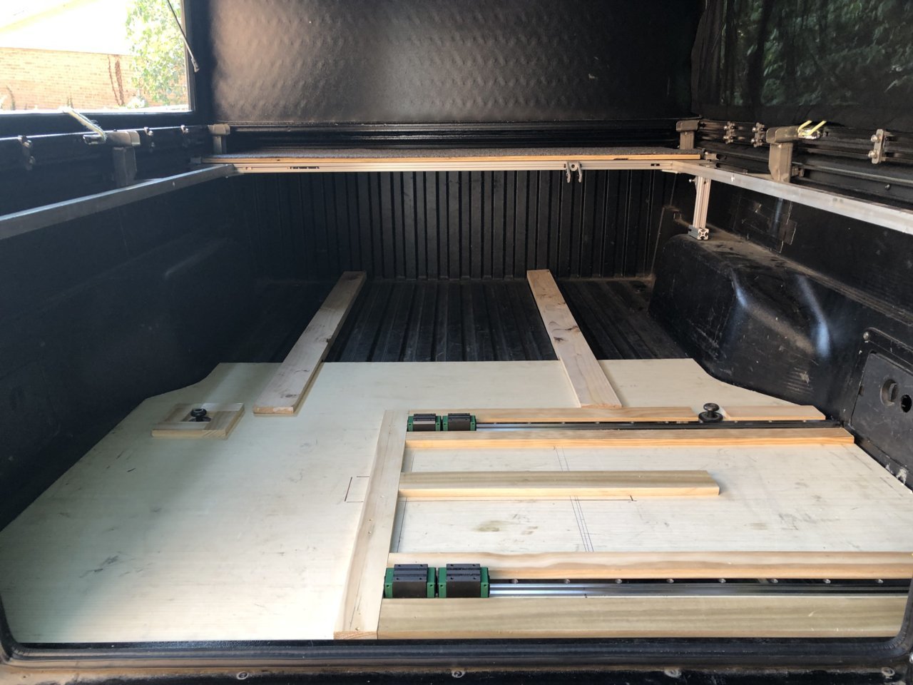

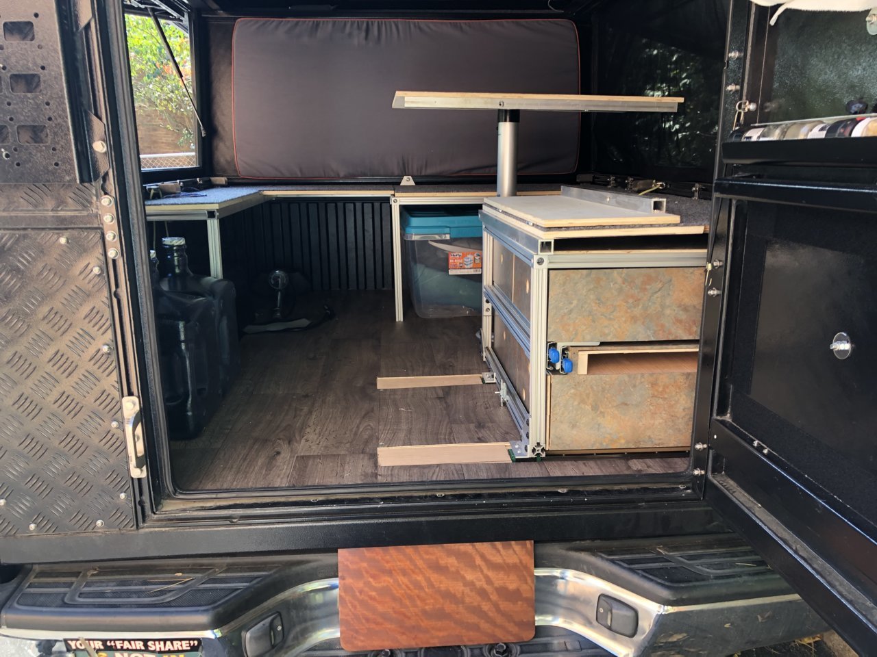

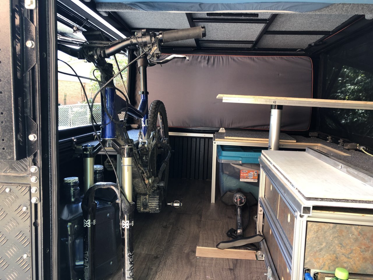

    1. IMG_2005.jpg Well here are a couple of shots from build to finished with the kitchn as well as the convertable table that drops down to give me a lower bed that is 30" wide and 6 ft long. (that way I dont have to sleep with anyone other than my wife up top)

    I will post some pics soon of the back hatch as well- i have removed the pull down rear hatch of the sleeping platform and built a tri folding board that fills the space when closed and then folds to be 8 1/2 inches deep when folded so that i can slide the mattress to it so that i now have access to top AND bottom while not crunching my feet on the roof

    no not an 80/20 vender but i do love the stuff. i have used the extrusions in this build for several older projects that i dismantled, just wish it was a little less expensive (its the same 80/20 you see in the other builds and pics in my thread- i think this will be its final use since i have no long pieces left :))

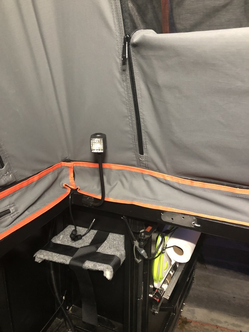

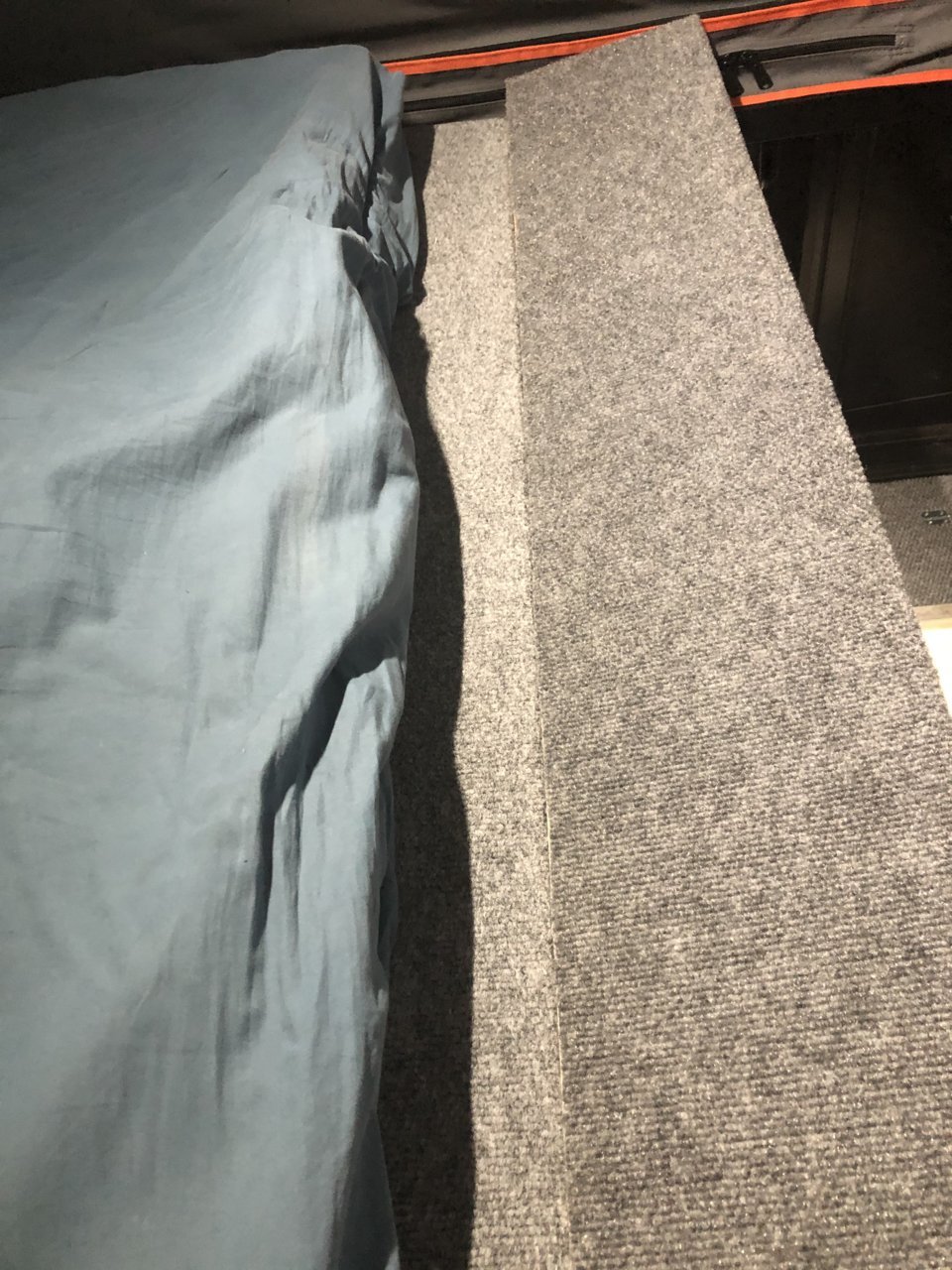

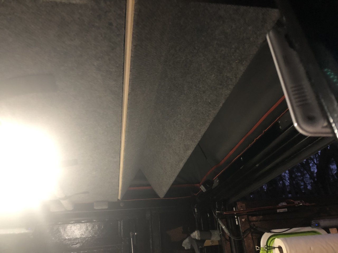

    Well I have come up with solutions to what i consider to be the biggest issues with canopy camper. 1. If you open the back door at night there is not a light you can reach and turn on to see what is inside. And 2. the trap door to the tent area is just a pain in the ass and just not practical in my mind- IF- you want to have a "bedroom" vs a deck to throw a sleeping bag on. Maybe i am unrealistic but i dont want to have to put my water bottle, my cpap, my phone, keys and wallet as well as my cloths up in the bed then climb in close the hatch and have to "place all that stuff" the pockets on the ceiling are okay at best but you cant reach them until up in bed.
    So i removed the rear hatch and that opened up about 6" more space in the opening easier to get in or out of bed but that left the second issue- with no hatch my toes were scrunched in the wedge of the tent and without the hatch when tent was closedall the fabric from the tent hung in the truck bed. My solution a trifold platform with each piece being 8.5" wide and as long as width of camper. so now when it is closed you have it fully open or 25.5" wide and tent is stored safely. Open tent, push up on hinge and the fold now is next to the sleeping platform at same height and allows me to pull the mattress down 8" which mean i now have space for m feet, i have a "table with light for my stuff" and i can get in and out without have to be a contorsionist. hopefully the pics help

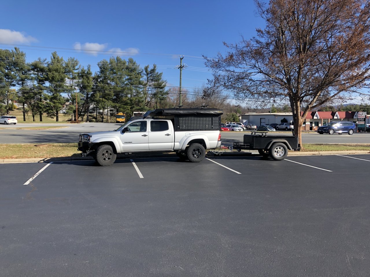

    Just liked this picture and thought i would share- i built the trailer a few yrs ago. and the first time i have pulkled it with the canopy on it. love the rear camera for backing up that shorty. truck spare is also the trailer spareIMG_2084.jpg
