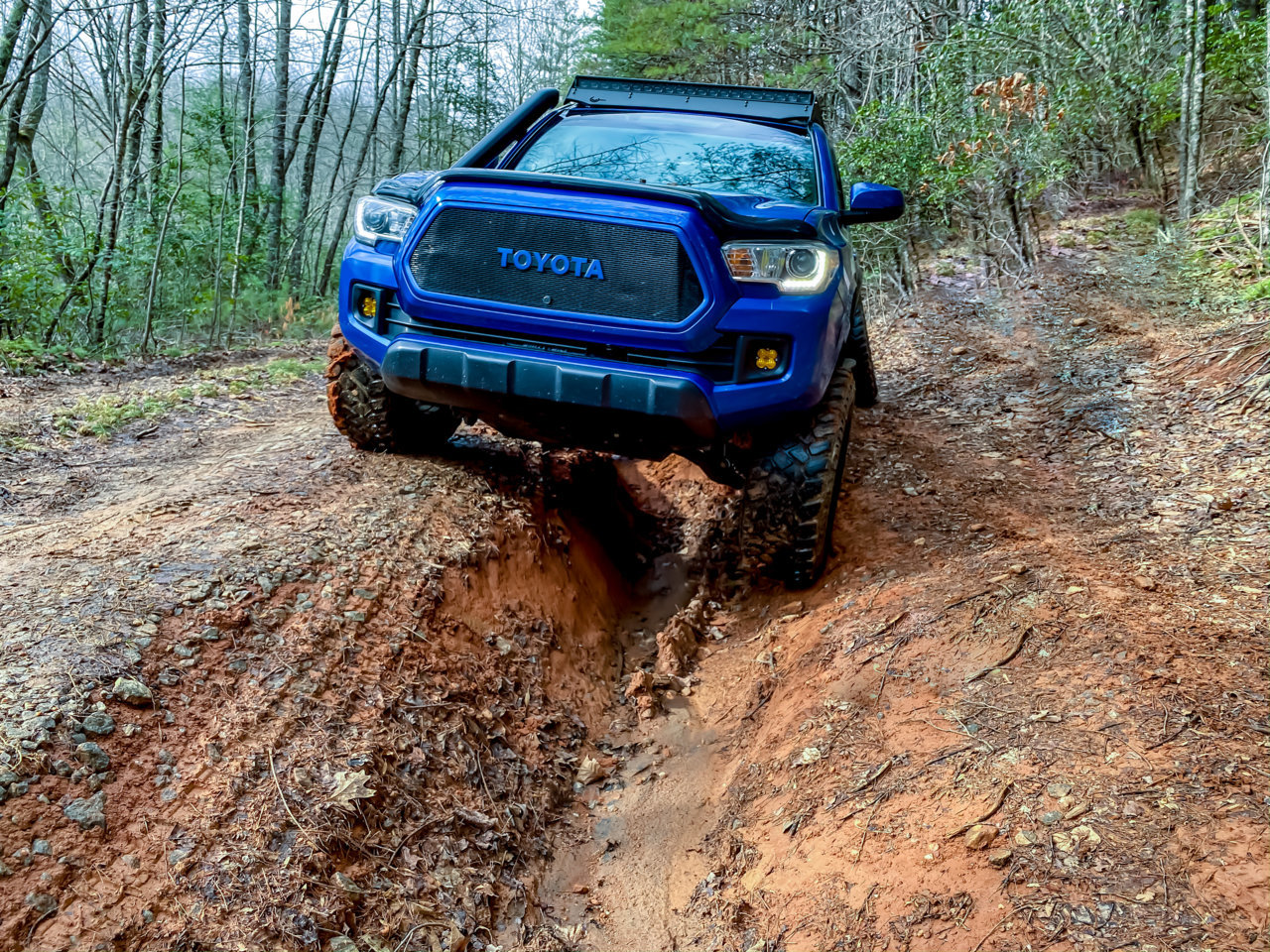

    I had 5100s with 887s with 35s and stock uppers. I have full skids, larger battery, metal snorkel, and sliders. I loved this set up the only reason I changed it out is now I have a C4 overload bumper.

    Nice! Mine sagged tho
