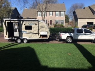

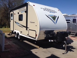

    I read many post on this forum about towing a trailer…the difference of opinion is great. Here is my experience.
    Truck – 2015 Double Cab Tacoma – 67K miles – Auto w/Hankook ATM 265/70 R17
    Trailer - http://www.coachmenrv.com/product-details.aspx?LineID=54&ModelID=3786#Main
    UVW – 3,560
    Two aftermarket coolers – Long Tru-Cool LPD 4454 &Long Tru-Cool LPD 4451 – more on this later
    Mirrors - CIPA 11960 Premium Universal Towing Mirror (Black)
    Transmission Temp – Ultra Gauge - Converter
    Rear Spring Support – http://timbren.com/blog/products-page/tortun4/
    Pro WD with antisway – A must in my opinion.
    I tow in 4.
    I purchased the trailer in Springfield, MO as the price was a couple thousand better than here in Kansas City. I installed the Timbrens and already had the 4454 cooler installed. With just my girlfriend in the truck, I was very happy with how it pulled the trailer back to KC. With a slight tailwind, I was able to drive 70 to 75 without much issue. The next day, we went dry camping. Loaded down my dirt bike and dirt bike gear/gas/tools/water/food/beer/etc (I estimate an additional 1K), I could definitely tell it was loaded down. On the way back into a 20 mph head wind up a long grade hill by the race track, I saw the highest trans temp I have seen at 215. This was on a 70 degree day. After that, I was a little worried about taking the combination out to Colorado and ordered/installed the 4451 trans cooler and installed it in a series. I also read a tip on letting the engine do the work and manually down shifting into 3 and 2 if necessary as it would help keep the tranny temps down. This tip really works and now wondering if the 4451 is overkill.
    We went to Pomme de Terre this weekend in central MO about 2.5 hrs away. No bike or water but with typical gear. I never got above 215 and it is “easy” to manually drop a gear and let off the gas slightly to halt the temperature climb at the converter. It was 85 outside on the way down. Most of the time the temp was at or below 185. On the way back, I had a 3 to 6 MPH tailwind and was able to do 70 to 75 less shifting…I passed more people than the number of people that passed me. Never got above 200 on the way back it was cool this morning in the 60’s. Engine temp both ways is hotter than normal, I attribute that to running in 4 and getting 7.5 MPG….burning a lot of fuel.
    My thoughts. The Tacoma did much better than I thought it would after reading all the threads. Brake Controller takes care of the braking. Let the engine work and you will be fine.
    What I didn’t like. On the way to Pomme de Terre, I took the back roads to avoid rush hour traffic. Being on twisty narrow hilly roads that are not in the best shape with no shoulder to speak of sucks with the trailer behind. Note to self, I will either take the main roads by leaving earlier or deal with traffic. I did not save time and the drive down was more stressful than the ride back.
    Product Reviews
    Trans cooler works better than stock. I saw a 20 degree drop with my dirt bike in the bed on the long hill by the race track. The second cooler is probably over kill since I learned to let the engine work and manual downshift.
    Timbrens are great with dirtbike in the bed or pulling the trailer. They are a little harsh as my leaf springs are already fatigued and there is almost no gap (recommended is ½” to 1 ½”). It handles better with no load; but, ride quality suffers on roads in poor condition. Not many of those were I drive unloaded, so this is no issue for me.
    Mirrors work – you will need to tape the straps together to eliminate the high pitched hum at highway speeds.
    I have minimal towing experience; but, will say the WD hitch is the bomb compared to the time I pulled a trailer (rented without one). That trailer was 500 lbs lighter and didn’t pull nearly as well. I attribute that to the WD.
    I will be headed to Harrison, AR this upcoming week and will get into the Ozarks. Interested to see how she will do. I will not have the dirt bike with me.
    Will post pictures tomorrow.

    Pics
