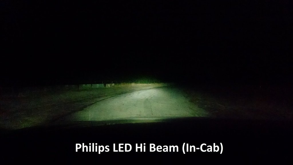

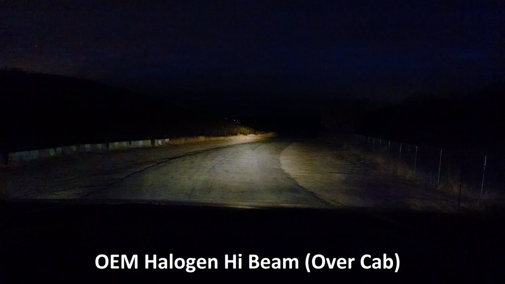

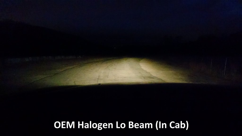

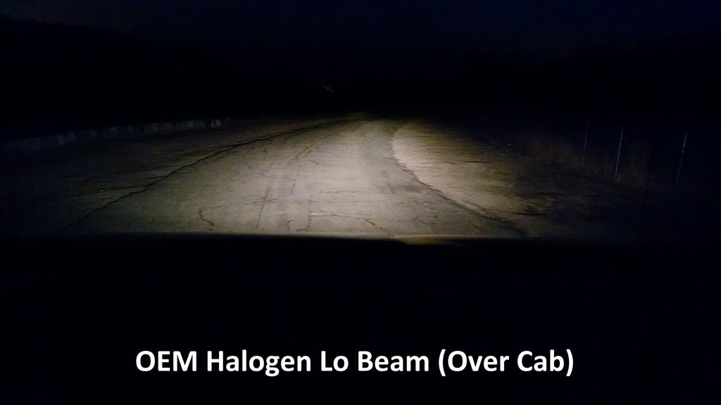

    My truck currently has 100% factory OEM housings and reflectors. I had the headlights replaced by my dealership about a year ago due to the warranty extension caused by melting/bubbling lenses on the DTRL’s. The installation of the Philips LED H4 bulbs did lead me to discover my passenger side lamp is severely mis-aimed, however, I made no adjustments to it during the course of my review to maintain the integrity of my light output comparison shots. (Which drove me crazy!)
    Install

    This is a big section for me, due to the fact that if the Philips LEDS failed to maintain factory beam pattern/cutoff, or produced glare which blinded oncoming traffic, it would be a deal breaker for me and they would be removed from my vehicle.
    I have happy to report I found Philips claim of maintaining factory beam pattern/cutoff to be accurate. I have been running them for nearly a month, and have not been flashed or had any negative reactions from drivers around me. I have also driven behind my wife when she was is in her Camry (which sits lower than my truck) and she had no complaints regarding the lights being blinding, causing glare, etc. I have also noticed as I drive through dips/gutters, in the distance, I can clearly see a sharp, distinct cutoff line produced with these bulbs. Unfortunately, I was unable to capture this in a photo.
    To be honest, I did however initially struggle with the splotchiness off the LEDS, especially up near the truck at the bottom of the beam pattern. In my research I found that this splotchiness is caused by having multiple diodes producing the light, rather than one long filament like the OEM Halogen use. I will say, I only really noticed this for the first night, while parked stationary in my driveway. It no longer bothers me, nor do I really even notice it when driving down the road. In fairness, I cannot say whether or not this splotchiness was present with the stock Halogens and I just didn’t notice it due to always running my fogs and the fact that the halogen output was significantly less than LED and as such the LED exaggerated it due to the increased output.

    Now for what everyone wants to see….
    The comparison shots…
    For some reason, my camera picked up a significant green hue when taking pictures through the windshield, for this reason I also have included photos taken from the bed of the truck over the cab, IMO these photos provide the most accurate rendering of the light output and color of each bulb. I have some beam pattern comparison pics on a block wall that for some reason did not make it onto my computer. I will upload them and add them later.
    Lo’s
    OEM%20Halogen%20Lo%20Over-Cab_zpsmtciuc2_59176a2fce8855f5f4c3ee59f7014766c71d0427.jpg
    Philips%20LED%20Lo%20Over-Cab_zpsoktwilj_08b50f8d0641c905f8bc0b3b84f6c052613d349c.jpg
    Hi’s
    OEM%20Halogen%20Hi%20In%20Cab_zpsfkas0ik_f93cd3c46a76ec1b16ed38b66a1b37a7ec47c883.jpg
    OEM%20Halogen%20Hi%20Over%20Cab_zpsb3uel_aeff4d7950367b946a1a42c265dc9a5302e6a055.jpg
    Philips%20LED%20Hi%20Over-Cab_zpshdokpga_b026314e9d7450ad2b663c7b5b3b94503c9d97ea.jpg
