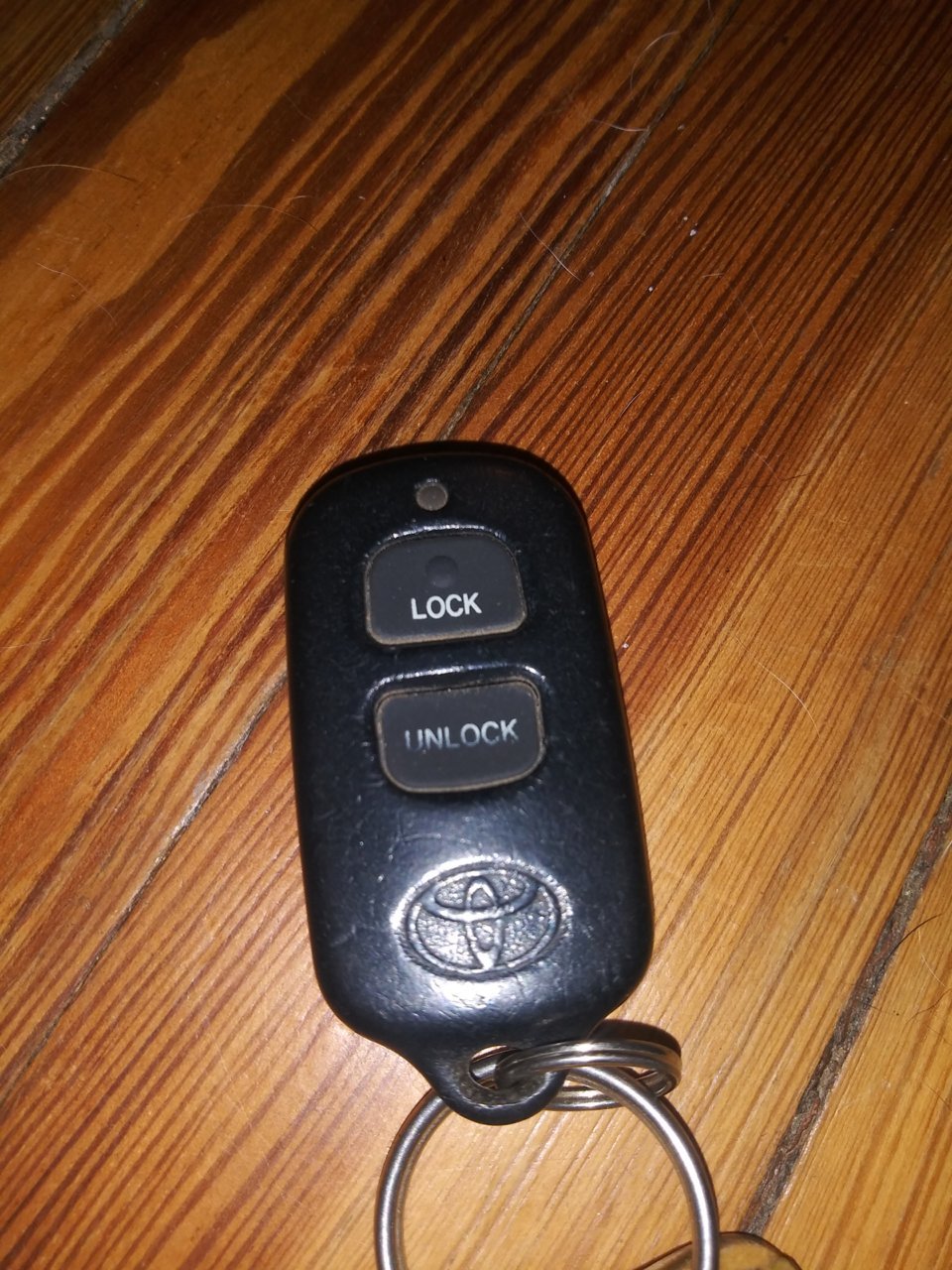

    I never looked for the RS3200 on mine... I figured its SR5 & TRD and it has power locks so it probably has keyless entry ability. First I got a different egg shaped fob at a parts yard, it was the wrong one. Then I ordered the one pictured on ebay (used) for fairly cheap. I just got lucky it worked. Then, one fine day... I met a cute highlander girl at the liquor store and I gave her the ovary shaped highlander/sienna fob. I gave her my number and she called me to come over and program it for her. Hers worked too! The rest is history, were now common law husband & wife. Damn she drinks alot though.

    lmao thanks for the advice! i’m gonna order the square one
