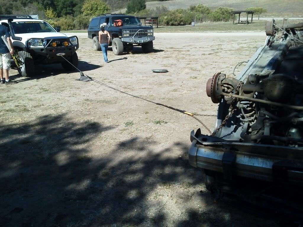

    I recently was a instructor at remote rescue class at the Overland Rally in Hollister CA and used it to roll and right this Jeep and it worked flawlessly!

    He's going to feel that in the morning.
    Nice work on both your rigs.

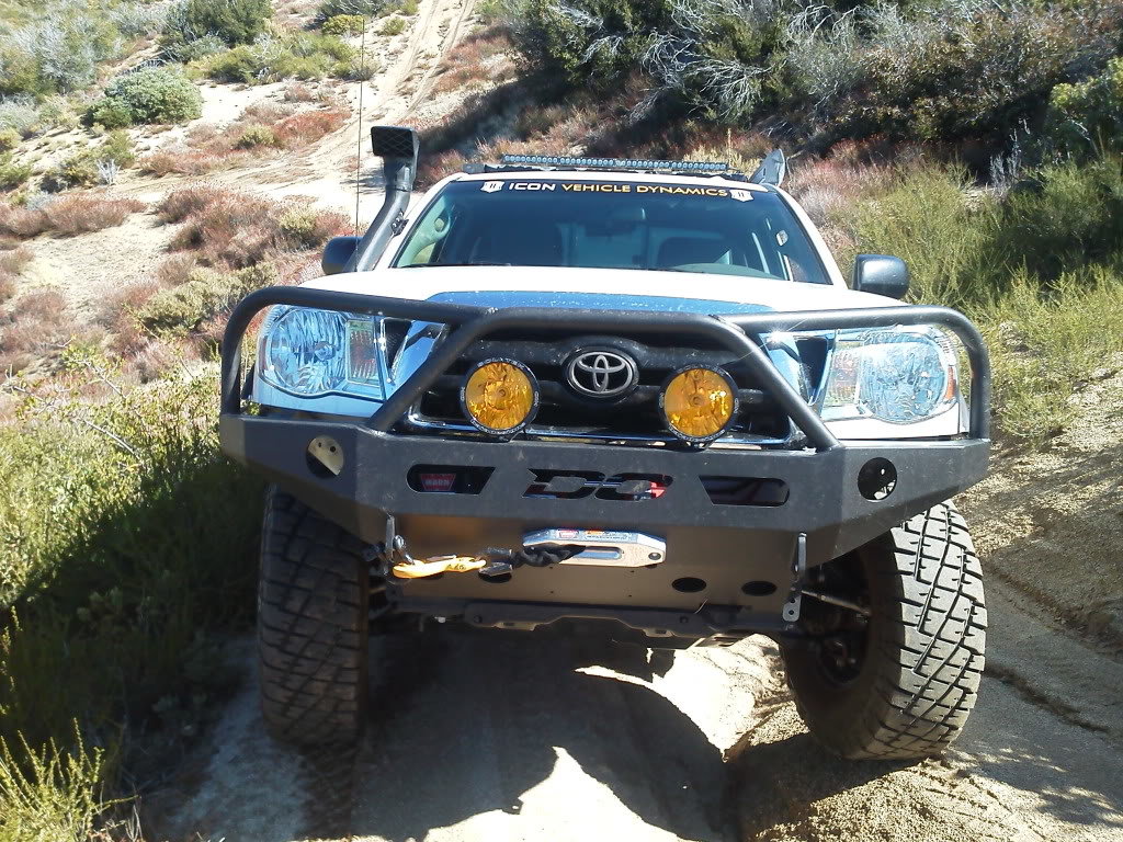

    I forgot to post the new pictures of the Demello 3 hoop.
    One shot of the Warn 9.0rc after we winched over a wrecked Jeep in a remote rescue class at Overland Rally Hollister.
