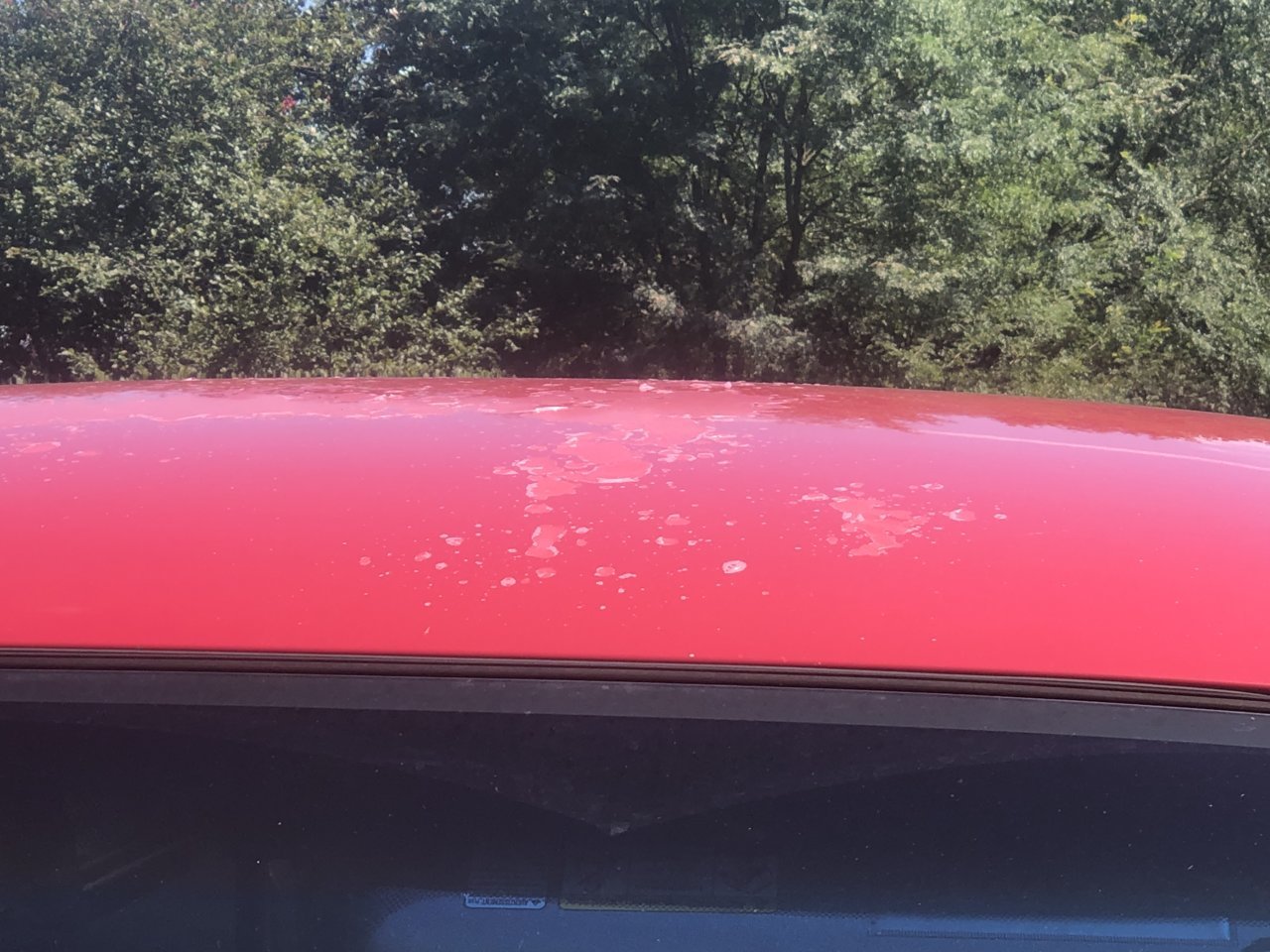

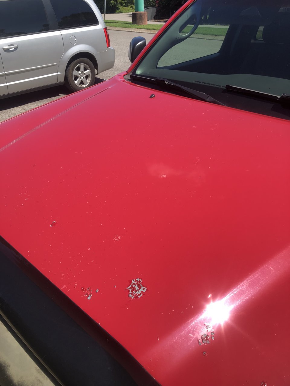

    Need suggestions
    I don’t mind it getting that rustic look, but I don’t want it to rust. Should I wrap it, never really considered it. Or maybe there’s some sort of long lasting wax? Bros my taco needs ur help

    Wraps do virtually nothing to prevent or stop rust. (They do cover it up though.) No "wax" is going to prevent / slow down rust either. The only way to stop rust is to remove it - mechanically (sanding, blasting, etc.) or chemically. Then you need to properly prime, seal and paint the bare metal surface to prevent rust from starting all over again. Sorry, but once rust starts, there are no simple options to stop it. Unfortunately, the best way to avoid this kind of trouble is not to let rust get started in the first place.

    Let it rust (patina) to your liking then clear coat it. People pay Gas Monkey Garage top dollar for that look.

    I'm in the same boat. After 16 years my clear coat on my hood and roof finally gave up. Was thinking of wrapping the roof and hood before the paint started peeling and chipping off too. I don't mind the rustic or even 2-tone look. Just don't want rust.

    When it loses its clear coat, next is the paint, next it will rust. Recognize the warning signs.

    I’d wet sand the bad spots and spry it with rattle can clear coat.
    Professional result? Hell no.
    But it should work, and it’s cheap.
    Of course this coming from someone who could care less about looks.

    Southern truck, no rust just want to prevent it with out repainting
  15. Aug 12, 2022 at 11:19 AM
    WPDAWG11
    WPDAWG11 [OP] Well-Known Member
    Mar 22, 2013
    #100311
    352
    Murfreesboro
    2005 4x4 5spd 4cyl
    Need suggestions
    Red imma post a photo when I get off work. Thanks for all the tips guys

    No rust Yet . Forget about the poppy patina . Definitely should do something now . Wrap or paint will need to sand down strip down . At very least polish regularly.
