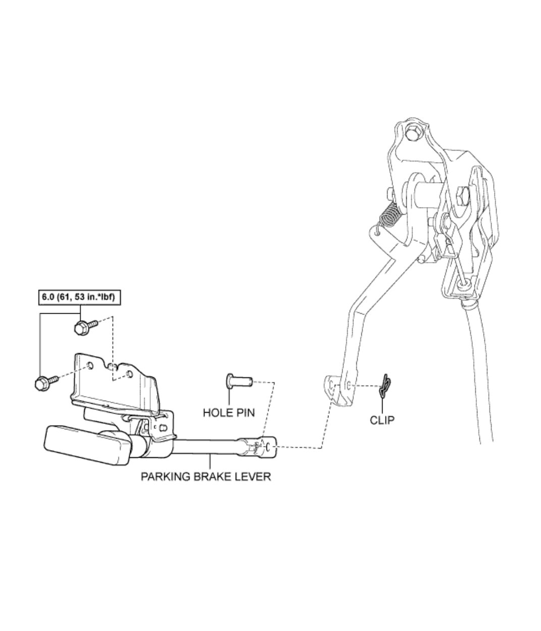

    You cab peak under the dash and see if the lever is retracting fully.
    But I don't think that's your issue. You have multiple springs releasing the parking brake.
    2 in the drums, and 1 under the dash.
    I'd bet the cables are cracked and broken and preventing the cable from releasing all the way.
    Rocking the truck back and forth helps wiggle the cable "in place" enough to release it.
    Check and see if the cable is broken where it goes in at the backing plate of the rear drum.
    This probably isn't your issue, but you can take a peak. If this was you issue you'd have to press the handle in yourself.
    But it gives you an idea of how it works.
