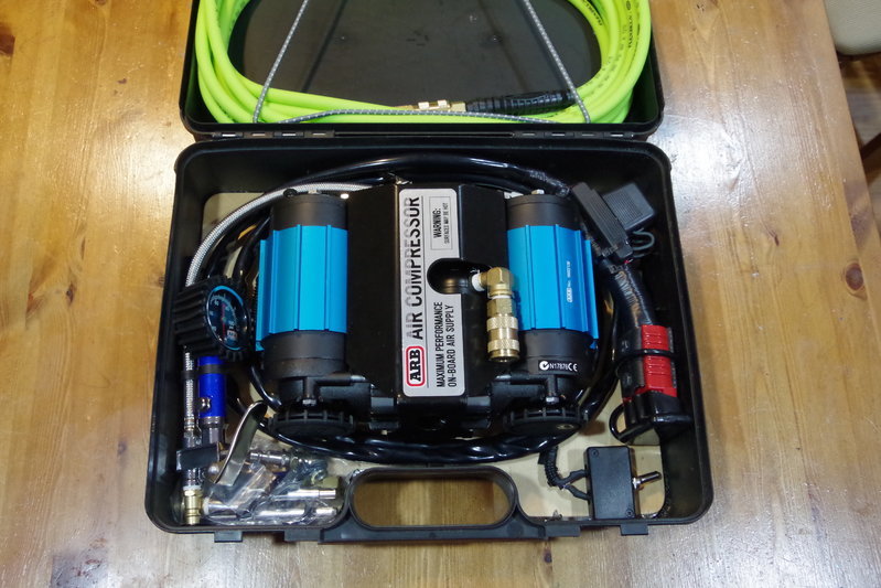

    Had to retire my old portable air compressor. It was one of those battery jump start/ air compressor combos. It was over 14 years old and has served me well. But it was slowwwwww!
    Here's my criteria for compressed air:
    1. Needs to be portable so I can transfer between vehicles.
    2. Needs to be fast.
    3. Needs to be reliable.
    Here's what I came up with:

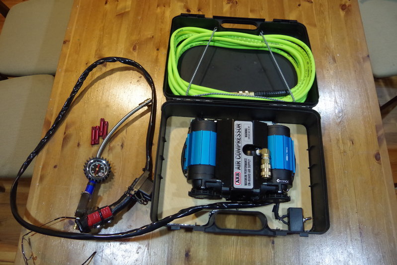

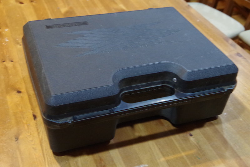

    Old hand gun case
    ARB CKMTA12 mounted onto 1/4" plywood fitted inside the case. Underneath plywood is a layer of thin foam to deal with vibration.
    Used the provided ARB power harness. Added Anderson 175 Quick Connects. 1/4" Flexilla Air Hose fits nicely inside top of pistol case. Left side shows ARB inflator and Trailhead deflators preset to 18 PSI

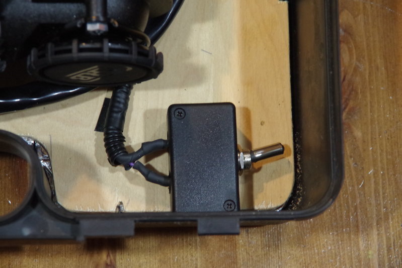

    On/Off toggle switch mounted onto plywood base.

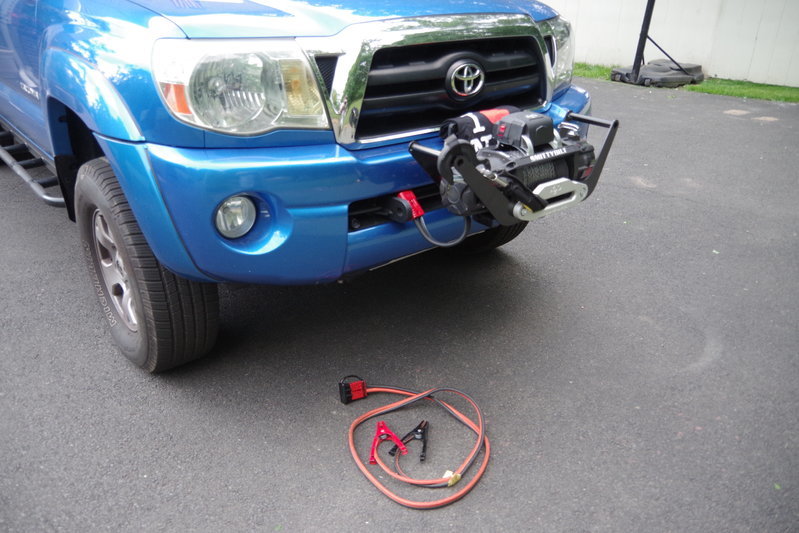

    I can quick connect to the Warn type "(Anderson") power cables that also provide power to portable winch and a bonus jumper cable. Same power connection is available at the rear of truck.IMGP6217.jpg
    This thing is FAST, FAST, FAST and extremely QUIET!
    MANY THANKS to @Crom for most of the ideas and for helping sort out the wiring for this beast.

    What routes did you use to wire the 0 gauge cables to the back connector?
