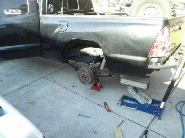

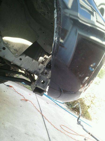

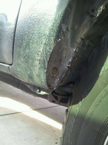

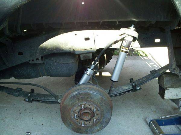

    Saturday the 14th I installed my rear racerunner v2. 0 icon MT Struts. We also cut the fender/bumper and smashed over the pinch weld to eliminate all rubbing. I also set my shocks at 2.125" of thread.
    I also removed my sway bar and I am very happy.

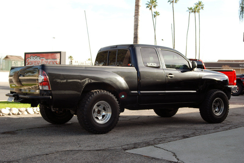

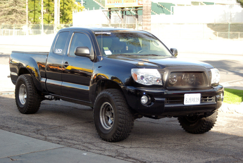

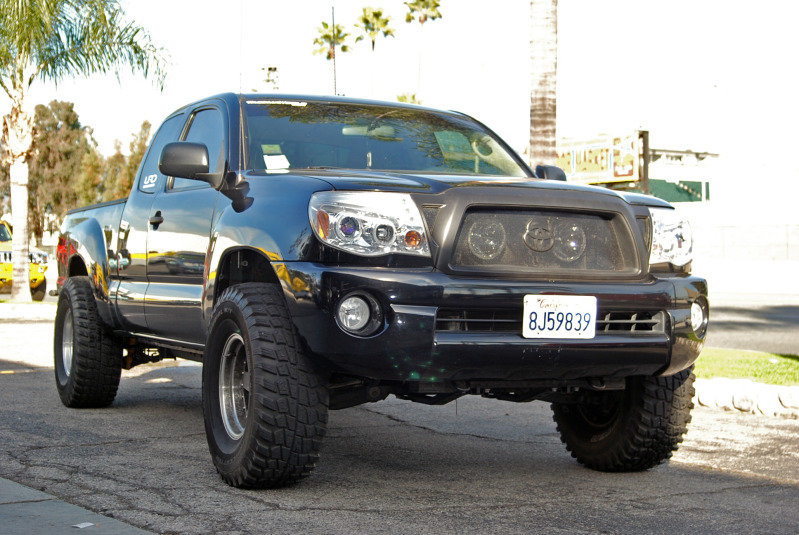

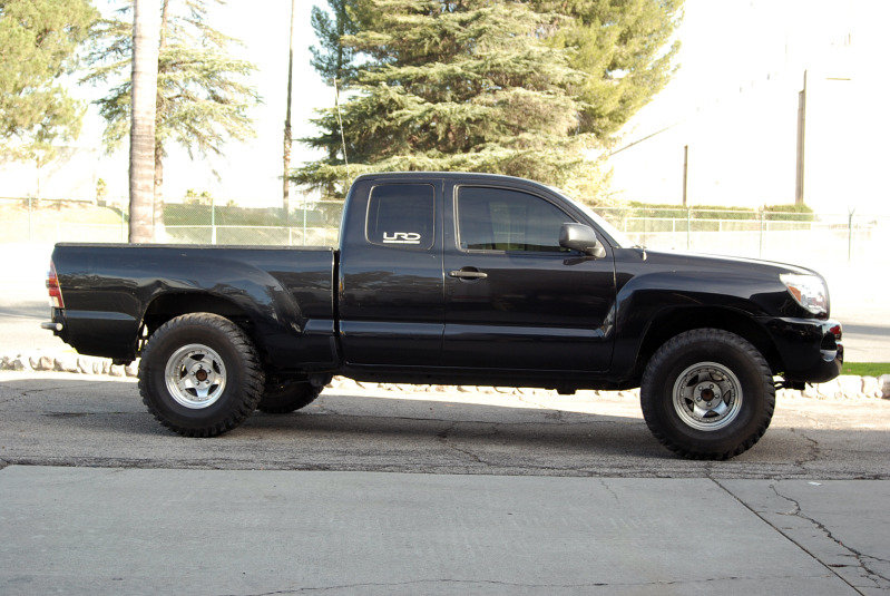

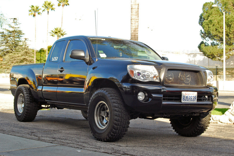

    Casey at SocalSuperTrucks sent me the photos they took of my truck today (before installing the MetealMiller Spare Tire Holder.

    nope thats why i showed the bumper and fender picture. i cut the bumper and fender. no rubbing at all

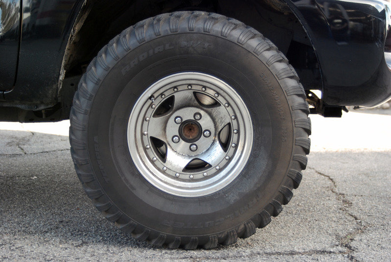

    Man that rear bumper and the missing center caps on the wheels makes the stance of that truck 10X better!
    What are the wheel specs? 15X8? Offset?

    15x8 3.75" BS -24 mm offset... I had to grind to make them fit (the same thing Total Chaos did on the Long Travel Truck). I have a quick link on the front page.
