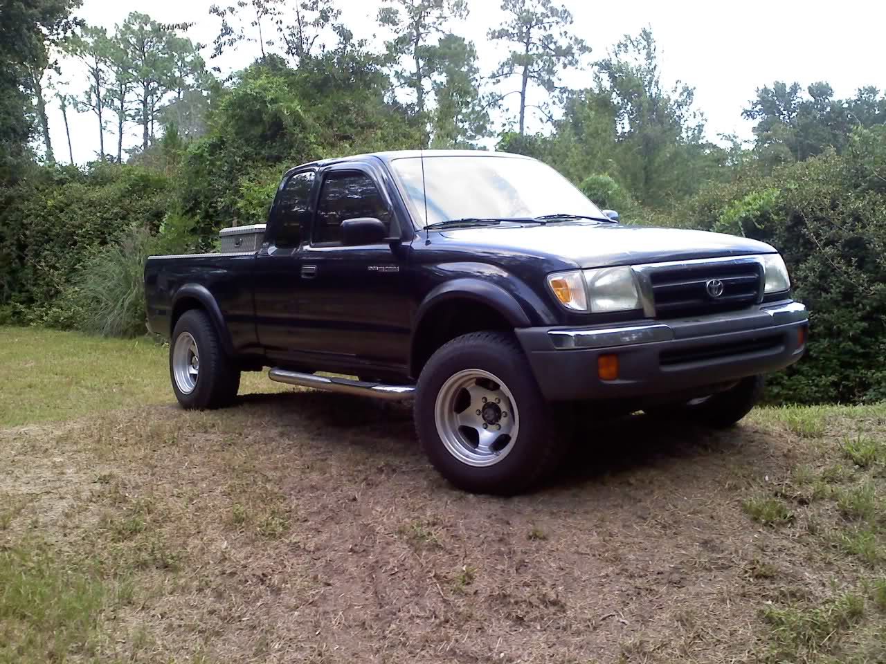

    well gonna start this thread... post a pic tomoro any suggestions on what to do first? i wana put it in the air... go all out... with like 40" ish on it.. what to do first??i know it will take alot.. but where do i start? also want to put like a 350 in it.. ill take any advice i can get!
