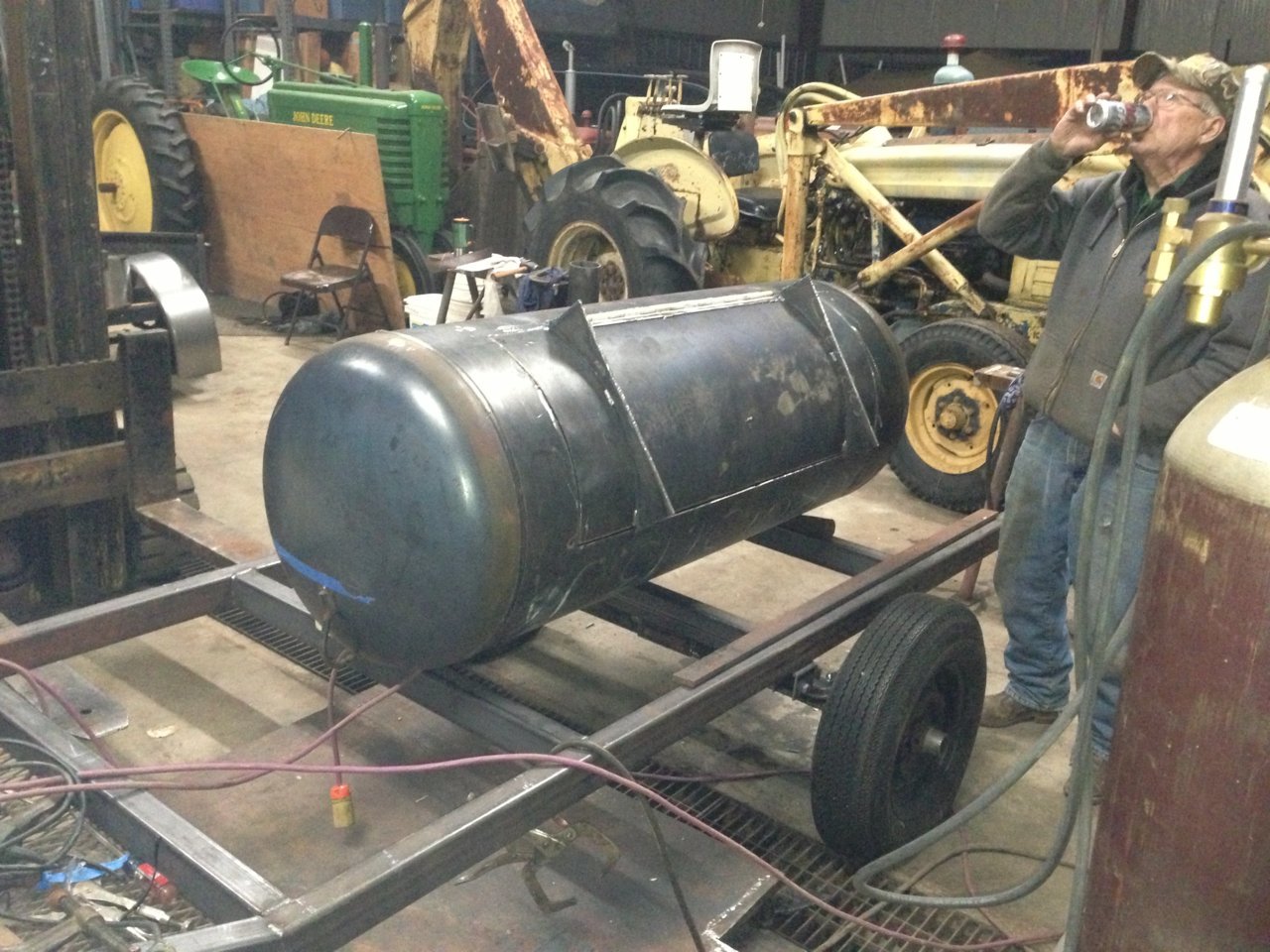

    This build is an older one but it has been a blast. I decided after literally cooking everything in the world on a charcoal weber, I needed something more... A buddy scored me a 120 gallon propane tank. This simple kind gesture sparked the BBQ revolution!IMG_0111.jpgIMG_0114.jpg

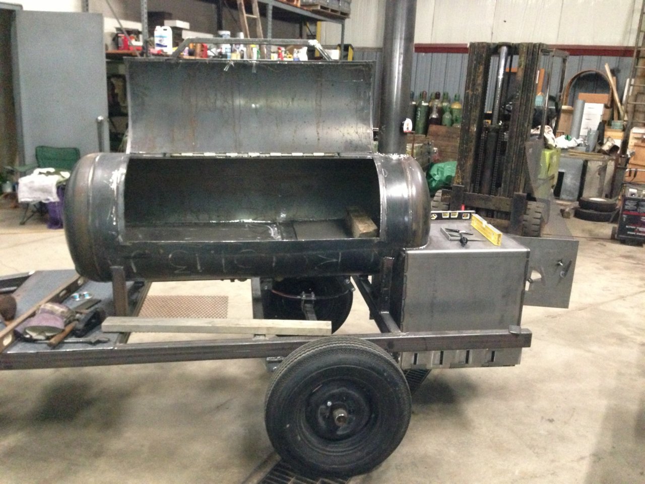

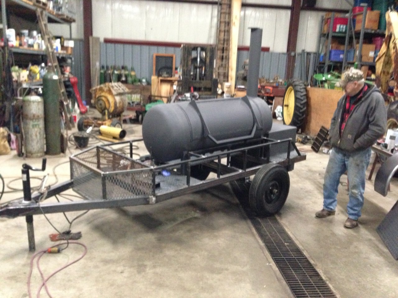

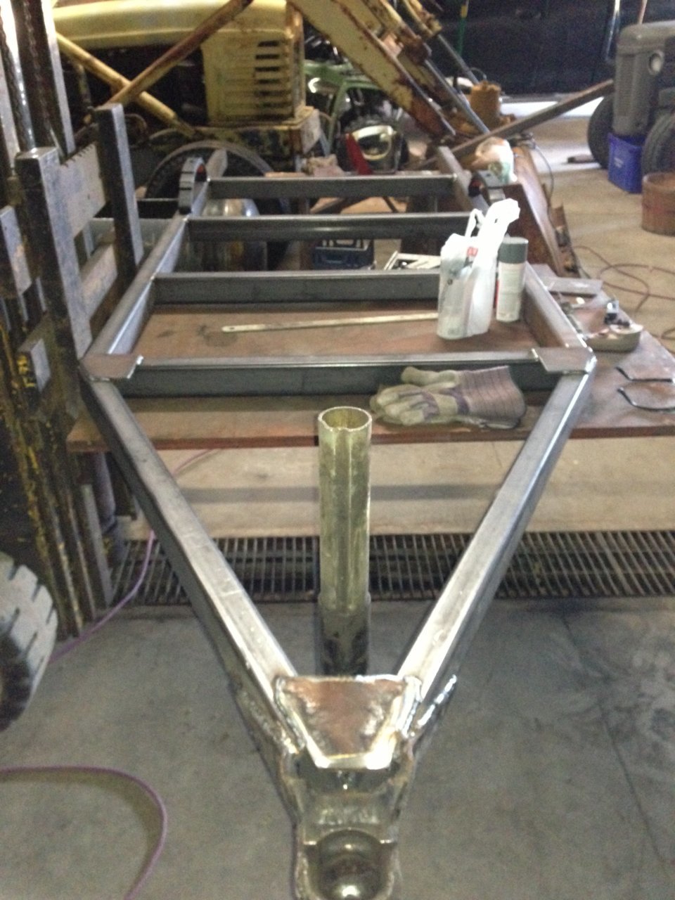

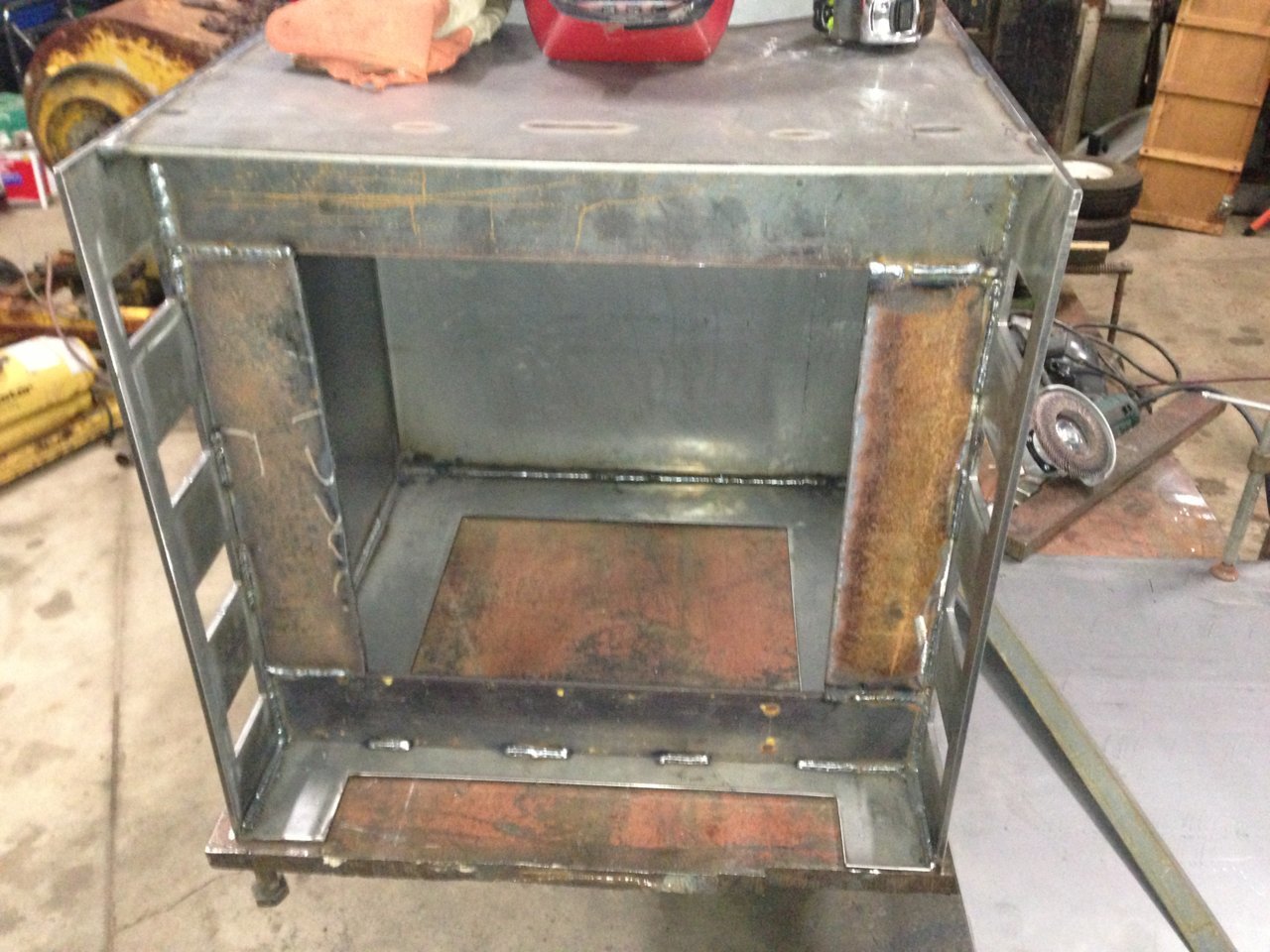

    Little bit of fab work, welding and beer...

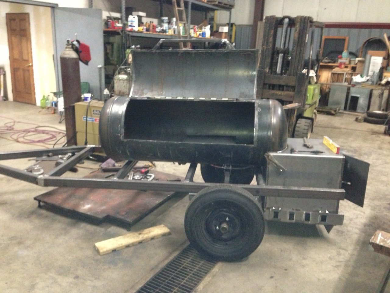

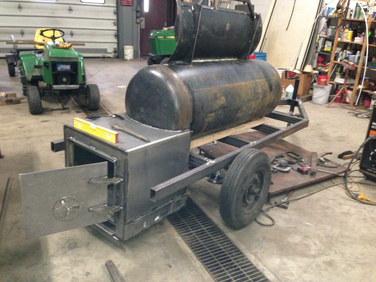

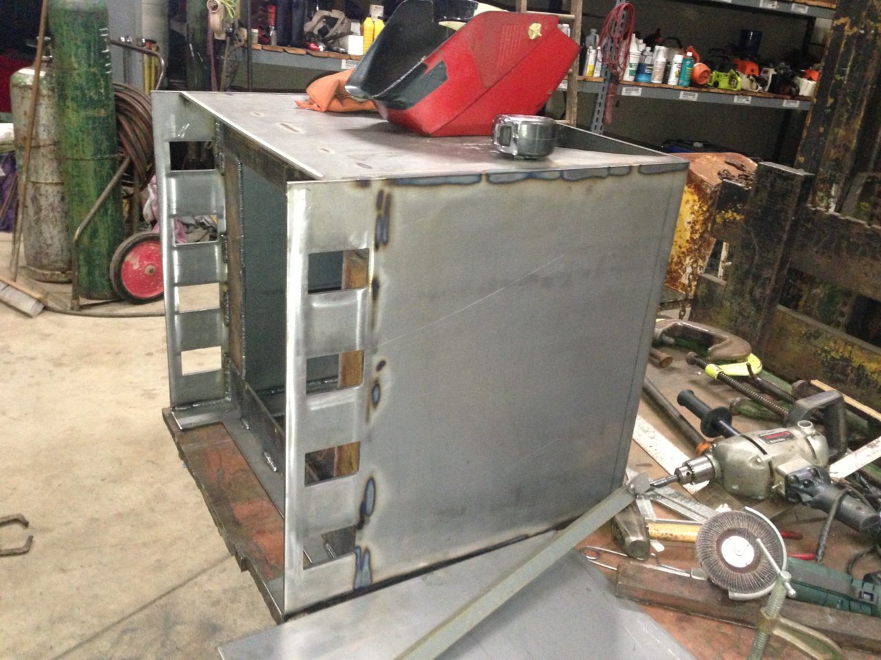

    More welding, more beer

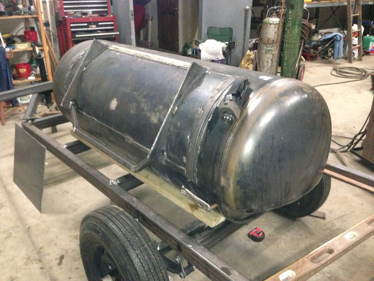

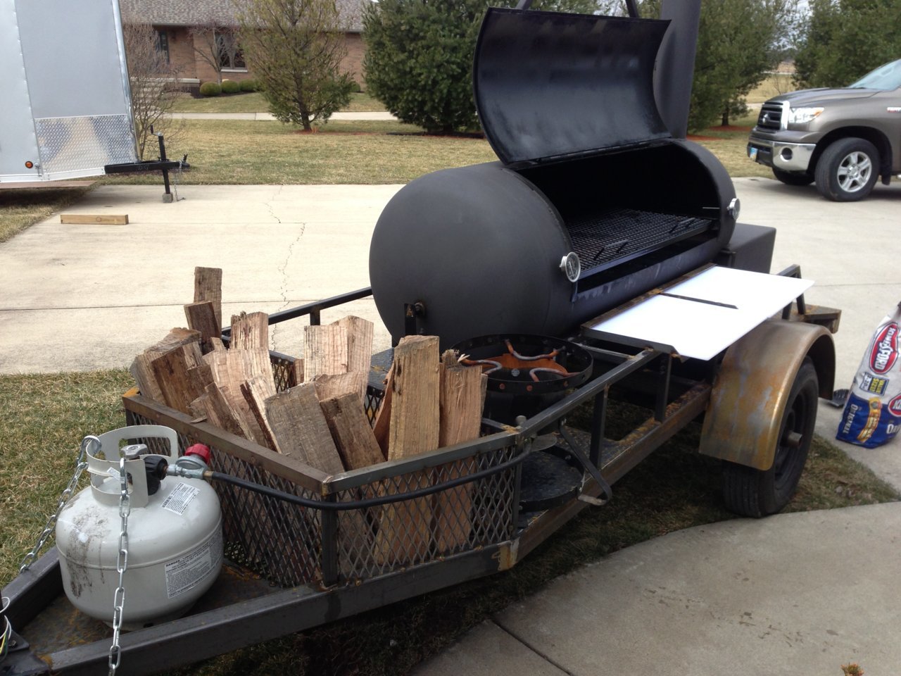

    More fun...

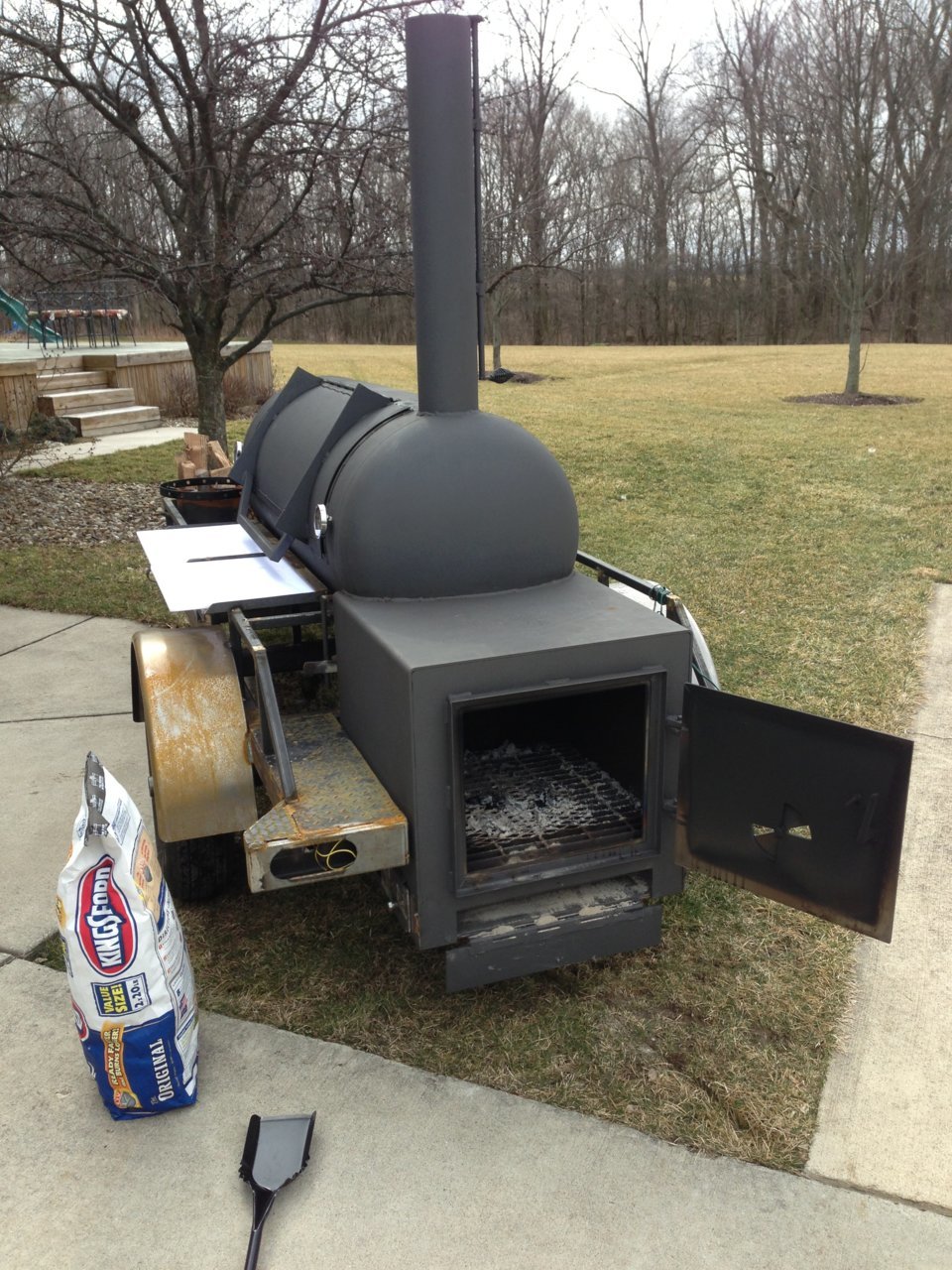

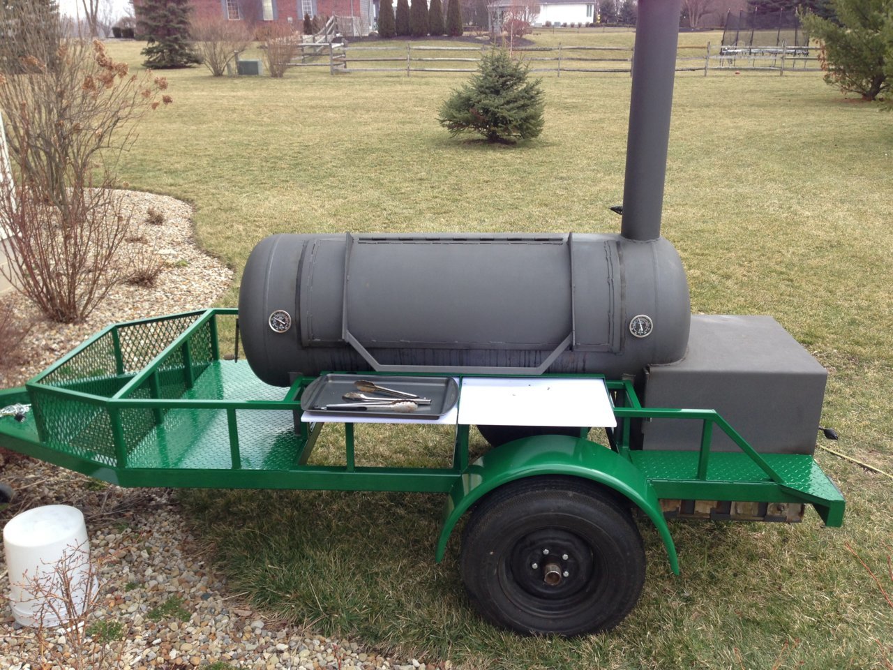

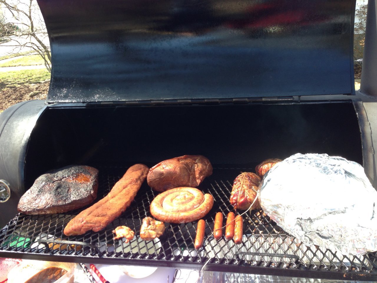

    Yes it actually burns!

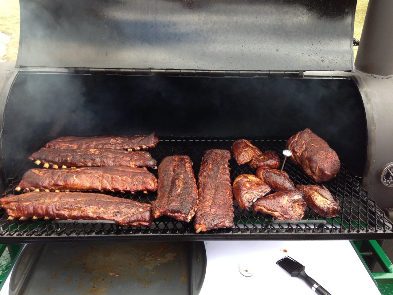

    A little product.

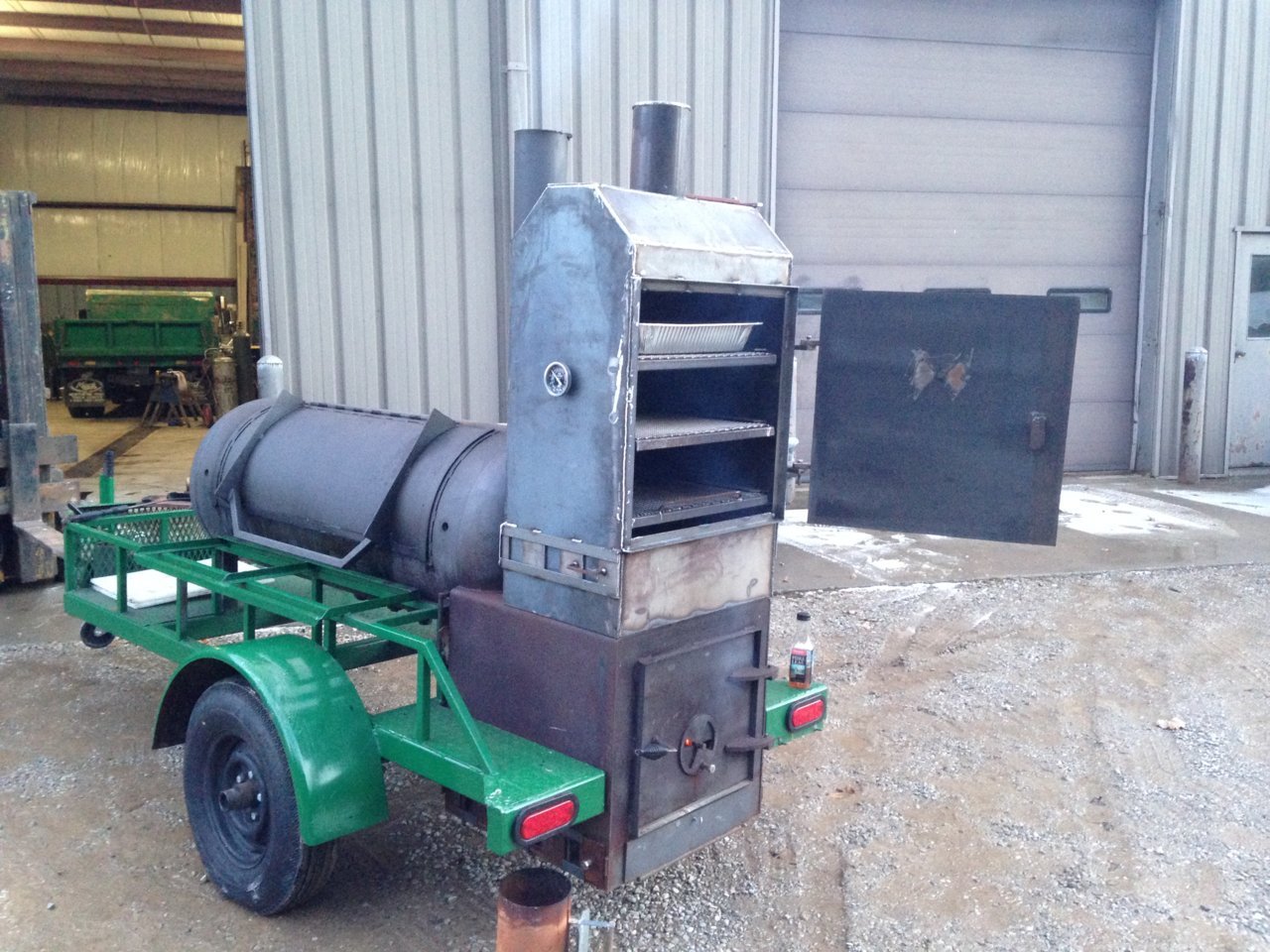

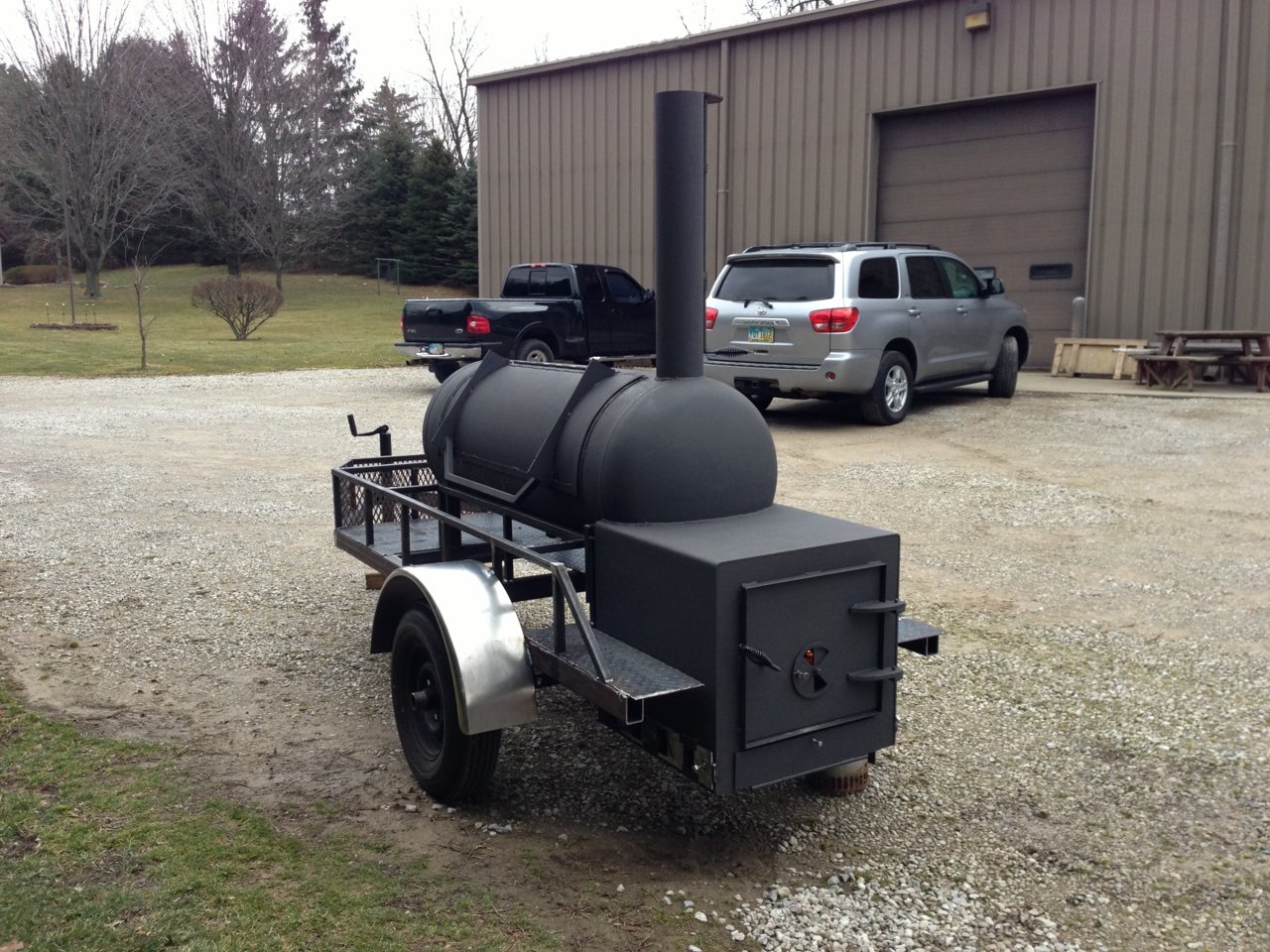

    added a warming cabinet a year later

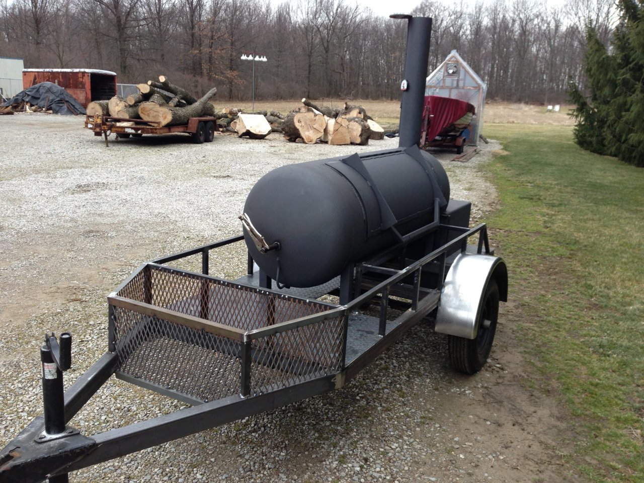

    Reverse flow?

    Yes! I can hold the temp within 5-10 degrees end to end. If I had it to do over I would have insulated the tank and fire box. It isn't that bad as far as wood consumption. Three pieces to start it and then one every hour or so.
