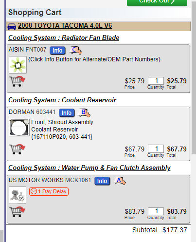

    So attached is my Rock Auto cart. From what I've read it's best to replace all components in the system. Looks like it's a bit cheaper to go with combination water pump/fan clutch, then add the fan on, then do the shroud. My dilemma is getting it home now. Or to the shop that fucked up in the first place, given that's what happened. It's about a 35 mile trip back to home base, less to the shop. This couldn't have happened closer to my destination and farther from home that day. I've looked into U-Hauling it. The problem there is that the truck I currently have doesn't have equipment rated high enough for the trailer and weight of the Tacoma. I'm thinking of limping it to a different shop 3 miles or so down the road in Waldoboro and having them fix it.

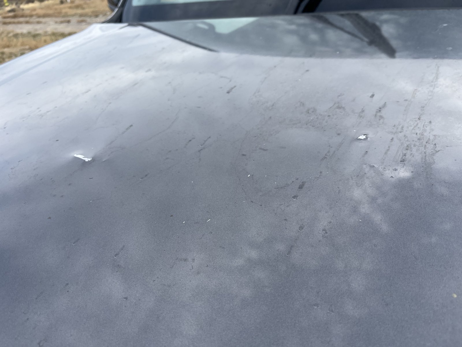

    You are not alone. This just happened on my wife’s 2014 4Runner with 342K miles on it. She was driving from our home in SoCal to our ranch in Montana. North of Idaho Falls, the fan disintegrated as she was passing a car at 65 mph on flat ground. She got it to the side of the highway and shut it down before over heating. Got it towed to Toyota dealer in Idaho Falls. They were as shocked as I was. Pieces punched dents in the hood causing paint separation. Clearly these fan blades are not fiber reinforced plastic and have a duty cycle that Toyota has not informed us of. She has a 2023 ORP at the ranch and we intended to relegate this one to winter driving and off-roading.

    So what was the outcome with insurance? In our case, the fan blades shot up into the hood creating at least 3 outie dents with paint removed.

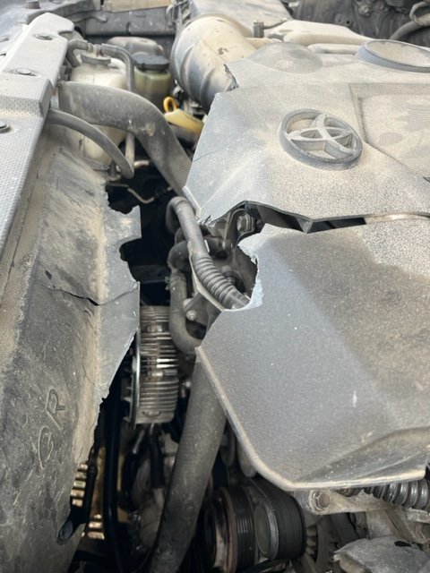

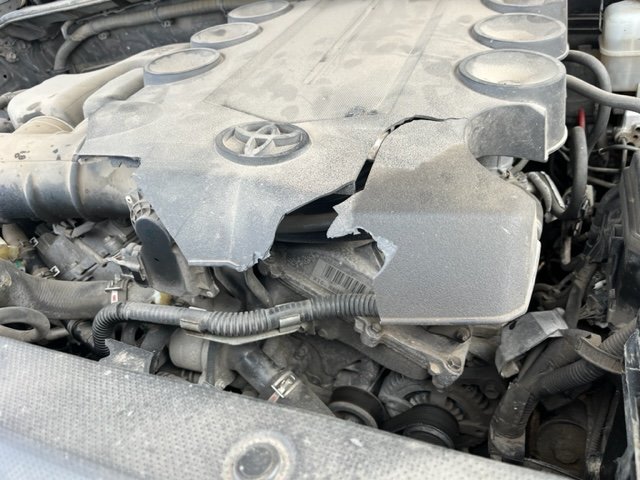

    Confirmed with the dealer service that the fan clutch seized. It punctured the radiator, sliced a hose to the oil cooler, but she pulled over and shut down quick enough that it never lost oil pressure and the dealer service confirmed there was no engine damage. I asked them to match Lithia Toyota online parts pricing and they are checking on that. Either way, the parts get shipped from Portland, OR.
