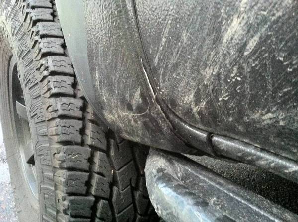

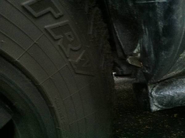

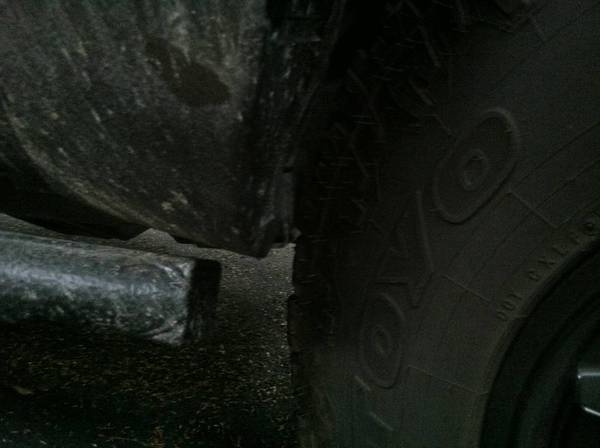

    Here's some of the damage the rubbing has caused.Mainly, the damage is to the fender flare however, there is also damage to the tire on the drivers side from the rubbing on the fender itself.
    I have also noticed that my driver side tire rubs on the frame at full lock with no bump. However, the passenger side at full lock with no bump does not rub on the frame (see pictures below). So I decided to take some measurements. I measured the gap between the inside wall of the fender flare and the tire at the bottom of the flare. I found that the driver side gap was about 1/2" narrower than the passenger side :mad:. Has anyone else encountered this?:confused:

    When was your last alignment and what are your numbers? Getting your caster higher might help with rubbing the body mount, but the best remedy is ganna be to just cut it. Grinder or sawzall will work fine, then you just gatta find someone with welding skills to box it in.

    So I saw my mechanic the yesterday to examine the rubbing since I had the feeling it was actually just symptoms of a bigger problem because it was asymmetric. He didn't think it was an alignment issue. Thus, next friday I'm gonna take it in and get all the measurements checked to make sure they are within factory specifications.
    My guess is that this problem dates back before I had anything done and tweaked something in one of the missteps I took in the truck. Probably when I was in the Gunks...

    So as I suspected the asymmetrical rubbing on the frame is due to a bent lower control arm on the driver side. The rubbing on the fenders wasn't what was worrying me but the rubbing on the frame was. The pictures above are to show that one tire rubs the frame a ton at full lock and the other does not rub even close to as much. If there was nothing tweaked this would have meant that the frame is asymmetrical or that the steering was asymmetrical. Both are not likely. So yea... I'm getting that fixed then doing some trimming. After that I'm gonna have be done for a bit to save money.

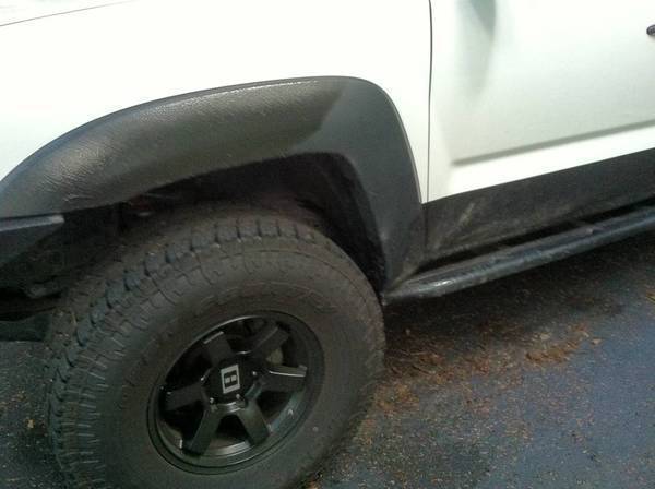

    So time for an update:
    I got the lower control arm replaced about 2 weeks ago. Then I got an alignment which realigned the wheels to the stock positions. This ended up brining that same insanity inducing rubbing. Got it realigned and the rubbing is better but it's still there. It's better than before but I may have to trim now… or should I just move the front axle forward by around 1/2"? Anyway I can't afford to have it in the shop for anymore time since it's my daily driver and my job requires me to drive about 400-600 miles each week.
    I think we all know where this is headed…
