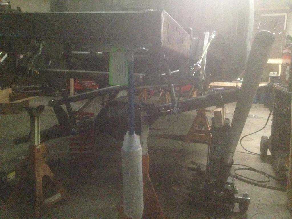

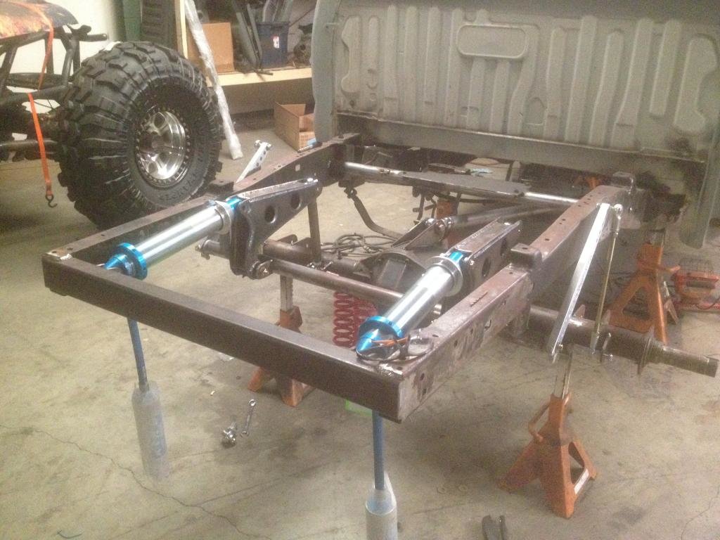

    Are you limiting the up travel so the tires don't get into the fenders? Looks like you have a lot of room leftover if you moved the Panhard back a few inches behind the axle.

    The picture shown was at bump, 5 inches above static, with a 22 inch frame height. The droop number is still to be determined, because we don't want to move the truck from it's position at this moment. The rear end sits on the concrete at 14 inches of travel, and room to drop.

    The pan hard bar actually has to brought down on the frame side.

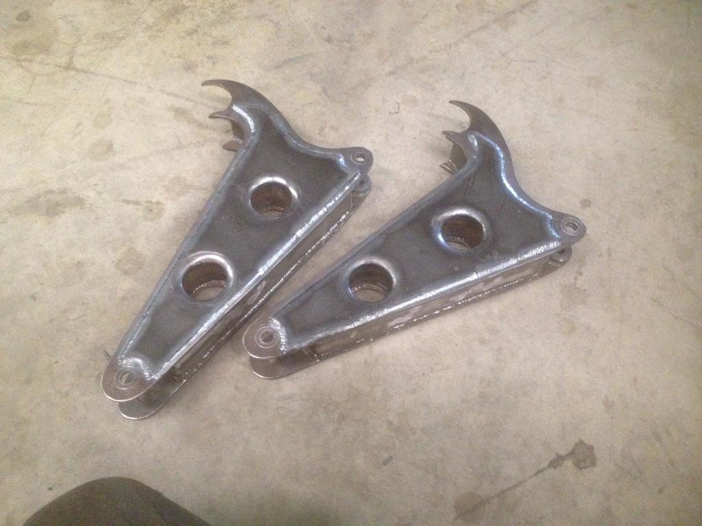

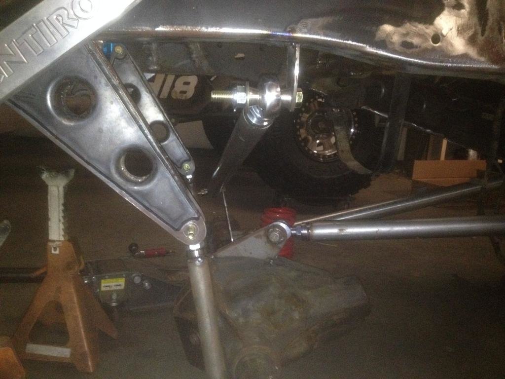

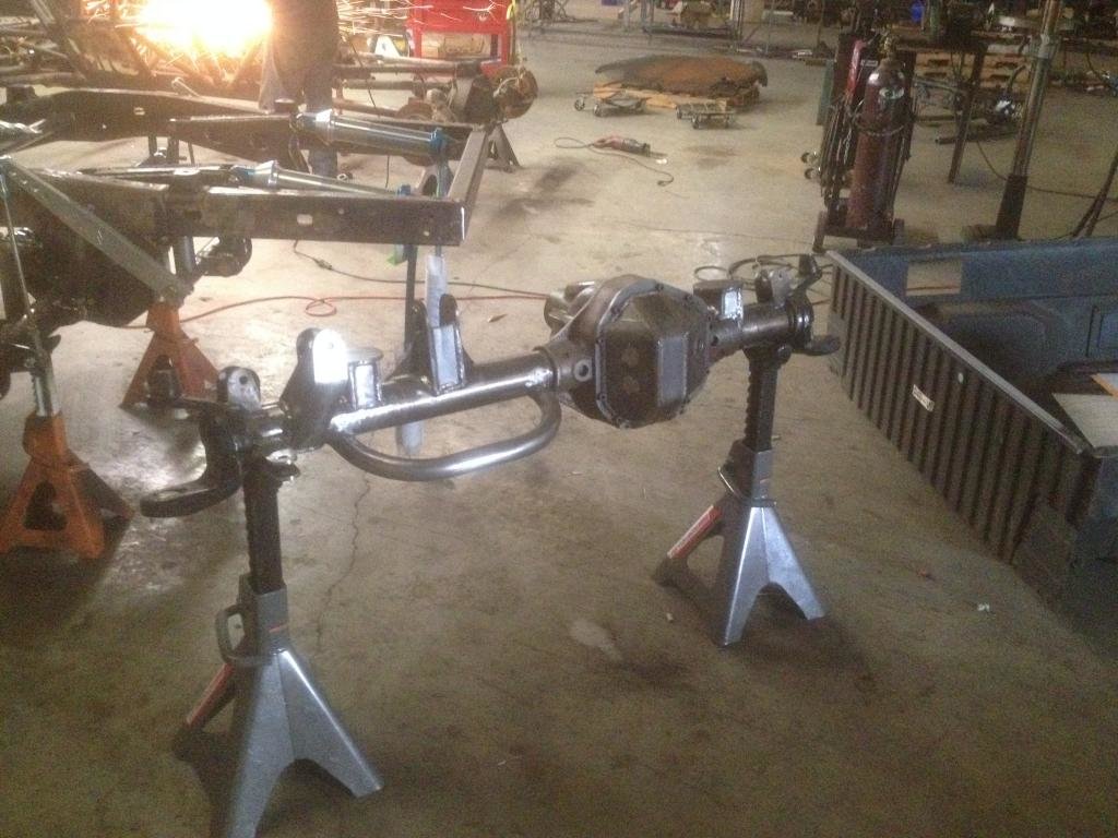

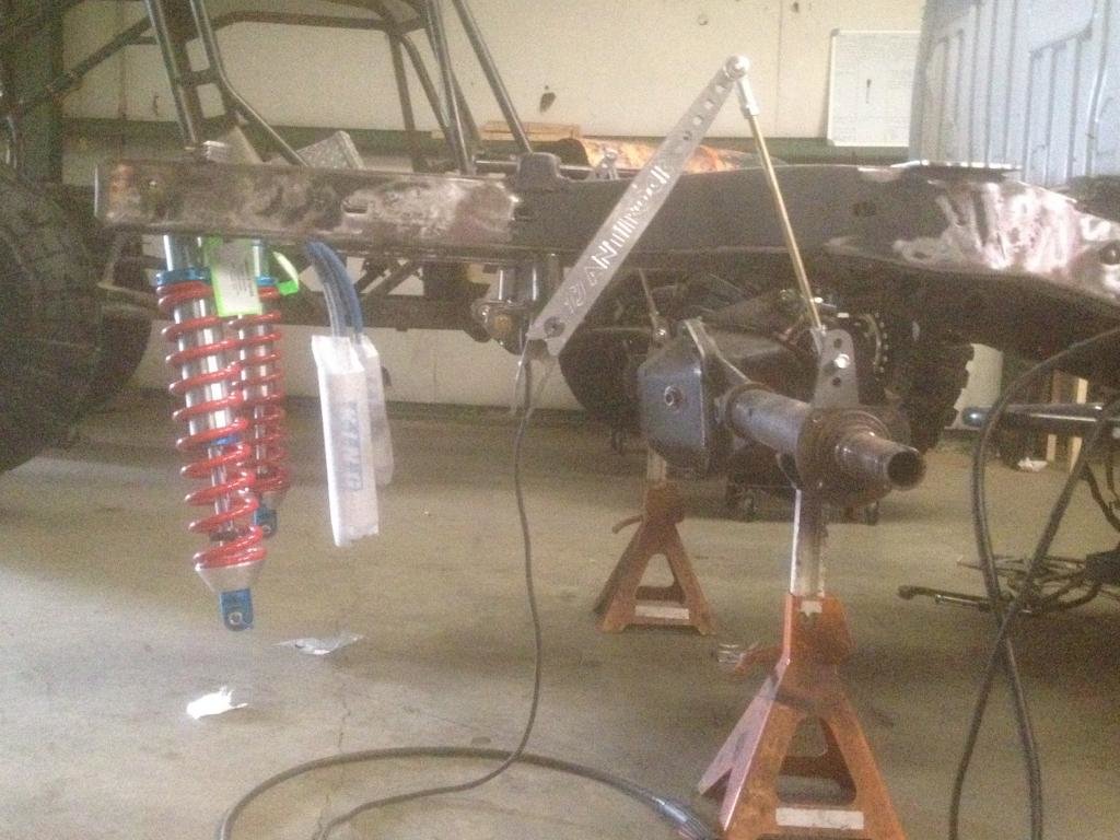

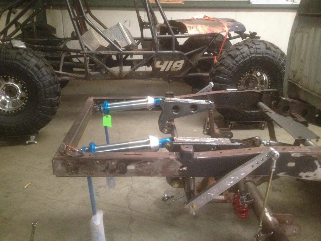

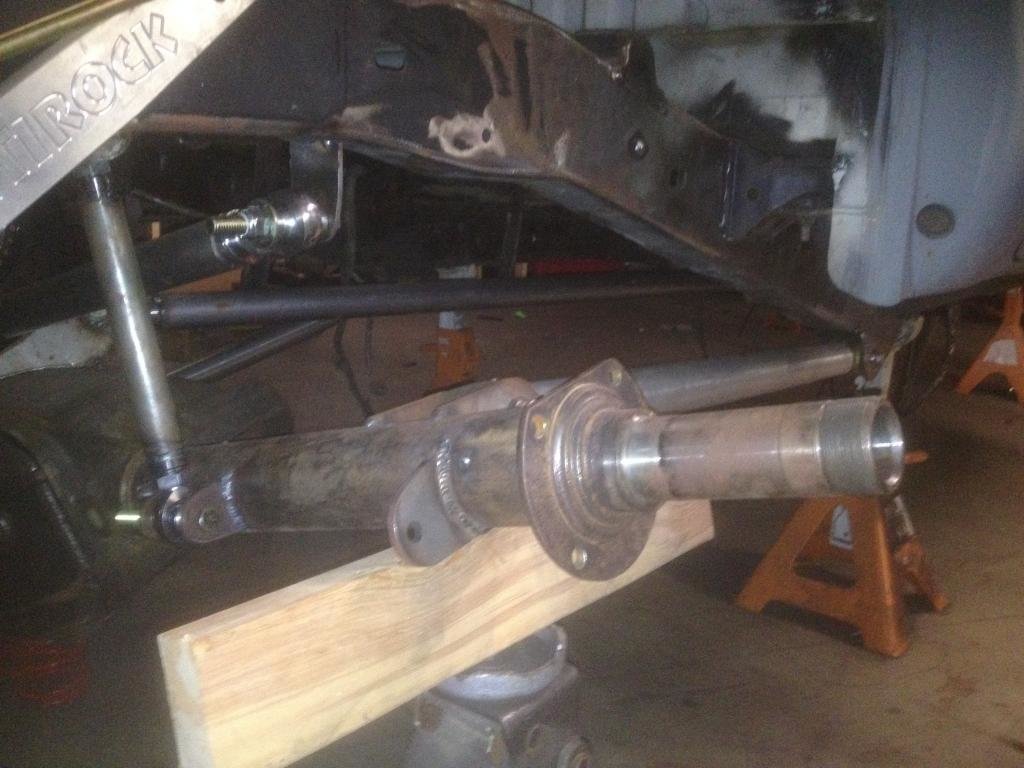

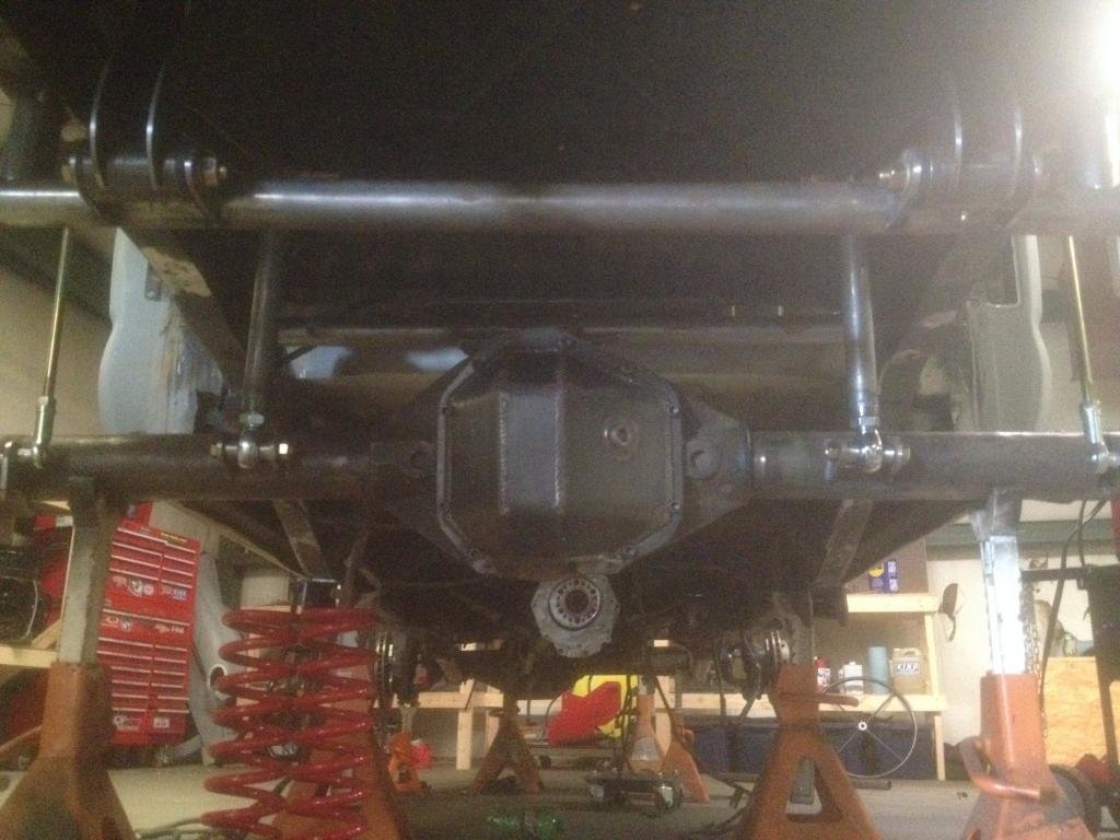

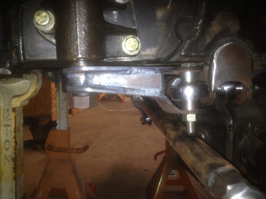

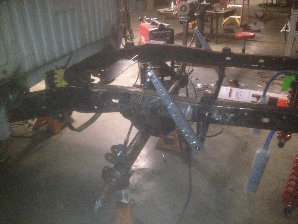

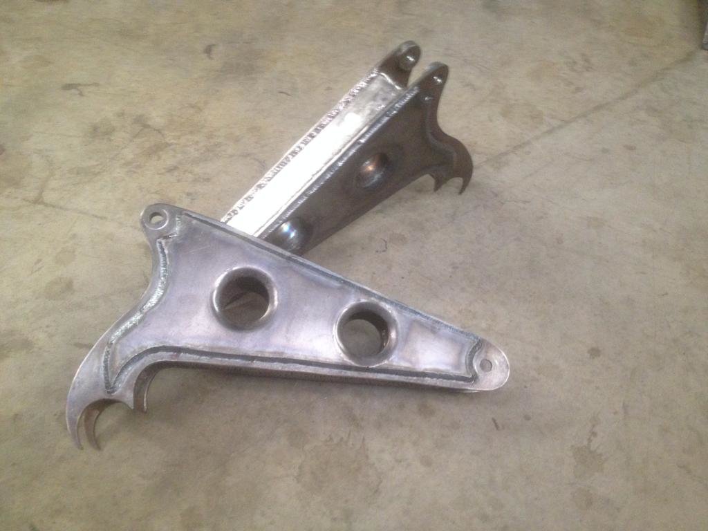

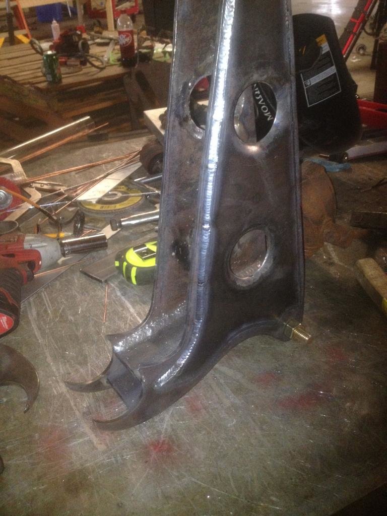

    few little update photos of the progress.

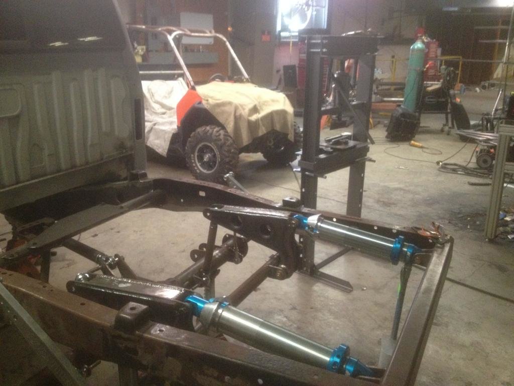

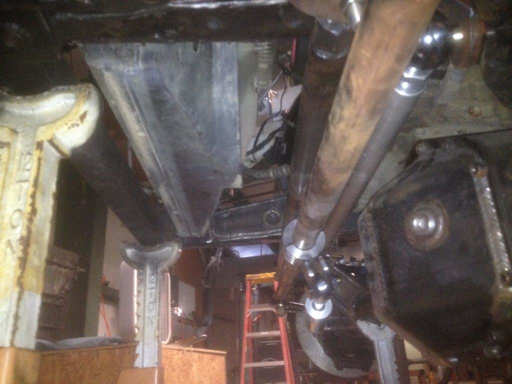

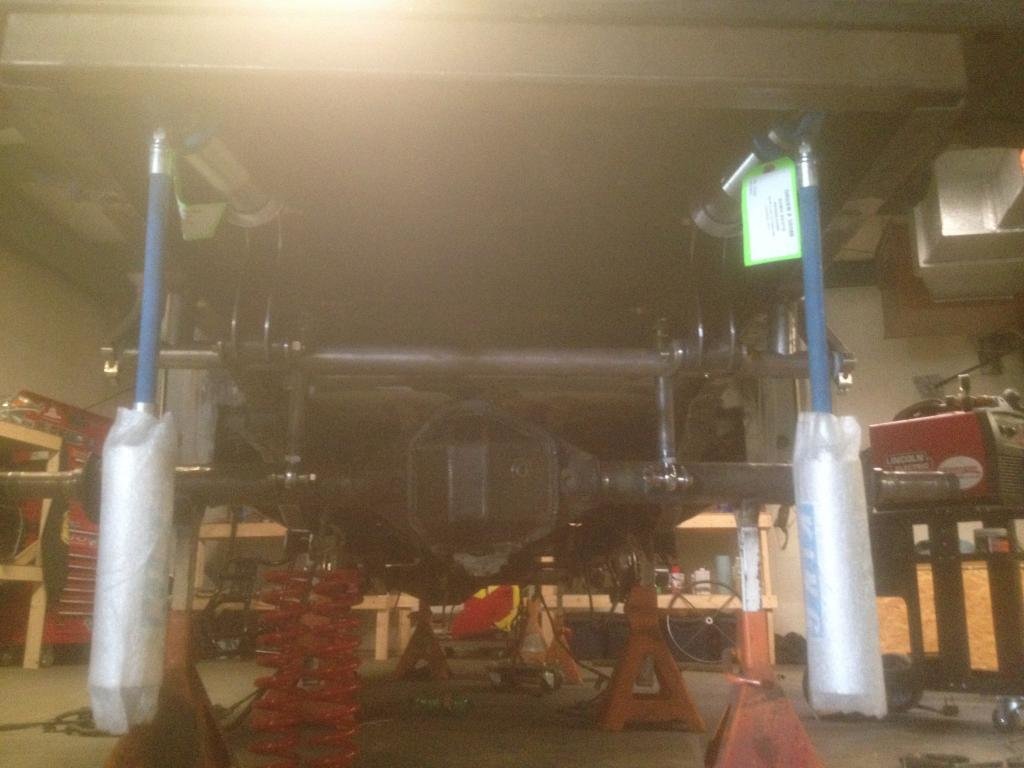

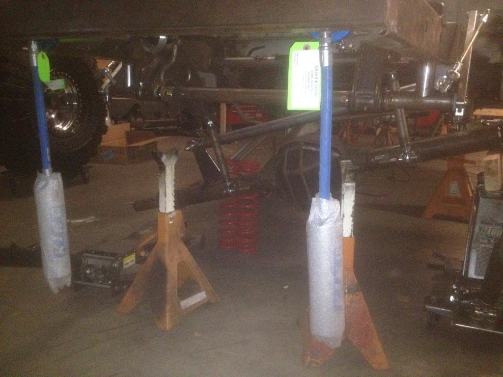

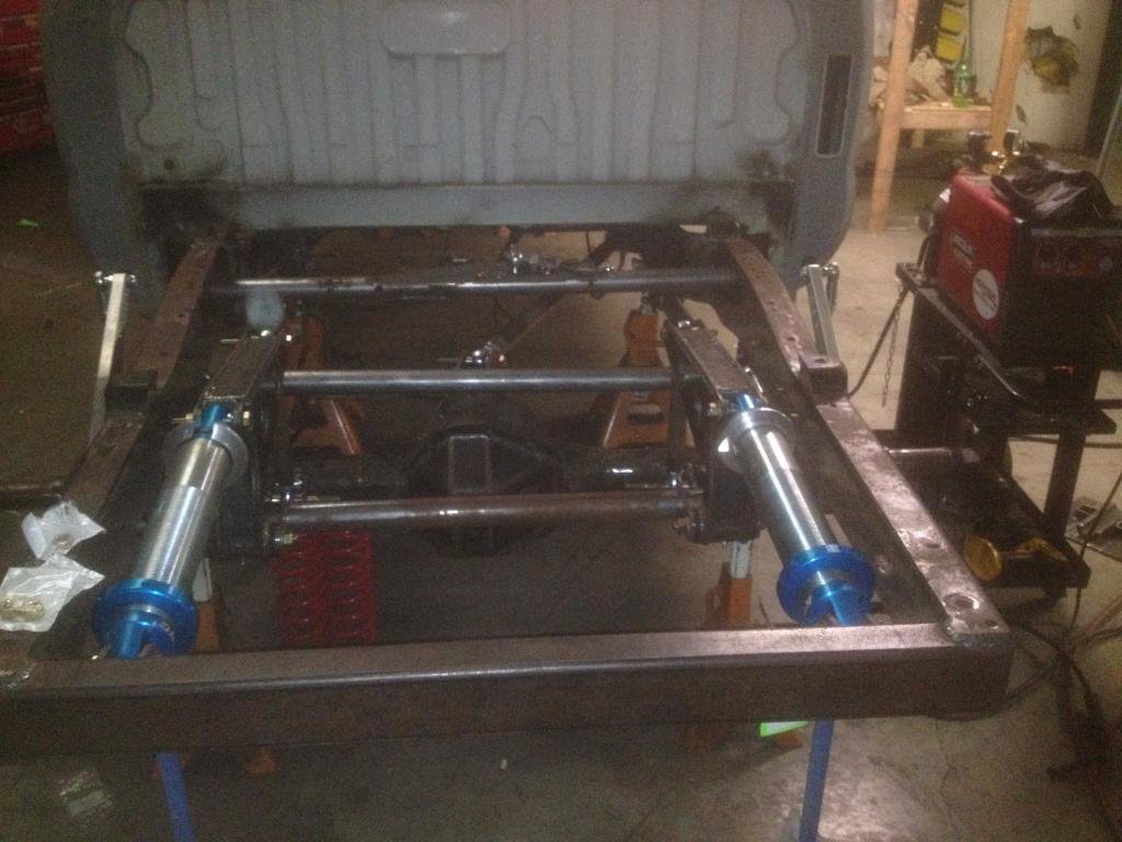

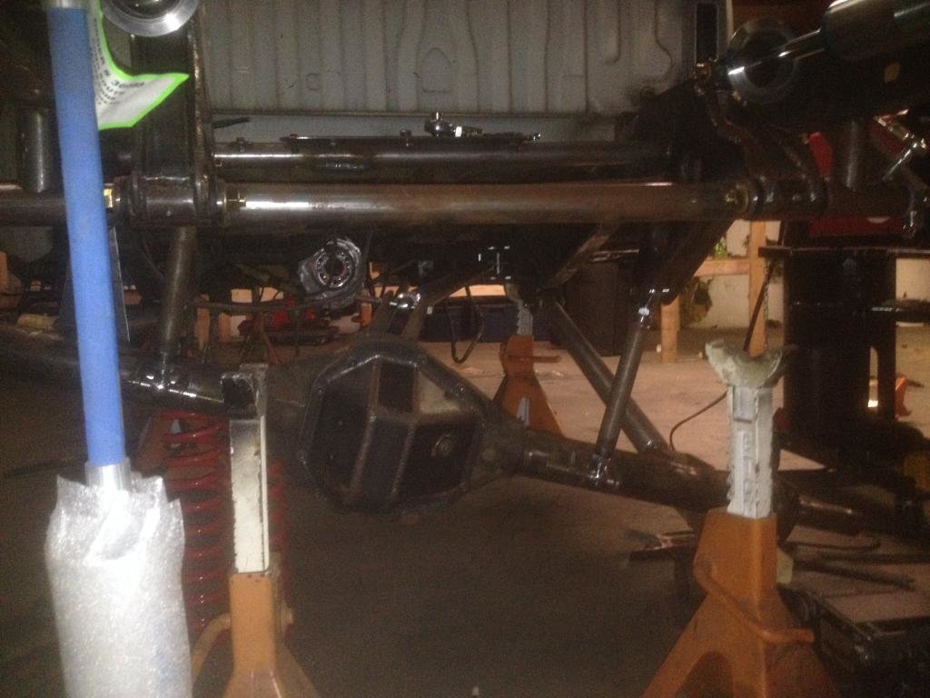

    front axel pulled and cleaned up. ready to get the ARB and gears installed and a free coat of paint

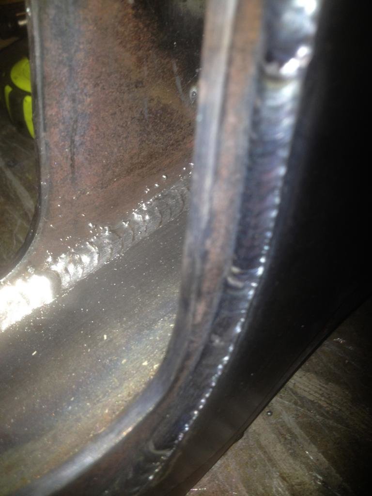

    Pitman arm version 2.0 this one is built using a Sky chromoly splined slug and 4130 plate. 100% TIG welded goodness. we re built the original prototype due to a slight mis calculation in the length needed.

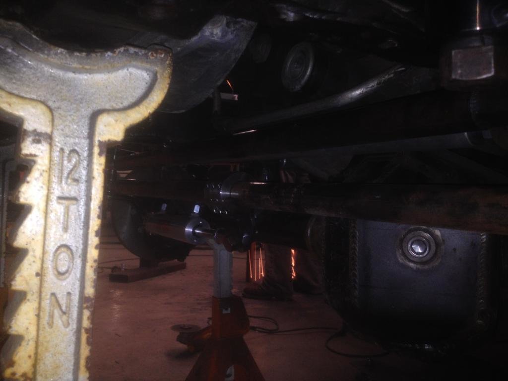

    installed the ram prior to front end tear down. checked the steering and suspension clearances one last time just to make sure it was all correct.
    IMG_1090_zpsd472206f_5bc5f9d386495386eb16fd03940af6a2c457b47d.jpgIMG_1108_zps6c7f3e95_91ce34825397abafad9c0a3541b2fbee61ae2c79.jpgIMG_1109_zpsef24bc7f_383449f9805b2ebb85b9aa491c5133085f347fb9.jpgIMG_1110_zpsc4adfae2_70ddebeec90636dddd513bb8f998bc8eedf234bc.jpgIMG_1115_zps62f8fc8c_877855ae1592f6370605bc0b758385f2e8a162d8.jpgIMG_1116_zps01606b43_d6ddd289e687bb37662ab23f6af8c8b1af250e7b.jpgIMG_1127_zps62c42049_84610f0af279bc15cb43b49370386dc0d7dc5f1d.jpgIMG_1128_zpse3913ec3_27fa494088a224c88138ae0549dcefe75495c10f.jpgIMG_1134_zpsfe9838c6_3d6cebdd24879f50720cce4b88d1227eb1db1d9a.jpgIMG_1135_zpsed067fd3_435d01b8c1341e02e941b91afd7ebad1b69a6397.jpgIMG_1136_zpsde250c04_82a922927544254f9f5aac1c5e2b410ab3ef01ec.jpgIMG_1137_zpsf6036839_f348c7367fee1fac5a5966439d09bc596f1d6ea5.jpgIMG_1142_zps80daa9a4_6ecc305d734ed21b0af31f6a6fab5ca085ac02df.jpgIMG_1145_zps17d59e2e_ebfed757a278d54d55a4606d3354c348bca37195.jpgIMG_1148_zps5f214b9d_b794e5a03aa49800a27c1aa186974f805b0d0aed.jpgIMG_1149_zps26edb2f8_62654f92ec72c4c53e72aef002a9a4347f58df80.jpgIMG_1150_zpsae57796b_626d29b759caba5bf9d83a3bed1675143e076345.jpgIMG_1151_zps0d3eb3eb_afa78a99ffa98e5bb3594e0779fe18b9f38549e9.jpgIMG_1153_zps10cd51cb_c5ff6b00a47fd2e52f26c579ae69db531fc9fa21.jpgIMG_1154_zps599b4734_fe1e4bd6ff4e2fdc014da3ad873ecc3faed307ef.jpg

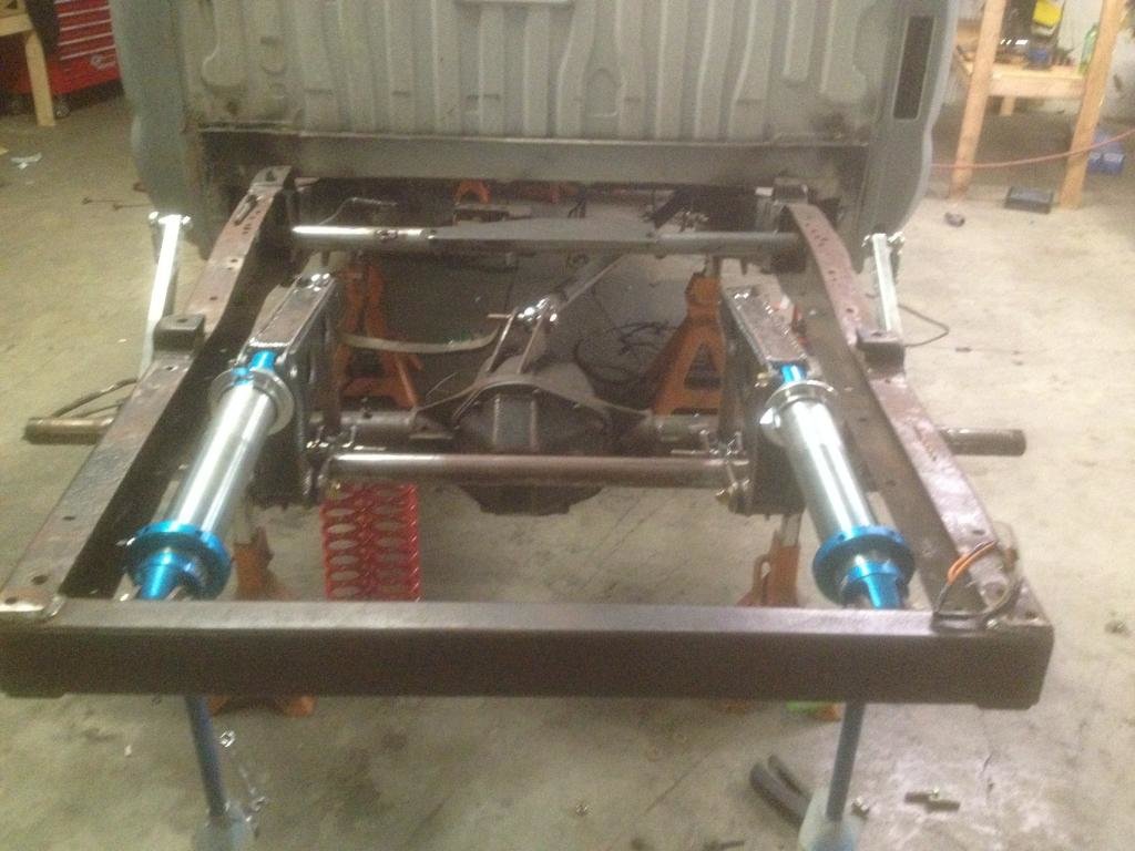

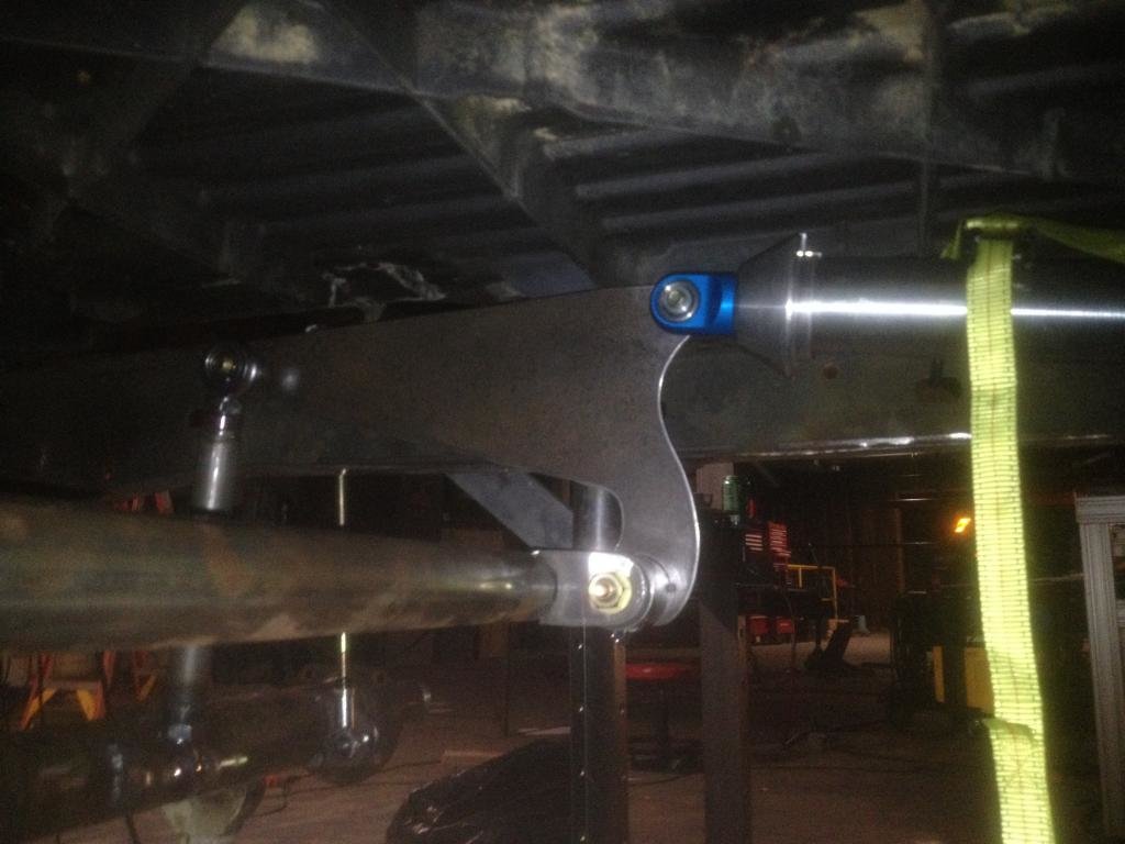

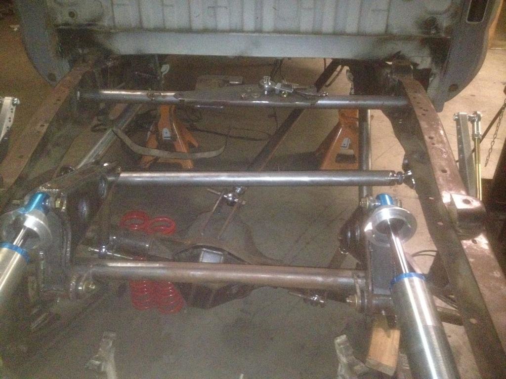

    I am not putting up much info on the cantilever kit. this is a product that we have built from the start with the intention of making a kit for the tacoma as well as 4runner and FJC. But we did want to share our progress. When checking suspension bind the sway bar was disconnected and we had 14" of travel limited by the floor out of a 8" shock
    things we still need to do in the rear include finish up the bracket plate work. finish a tube substructure to help support the cantilever suspension and provide a mounting place for an OBA air tank. and finally mount the king air bumps.
