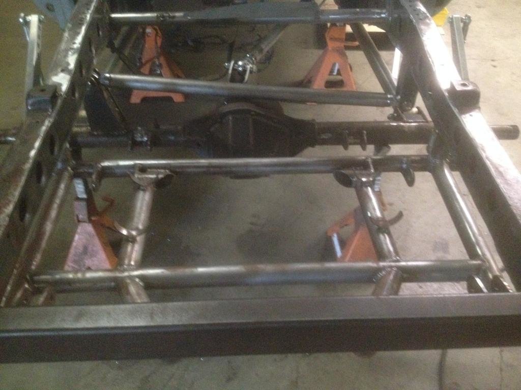

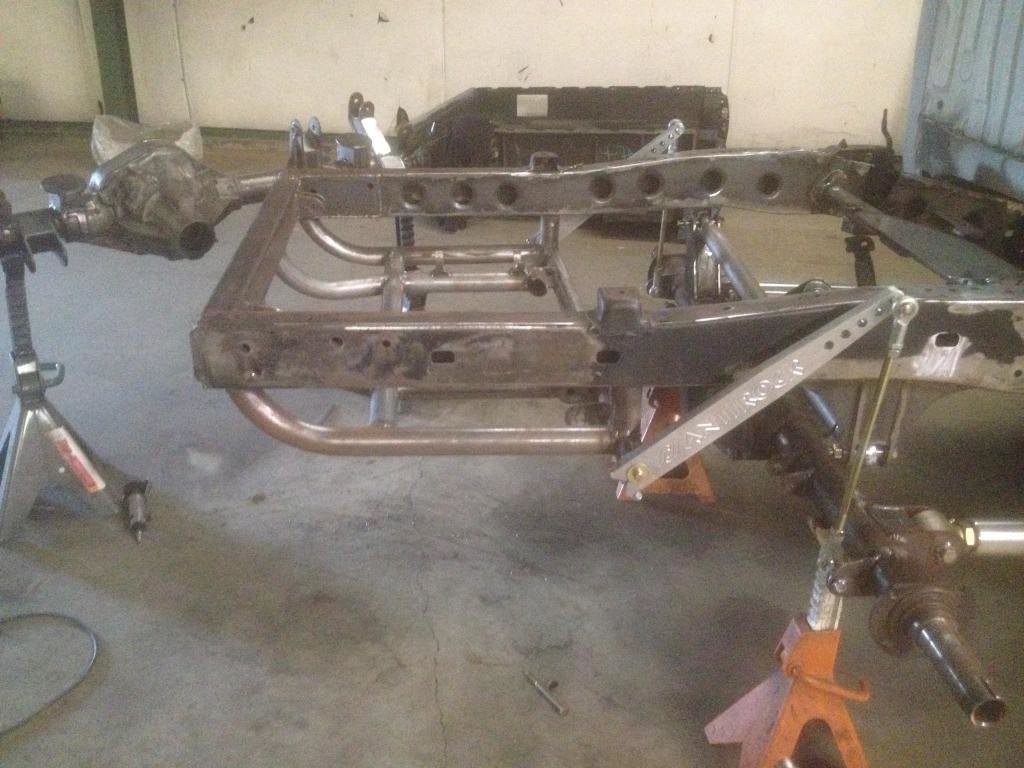

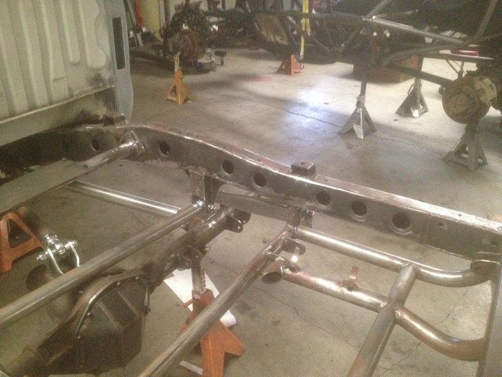

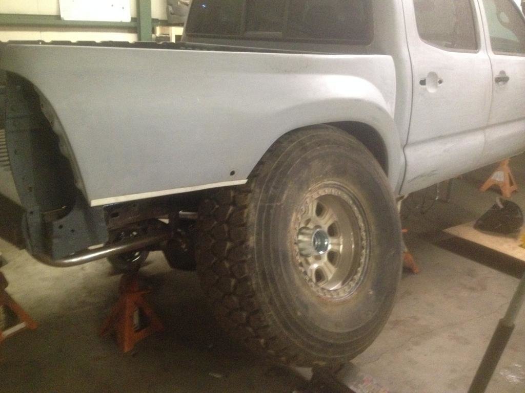

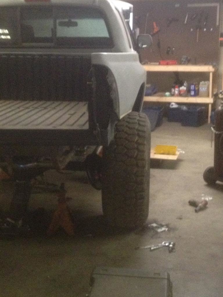

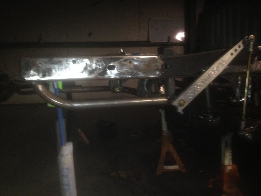

    so now here is the long over due update. the cantilever suspension is done and has been tested for bind and clearance. she preforms flawlessly on 40s with around 25" frame height. I measured 18" of travel yesterday and was limited by the floor.IMG_1166_zpsf3606cfc_dba561ac595546f421ced8c797275a97c8c1428f.jpg
    IMG_1175_zps9f90b071_3098050a5e12bba6e174b4160f8d16d2d60aef41.jpgIMG_1176_zpse6991839_1fcc9ed762065ac7e6598d0daa37443ad091c106.jpgIMG_1177_zpsfa824bc2_811f3d906446062265d42331e9778fa146f4cc0a.jpgIMG_1178_zpsb0728efb_b1d62ac05317938f143d5ee5dca5d25ff2c8ae08.jpgIMG_1193_zps95cd790c_67f07d84c95931bc3bc7971c846f6cc0294b860c.jpgIMG_1194_zpsfa8d3bf1_3241894672594ff5df6a960005fe87b01dabfdb7.jpgIMG_1243_zps6e377972_4b2ca6eaa23d3d6ed2acabc2a8a5fac7512fa90b.jpgIMG_1244_zps6fbadc72_2aaedf8a95c0ad85ed61796c9880b7ecb0bc75f2.jpgIMG_1245_zps1bb78eea_4c5b485caa249173382b237cdb4e0d70ddc63402.jpgIMG_1246_zpsf961268e_f97c14d13a75634ba303364734dead2c274c279d.jpg

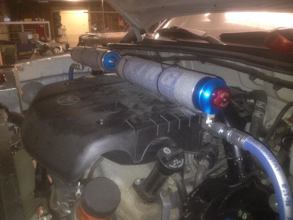

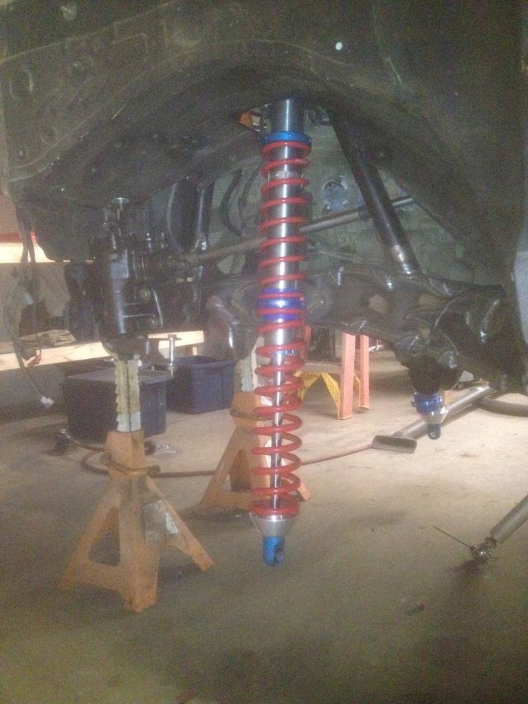

    We have a few things taken care of up front as well. the front is tore down and ready for paint. every thing has been finish welded and the air bump cans have been put it. The FOAs we used for mock up were ditched in favor of some better quality equipment
    IMG_1209_zpsf8ce0cfd_f61d8b950188364b242e18b2034be1f8161c54bf.jpgIMG_1210_zps81289b52_1d2a4b32b3134d972e3cf5c6c07afa742ac42101.jpg

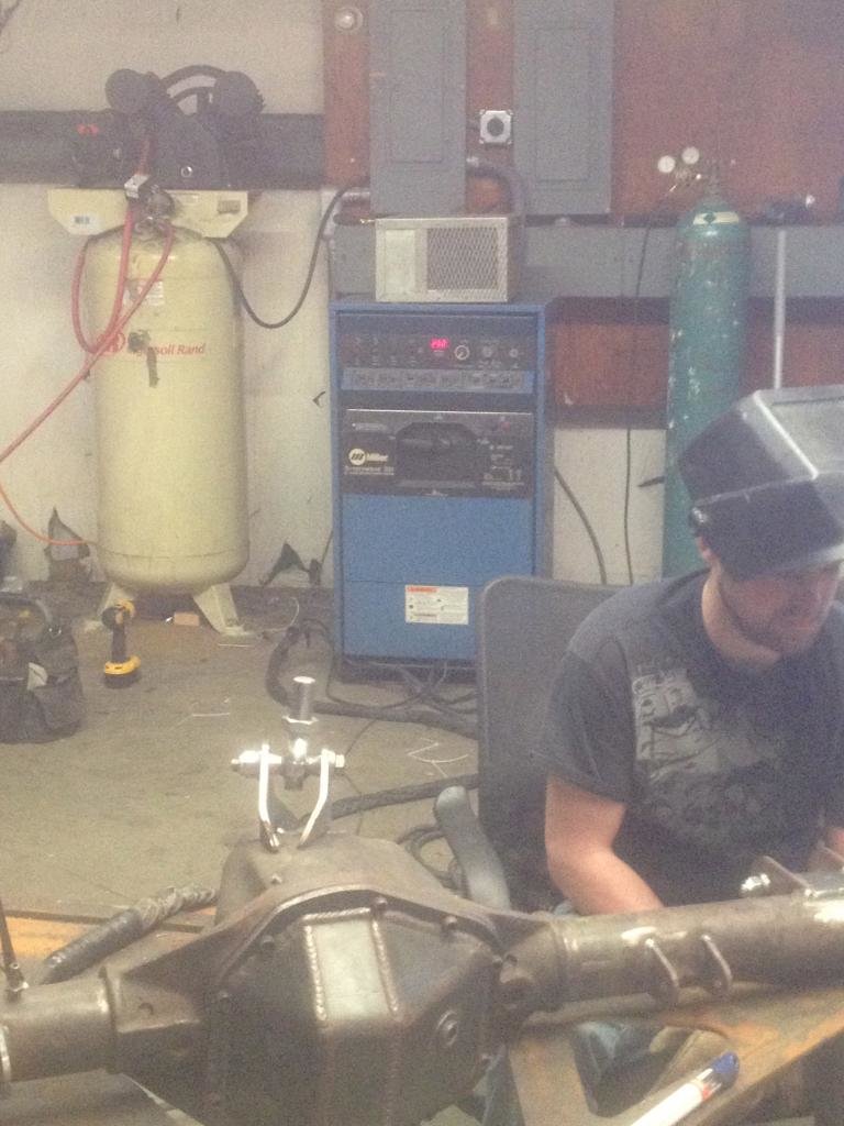

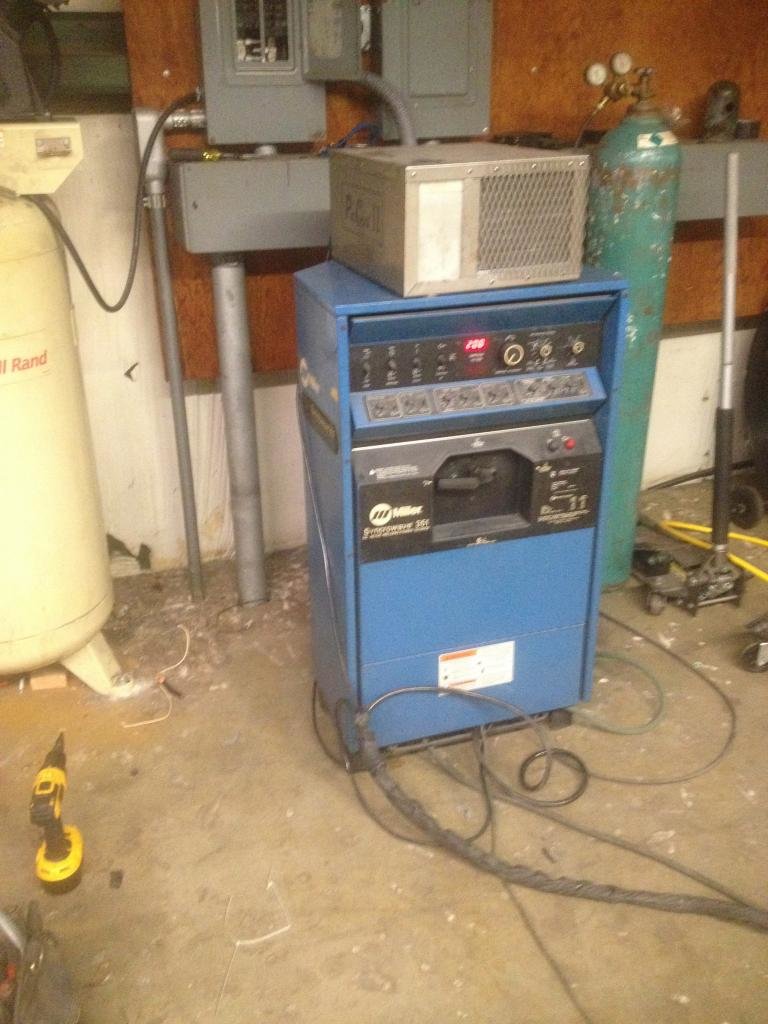

    we also had a nice mishap in the shop. our TIG died. this put us in a predicament and we stumbled into a retarded good deal on a Miller Syncerwave 351 with cooler to replace it. this thing is awesome! I think Ray Charles could TIG weld with this thing

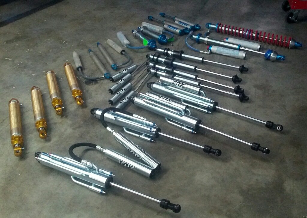

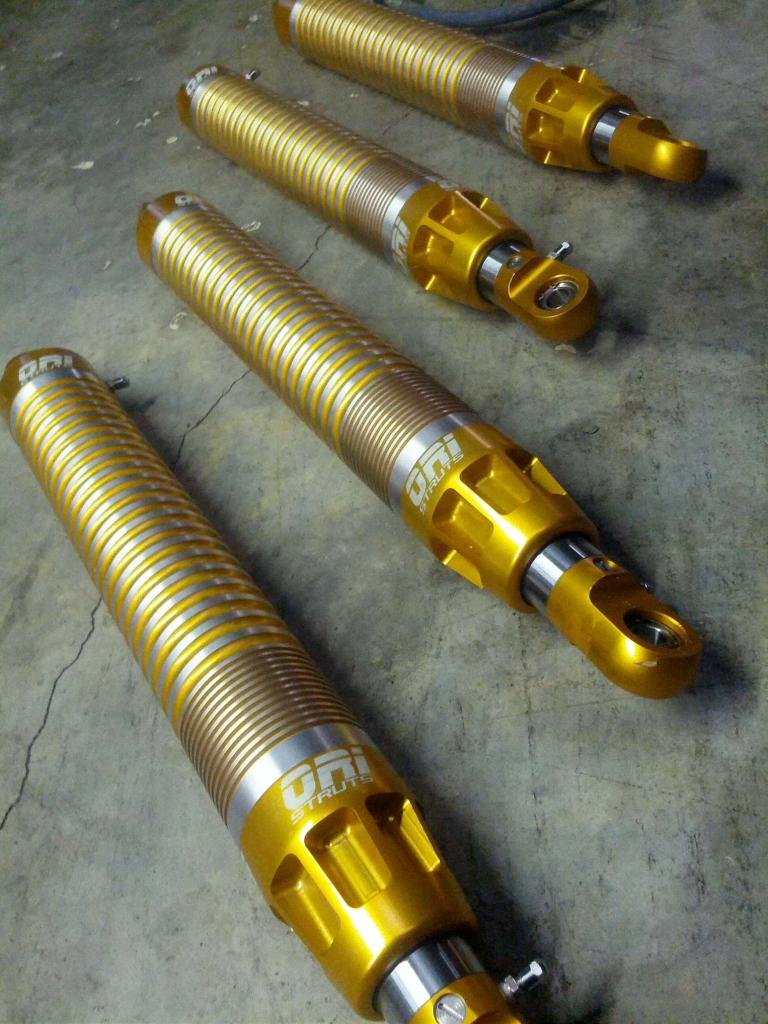

    and I will leave you all with some shock porn
    this is what is currently in house
    some nice shinny new 18" ORIs

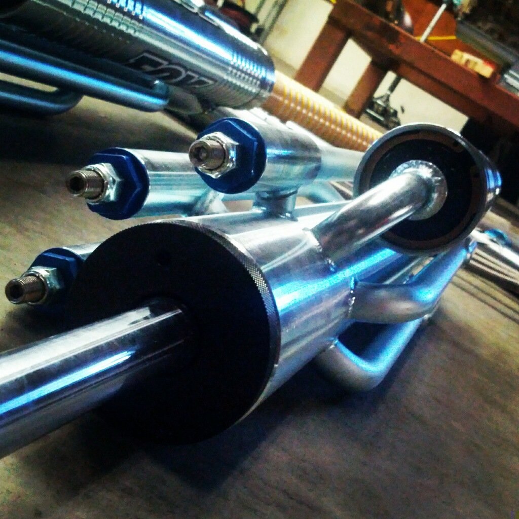

    Shock porn of all Shock porn BABY! a set of 4 brand spanking new 14"x3" 5 tube Fox By-Pass shock for the KOH car we are building for a customer. Custom built to our spec specifically for this customer's car. absolutely beautiful!

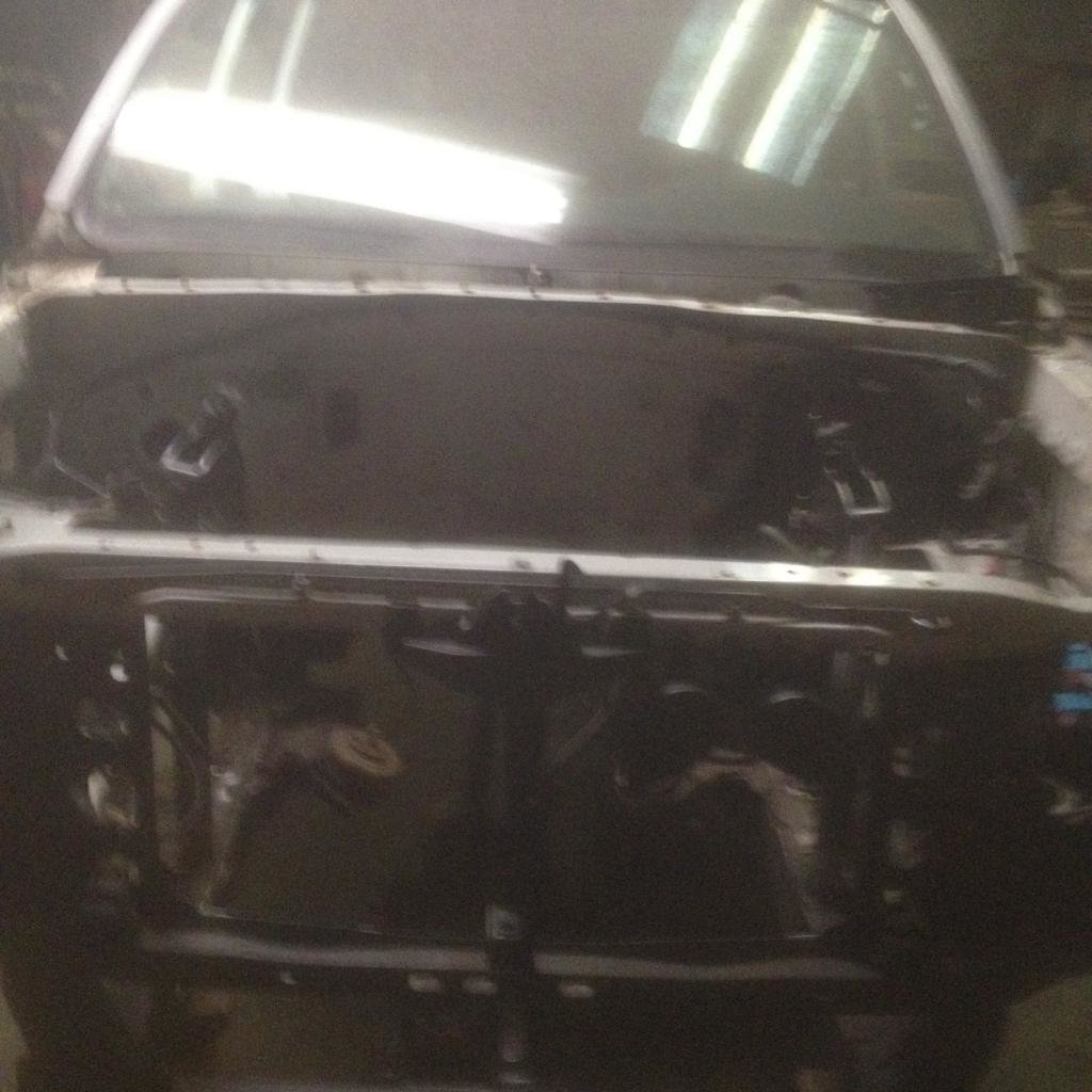

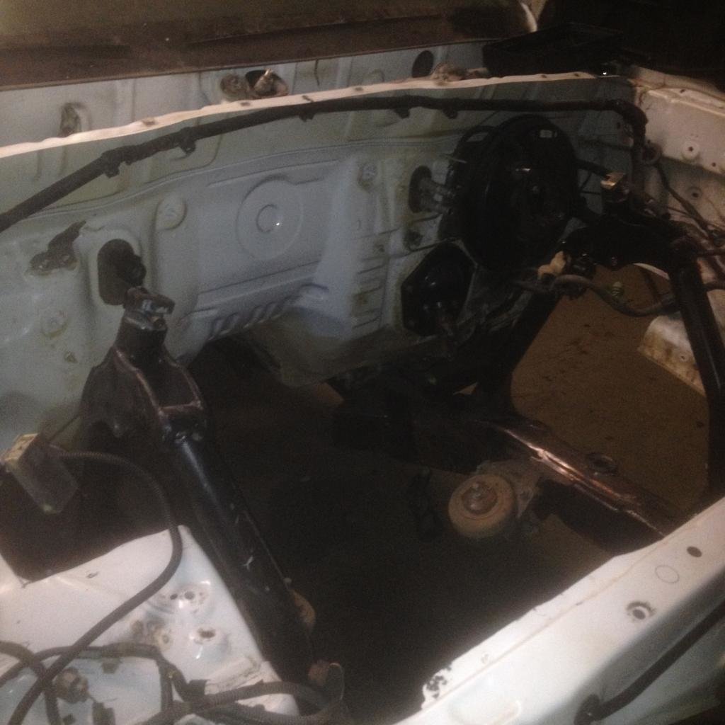

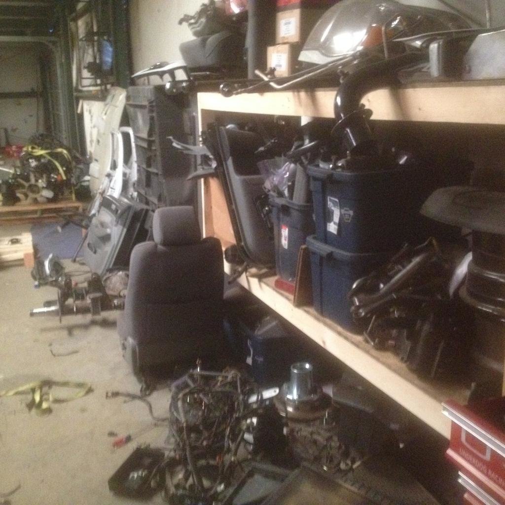

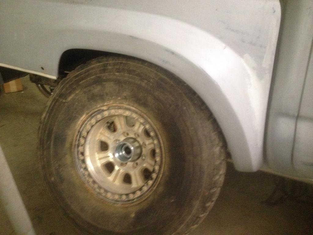

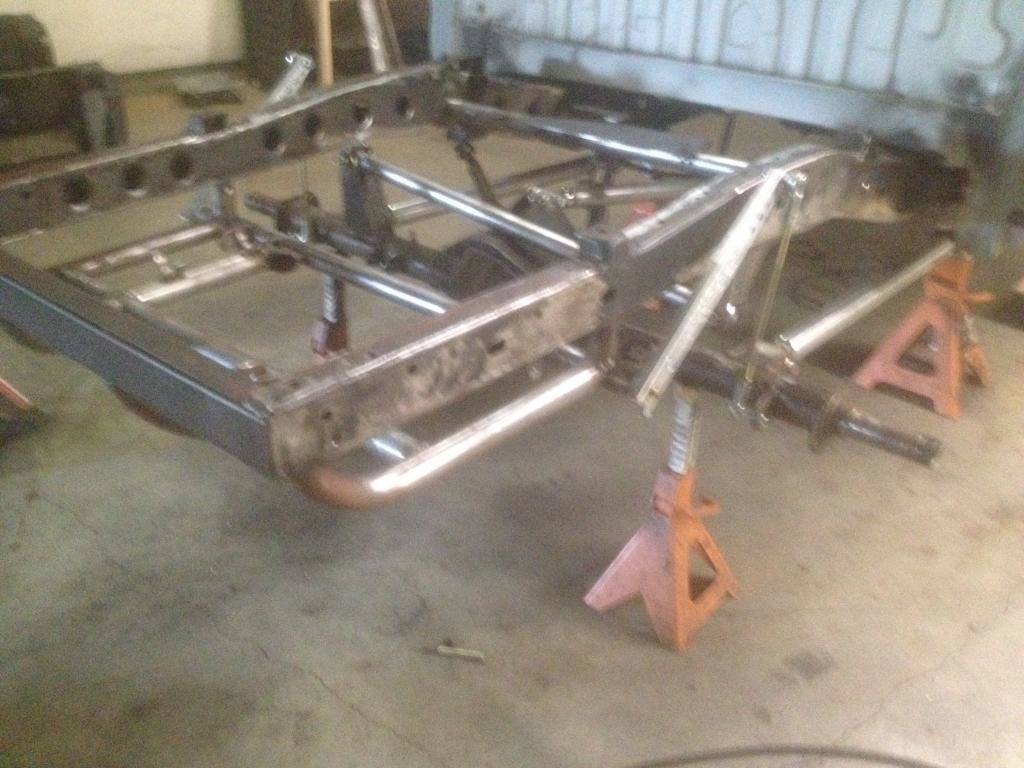

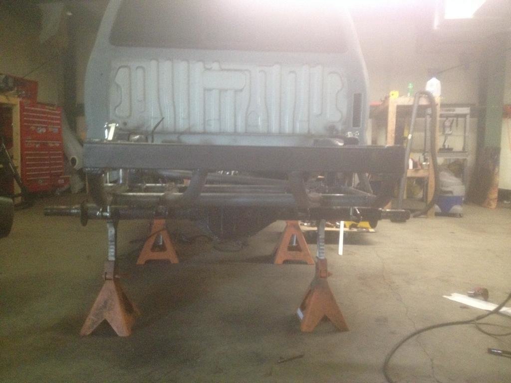

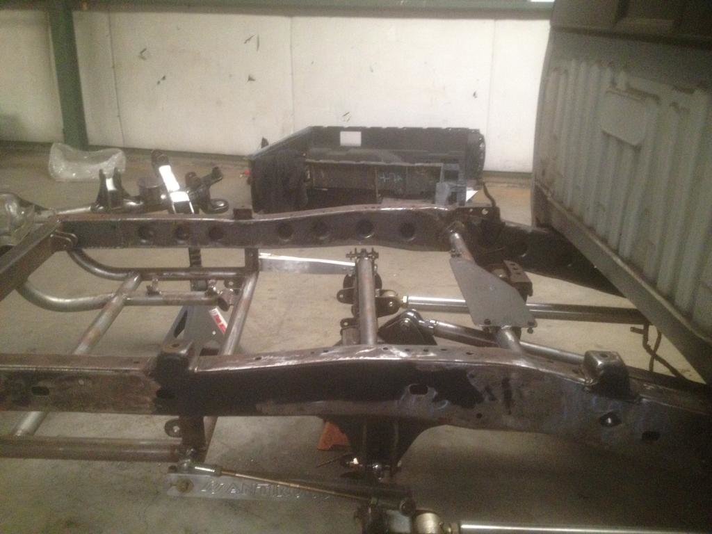

    thought I would give a little progress update. After all it has been a while. The last Photos I posted up showed the rear flex testing and that was pretty much the final step in mock up. the truck has been completely tore down to completely remove all rust or any deterioration and to ensure the top welds on all brackets on the frame are solid. then comes sand blasting and epoxy painting the frame, axels, and other suspension components. the frame and other parts that are being epoxy painted or powder coated where dropped off last night and the body in its completely stripped down state will go out tomorrow morning. hers a few pic for those who prefer visuals
