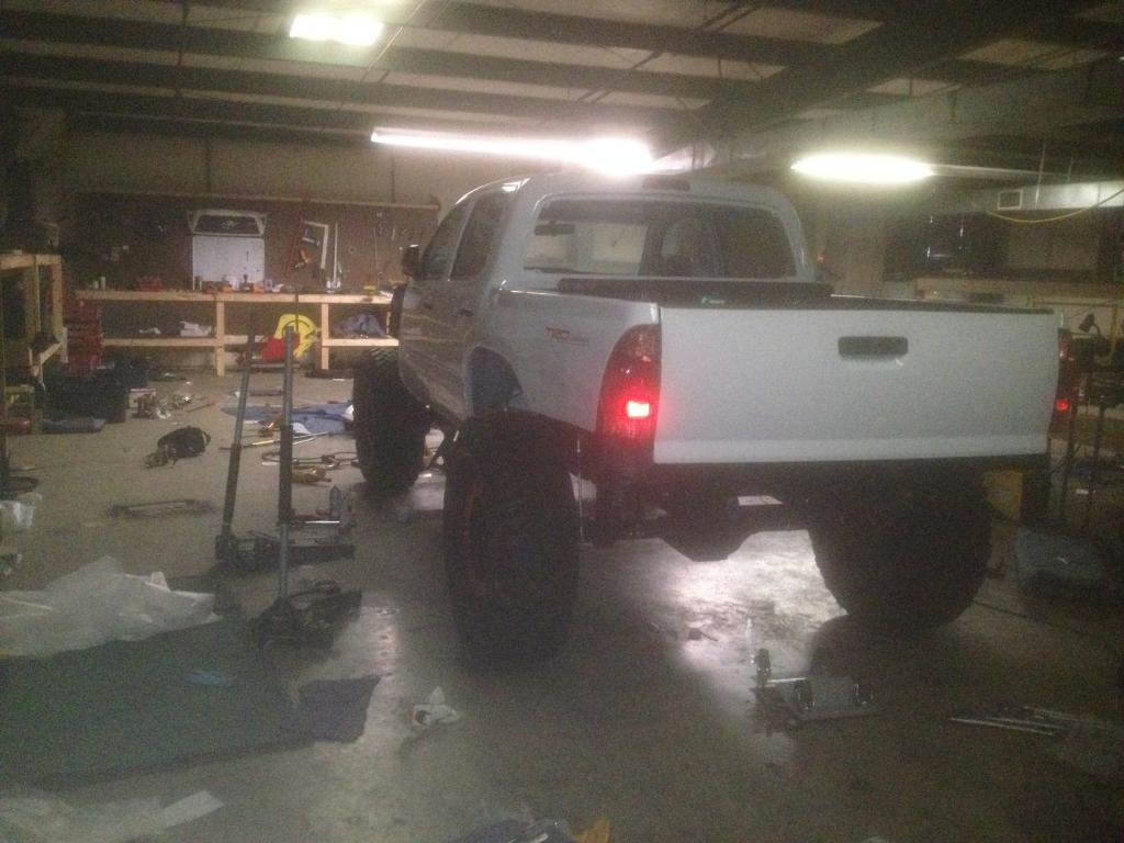

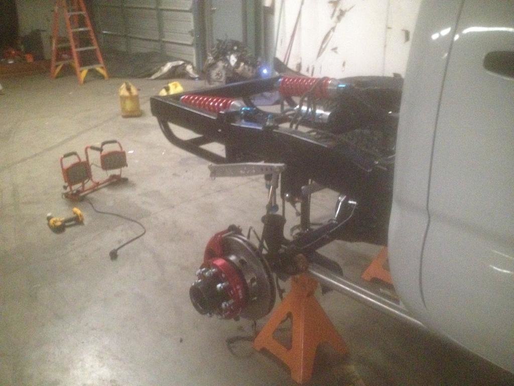

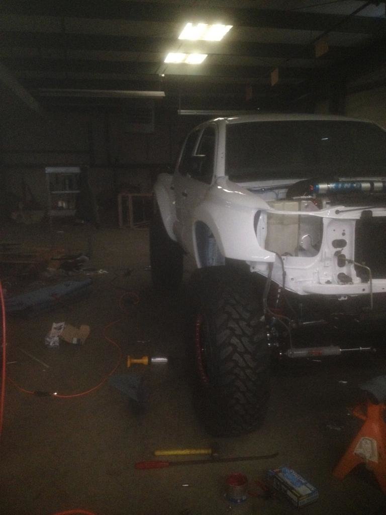

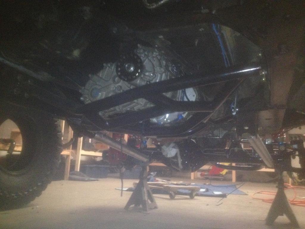

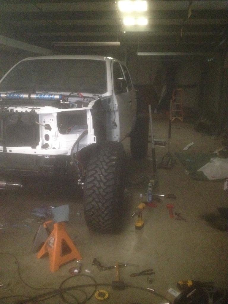

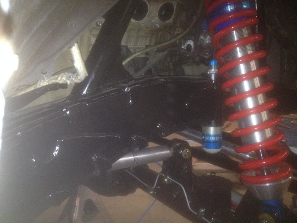

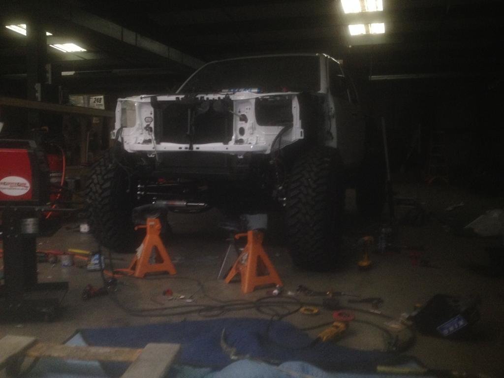

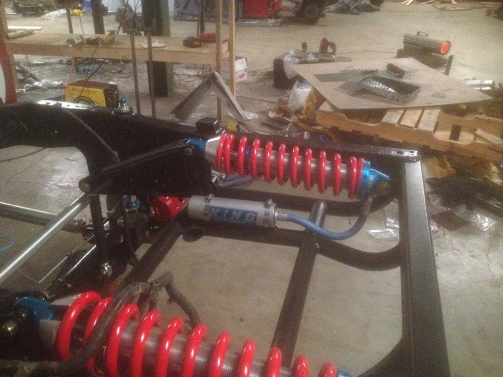

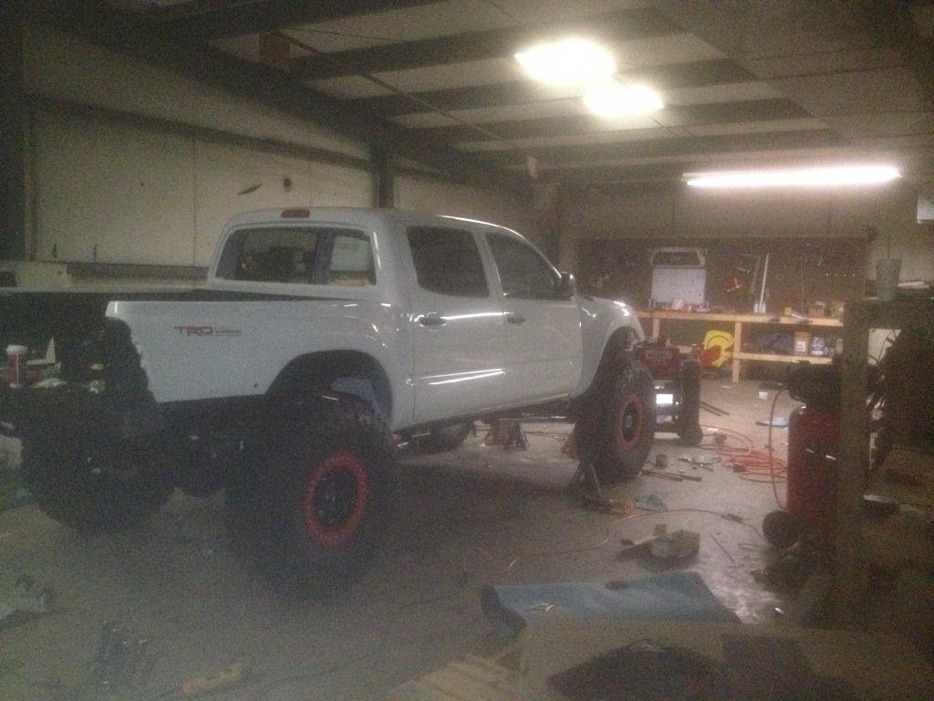

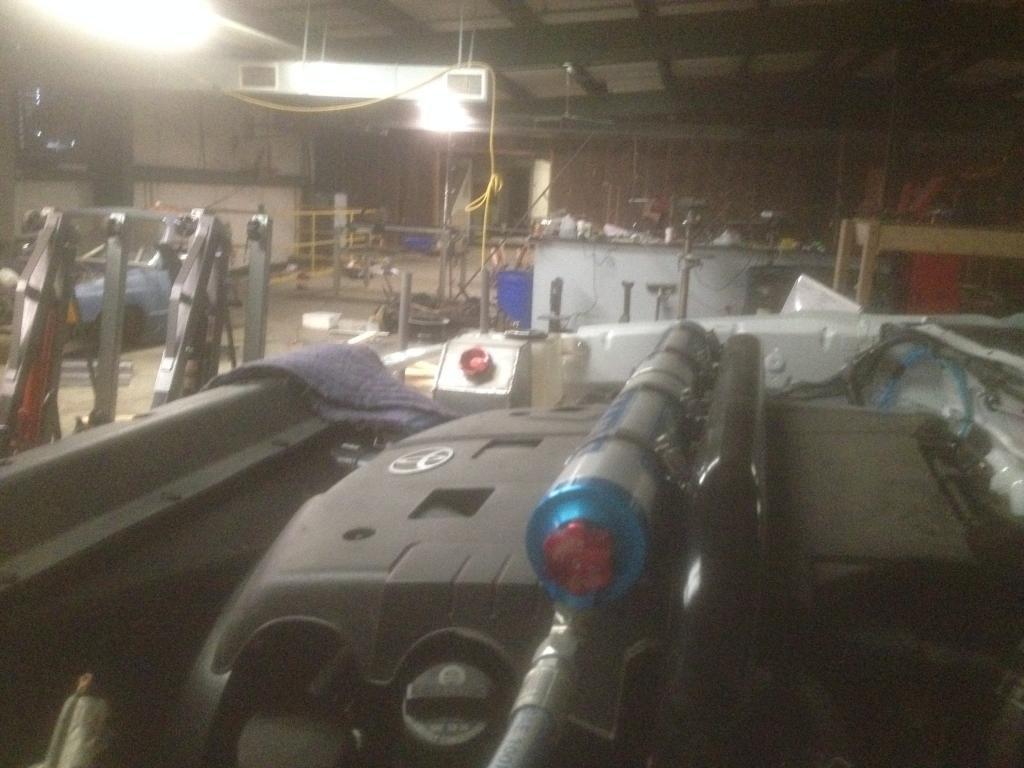

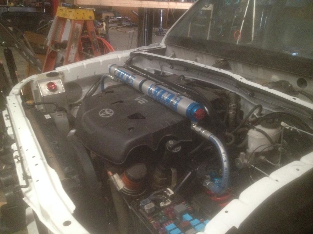

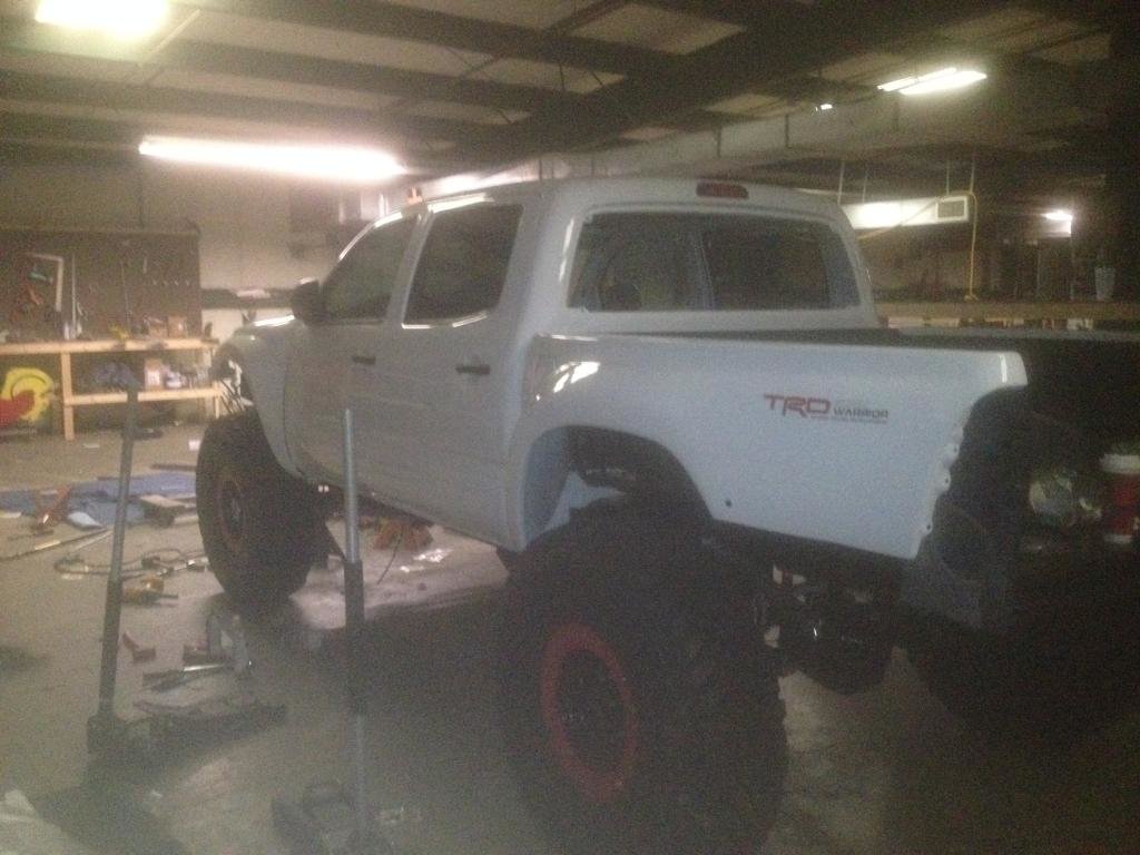

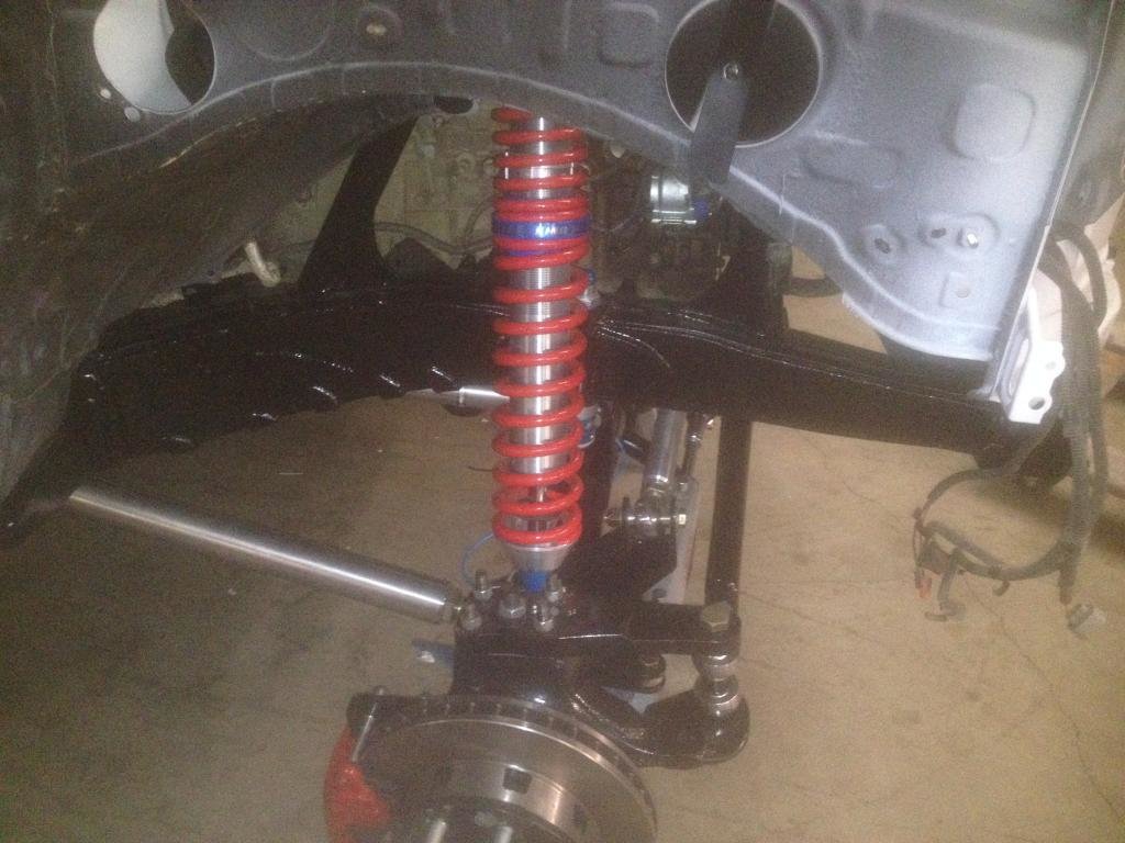

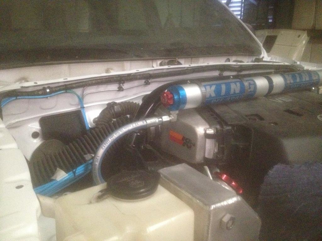

    every thing is finally back from the painter or powder coater and I had a week in the shop alone. I have made a massive amount of progress. super pleased at the moment and excited
  9. Feb 28, 2015 at 1:17 PM
    #249
    I8AJEEP
    I8AJEEP [OP] Dynamite Design Josh
    Nov 17, 2013
    #116712
    154
    Josh
    Lexington NC
    05 DC TRD SAS
    SAS, with tons, 3linked front and rear…I stopped saving receipts for my sanity
    all the big stuff is done. I am waiting on a few brake line fittings and I can bleed the brakes/clutch system. I still have to plumb the power steering and hydro assist system. I have to fill all the fluids. waiting on a new rear slider window to get here and the rest of the interior can go in. I am building a new rear bumper and sliders today and tomorrow and they will go to P.C. driver shafts need to be built. exhaust needs to be done from the headers back. I am debating doing it myself or sending it out for that. and I have to relocate and build the dual battery system….then it is time to fight all the bugs

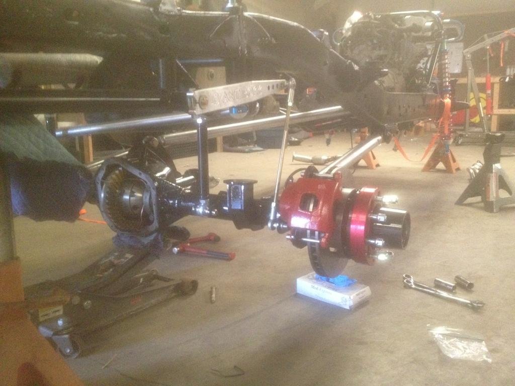

    If you're running custom axles, why the wheel spacers/adaptors?
  14. Feb 28, 2015 at 2:30 PM
    #254
    thekernel114
    thekernel114 Well-Known Member
    Sep 30, 2011
    #64427
    1,041
    Chilliwack, B.C.
    07 tacoma 4x4
    allpro long travel, shackle flip with ome dakars, cruisin offroad bumpers and sliders, 4.88 gears with arb's front and rear, budbuilt skids.
    They aren't custom axles.
  15. Feb 28, 2015 at 2:40 PM
    #255
    jmg256
    jmg256 Calmer than you are
    Sep 1, 2009
    #22100
    1,807
    Al Tonter
    TRD Offroad
    Bilstein 5100 front/rear (front at .85), Hayden 678 Trans Cooler, 20% tint, Curt Hitch/Wiring Harness, Weathertech Digital Fit Floor Mats (Black), Wet Okole Seat Covers (Black), Cooper Discoverer ATP 265/75/16, LED Map/Dome lights, ImMrYo bracket, Debadged, Extang Tuff Tonno.
    Custom to the truck they are...what I'm asking is why, with the multitude of axles on the market today, why not find one with the width you need sans spacer?
  16. Feb 28, 2015 at 2:48 PM
    #256
    thekernel114
    Sep 30, 2011
    #64427
    1,041
    Chilliwack, B.C.
    07 tacoma 4x4
    Cause any aftermarket axle is going to cost more then a built junkyard axle. You use what you have and can afford. Using wheel spacers isn't bad as long as they aren't to big and you do proper maintenance.
