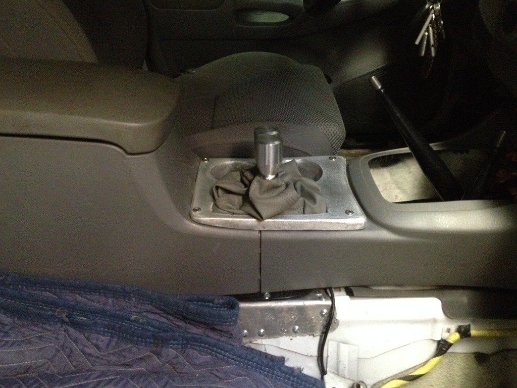

    SAS, with tons, 3linked front and rear…I stopped saving receipts for my sanity

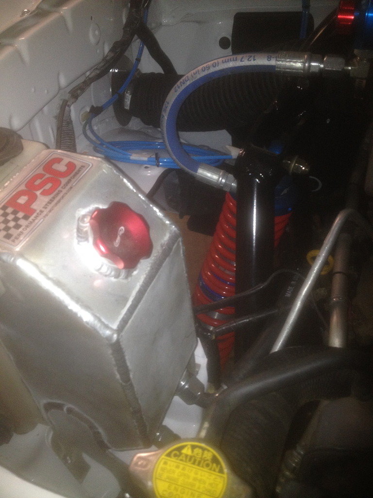

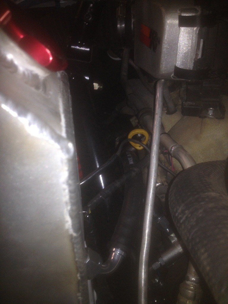

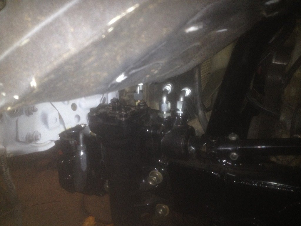

    little progress update for this weekend. I managed to plumb in the hydro assist. I used all compression style "field serviceable" weather head AN fittings. wanted to keep it simple. I plan to carry two 90* fittings and two strait fitting as well as a length of 8' hose. this will give me the ability to completely build any of the power steering system hoses on the trail if need be. it also look a lot cleaner than using the cheap AN barb fitting a lot of guys use on the return side

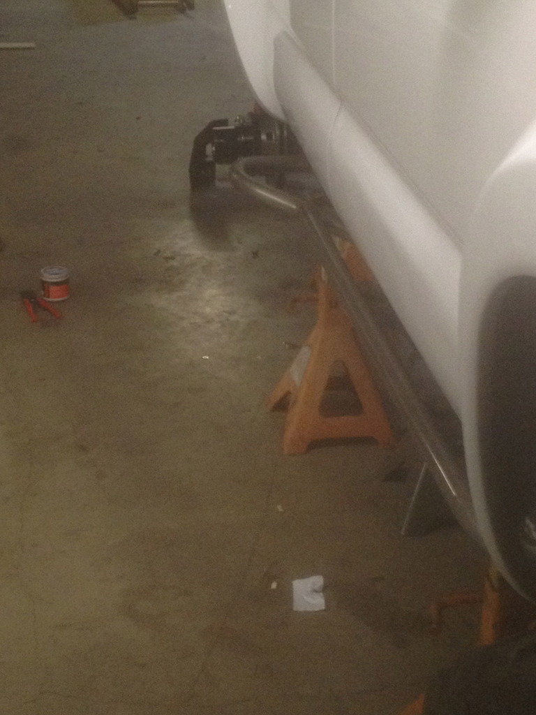

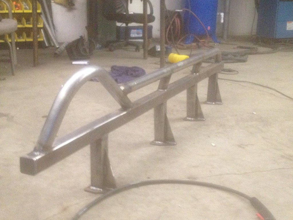

    I also managed to throw together a set of sliders. they are ready to go to powder coat but I will wait until I have the rear bumper finished before it goes out. I typically get a better deal wit the more stuff I take hi for the batch. They aren't anything special just some square tub main bar with DOM outer tubes. I am not terrible happy with them I built them for strength and they have too much weight. I may rebuild them out of 4130 and use thinner material to save some weight.

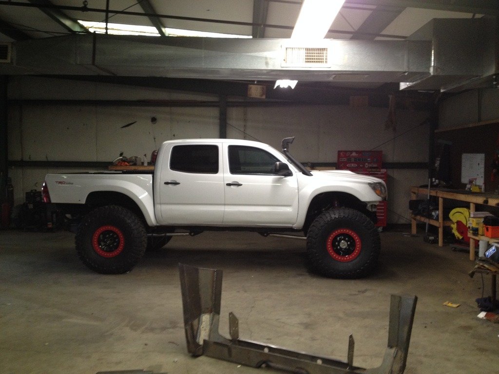

    here is the truck at the end of the day. you can see the rear bumper coming together in the foreground

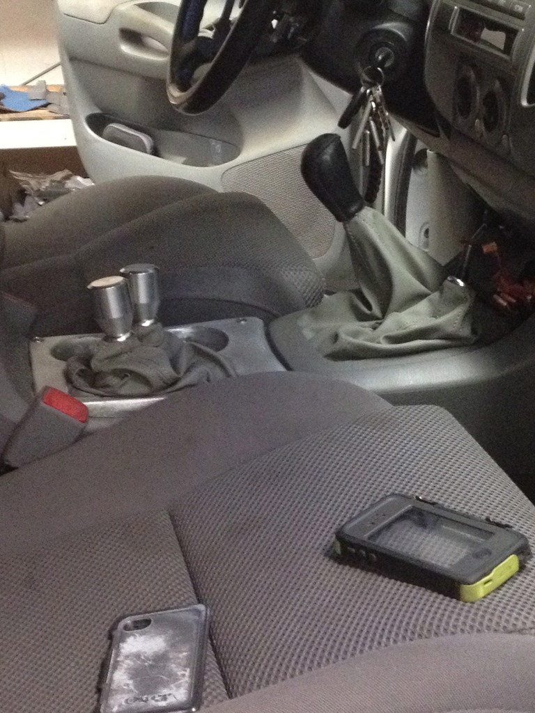

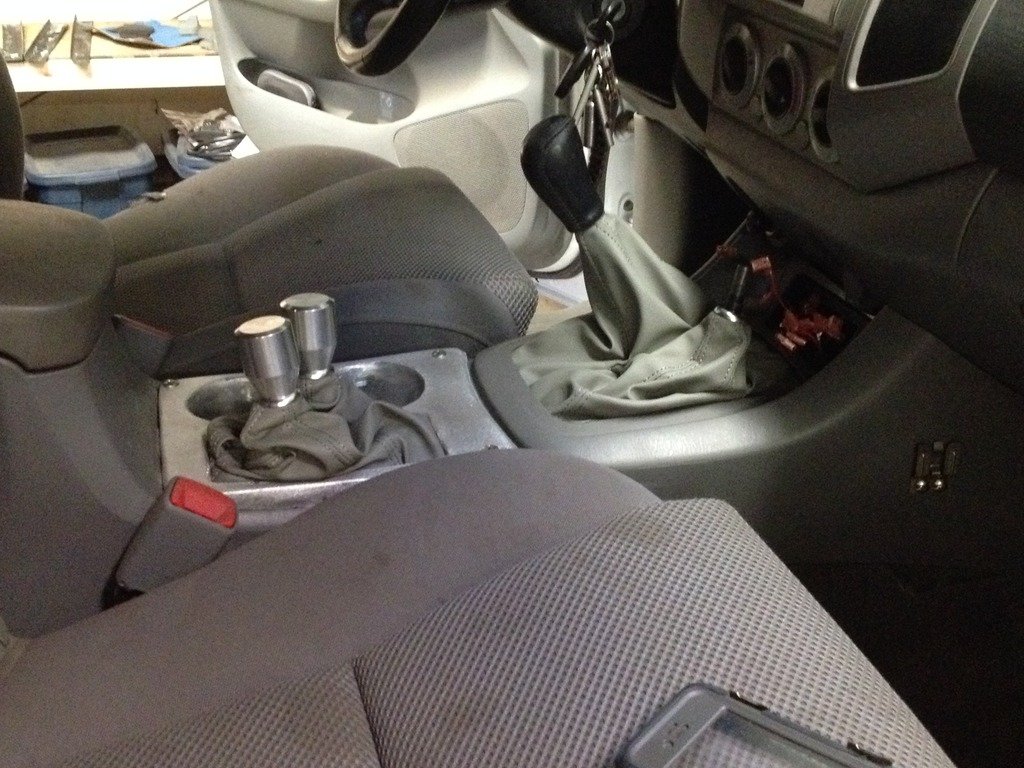

    I saved this part of the update for last because I know a lot of people are waiting to see how it turned out. I am glad that it has been so well received because I have been anxious to build this piece the entire build. I am really pleased with how it turned out.

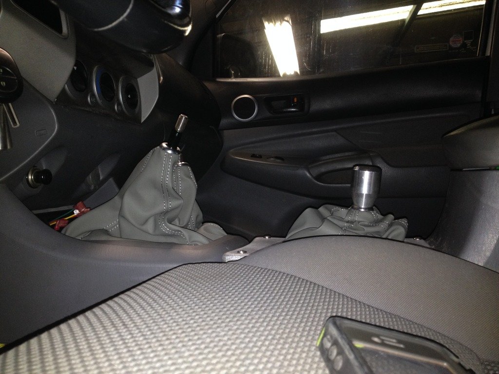

    I am thinking about having some custom shifter knobs made with the correct shift patterns on them for the t-cases. honestly I really like the stock transmission shift knob. But I really like the raw aluminum trim plate and the billet shift knobs.

    Get a custom knob and make it all match, it looks really good though

    Looks good! The cantilever setup is badass, gives me some bad ideas for mine :D Time to trim some fiberglass huh?

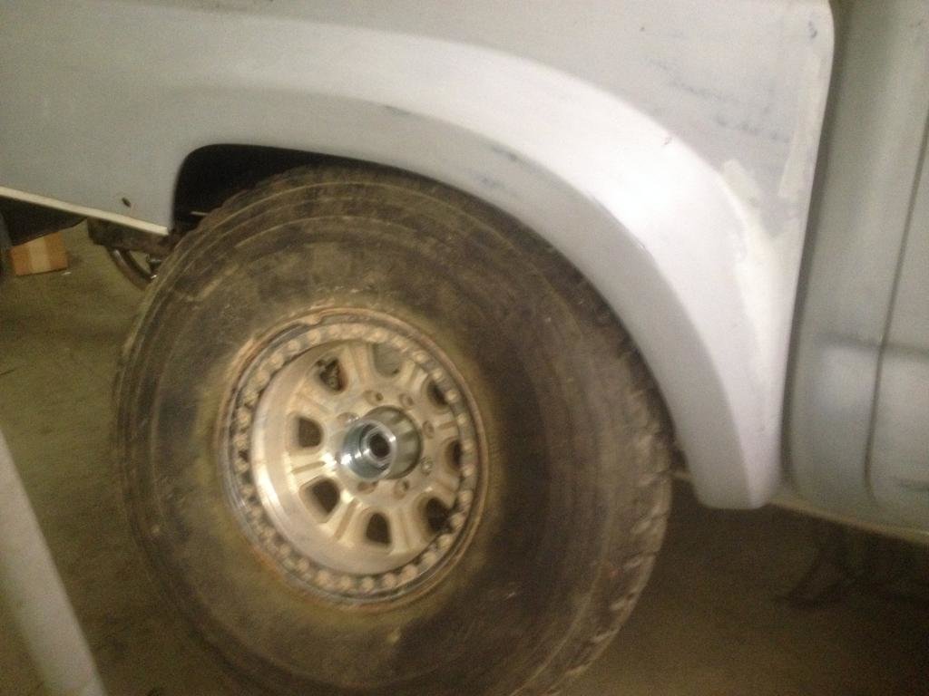

    nope, it actually tucks very nicely

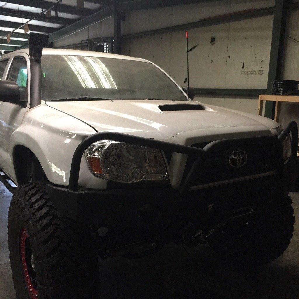

    an update is coming. I am finishing up the last few details. Not much is left. I have the fallowing left to do:
    build the front bumper
    build a tire carrier
    get front, rear, bumpers sliders tire carrier powder coated and install
    mount the spare tire
    install rear axel shafts and slugs
    replace the brake reservoir
    build a clutch reservoir
    bleed the brakes and clutch
    build the exhaust
    pretty much everything is here except the rear axel shafts but they are only a week or less out

    Truck was looking good dude! I was there a couple weeks ago, had David weld up my busted fuel cell. I noticed it looked like you were going to be cutting it close clearing the back of the fenders up front. Have you had a chance to stretch it out any yet?
