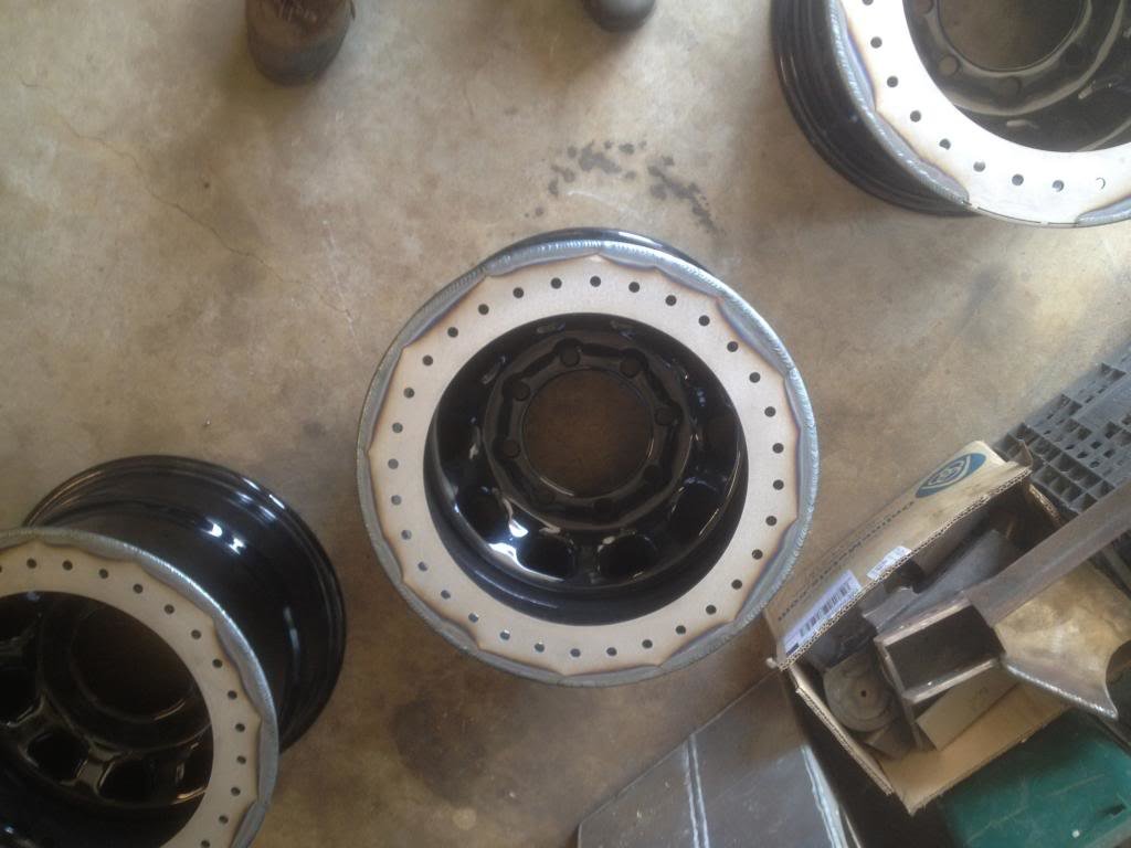

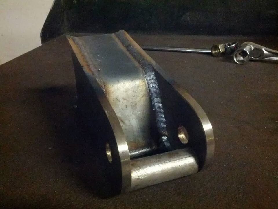

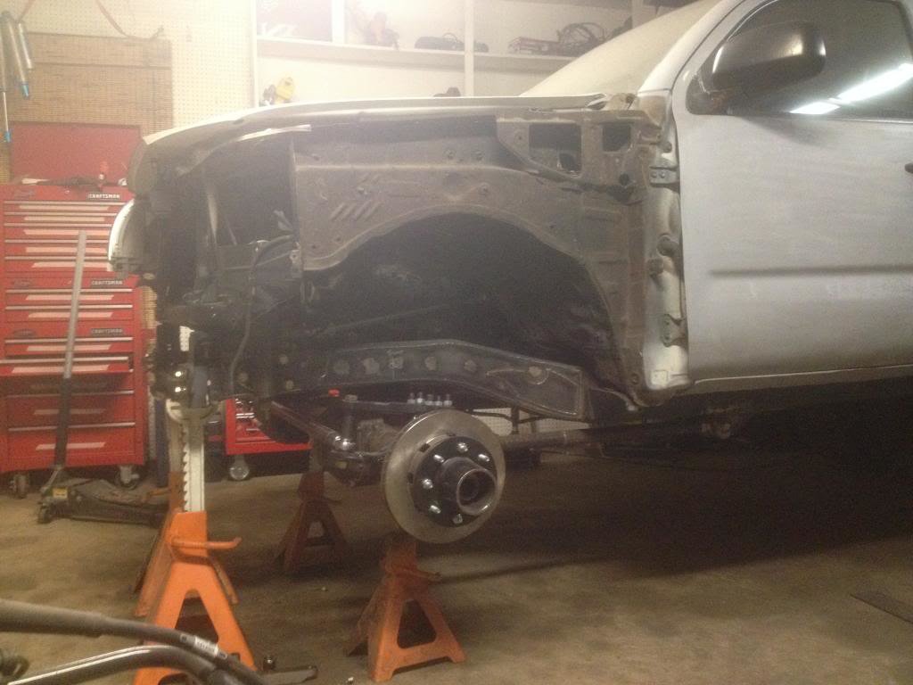

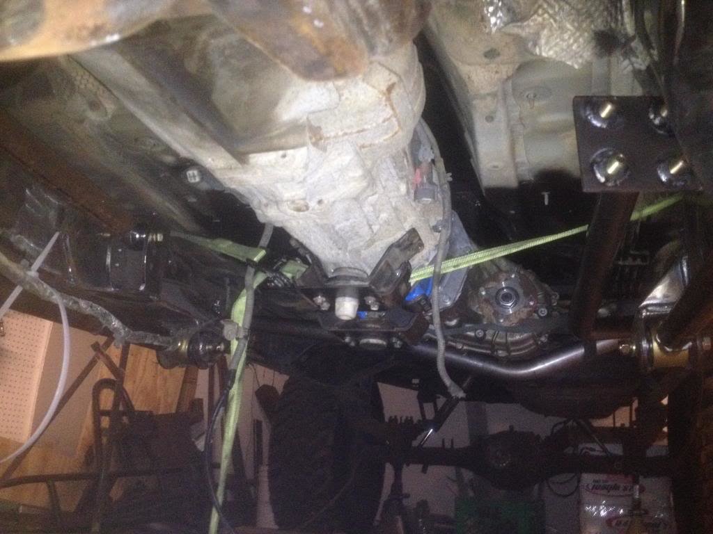

    time for an update…I know some get a upset when its all work and now post so here is some truck porn

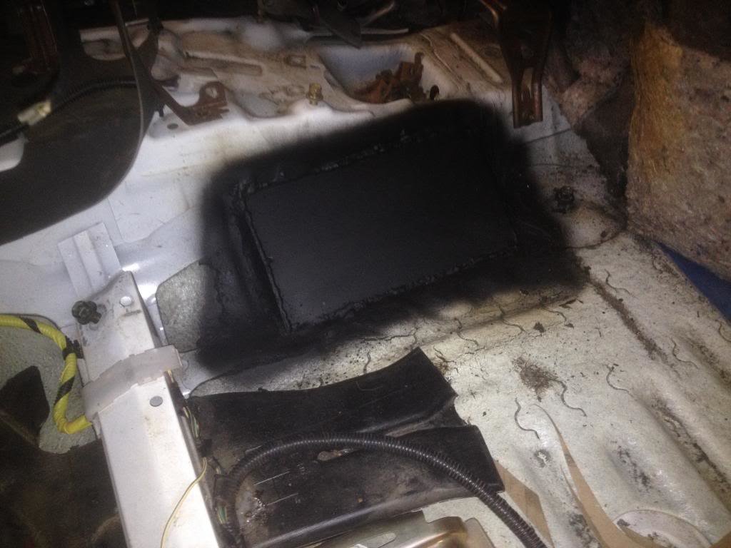

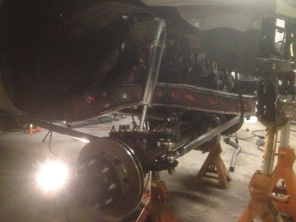

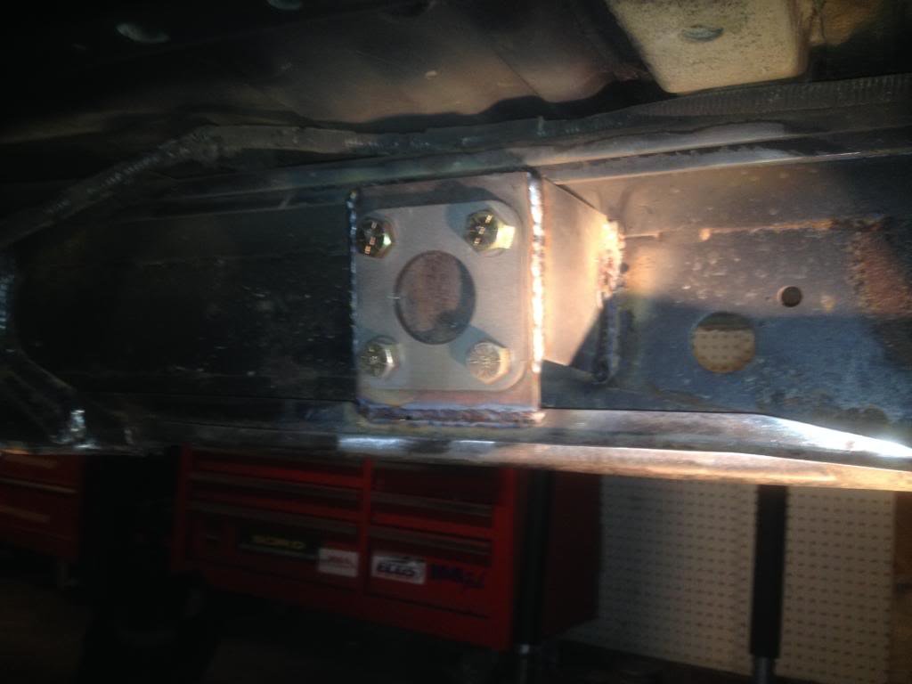

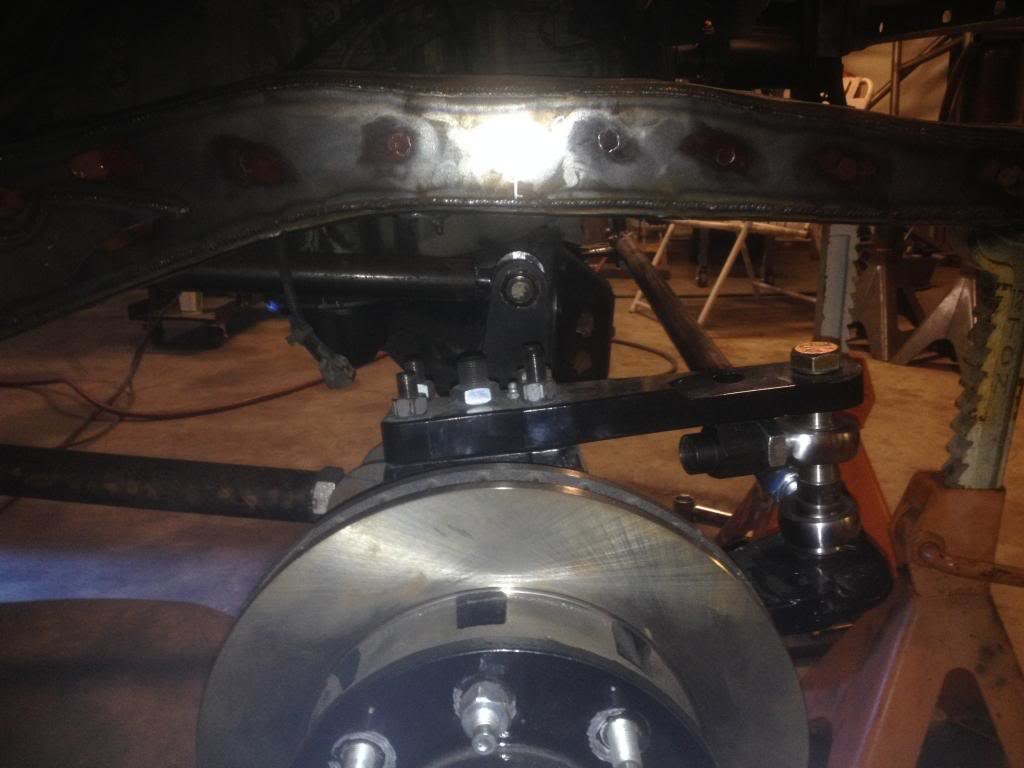

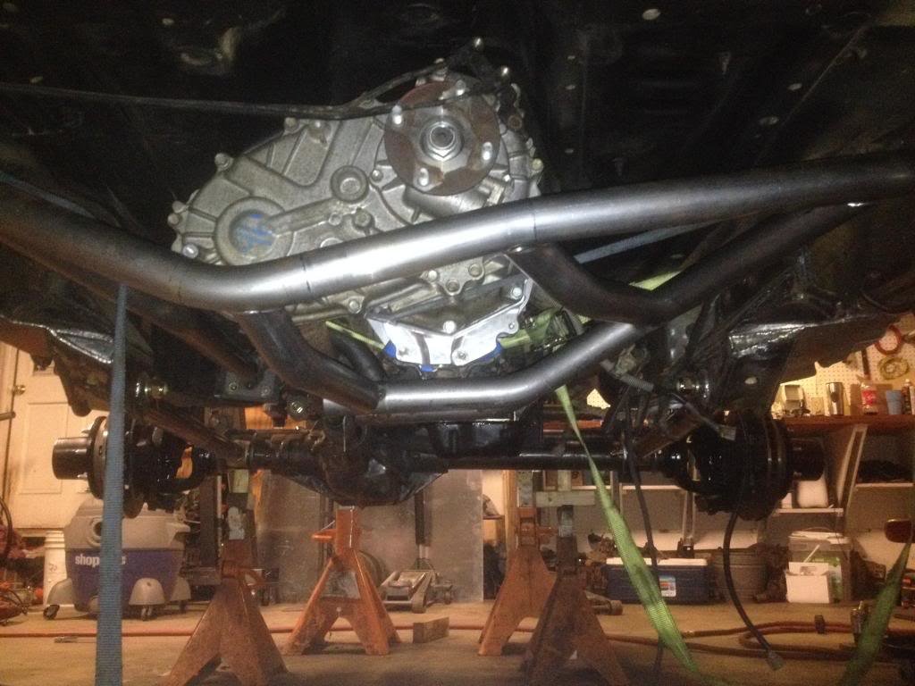

    floor board has been "clearances" to get the Tcase as high as possible

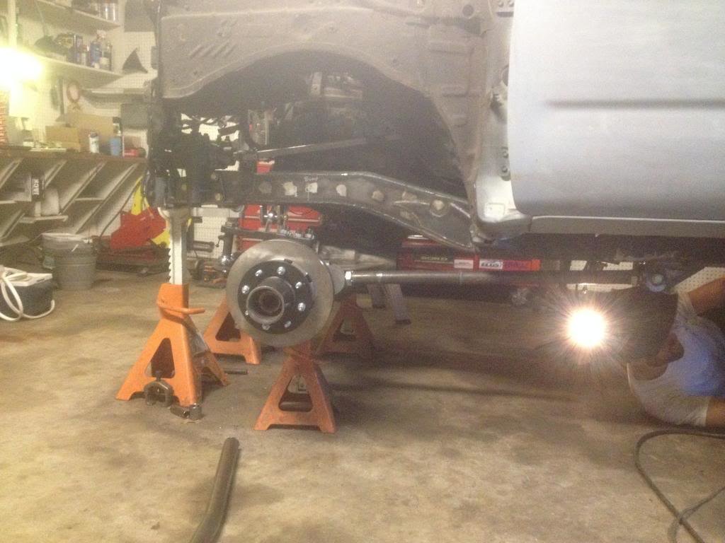

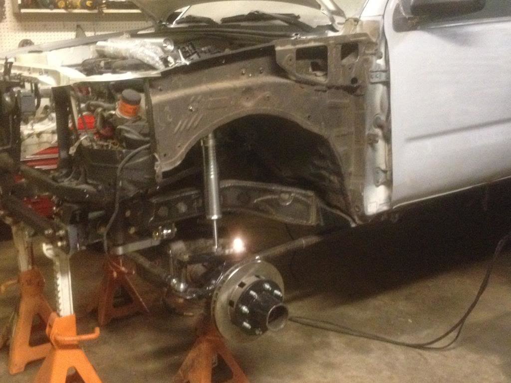

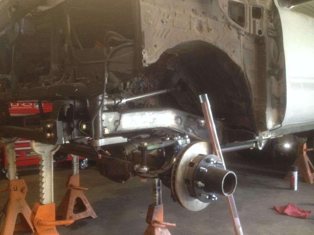

    mock up links are in. The tie rod is finished and TIGed up. Some of these pictures the axel is at static ride height and some are at bump. Aluminum links have been ordered. Still have to figure out the panhard. It more than likely will be steel and powder coated to match the aluminum.

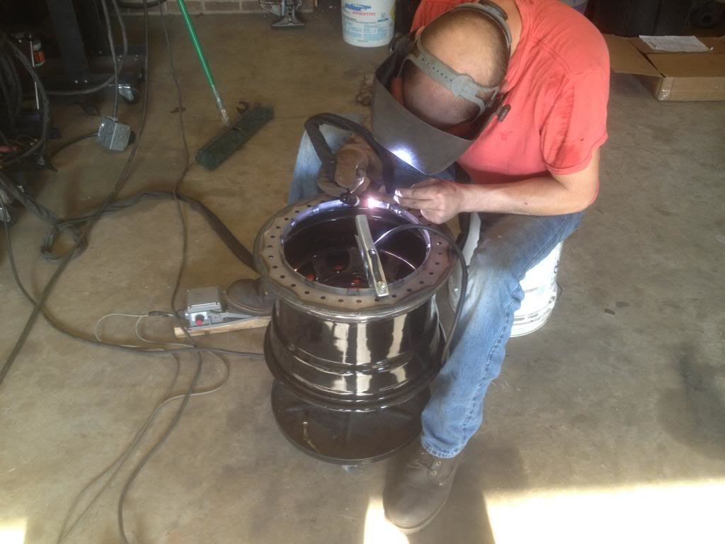

    Wheels FILIALLY got here!!! Beadlocks were TIDed on as was the conning material and the wheels and lock rings have been sent out for powder coating. No half ass welds being ground down refilled and silicone on the back side… all done right there is a full tech write up on the beadlocks on www.NC4x4.com

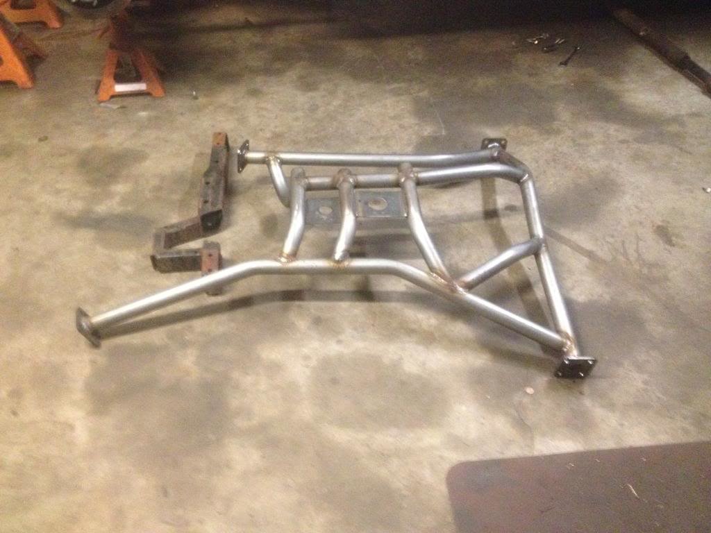

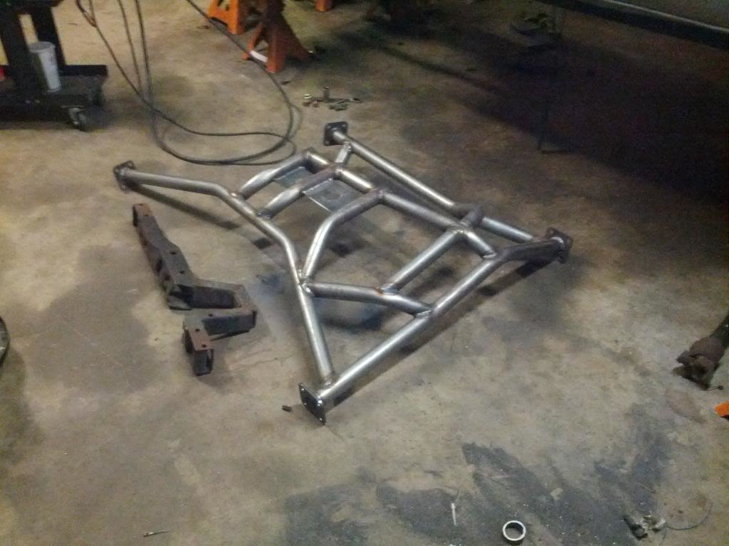

    the crossmember is about 50% mocked up and should be done by tomorrow night. we are approaching the crossmember differently than most. we are using stock Toyota Tcase and trans mount but the design of the crossmember is very different than all the other I have seen.

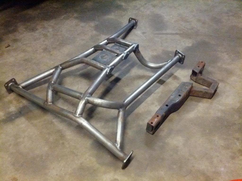

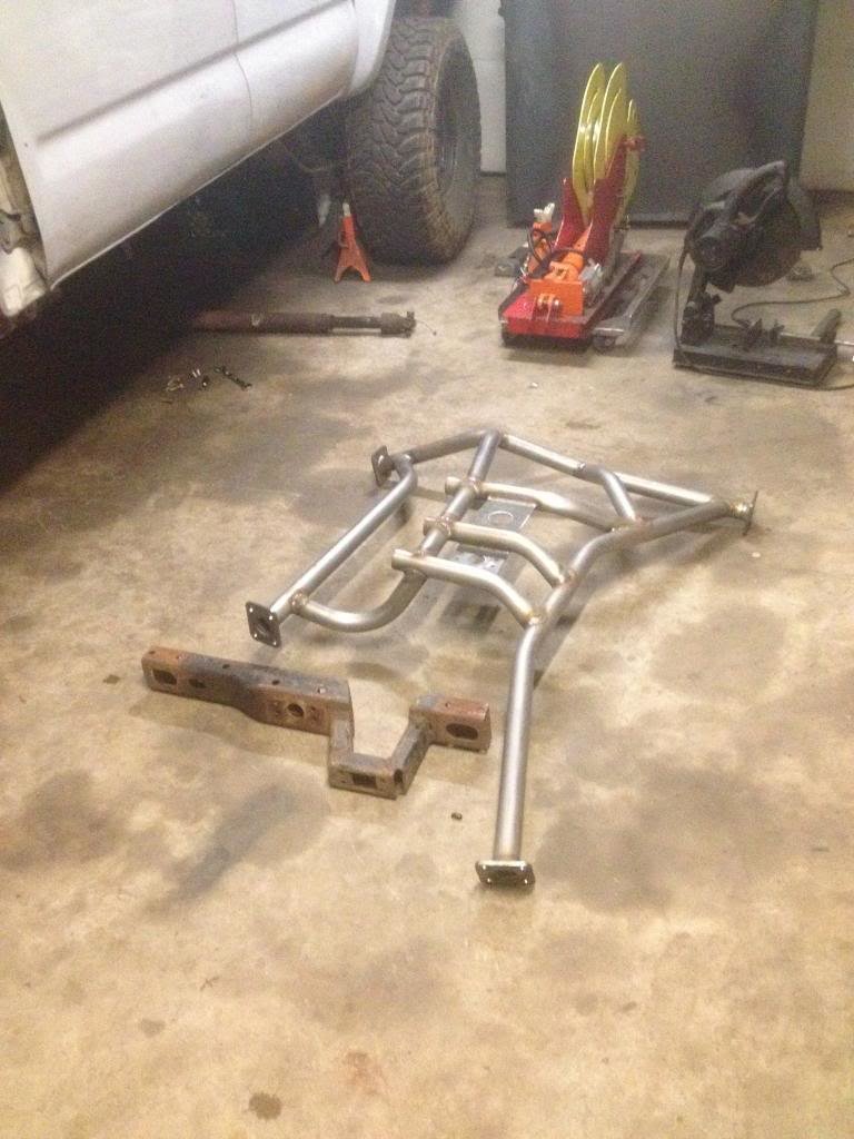

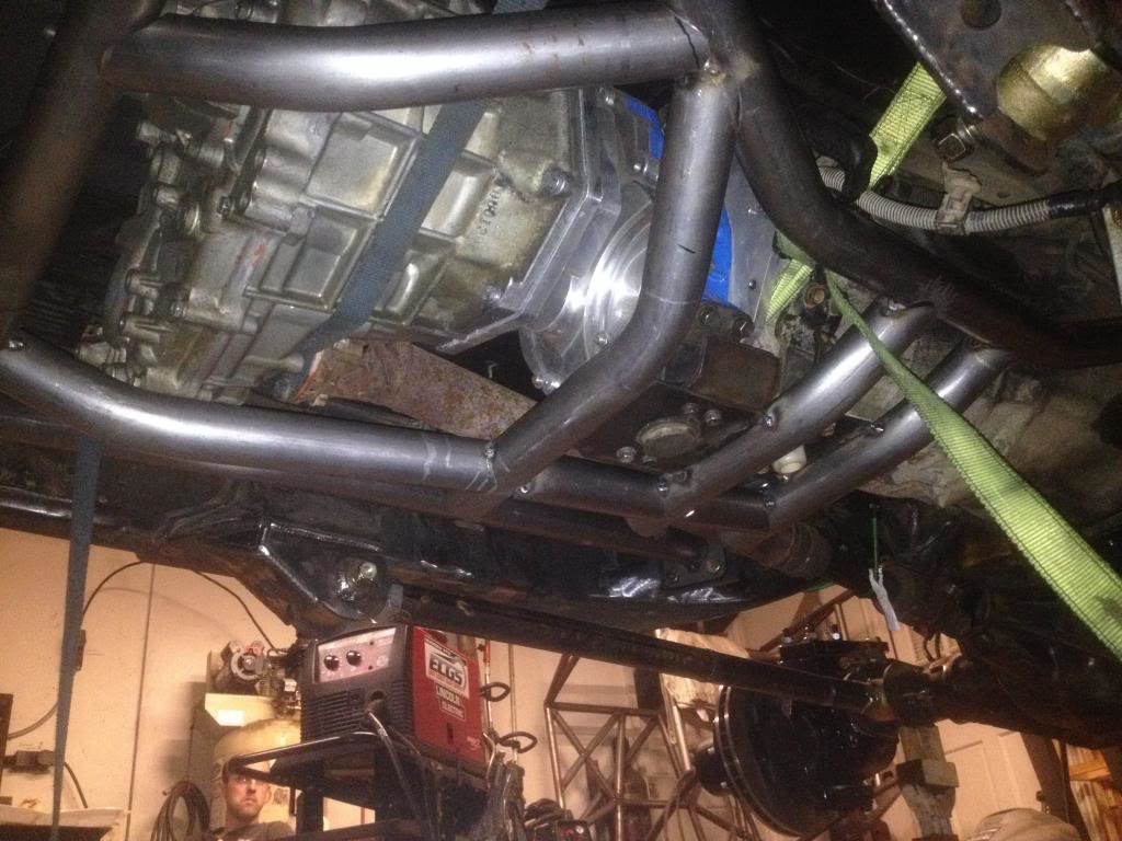

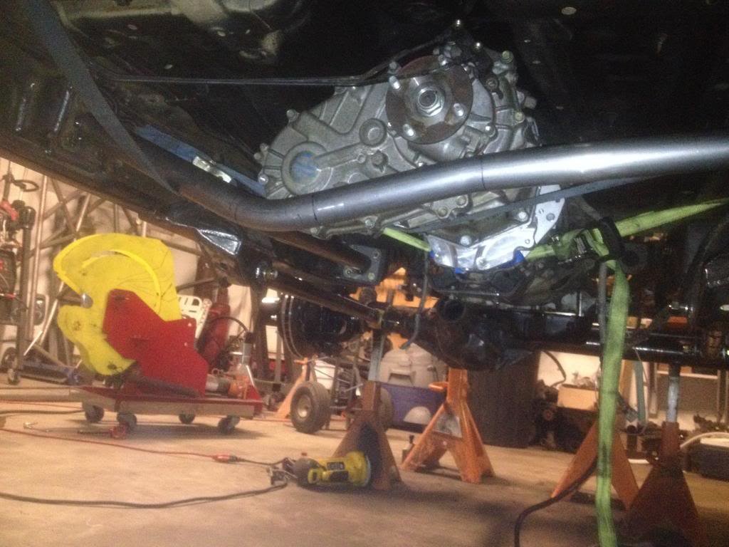

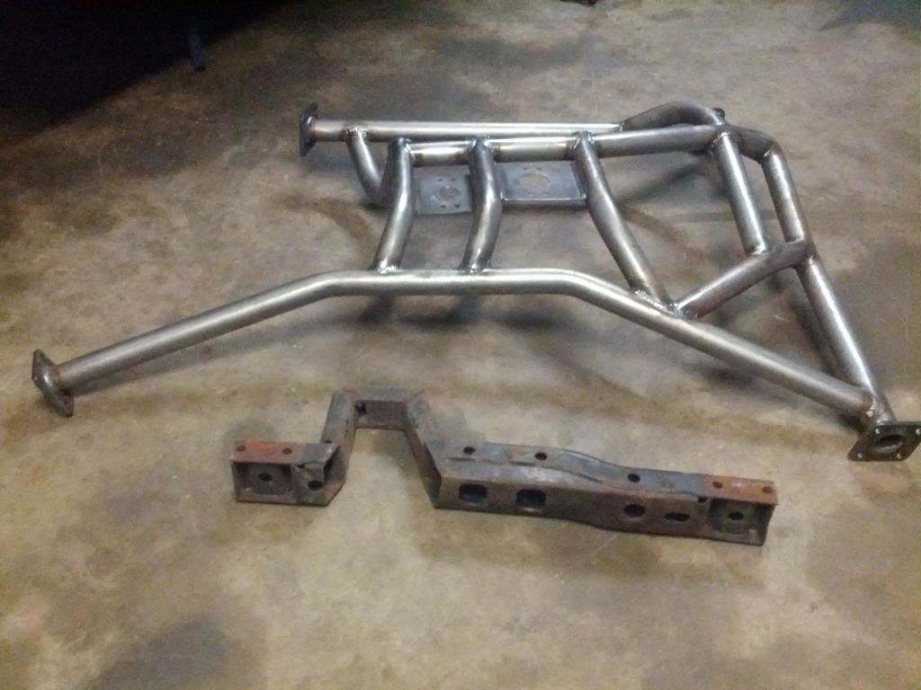

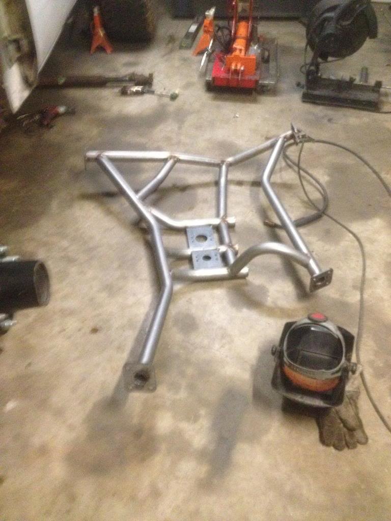

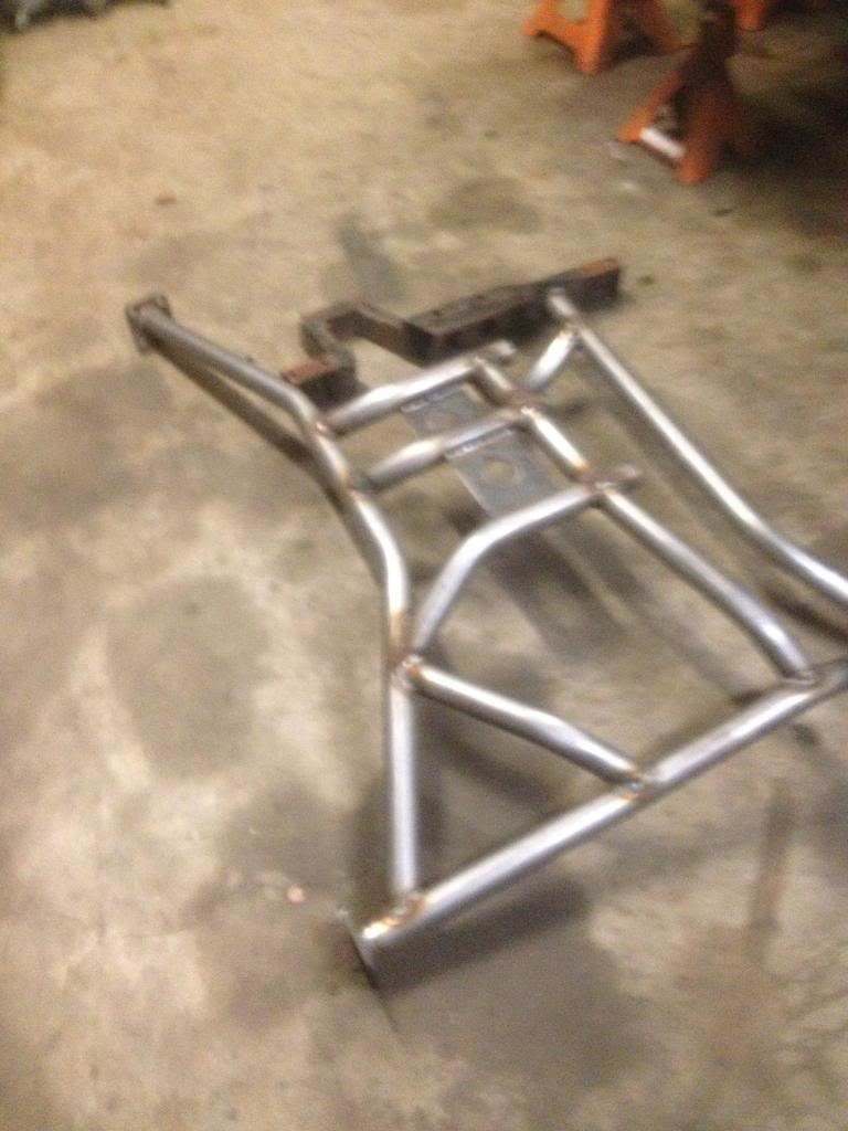

    work has been a little crazy and I have had to travel a bit more than I like to but we were able to get a little bit done last night. we focused on getting some of the crossmember finished. it is still not 100% but it is pretty darn close
    and here are some new vs. old pictures.
    IMG_0763_zps83d7359a_9aa2f551d197e21ab061d45f58f2b9086cf1c564.jpgIMG_0765_zps92ee72c7_f08eb6affc0e3896baeafced1c8c38f9aae15442.jpgIMG_0766_zps0f3586d1_d7ae4530e9691134137691b3f4a82b6ecbfe892c.jpg

    That crossmember is sick :drool: makes the old one look like garbage
