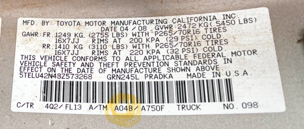

    I have a 2008 trd sport access cab 4x4 sr5 tacoma and as far as I can tell I have a lsd differential. It was mentioned here somewhere that it was in this specific year and trim also. On the lift my rear wheels spin in the same direction and I can get up my snowy incline in 2wd.
    Is there a way to figure out exactly what I've got? I know there's supposed to be a sticker on the rear of the diff but that might be gone since the truck has been rust proofed extensively over the years.
    How do I figure out whats in there?... Havent had the truck long only a month and a half or so.
    Thanks and glad you found all you needed and your trucks up and running
    #30

    @jbolts - you get the axel code off the inside door panel- the last letter in the code tells you whether it is e-locker, open, or LS. A=open, B=e-locker, C=LS. I’m pretty sure anything after ‘06 is ELS and not MLS?

    That's what I thought but some one mentioned specifically my model being equipped with an lsd diff. Last year before being phased out.
    I'll go to check the sticker right now actually.

    A04C
    So it is indeed a lsd nice
