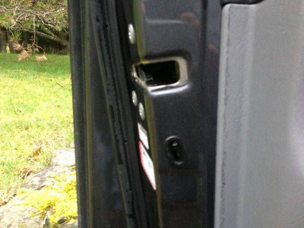

    You mean this
    You , and the others who said it was the child locks were correct , that small lever had been inadvertently tripped
    I misunderstood and thought people were talking about the master lock buttons on the front doors that control the rear door locks
    Emergency averted , thanks for everyone's help
