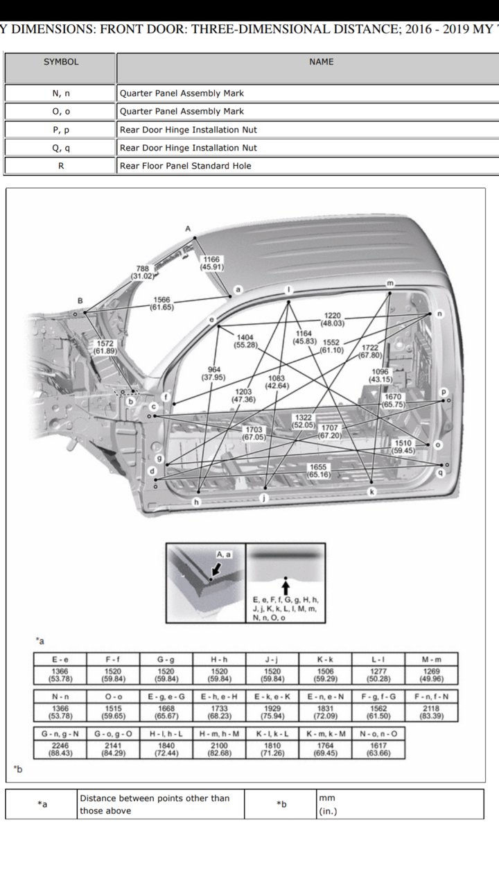

    Good time to test fit the windshield to make sure everything lines up correctly. When I get into work later this morning, I’ll check for dimensions for the windshield opening.

    Ya, I should start shopping for one. My brother in law works for Safelite so I should see if he can get a deal on one.. I have some dimensions, just didn't have any for the height of the roof at the middle of the windshield opening. I git this from the local dealer.

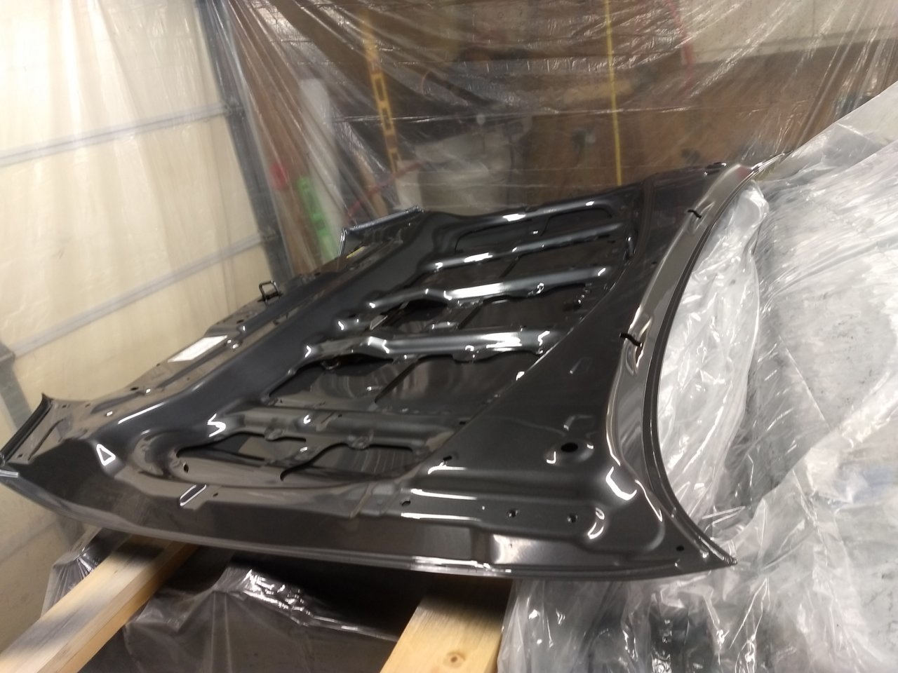

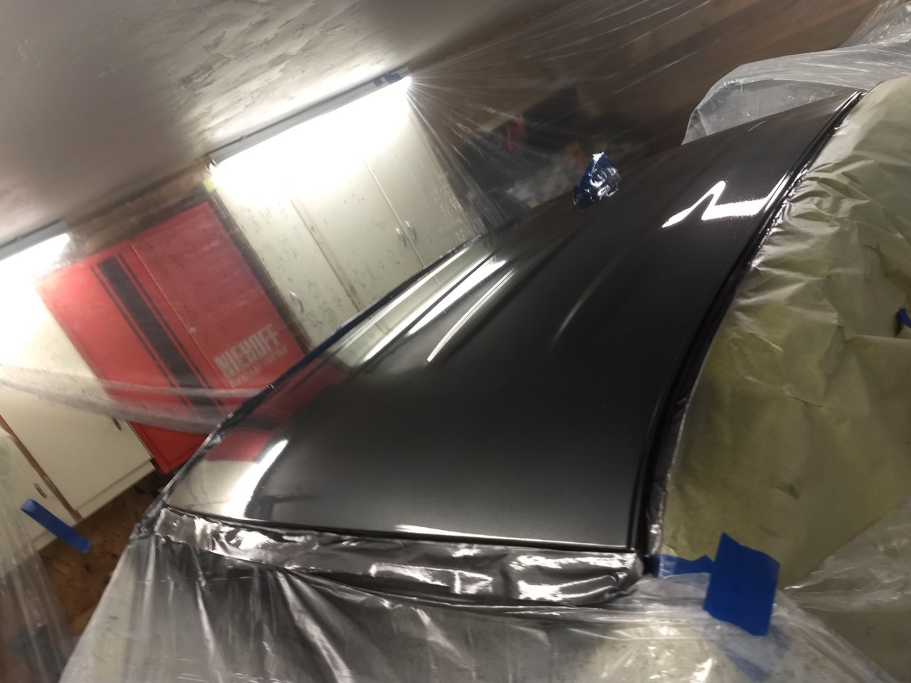

    The painting is done. Had a heck of a time trying to buff out 2000 scratches, I think because I waited a week after clearing it. Ended up picking up some 3M trizact 3000 and 5000 and it came out glass smooth no scratches. I use lake country orange pad with meguiars m105 and the white pad with m205. My second time buffing so I'm still learning..

    I would have gone scooped if I didn't get a takeoff hood for 175$ from someone swapping out for a scooped hood.
