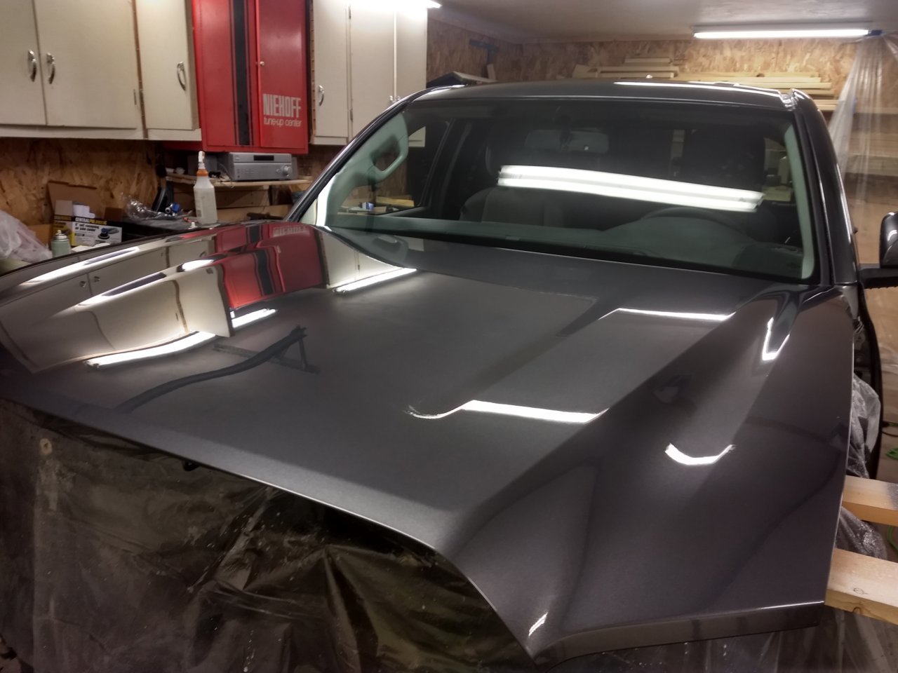

    For Megs m105 try using their microfiber buffing pad. It cuts so much better than the LC orange or yellow pads. I spend much less time using the microfiber pads than any foam pads.
    Also, while I have megs105, try Menzerna Heavy Cut Compound 400 if you can. It polishes out so you don't need to use a 2nd stage polish unless you want a super fine polishing for jeweling the paint. My only complaint is that it dusts more than other compounds.

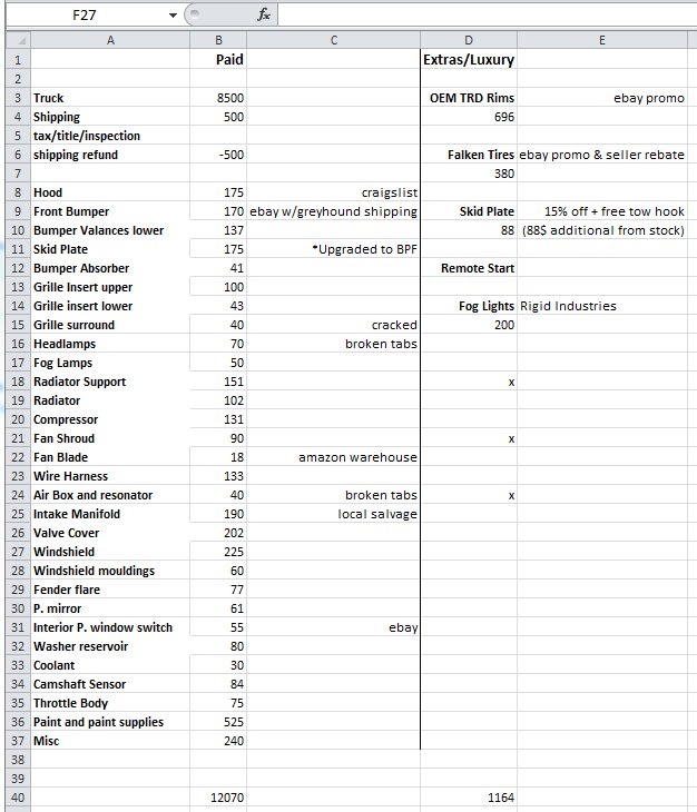

    Thanks for all the replies and support thus far!
    Here is an updated spreadsheet, I removed my estimates column. What I have paid is on the left, what I consider to be extras or luxury items or "above oem restoration costs" are on the right.
    Sorry for the lack of updates, but there has not been much to report. I just haven't had the time. I did get a few things done. I had a bunch of codes that I was able to get rid of by replacing a camshaft sensor, and the engine wire harness. I now have no codes, but the thing still wont start. I am getting a noise from the throttle body as if it's stuck, so I have a new one on the way and hopefully that does the trick.

    Nice use of spreadsheets to track everything!

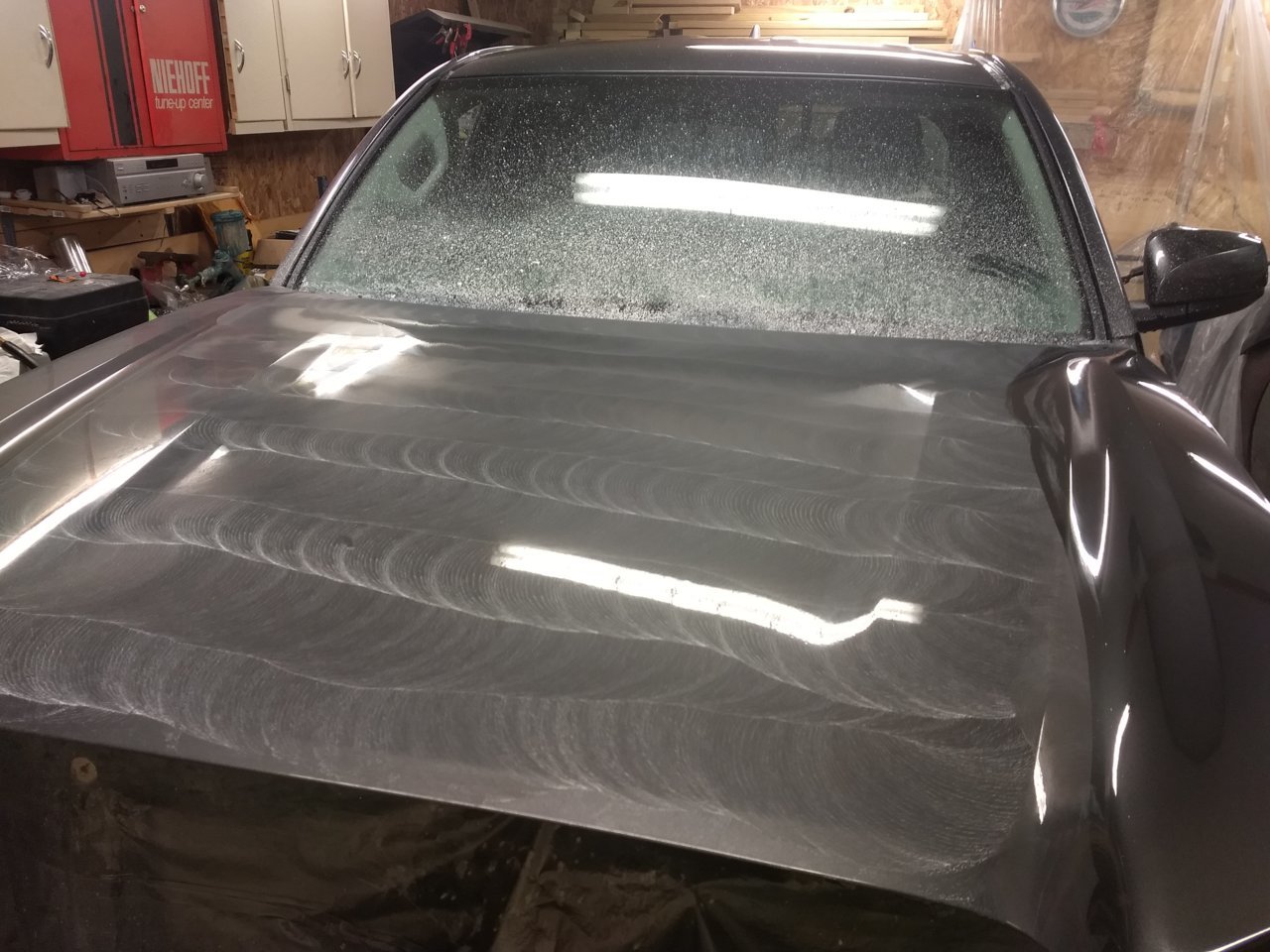

    Just a tip, work in smaller sections. I work in about 2'x2' or 3'x3' sections at a time. Looks like you're using more product than you need as well. Just a few pea sized dots around the pad is enough.
