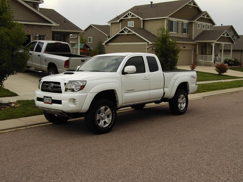

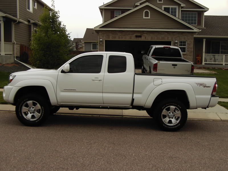

    Just picked up the truck with the Billies set at 2.5 and the pro-comp rear 1.5" leaf.
    Using the same points of measuement the front is now 38" on the nose and the rear is 39" on the nose.
    Truck still on stocker wheels and 265 BFG's as the UPS guy is out cruising around the hood with my wheels as I'm sposed to get them installed tonight at Disgruntled tire....
    Needless to say the 5100 set at 2.5 do not ride rough like I thought they would they ride firm and actually really nice. The rear with Pro-Comp AAL is perfect and I'm glad I passed on the TSB springs as it would have had too much rake. I'm actually hoping the ass end settles a bit as its raked a tad much as it is.
    So heres how she sets with the 2.5 Billies and the pro-comp AAL...Any higher in the rear would have made for an undesirable rake IMO.....Man I need the UPS guy to get his ass here before the tire joint closes!!
