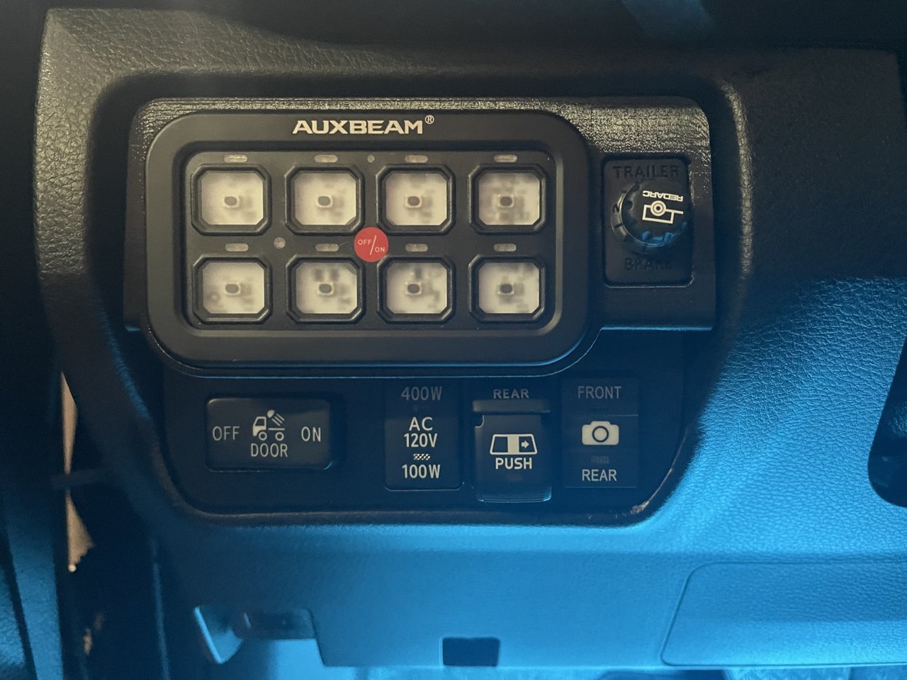

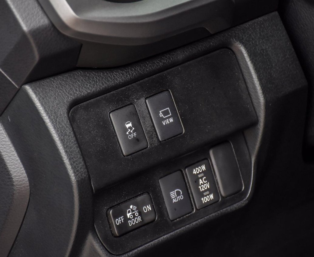

    The one thing I wish the Pro had that it doesn't is a trailer brake controller. I'm OCD and not willing to drill into my dash, so the Redarc seems like the ideal solution. The trouble is that I don't have a normal/small blank available in the Pro. The only blank I have is where the Clutch Start Cancel button would go in a manual transmission truck, and it's a bit larger than every other button/switch. Does anyone know if there is a blank for the Redarc that would fit this? @REDARC_Ryan is this something you guys provide?

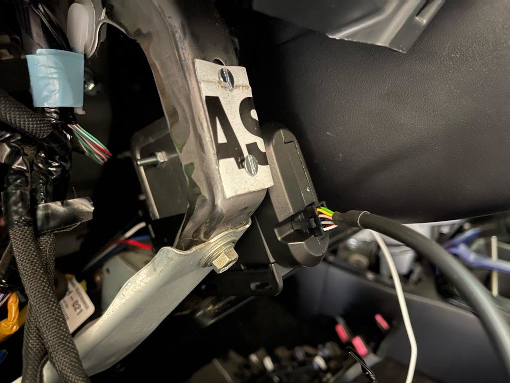

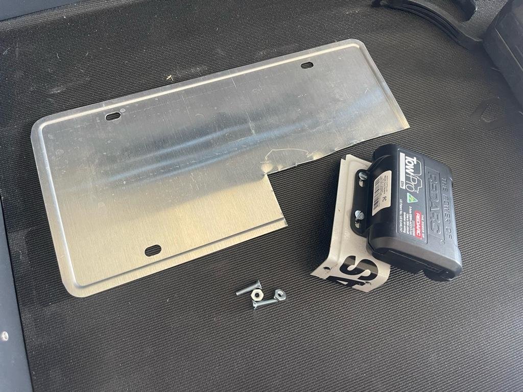

    Also, @pgfitzgerald do you have any of the mounting brackets remaining? Looks like a much more secure way to mount it.

    https://www.redarcelectronics.com/us/switch-insert-panel-to-suit-toyota-tundra-tacoma
    I'd just get an aftermarket dash panel and cut a little. :sawzall: It's looks fine.:notsure:

    Yeah, that's exactly where I installed mine.
    I bought the package deal or combo or whatever they called it, and it came with the TPSI-001, which is the square-ish one I couldn't use.
    So I also bought the TPSI-007, which is the right one for that spot. (So I concur with MGMDesertTaco in his post above)
    Yes, I have brackets if you want one. Just send me a PM. :D

    The default Tacoma switch blank is small since we MT have the tall spot occupied. It’s a great choice for AT though.

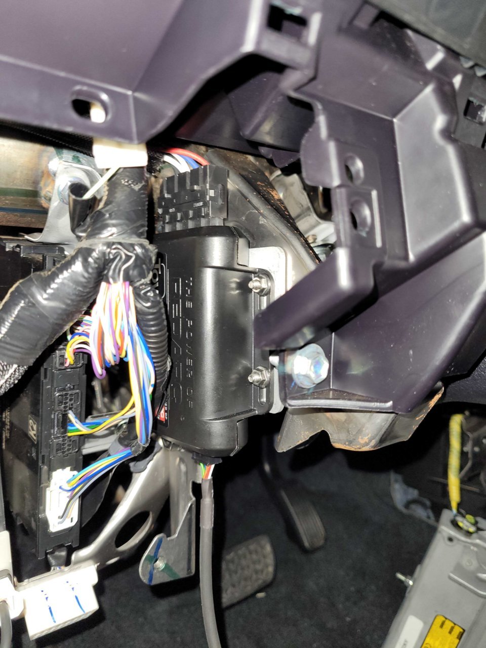

    I made my own bracket for my 5g 4Runner. Didn't realize the kit didn't come with a mount until I started installing it.

    I ended up doing the same. Used a flat bar and bolted it to the same bolt hole.

    hi @pgfitzgerald - thanks for sharing this, do you have additional mounting brackets that i can buy, i am planning to get REDARC break controller installed in my new '23 Tacoma. thanks in advance.

    I do have brackets available. Please send me a PM.
