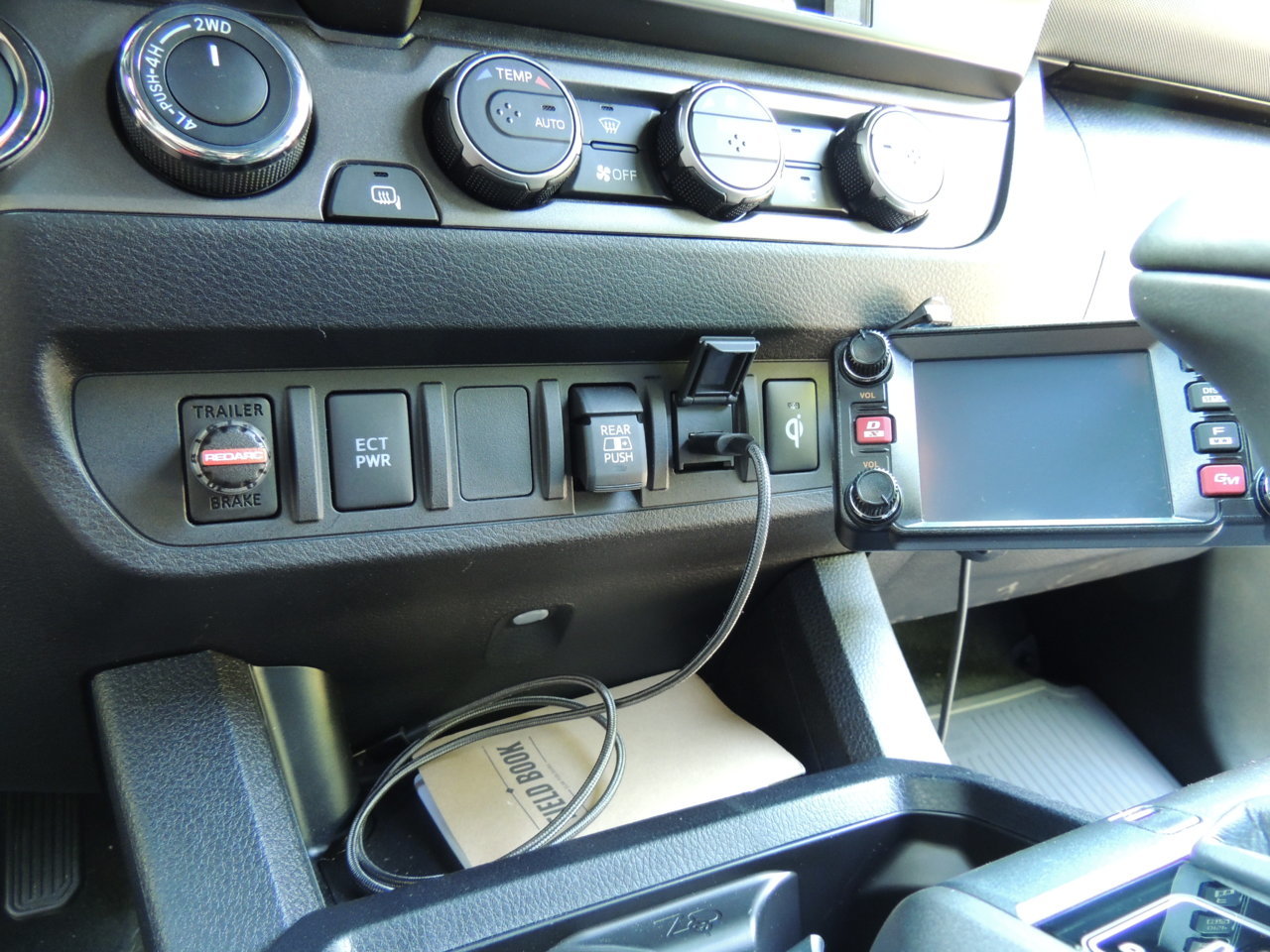

    This mounting spot for the control knob has the added benefit of allowing you to start the truck with one hand without having to get in and step on the brake. Hold the knob in and press the start button....thanks to whoever pointed that out! That will come in handy this winter when you just wanna start the truck without getting in.

    How have I never known about this!?! I used the clutch start cancel frequently on my manual first gen and my tow pro knob is in about the same place...

    Tried this for the first time the other day, slick little feature. Obviously I won't use it all the time, but definitely handy on occasion... Got lucky & accidentally put my REDARC knob in the perfect spot, haha!

    Same here. Although I have my dial on the left side, it still gives the convenience of starting the truck without reaching your foot for the brake, just takes both hands instead of one. Pretty neat feature.

    So, I tried this the other day with my '16 MT and, doesn't work without clutch start/cancel. Is there something I'm missing or is the button AT only?

    Some are not going to like the following feature: but I did some experimenting and found that by just pushing the RedArc brake button the shifter can be moved out of Park. Without the BRAKE pedal being pushed! I'm not yet sure how I feel about this. As long as I don't get into some BAD habits it will be fine... I think. This is most likely the same with any Trailer Brake controller, not calling out RedArc.

    What is the "head" unit to the right?

    That's a Yaesu FTM-400 VHF/UHF ham radio

    Thanks, I'll have to look that one up... Nope, just did, seems to be discontinued.

    Yeah...it's been replaced by the FTM-500. Had one on order, but decided to keep this one due to screen size.
