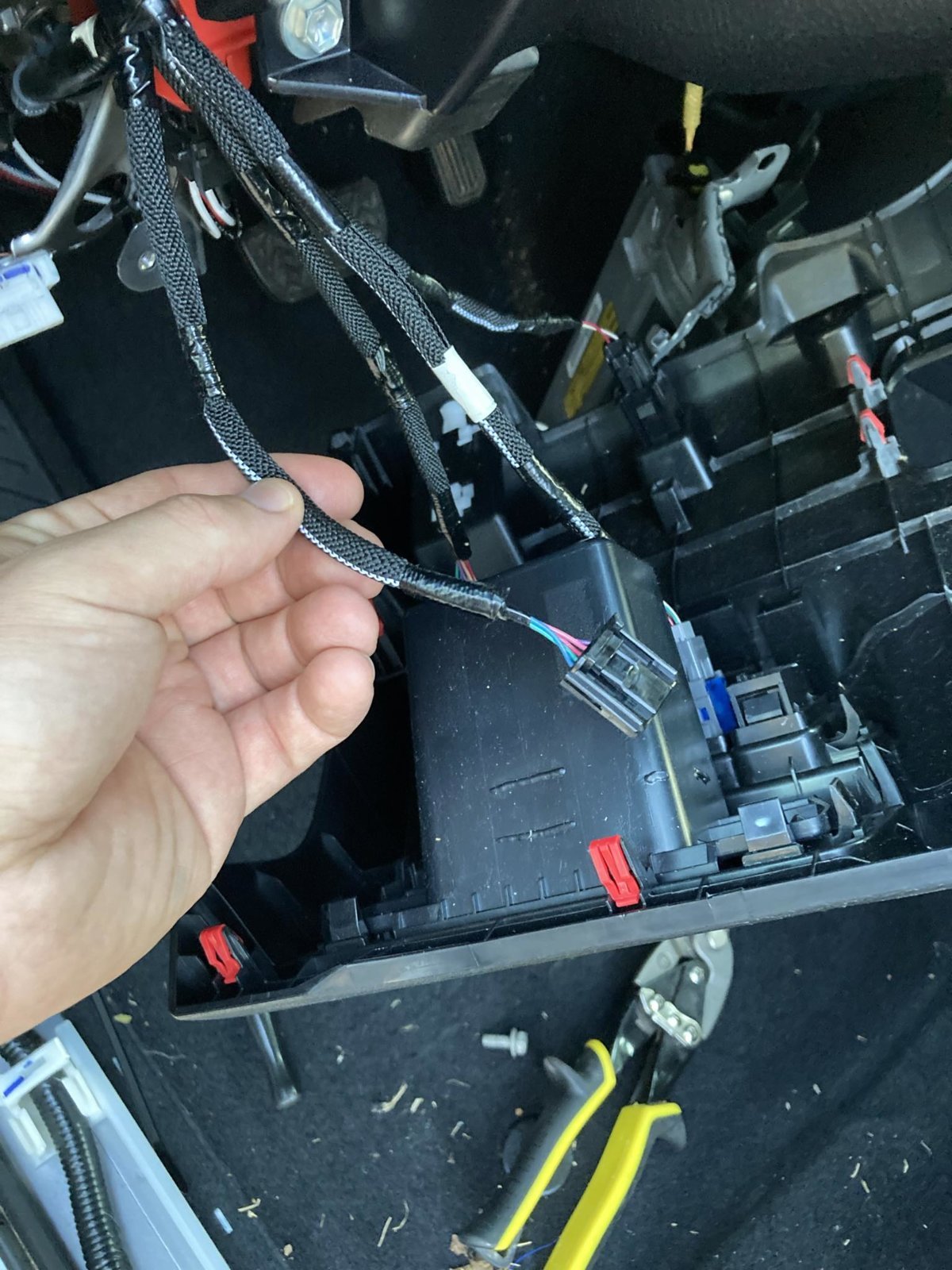

    2018 SR5 Crew Cab Long Bed 2WD

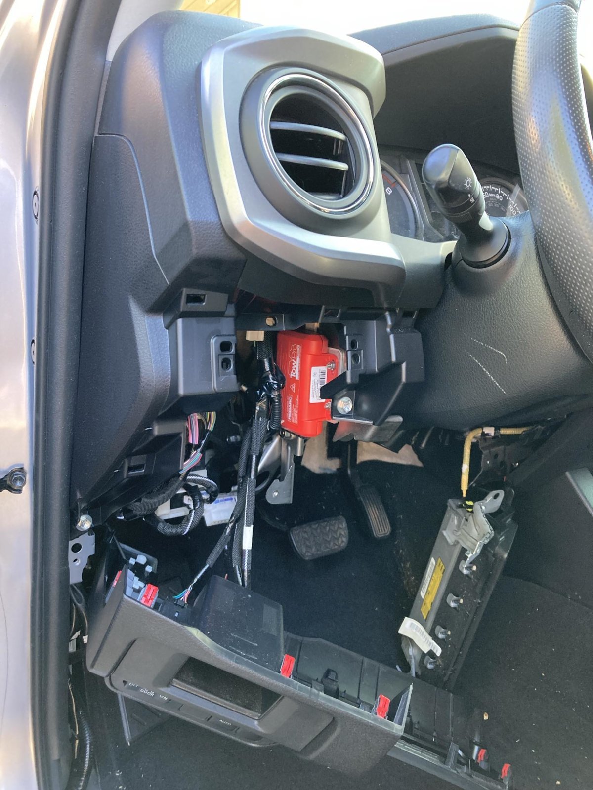

    I got around to installing it this evening. It went very quick, but I'd pretty much memorized every video about installing it that I could find. The bracket 'just worked' and I'm glad I had it. No issues really, everything was pretty plug and play. I did find a good hint about popping out the blank in the console, I didn't have to removing anything else, I was able to fish the wire through with a stiff piece of coax that I had in my junk cable drawer. Powered up and shows blue, like the manual says it should, so I think I'm good to go. Just have to get the brakes on the trailer.

    By the way, I have this wire that doesn't seem to be going to anything, any idea what it is?

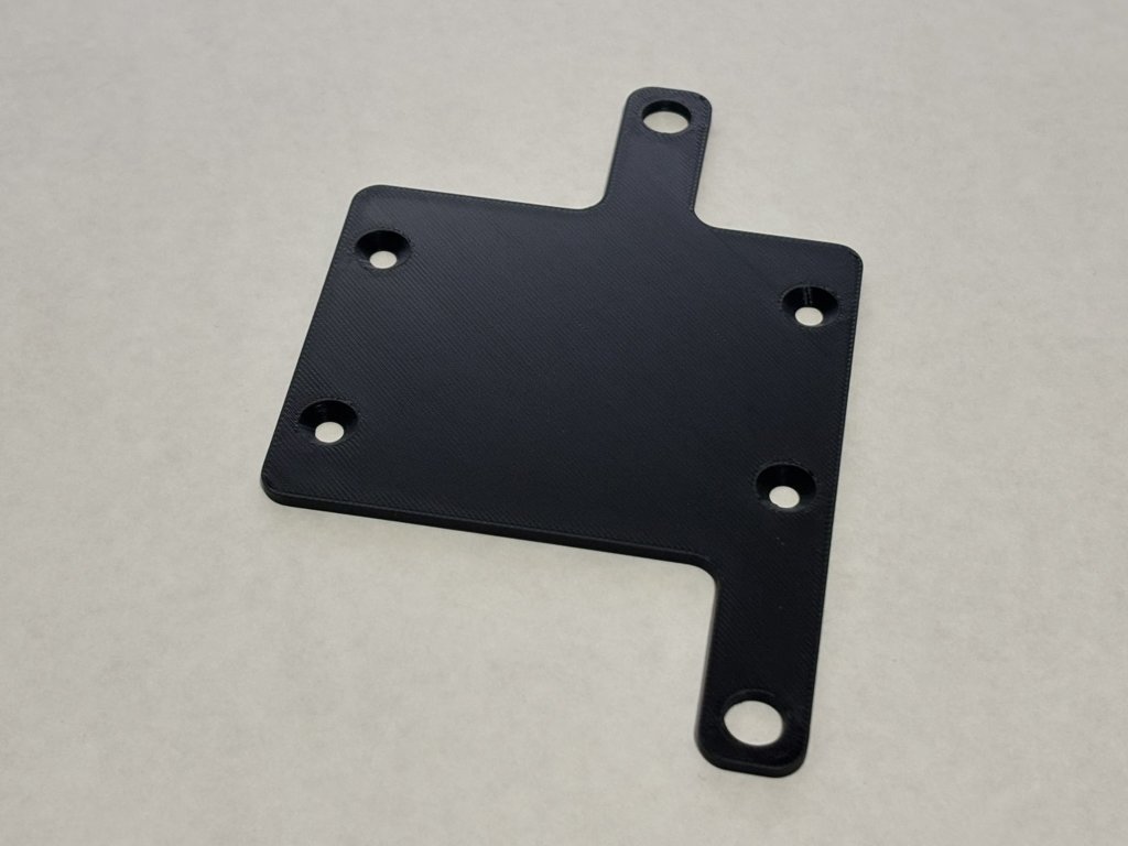

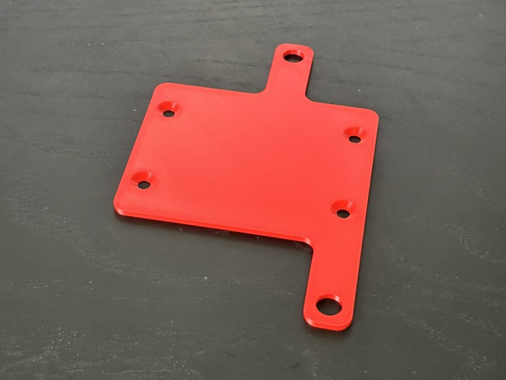

    Now available in Black or Red ASA to match the Tow-Pro Elite and Tow-Pro Liberty!
    Still available in laser-cut 10-gauge 5052 aluminum as well. :)
    Low stock right this moment due to a pending fasteners order. Give it a few days and I'll have plenty on hand.
    https://lucianmade.etsy.com/listing/1417438984
