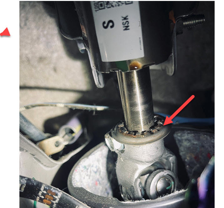

My retaining clip has fallen down from the collapsible steering shaft.

    my retaining clip has fallen down from the collapsible steering shaft.
    toyota is saying cause im lifted its not under warranty and I have to get a new column, do you know if that clip can be pushed back in or anything cause toyota is saying it cant and ive tried.. how do i prevent it from breaking again in the future?

    There isn't anything in the service manual about tearing down the column, so I suspect Toyota would just replace the entire thing as they said.
    You might have to take it to a specialist.
    Below is a photo of mine. It appears to be a pressure fit ring. Yours might have some of the fingers broken off?

    ya toyota is going to replace it but im paying 1500

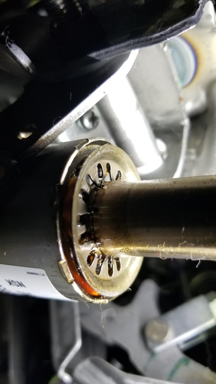

    17tacoOR
    samething happened to mine. just push it back up and life is good

    you can't push it back up there? its not easy but heres bow I did. pull the shaft all the way down and it hold it. push the ring up as far as you can with your hands then with a wrench start tampering it in. it will in with some effort.
    if you pull the shaft all the way down you should be able to see a groove. the groove must be below the sleeve.
