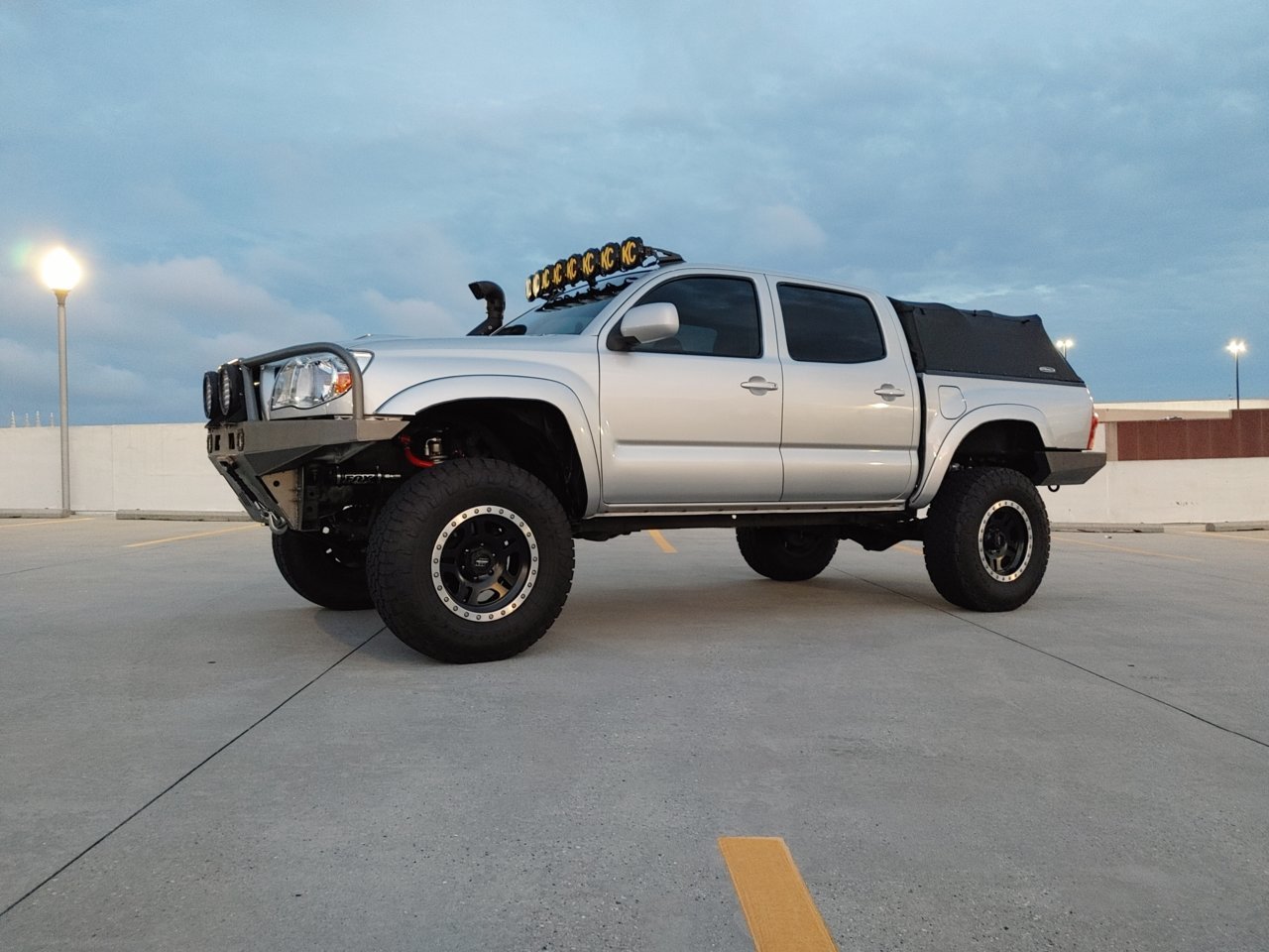

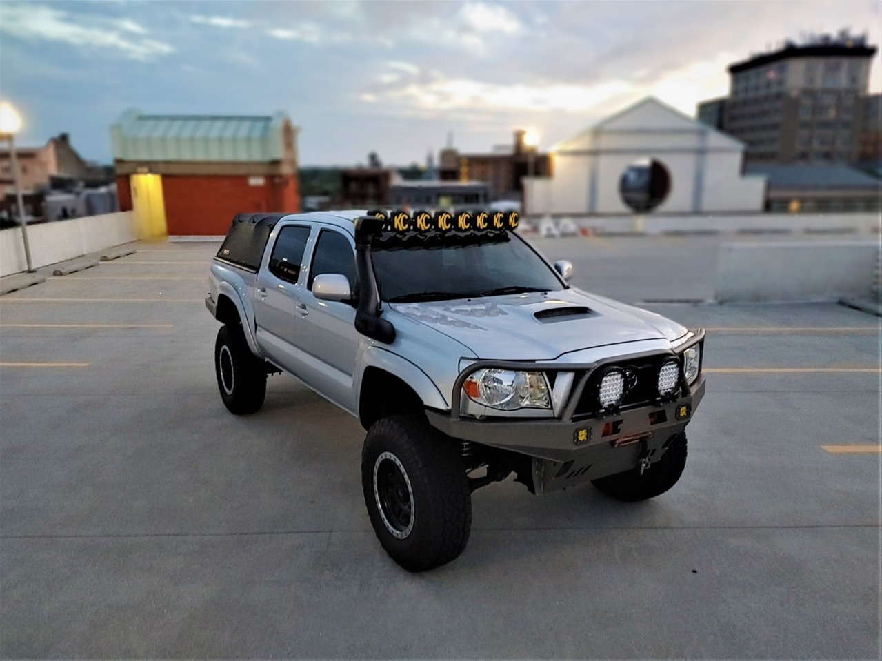

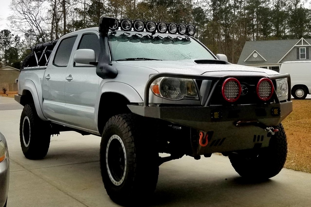

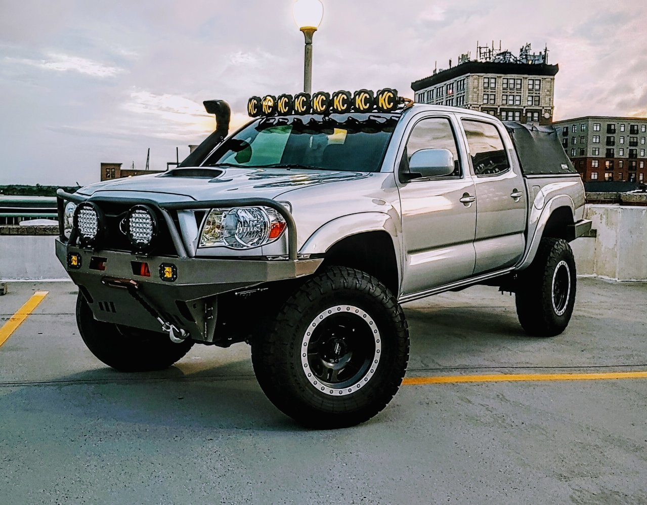

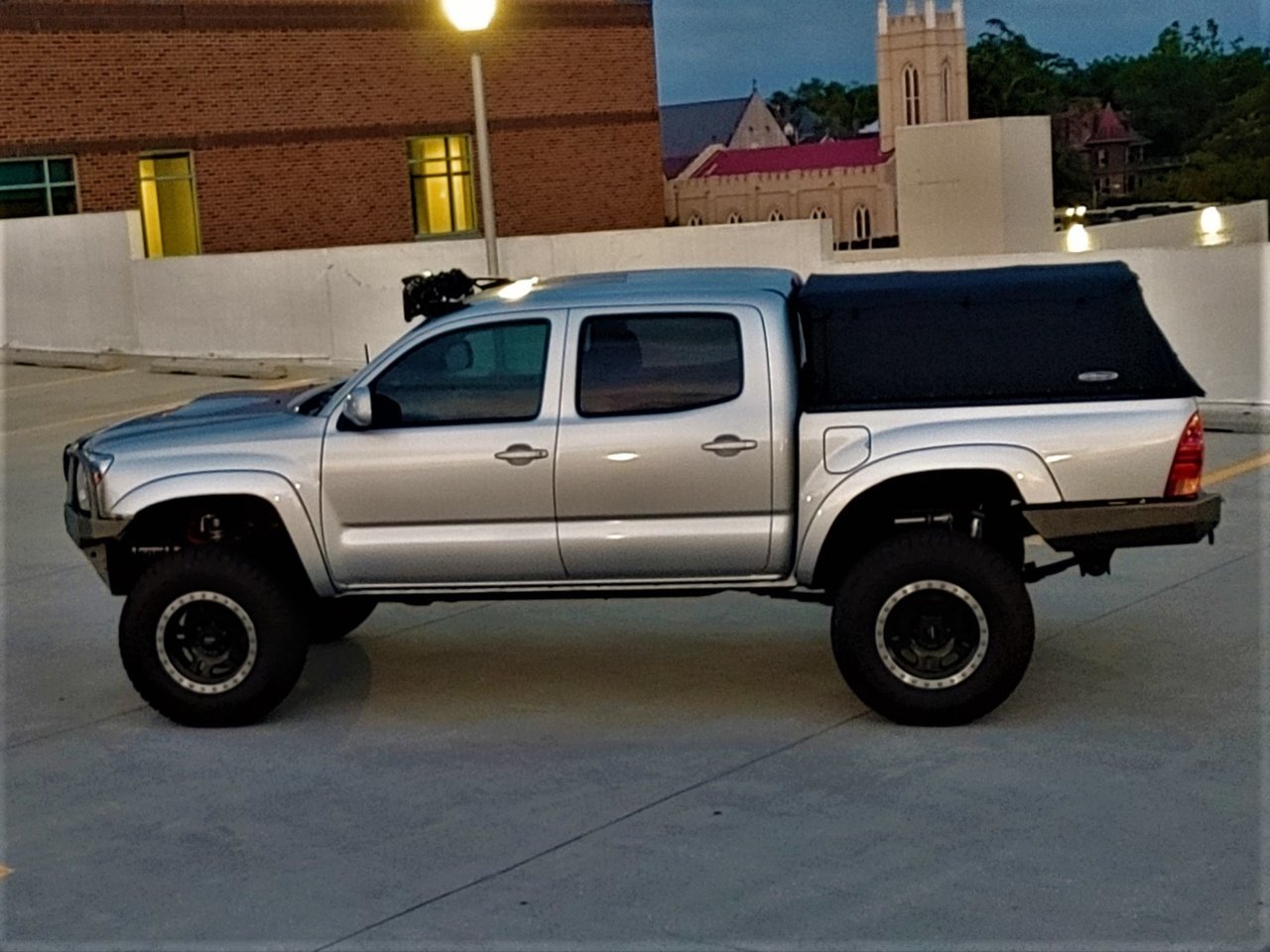

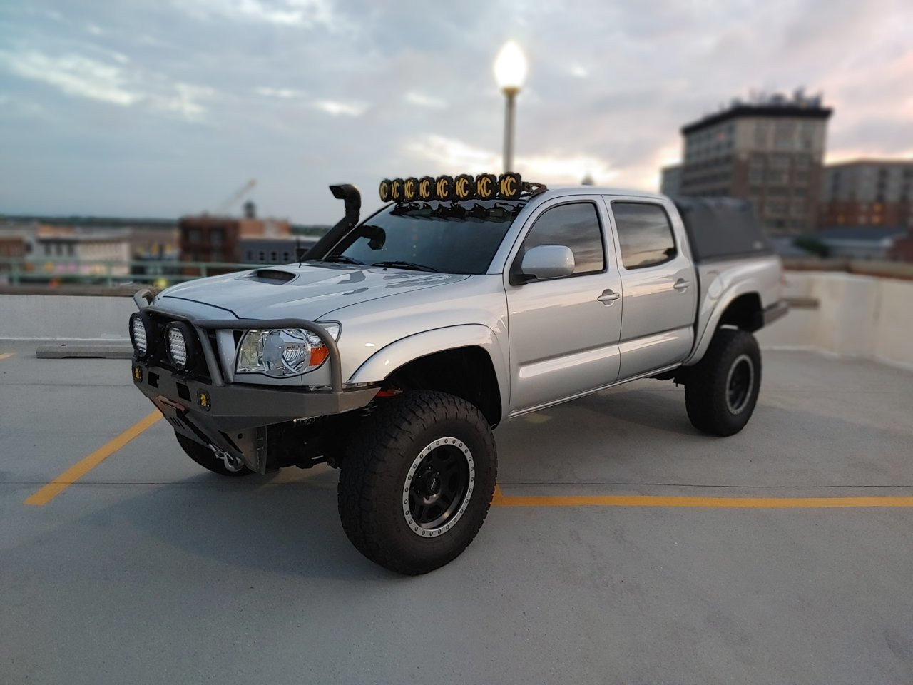

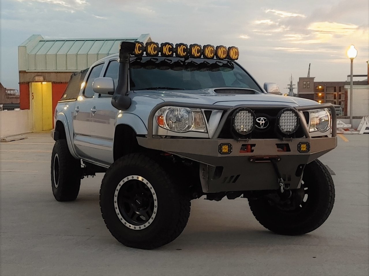

    Just installed my ecgs front and rear 4.88 diffs.
    Wow. Truck is like new. Feels light again. Running front and rear steel bumpers with winch and rear tire swing out on 34s.
    Transmission is so much happier, no more driveline clunking or gear hunting, pulls up hills no problems or dropping gears.
    Running Detroit trutrac in the rear, heard it click twice but locks solid when needed. Open when not needed.
    65 mph is 2200 rpm. Definitely not "screaming" like some people describe. Engine is happy and at the bottom of the powerband ready to go. Would not even consider 4.56s now that I've had 4.88s.
    Also installed @mightytacoman 3° cam gears and I have never felt a 4.0 idle this smooth. Had to sit for 15 minutes to let diff cool down to break in and it's like sitting in a brand new truck.
    The absolute best money I have spent on this truck and it will be the FIRST thing I do on my next one.

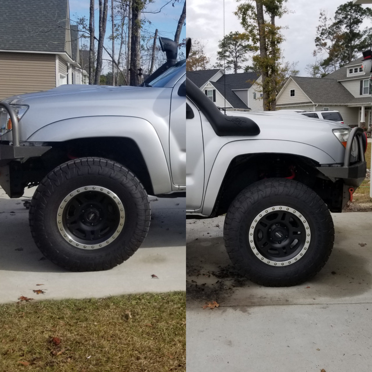

    love the truck man! the only lift you have up front is the springs and fox shocks? looks like more than 3 inches
  13. Jan 10, 2021 at 4:16 AM
    IvanhoeTaco
    IvanhoeTaco [OP] Well-Known Member
    Aug 4, 2019
    #301199
    2,907
    Eastern NC
    2005 Supercharged Converted Prerunner
    Total Chaos 3.5 LT, King Coilovers, 35x11.5r17 on Falcon T2, ADV 4 inch fiberglass, 4.88 gears, FJ cruiser transfer case, 4 runner front diff, Cab mount relocate, archive hangers, shackles, king 2.5x14 rear shocks, icon rxt leaf springs, king hydro bumps
    Thanks! My front fenders are cut so it appears higher. Its actually only 2.5 inches right now

    Cool! You used OEM fender flares or aftermarket? How did you fit them after you cut, I gave been trying to figure out how to do that :)
  17. Jan 10, 2021 at 4:32 AM
    #17
    IvanhoeTaco
    Aug 4, 2019
    #301199
    2,907
    Eastern NC
    Cut about 2 inches off the factory flares, of course you have to cut the actual fender as well. I bought brand new flare clips off Amazon and they are holding great. There are a few good writeups about it. Its an unnerving task but it's worth it
  18. Jan 10, 2021 at 4:34 AM
    #18
    IvanhoeTaco
    Aug 4, 2019
    #301199
    2,907
    Eastern NC
    before and after
