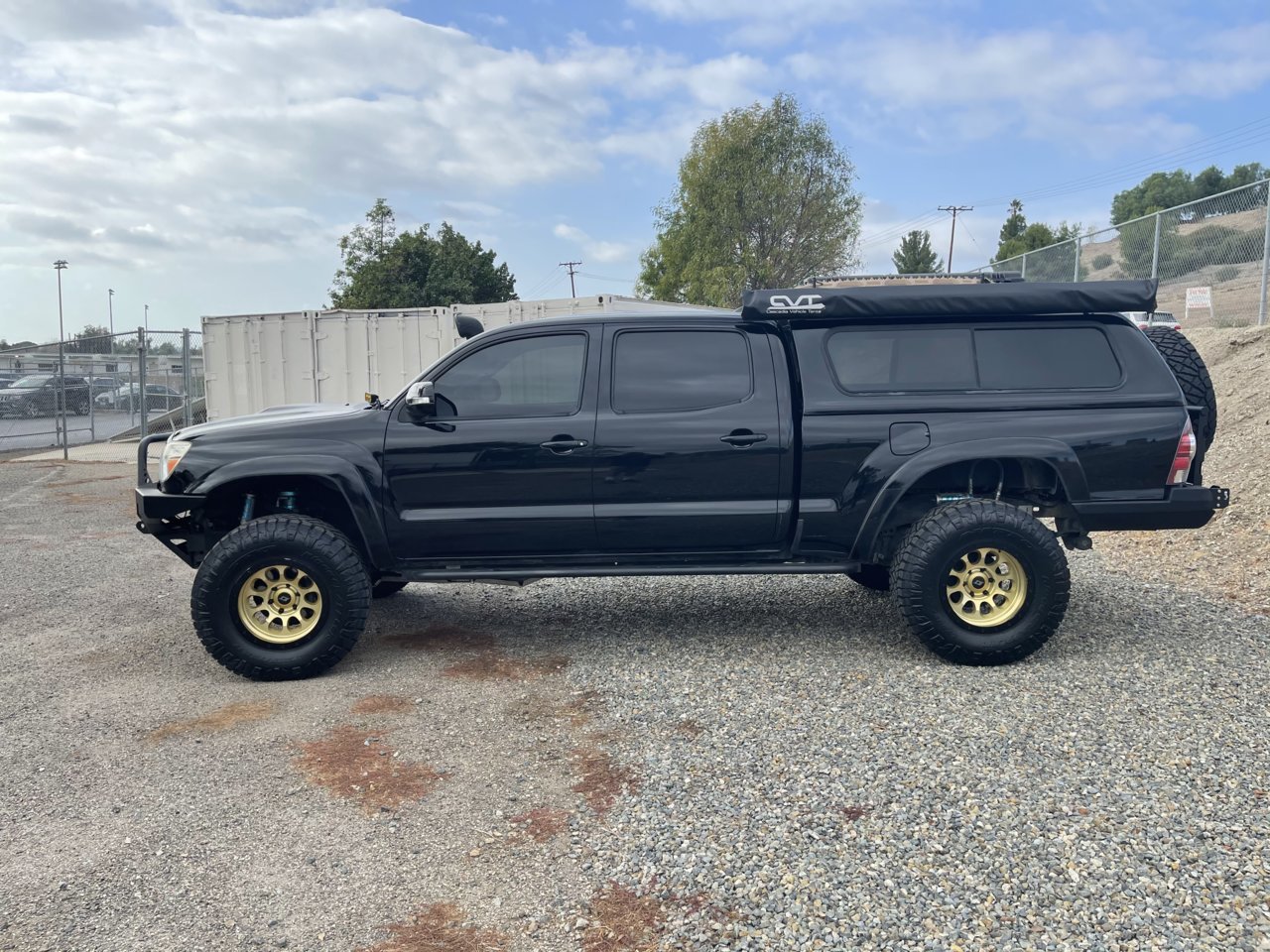

  9. Jan 14, 2021 at 11:25 AM
    #69
    dpf88101
    dpf88101 Well-Known Member
    Sep 21, 2020
    #341518
    359
  10. Jan 14, 2021 at 12:23 PM
    #70
    IvanhoeTaco
    IvanhoeTaco [OP] Well-Known Member
    Aug 4, 2019
    #301199
    2,953
    Eastern NC
    2005 Supercharged Converted Prerunner
    Total Chaos 3.5 LT, King Coilovers, 35x11.5r17 on Falcon T2, ADV 4 inch fiberglass, 4.88 gears, FJ cruiser transfer case, 4 runner front diff, Cab mount relocate, archive hangers, shackles, king 2.5x14 rear shocks, icon rxt leaf springs, king hydro bumps
    What's your rpms around 70-75 with the 5s'?
  11. Jan 14, 2021 at 2:44 PM
    #71
    dpf88101
    Sep 21, 2020
    #341518
    359
    2800RPMish
  12. Jan 14, 2021 at 2:45 PM
    #72
    IvanhoeTaco
    Aug 4, 2019
    #301199
    2,953
    Eastern NC
    Same
