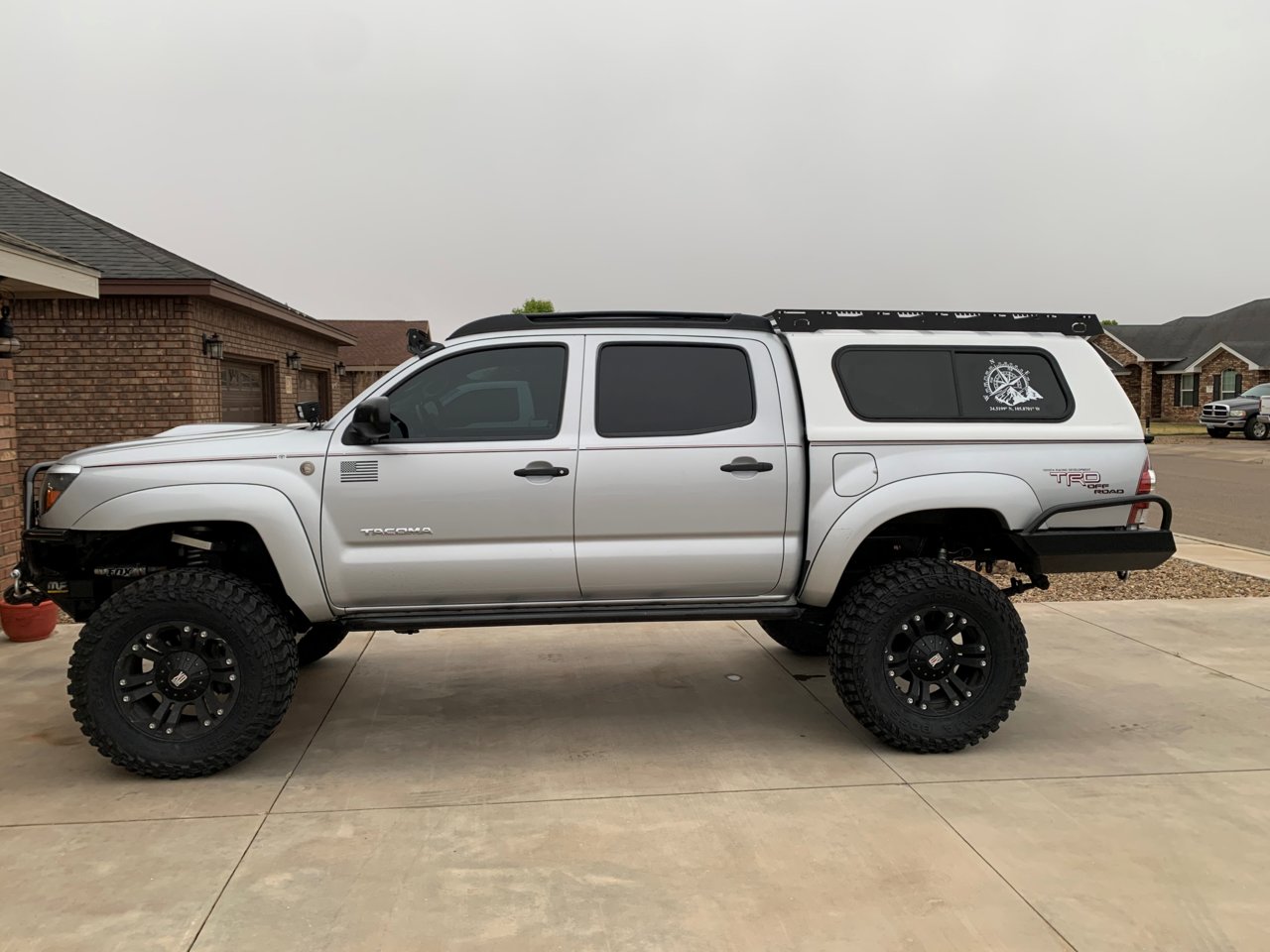

    Thanks for all the inputs!!!! Im settled on 4.88s now. Anyone has a pic of true 35s? Looking at the gap I feel like I have 33s on now haha.....
    IvanhoeTaco[OP] likes this.
  15. Jun 15, 2021 at 1:20 PM
    #135
    dpf88101
    dpf88101 Well-Known Member
    Sep 21, 2020
    #341518
    359
  16. Jun 15, 2021 at 1:22 PM
    #136
    IvanhoeTaco
    IvanhoeTaco [OP] Well-Known Member
    Aug 4, 2019
    #301199
    2,911
    Eastern NC
    2005 Supercharged Converted Prerunner
    Total Chaos 3.5 LT, King Coilovers, 35x11.5r17 on Falcon T2, ADV 4 inch fiberglass, 4.88 gears, FJ cruiser transfer case, 4 runner front diff, Cab mount relocate, archive hangers, shackles, king 2.5x14 rear shocks, icon rxt leaf springs, king hydro bumps
    Damn 6 inch lift
  17. Jun 15, 2021 at 1:23 PM
    #137
    dpf88101
    Sep 21, 2020
    #341518
    359
    ya - Sorry :)
