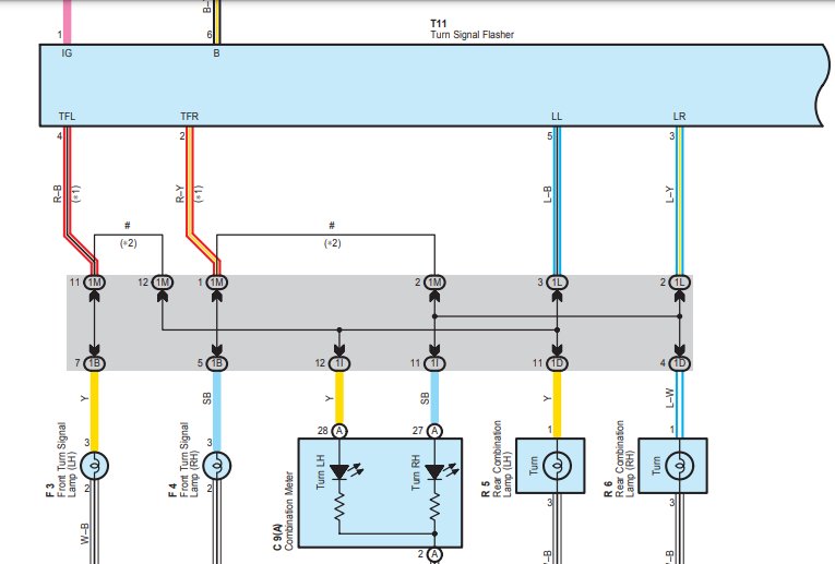

    All of my lights are on and working from out side but only my right side turn signal indicator light is not showing up on my dash but I hear it clicking...
    Anyone know how to fix this???
    Thanks.

    It's either a broken wire/bad connection, problem in the Combination Meter (Instrument Cluster), or a problem in the Driver's Side Junction Box.
    Do you have a test light to do some testing with?

    Yes, I have a tester to test the wires..It's not the instrument cluster because I bought an used instrument cluster and replaced it same problem... I think it's something with wires but I cannot locate which wires... plus this car had lots of electrical work done for putting up light bars, remote start and new radio system.. I am the 2nd owner and I failed the inspection due to right side turnsignal indicator not showing up on the dash..

    Test light connected to Ground check Connector 1I Pin 11 (Light Blue) on the back of the Driver's fuse/junction box, the light should flash with the Right turn signal on.
    Same check at the Combination Meter Connector C9 Pin 27 (Light Blue).

    I tested everything you suggested but do you have the color reference to these pins?? I am having trouble locating the faulty wires but on the diagram it doesn't map out the colors...

    Nvm bro.. finally found the wires and rewired it
    It was a faulty wire from cluster connector right turn signal to turn signal indicator fuse connector (blue and yellow wire)..
    Thank you so much for the wiring diagram brother man~
