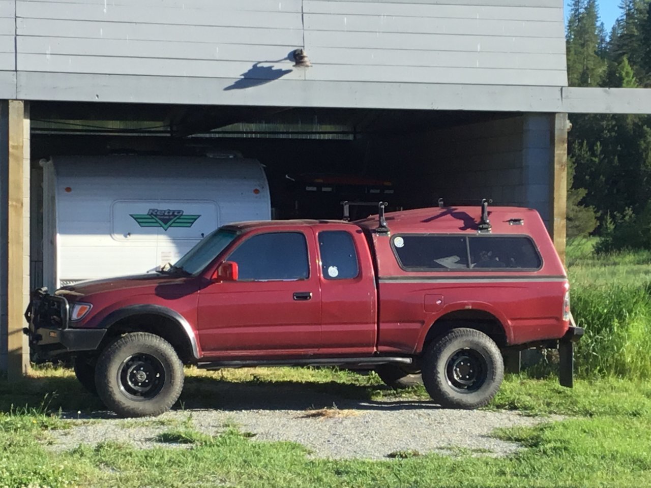

    The emptiest the Taco has been since I the day after I got it.CC90682A-E54F-4234-9838-CC370F78A38D.jpg
    Just got back from a dump run.
    Phessor likes this.

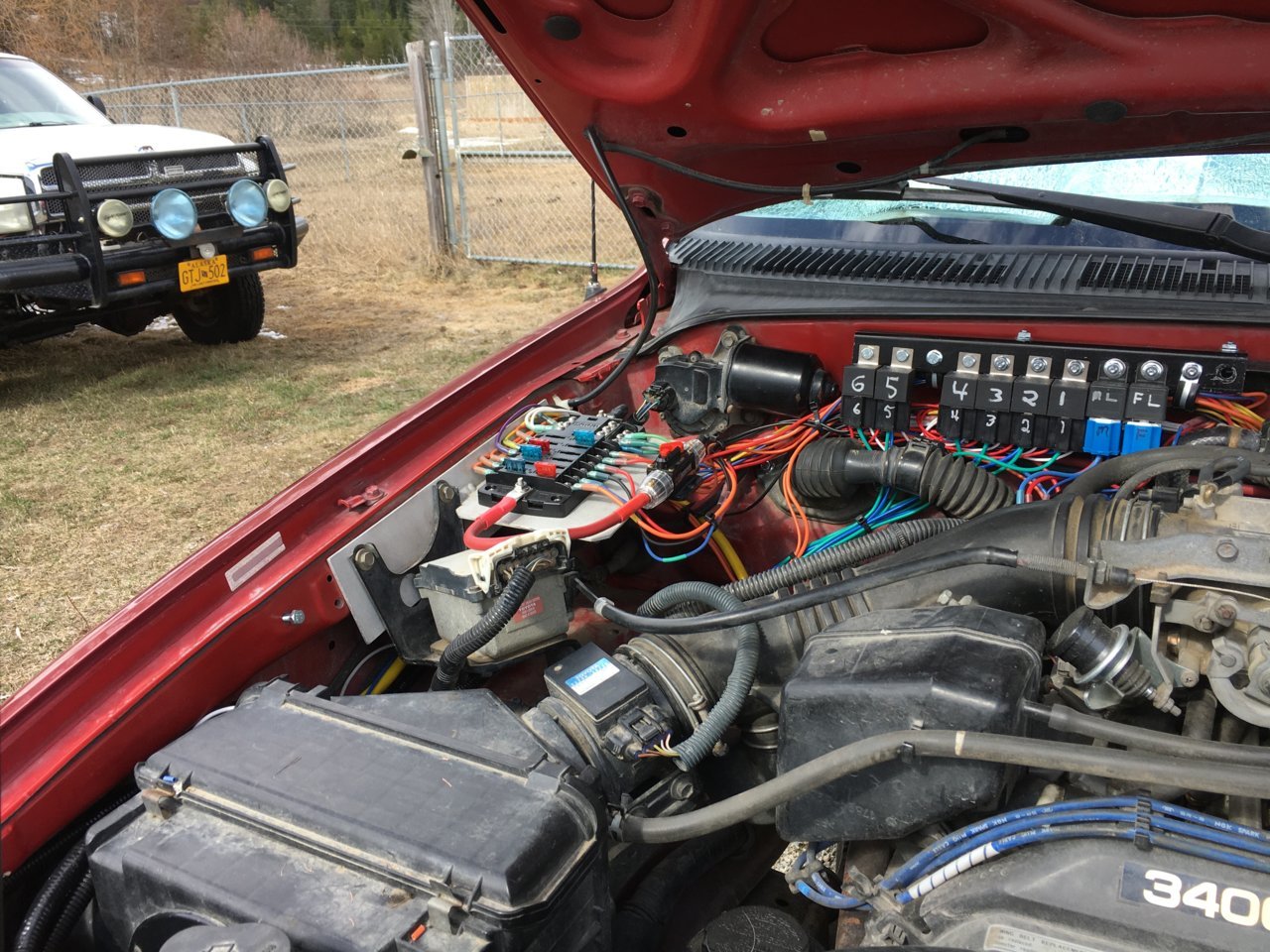

    That will change, need to fab a bigger mount for the fuse panel next summer, and clean up some of the wiring- final termination, left a lot of the stuff a bit long, while I was routing the wiring. I guess this is version 1.0:
    Still need to install some of the switched loads, but they are big ticket items that have been delayed/ corona-d.
    I did move the driving light relays over by the battery- too busy on the firewall, and then they keep company with the new headlight relays.
    Phessor[QUOTED] likes this.

    I need to do this, my Blue Sea dual battery isolator acts up every now and then and I loose power to my auxiliary battery and fuse box.
