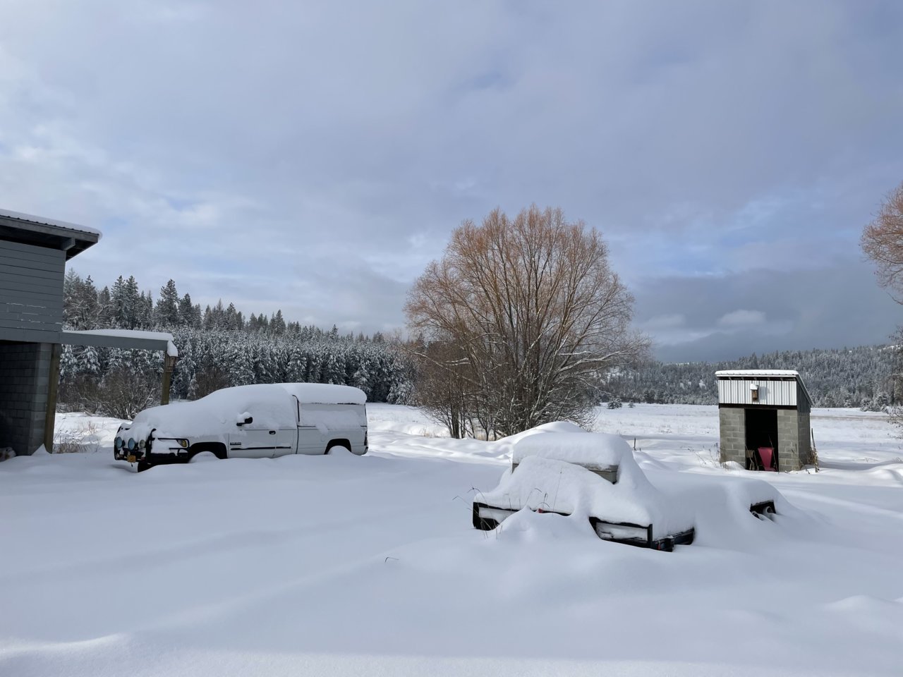

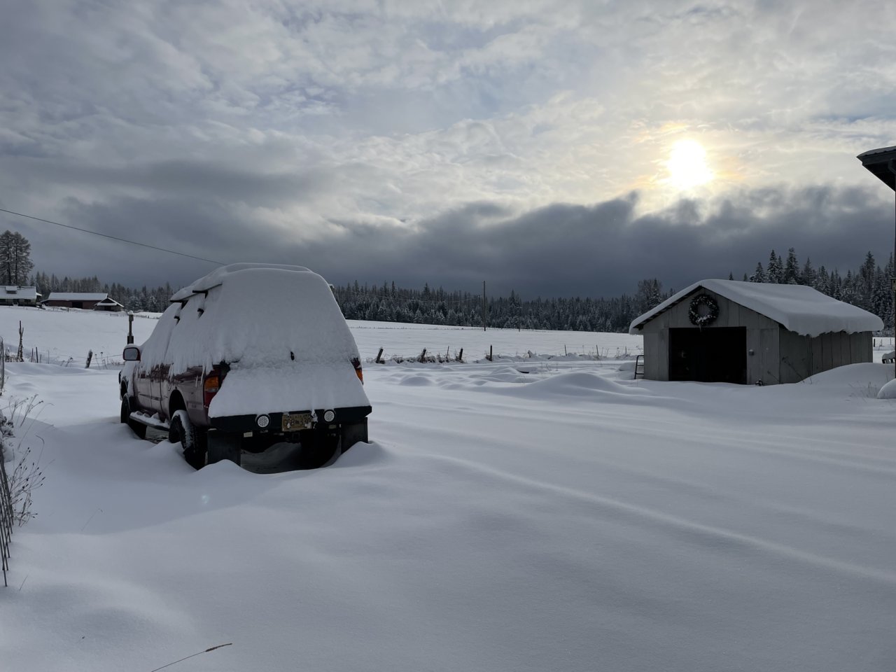

    Ah wintertime, no better time to move…., or is there?
    Thursday after the storm in Washington:
    Winter progresses along up here in eastern Washington. We got about 18-24” of fresh snow earlier this Wednesday- I was driving the fiancé’s Suburban back from Montana at the time, having hauled a trailer and a load of stuff over to the Madison valley.
    Lookout pass on I90 around the border between Montana and Idaho:
    Conditions weren’t too bad although, the signs on the I90 warned of a big storm on Wednesday…. For once the weather guessers we’re right on the money.
    Going to miss certain aspects of living here:

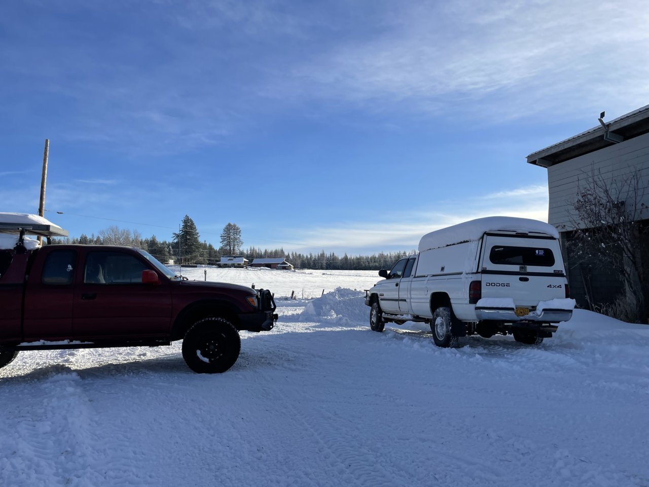

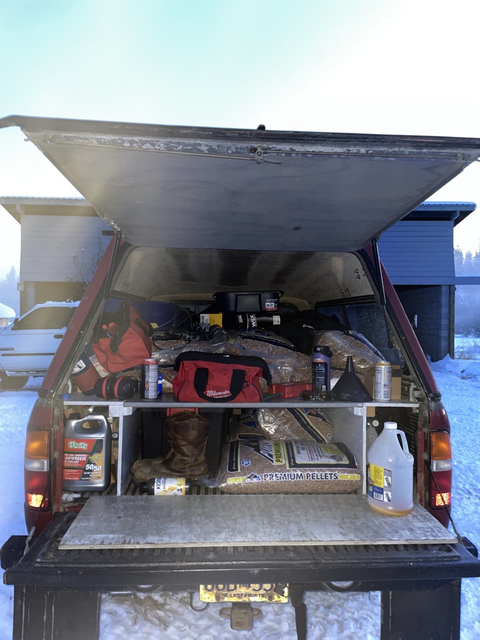

    Onto local chores after clearing the driveway. I was using the Tacoma- as I had to change out a faulty thermostat on the Suburban out in the driveway while chasing down parts and tools( what better timing than during a move- hah!).
    Tacoma with a tools and 10 bags of pellets- that will anchor you to the planet:
    The hungry baby in the basement:

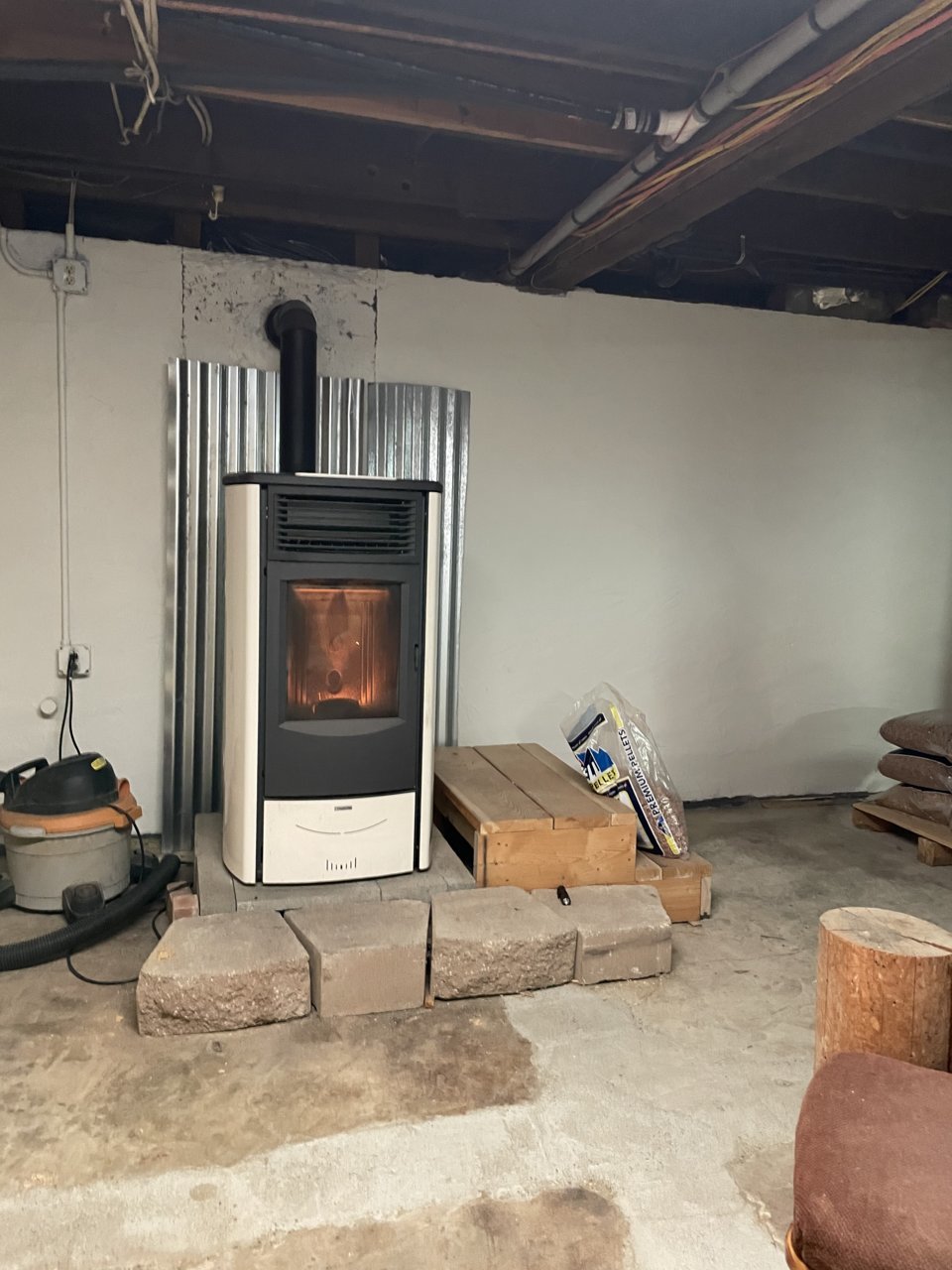

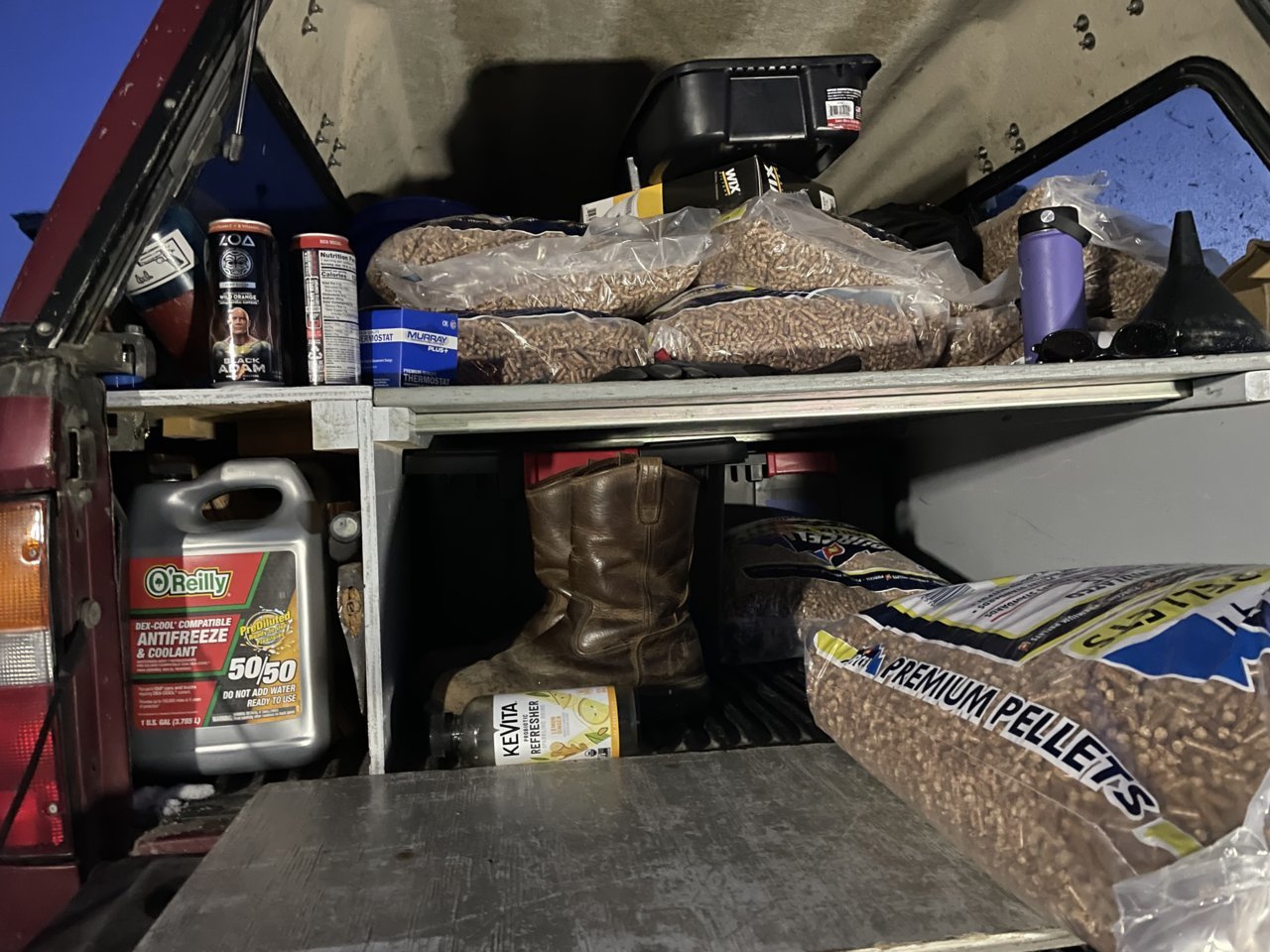

    One of which was hauling a few bags of pellets for the voracious pellet stove, as well as tools, camping supplies ( the Tacoma is never without camping/winter survival gear), so ended up with about 800+# in the truck and there is nothing like some ballast to keep you planted on the road. The Tacoma handled everything with a shrug, slowly perhaps but:
    Running around in 2wd w/studded tires on packed snow and ice reminded me of my first Toyota-74 HiLux with a wood camper shell and 4- 5 gallon buckets of sand just inside the tailgate- which I drove during my first winters in Ak. I went just about anywhere I needed to go- except up a few steep driveways then it was chain up and go.
    Looks a bit more level than the HiLux did:

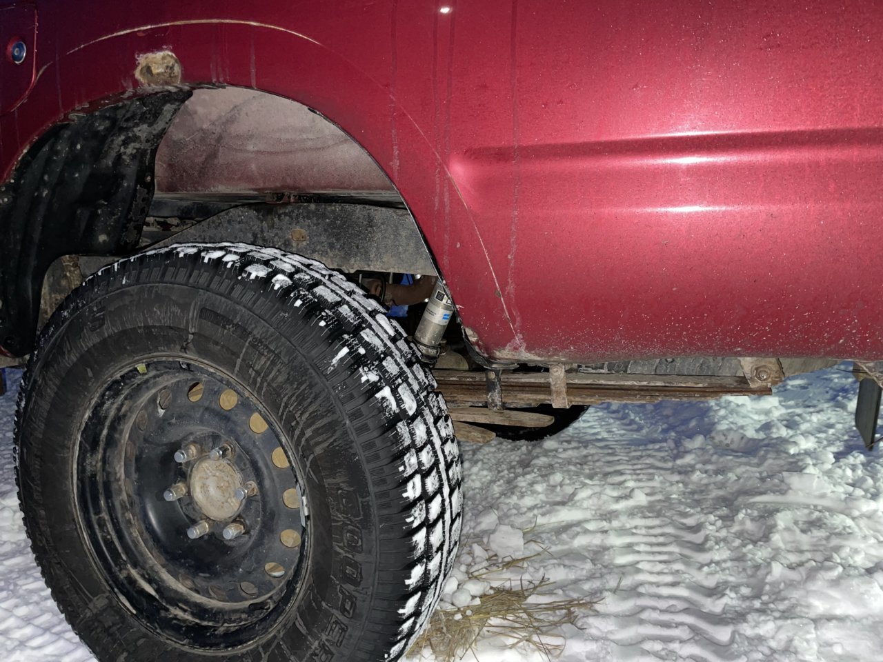

    Needless to say the Tacoma with the Icon AAL pack added preformed as expected, it held up well on the AlCan, just broken in…

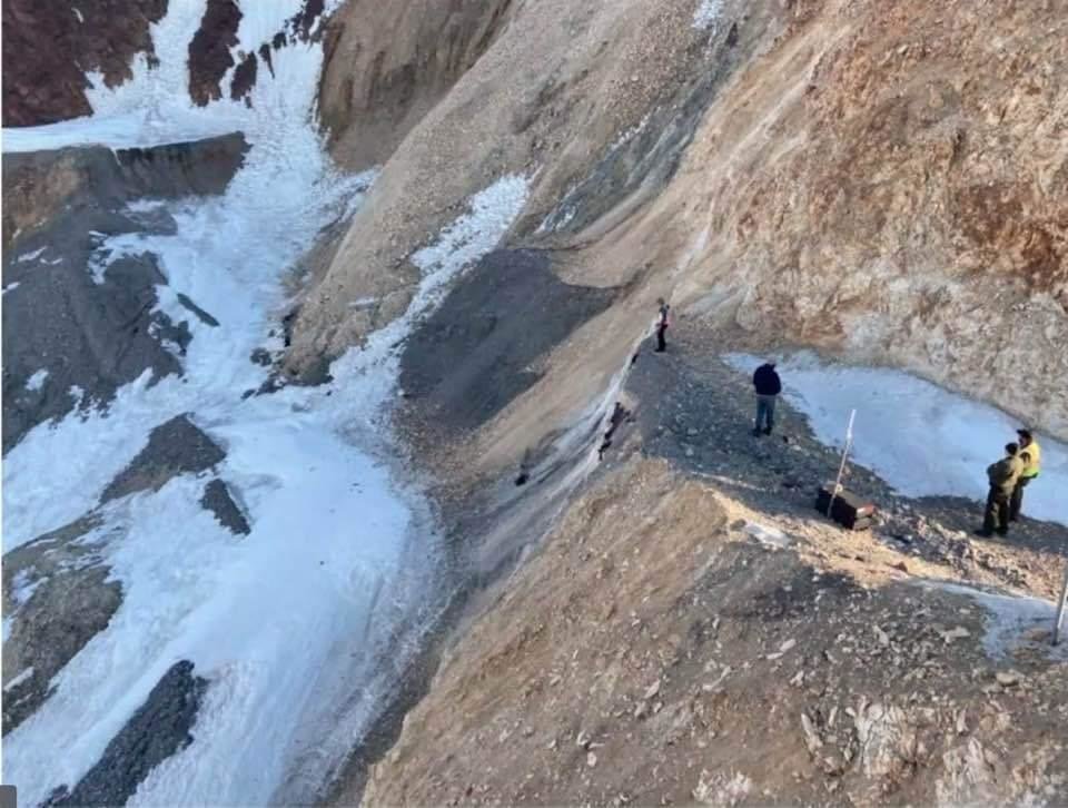

    Well everyone is likely tired of the updates on the Pretty Rocks slide, but I found a recent pic from this spring. Looks like the road has dropped 40-50’ , they have let the project out for bid, with an actual design now. Not sure if it’s FHA or DSC, but the result was they got around a half dozen contractors, mostly big outfits from Outside to bid on it so it looks promising for something to get started in the spring with any luck.

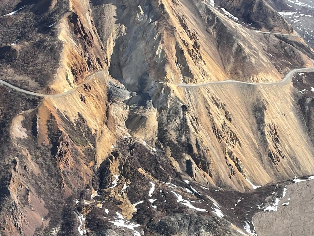

    All of the grey material is gravel they put on the road in 2021, the area in the upper left of the photo is where road ended on the other side of the slump. If I understand correctly the proposed bridge will go across from the cut where the people are standing straight out to the far side of the oxbow above the dark brown outcropping to the right of the wing support frame which is out of frame on the previous photo but on the left side of the picture in this post. So basically bypassing that whole oxbow slide area and attempting to make an easy left turn off of the bridge back onto the road for the long passenger buses (and the very rare full length 40+’ tractor trailer rigs that they occasionally allow to transit after midnight). It is likely that there will reduced vehicle size restrictions in the future depending on the bridge design. Kinda just speculation on my part, but time will tell.
    That is to minimize the amount of material they have to cut off the bank and expose less of the rock glacier strata. As I said it should be a very interesting project to watch.

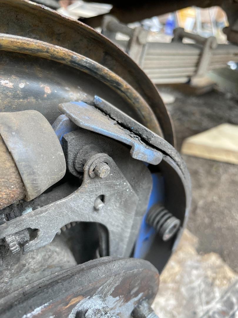

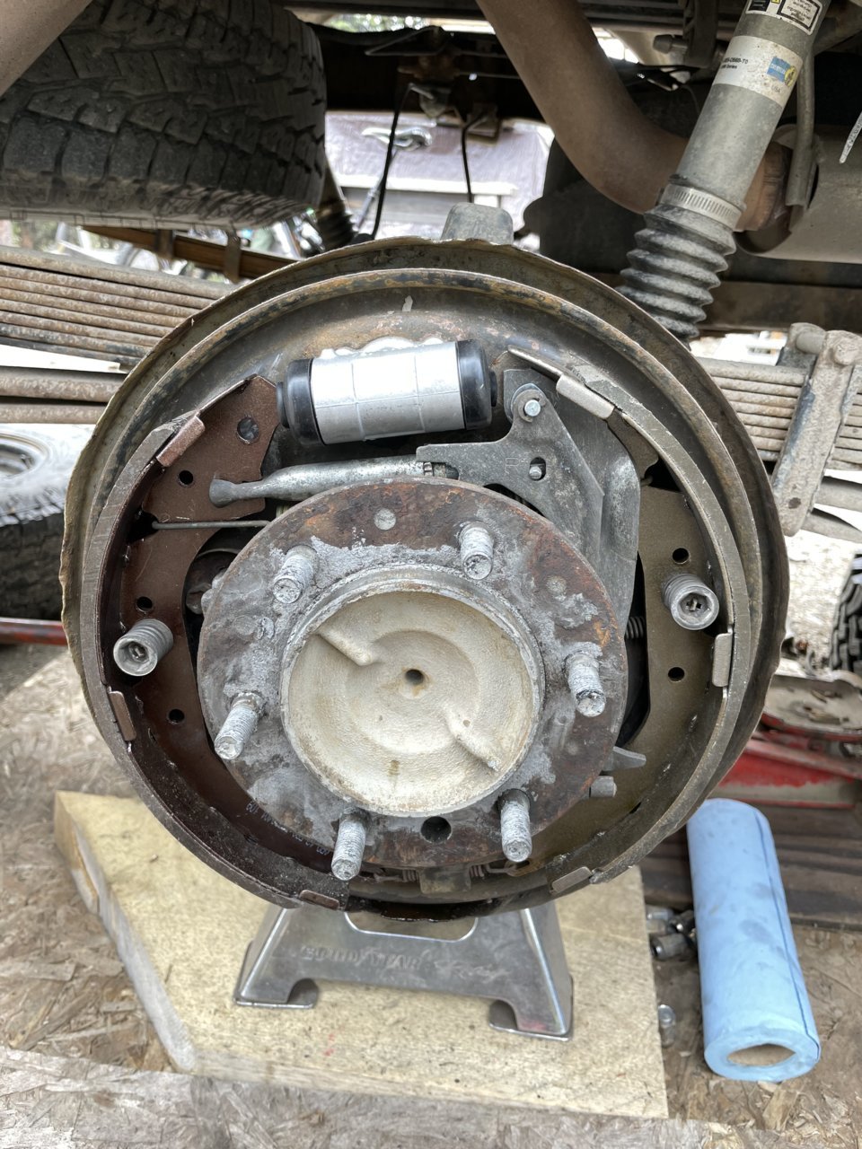

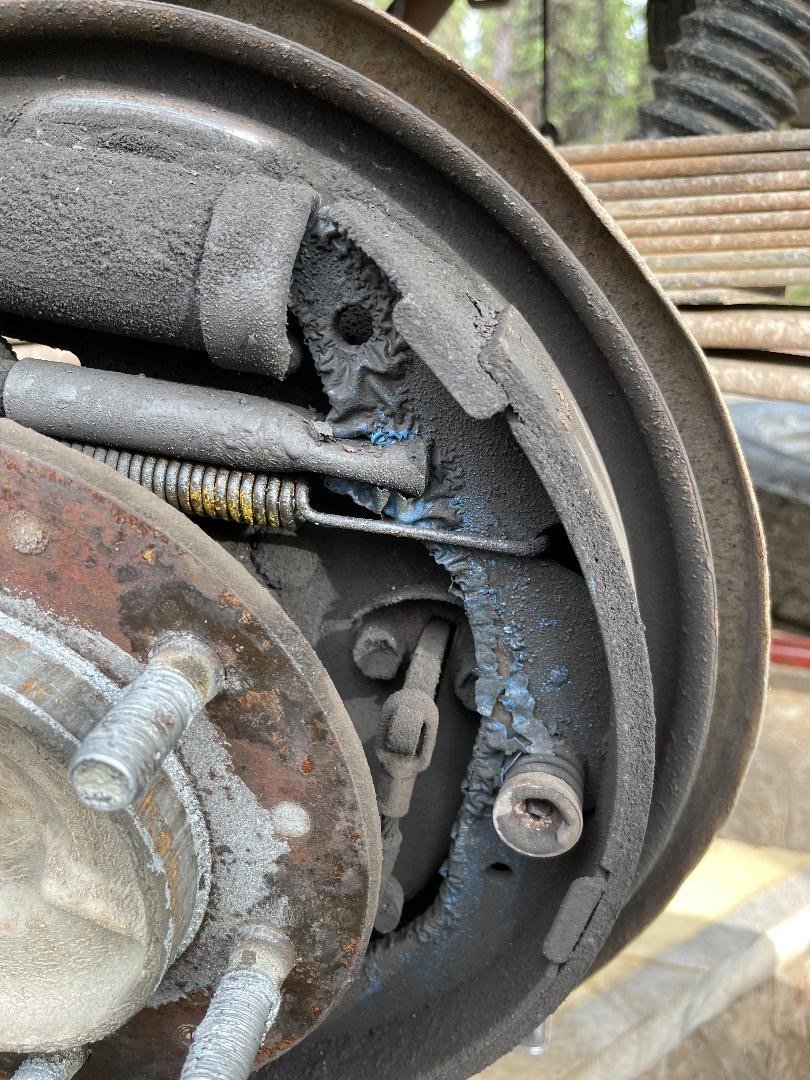

    2) might have a bad caliper on the front, seems to randomly stick, this happened 3 different times with varying degrees of intensity. Kind of a light stick then a solid clunk of engagement, and the last time the passenger side grabbed while stopping at a traffic light in Fairbanks, although it could have just been loose gravel and sand.

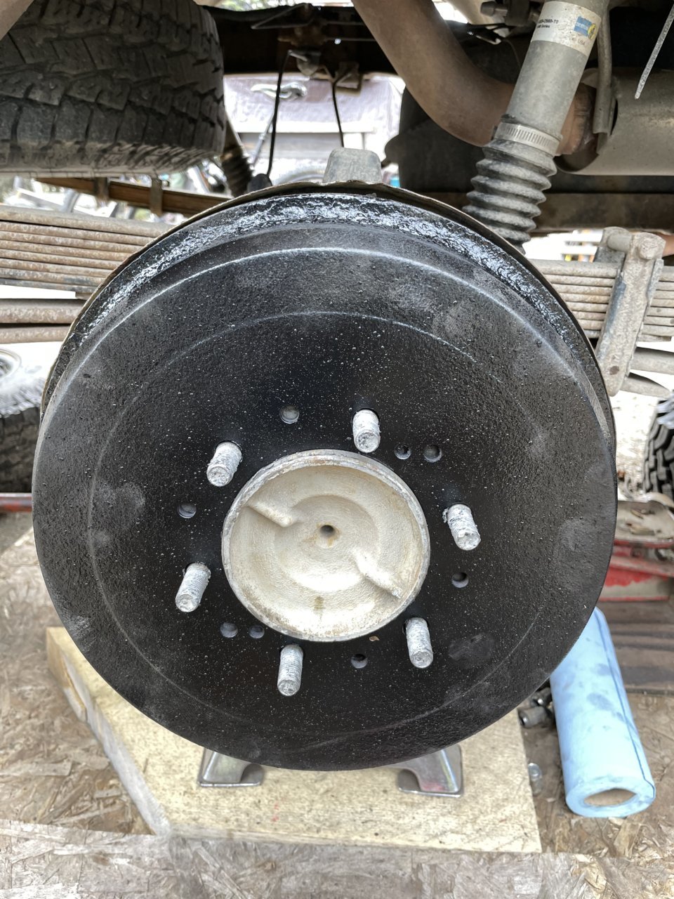

    3) had a couple of interesting clunks under the back but I saw no signs of and cracks in the springs when I checked a couple different times- so I plan to get it up on a rack and do a closer examination. It might have just been a spring shifting.

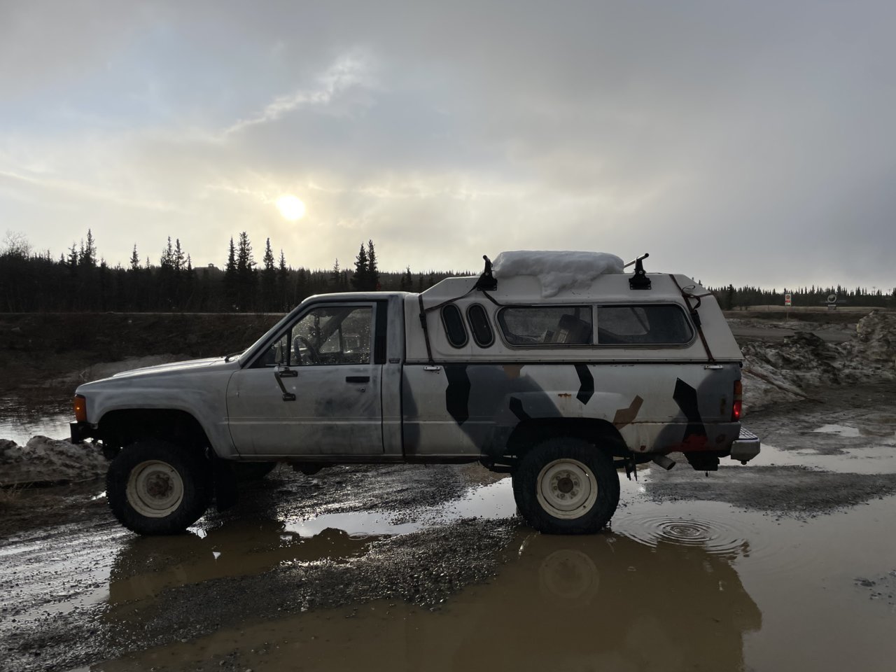

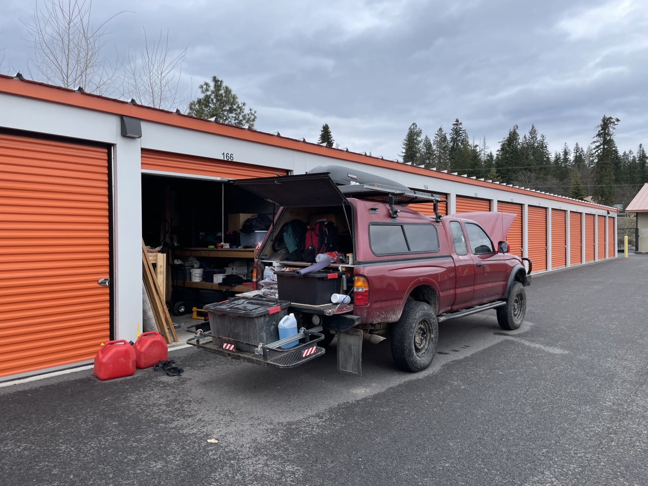

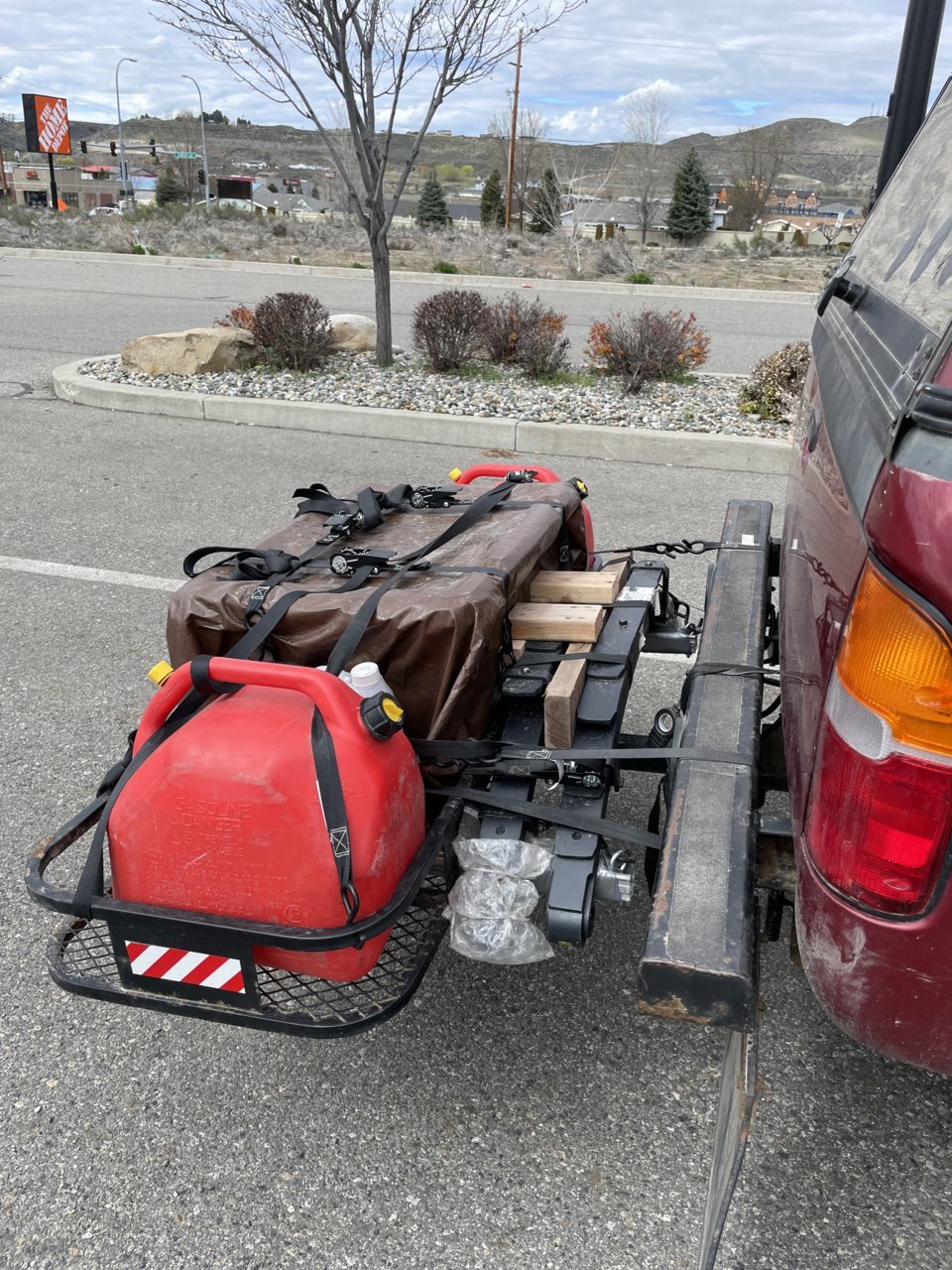

    A few photos from the sprint up the AlCan:

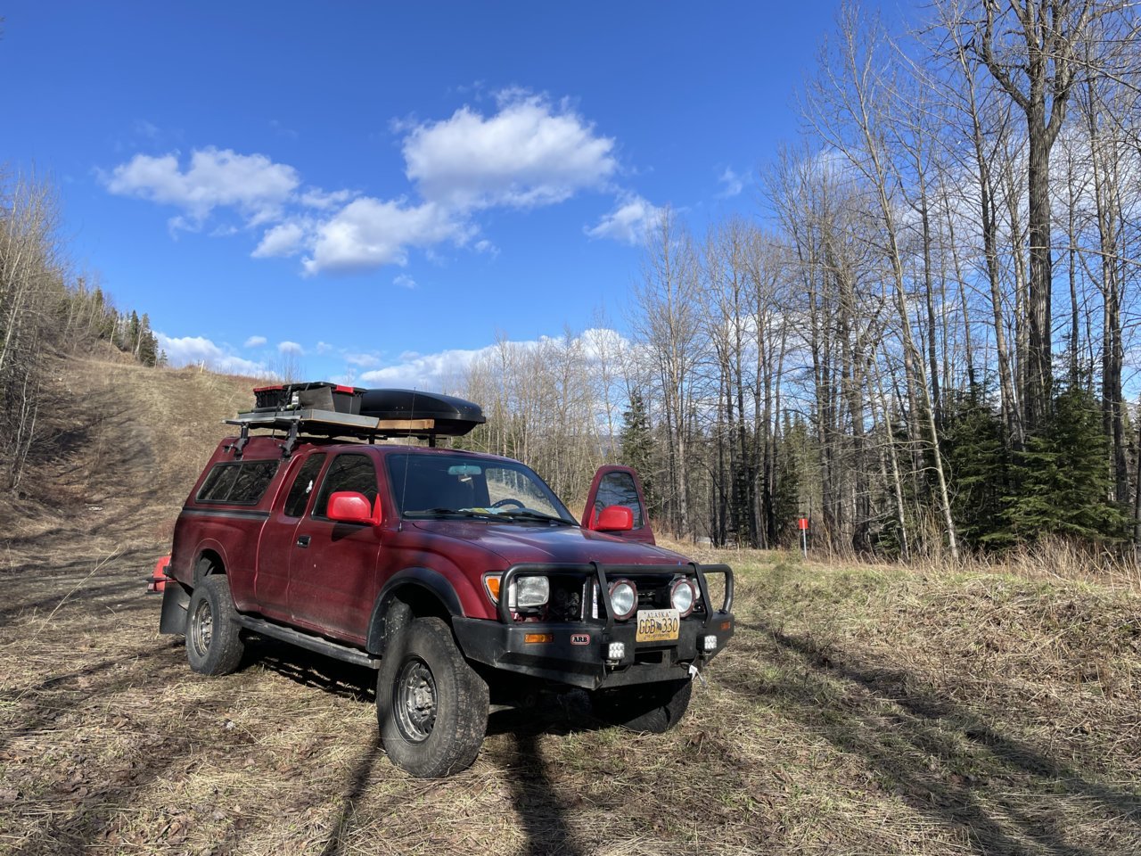

    finalizing(?) the load after changing the the studded tires for the Toyos 9FC9524A-F6D1-4F39-971F-B0950EFEF50A.jpg sorting out a way to haul the new rear ARB leafs for Roland up to the cabin, this turned out to be both necessary( couldn’t let the tailgate down all the way) and also safer- dropped the weight down lower still, which made for a much smoother ride.

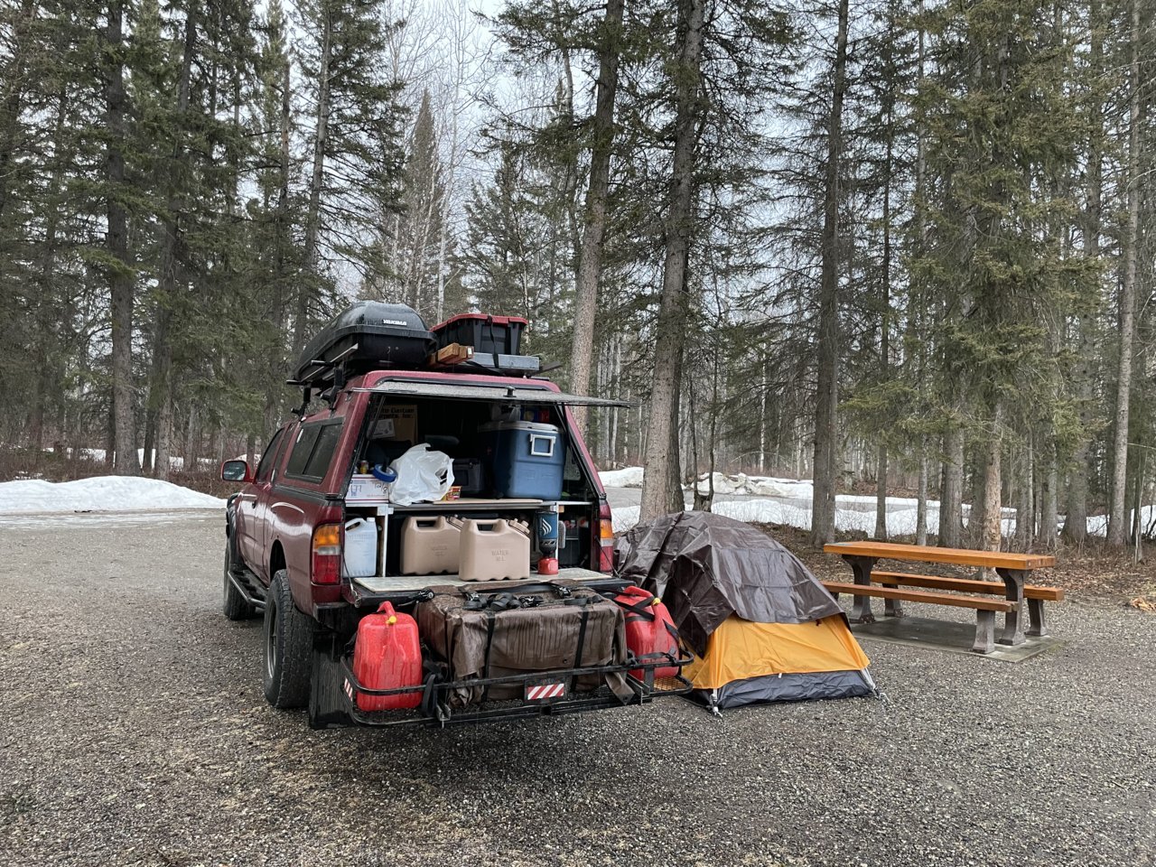

    430995DA-FD19-476A-83A2-57A873CC5F65.jpg stopping for a break from the road in the Peace River canyon.

    Camping at Liard River: E46E4C17-D2E0-47A7-8E0D-C45D86272D56.jpg

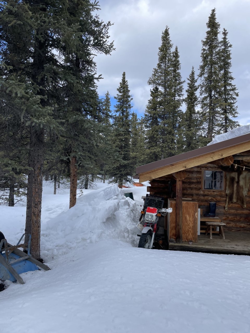

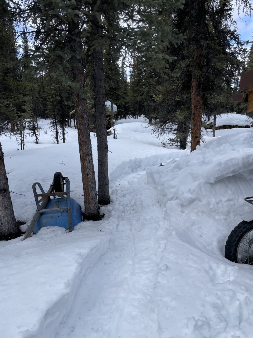

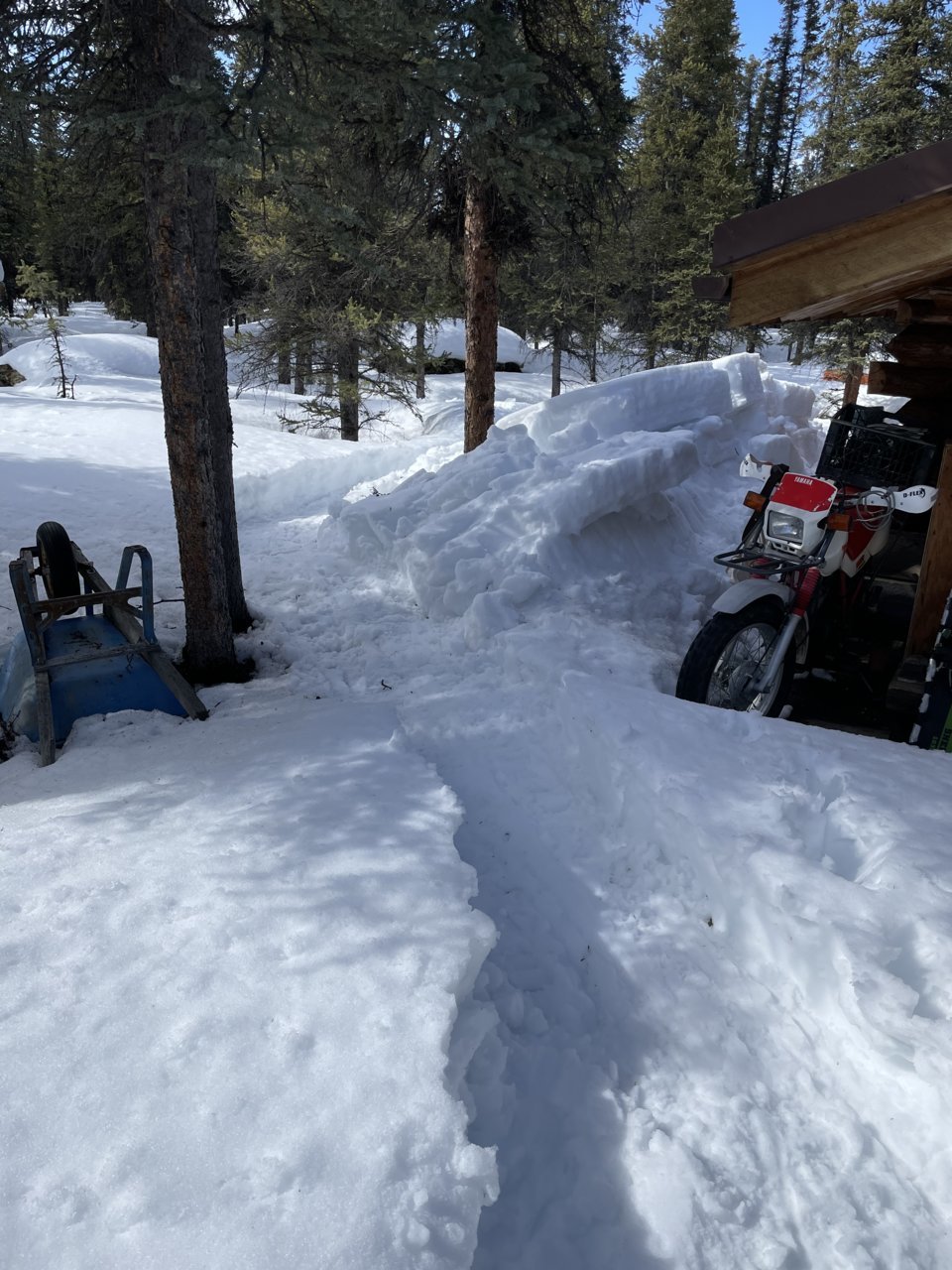

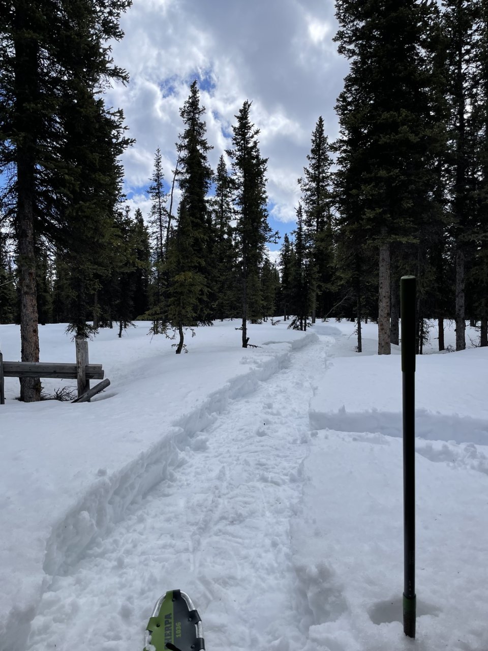

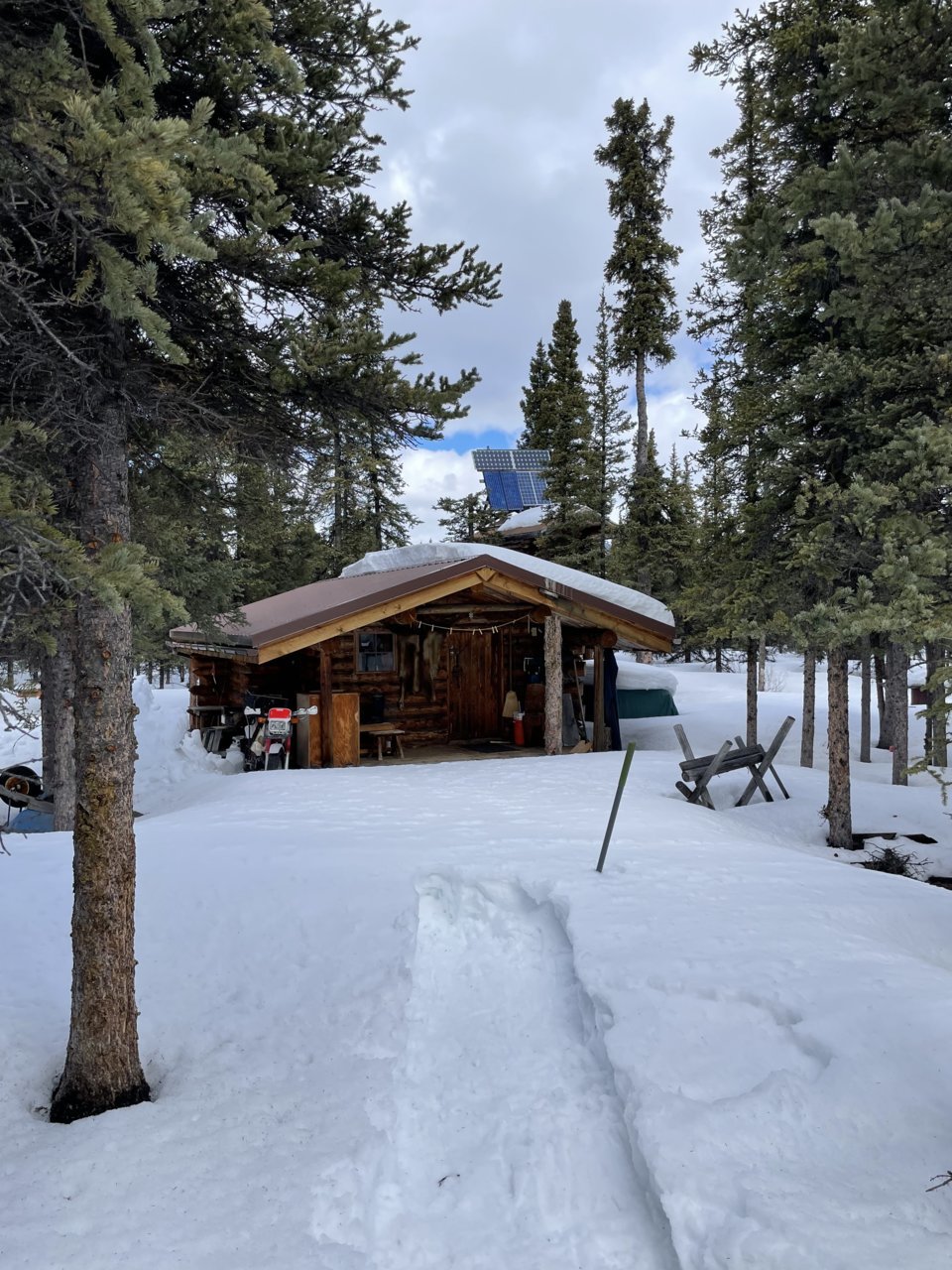

    Still quite a bit of snow at the cabin, I guess I know what the first order of business is:BC1601A1-FF6B-4FE1-9CC4-4BD16A31468C.jpg

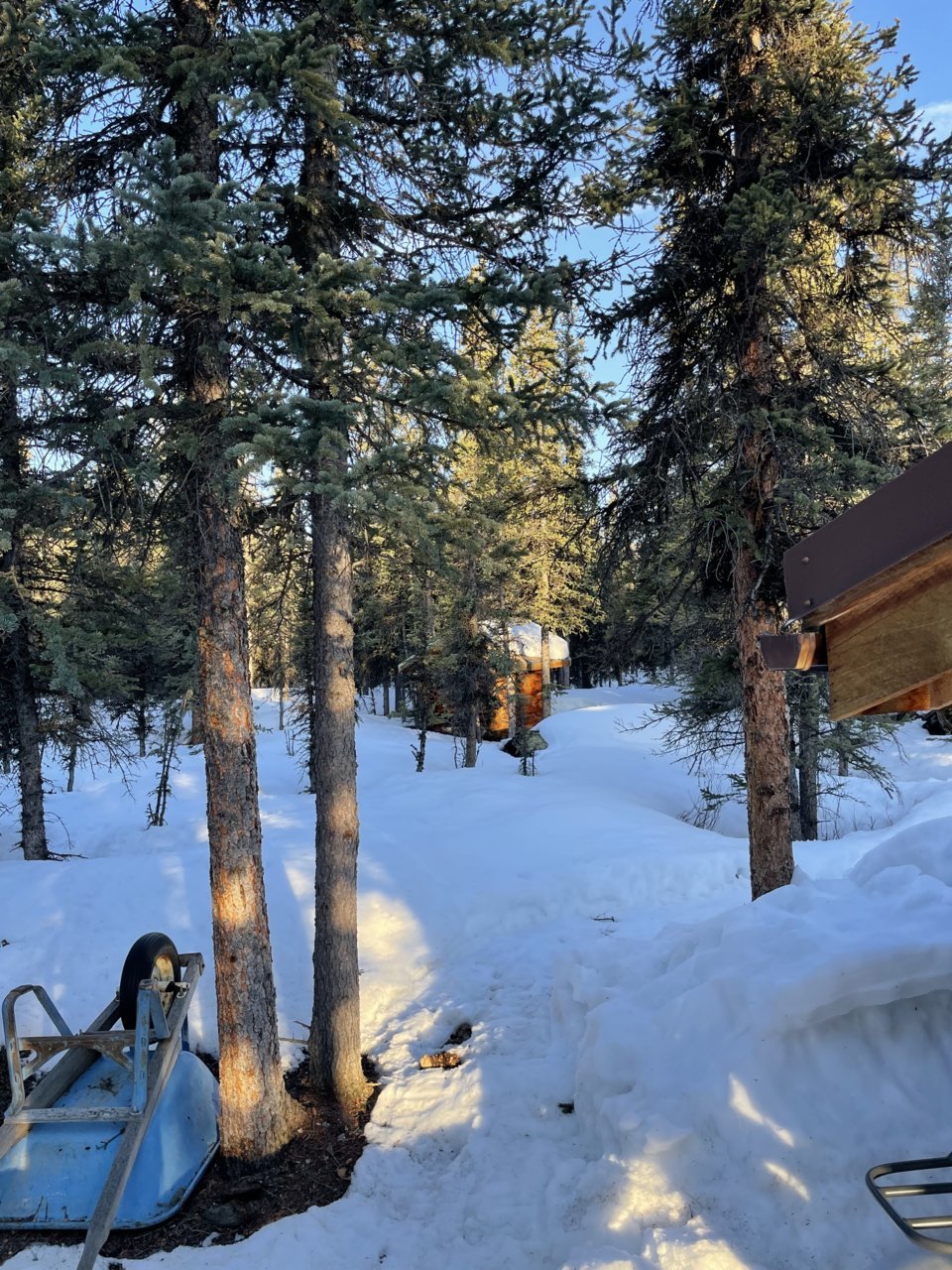

    Need a temp spring trail to the outhouse:8043E889-C5E9-44FC-BDC3-4F856539895C.jpg

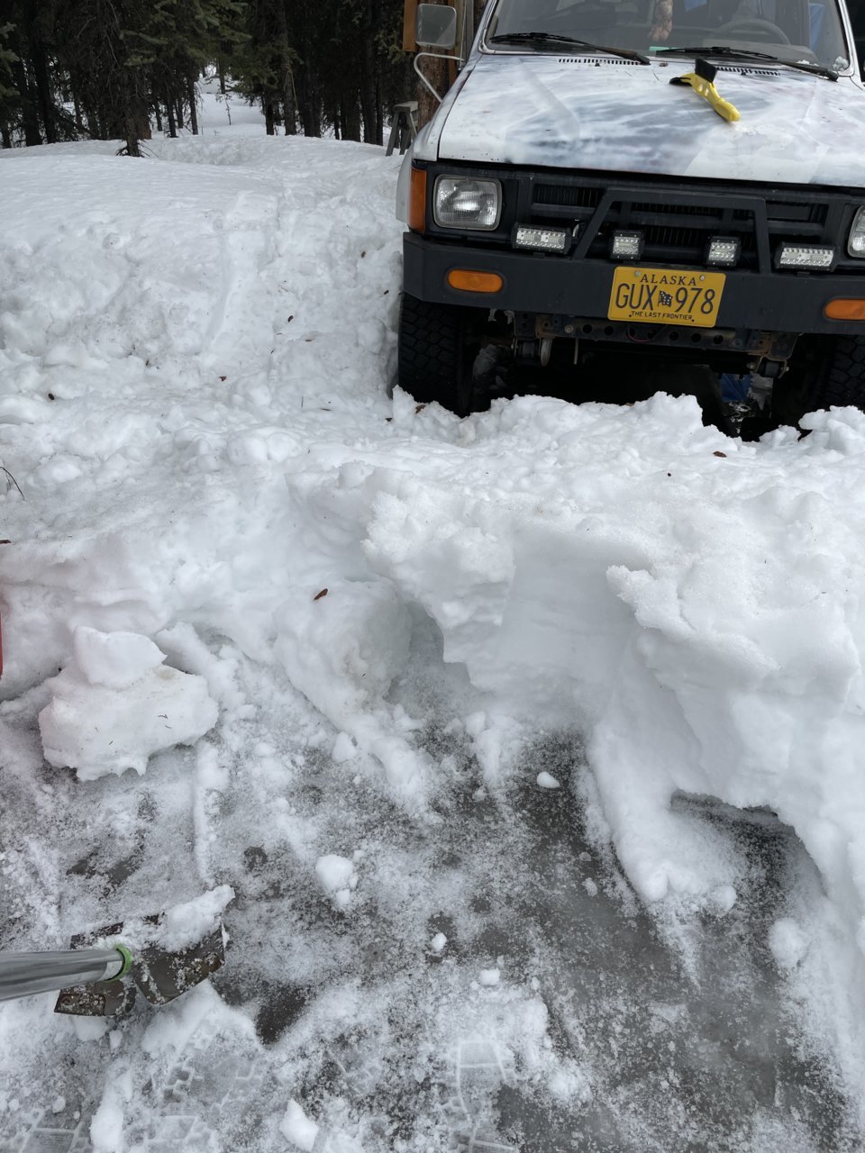

    A bit of driveway clearing:15CAB7A8-BC81-487C-B91D-D762D077B4F7.jpg
    Access to the facilities:3A4C1AF9-D786-4EEF-A9B2-0793F93E3A05.jpg
    Cranked up the Efel oil heater, love this stove, small but very capable:

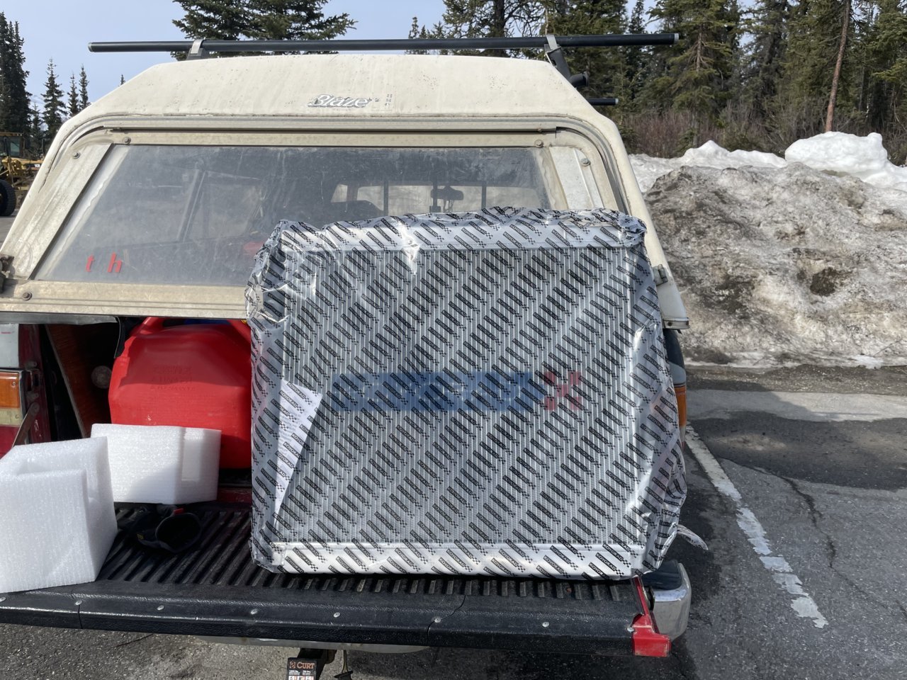

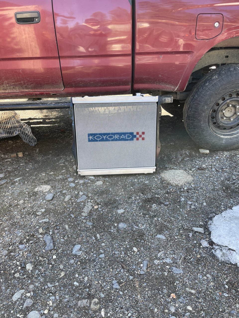

    Looks like radiator arrived undamaged. Now to find out where they delivered the radiator cap.
    3DE07633-B2FB-4CE9-BEC8-5C686F5C9354.jpg B067D298-46F3-43BA-B33A-3C59DD195B85.jpg
    Sometimes one wonders how some businesses stay afloat, they got the address wrong sent it to the next town(wrong zip code?) That PO sent it back as undeliverable, which I found out once I drove 18 miles. Ordered one from a different source, and it showed up today:
    4C11168C-C990-4E3E-AC07-5FC7364E2FA1.jpg Not a big deal, ran into some friends and played catch up.
    Also the lower radiator hose won’t be here for another day or so anyway.

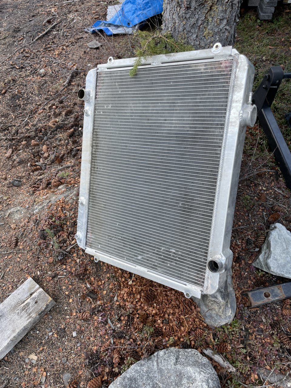

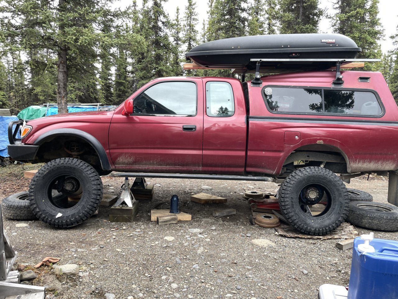

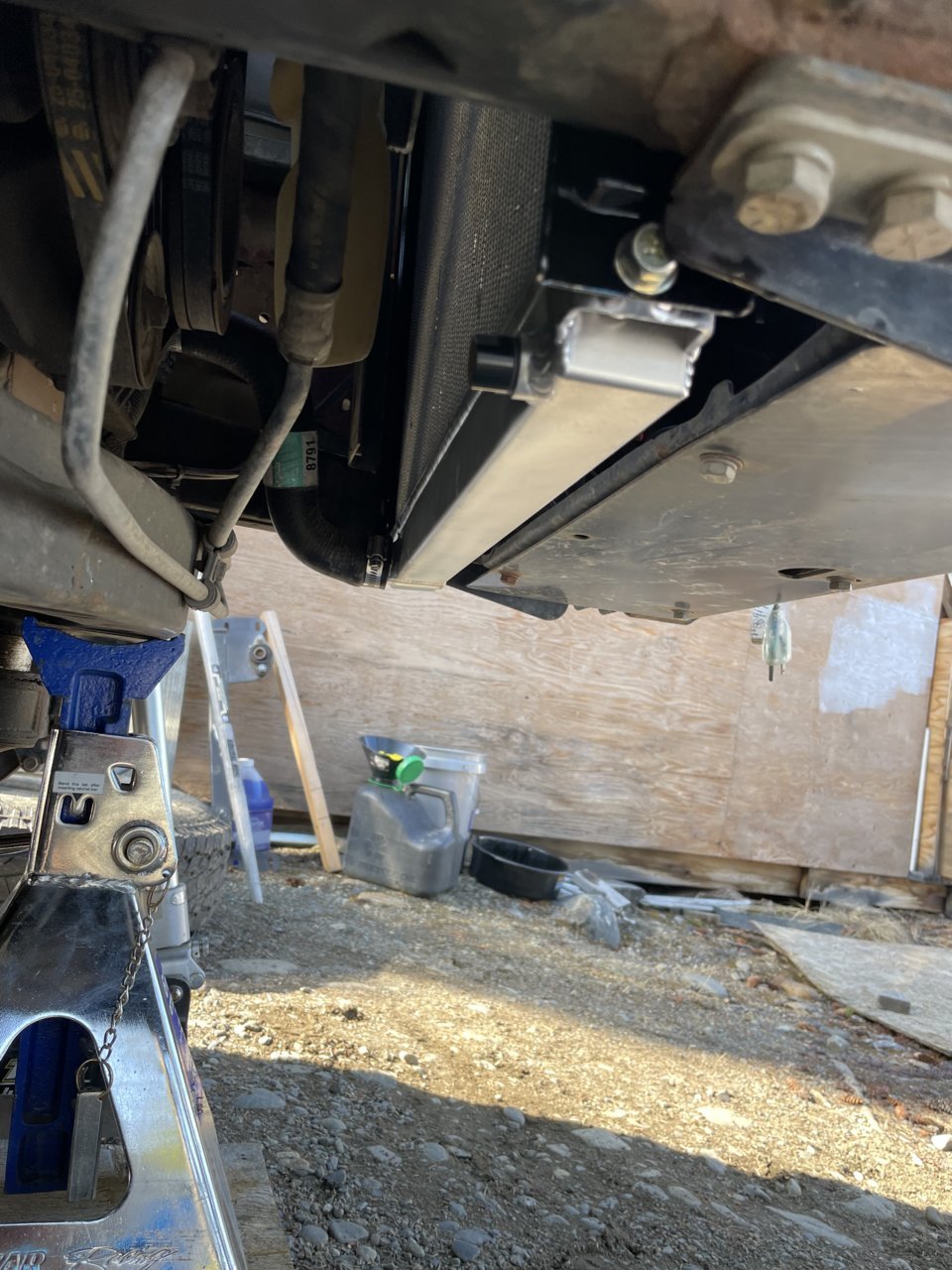

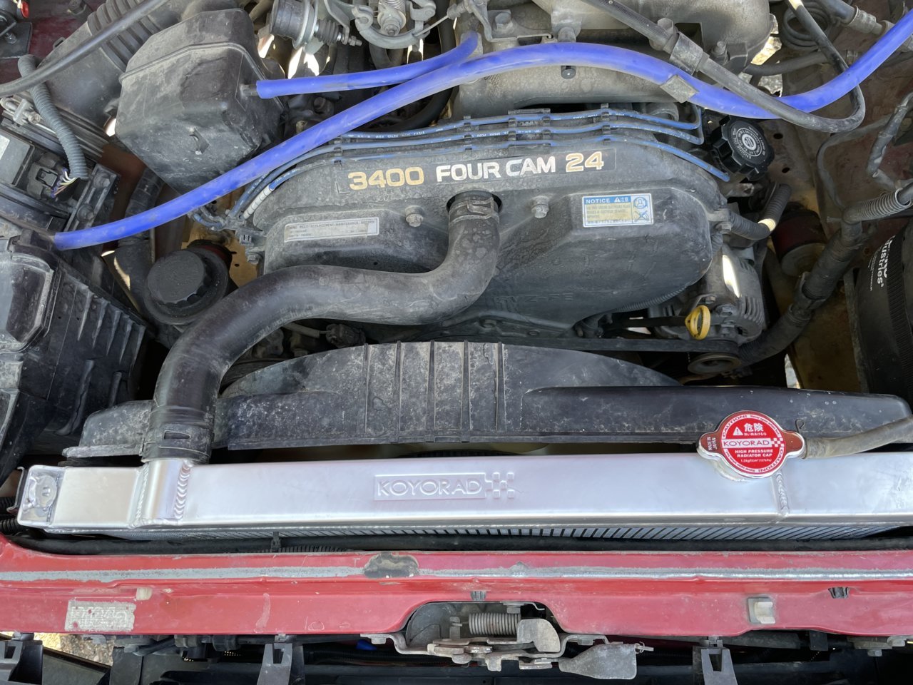

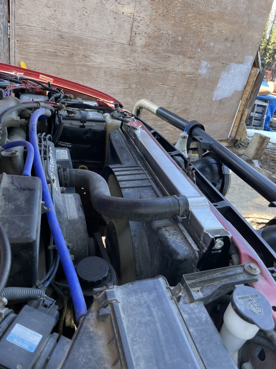

    Off to the recycling yard for this POS:

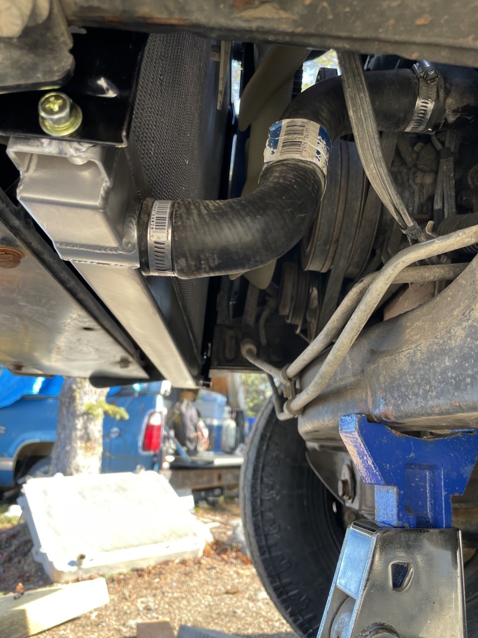

    image.jpg Well the planets aligned and I finally got the KOYORAD VH010513 radiator installed. All it took was having to sideline the Tacoma to deal with an axle boot(might be a cratered CV, the dreaded thump, clunk, and intermittent spinning banging sound - new development happened). So I installed the radiator changed the oil, greased and soaked the bolts for easier removal to be ready for the axle replacement.
    Notes about the installation- poorly documented as always, just head down and get it done as always here in the open air gravel garage.
    1) good build quality
    2) get the radiator cap KOYO SK-C13
    3) flanges are to fairly close tolerances so if your truck is a bit tweaked be patient and expose the core support, make it as easy as you can
    4) might not hold as much as the champion POS
    Looks pretty good
    Good clearance:
    Uses the same NAPA hose the chumpion used NAPA 8971
    great approach angle
    No leaks at this time.
    Not expecting any but it will be a couple weeks before the Taco is back on the road. Besides it is due for a vacation and some work.

    a couple of pics on the way out west:
    A much quicker commute to the west end, Kantishna airstrip:IMG_3848.jpg
    A couple photos from Tuesday morning after a freshening of the snow in the hills:IMG_3849.jpg
    The spring madness has eased, only one job to finish up this weekend. Be a good chance to knock out some spring cleanup around the cabin, maybe take a deep dive into whatever is making the weird noise.

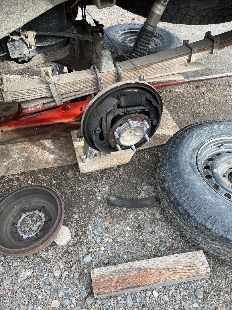

    Well I may have discovered the mystery sound from under the truck, looks like it may have been in part caused by delaminating brake shoes. LR front shoe brake lining came off completely when I removed the drum:
    Leaking wheel cylinder apparently dissolved the glue/bonding agent, that ahead the lining to the shoe:
    Looks like the other side was thinking about it as well:
    Obviously the linings were due for replacement, which was on the list of things to check this summer. Parts are here according to tracking, so next week it’s brake repair time. Thinking about getting a Trail Gear rear disc brake kit next winter, and possibly a driveline E-brake kit. Not sure if it’s necessary, the drums seem to do quite well on the rear axle. Just a bit more involved inspection wise.
    Kinda wondering if anyone has installed on of those rear disc kits, also thinking that upgrade the brake master cylinder to a Tundra/T100 to help with the rear brakes.
    Time for some research. Better to do it now I think. Waiting to hear about some front axles as well, then rebuild/replace the boots, before the Taco is back on the road. The fun continues….
