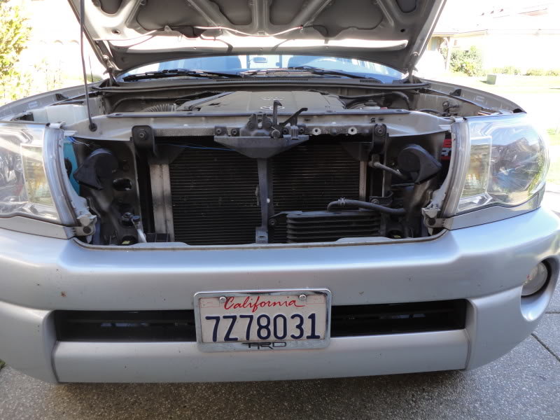

    If you look on either side of your engine bay there are 2 bolt holes (on both sides) bear the top. The one on the right is directly behind the fuse box. The bolts that currently hold the horns in place fit perfectly in those bolt holes.

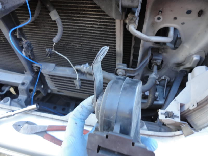

    I started mine also just thought i would share my horn mounting location.
    Factory:
    Uninstalled, had to extend the factory wires (Easy):
    Small bend in mounting tab:

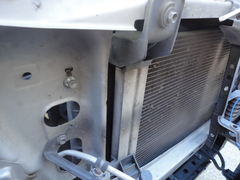

    Used this (silver) radiator mounting bolt (the one half unscrewed):

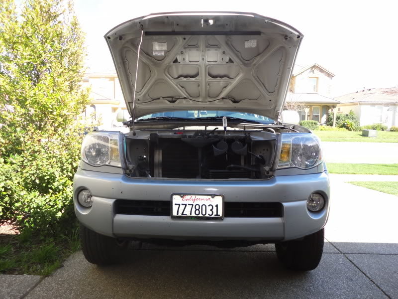

    Attached and wired hidden and protected from the heat of the radiator:
    With half finished grill installed:

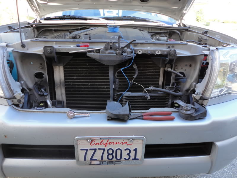

    I put them there so they would still be in the front yet hidden behind grill.
    Finished:
